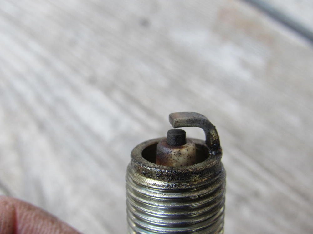

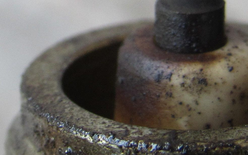

July 23, 20195 yr Author comment_580265 So put the fuel pressure gauge back on between the filter and regulator and all is good, 35psi, pulled the plugs and they were still wet from yesterday, blew lots of gasoline vapour out of the cylinders, the plugs looked pretty good so cleaned them and re installed. Turned the key and the engine started right up and settled down to an 800 rpm idle just like where I set it a couple of weeks ago. All is good with the world. I guess I blipped the throttle too many times and flooded it yesterday, not sure why the rpms went so low but it is not doing it now. The spark plugs only have an 1.5 - 2hrs on them and there is a dark streak on one side of the insulator, can't say I've seen this before. Link to comment https://www.classiczcars.com/forums/topic/62377-trouble-shooting/?&page=4#findComment-580265 Share on other sites More sharing options...

July 24, 20195 yr comment_580276 There is an unusual spatter on this plug. Link to comment https://www.classiczcars.com/forums/topic/62377-trouble-shooting/?&page=4#findComment-580276 Share on other sites More sharing options...
July 24, 20195 yr comment_580283 Well you know that if you don't find the root cause, it will absolutely happen again. Intermittent problems suck. Did you replace all the electrical connectors in the engine compartment? If the connector to the EFI temperature sensor isn't making great connection, it'll run very rich. Link to comment https://www.classiczcars.com/forums/topic/62377-trouble-shooting/?&page=4#findComment-580283 Share on other sites More sharing options...
