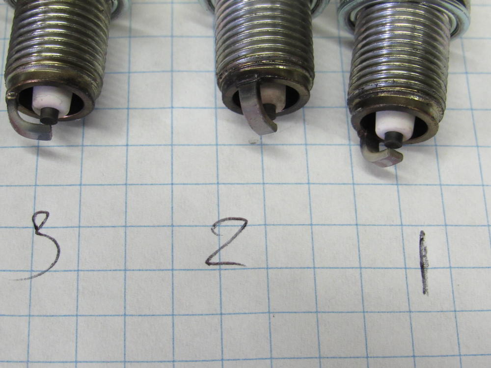

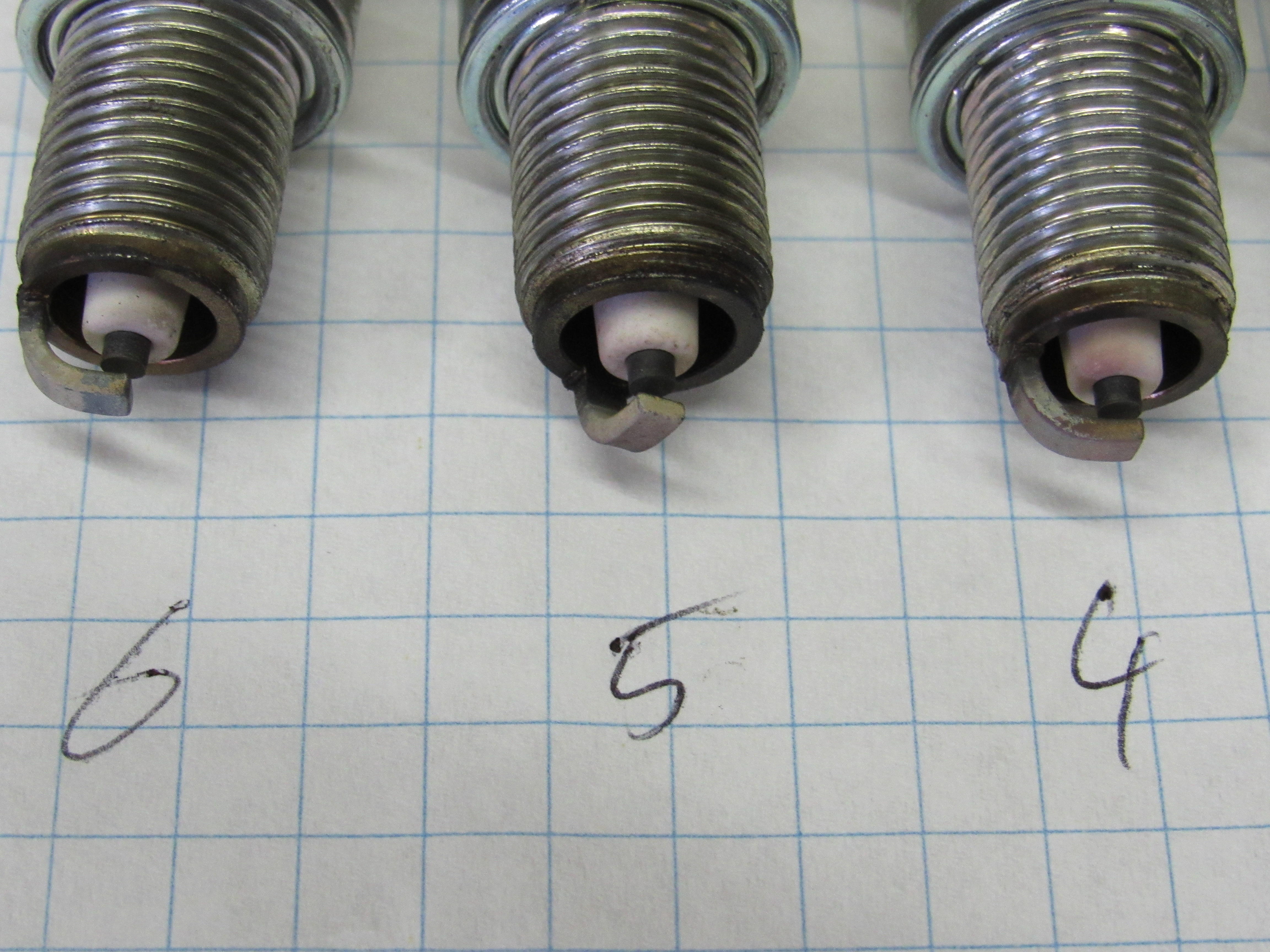

So have started the engine multiple times now with no repeat of the problems, starts first try every time.  I took the car out for a 10mi. run today just to push it a bit, see if I could break anything, it is running like a champ so when I got home I pulled the spark plugs to see what was happening. Looks kind of lean to me, not at all sure how to make it a little richer with an AFM.
They are all even but very lean. The easy way to enrich is to put a resistor in series with the temp sensor.

10 minutes ago, Captain Obvious said:
The EFI system is supposed to run clean. Other than the plug color, do you have any reason to believe you're running too lean? Were you pinging?
Is ten miles enough to really get a good plug read?
Other than the plug colour, no, there are no other signs, no pinging.  I've always believed that you could get a good plug read on much less than that although I could be completely wrong. The lean looking plugs are the same ones from post#44
They actually have a little bit of carbon buildup starting on the exposed metal at the ends of the threads.  Where it's cold.  The insulators look good and so do the grounding straps.  You can see some ash on the grounding straps and a little color on the insulators.  They'll be nice and tan in a few hundred miles.
