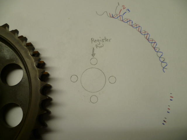

June 26, 20195 yr Author comment_578402 The FSM says that each different alignment hole in the cam sprocket adjusts the cam timing forward by four degrees. To make sure I knew what was going on with that I checked it out using the cam gear. Here's a quick sketch I whipped up using the cam gear off my P79 head. I traced the holes and sprocket teeth in the three different positions, and guess what... They are two (cam) degrees apart. That's perfect because two cam degrees is four crank degrees. Note that the direction is backwards because I could get a better registration with the cam gear flipped over, but the delta between the different positions is what's important. Here's what I whipped up: It would appear from the calculations, that you could take .080 off the head and advance cam the gear to it's next setting and pretty much be exactly back to where you started. Probably showing my inexperience, but assuming the tensioner can account for the difference, why can't you just do that instead of different valves and a whole bunch of shims under the springs and cam towers? Seems like the only thing you would need to do is move the cam gear. Edited June 26, 20195 yr by Captain Obvious Included a note about flipping cam gear over for sketch Link to comment https://www.classiczcars.com/forums/topic/62385-f54p79-swap-project/?&page=2#findComment-578402 Share on other sites More sharing options...

June 26, 20195 yr comment_578405 On 6/26/2019 at 5:06 PM, siteunseen said: I'm sure you've read this before but you know me...flog that dead horse! http://www.datsunzgarage.us/p79/ Great illustration Site.....and I spent hours in Roanoke with the Z Doctor. He built all of my P79 heads....he’s the one that originally came up with the set up. It tricks a P79/P90 into stock chain configuration with a 10:1 c/r. As far as advancing the cam sprocket 4 degrees to make up for an .080 cut without shims Capt., I think if that worked, it would have been done that way. I think Jeff G figured out some offset bushing for the cam sprocket that eliminated shims for his race car. I miss Doc! Link to comment https://www.classiczcars.com/forums/topic/62385-f54p79-swap-project/?&page=2#findComment-578405 Share on other sites More sharing options...

June 26, 20195 yr comment_578408 I would think .080 head thickness reduction would be difficult at best to maintain proper valves timing without shims. First you would be slotting your chain guides to slide them over enough to make up for the serious chain slack. I wouldn’t trust doing it without shims unless I could degree the cam. The cool part of that p79 trick with the taller valves is I believe you don’t have to mess with lash pad adjustments ( Guy can verify ) if you keep the stock cam or a slightly modified cam. I currently run my E88 with .050 cut off with no shims. I did degree my Isky cam . I am actually running 8 degrees advance on the cam . Link to comment https://www.classiczcars.com/forums/topic/62385-f54p79-swap-project/?&page=2#findComment-578408 Share on other sites More sharing options...

June 27, 20195 yr Author comment_578442 Thanks guys. I did some searching around online and the issue with the .080 cut seems to be more about the chain tension, rather than the valve timing. The valve timing can be adjusted using an adjustable pulley or the stock holes as I described, but with that much of a cam drop, the tensioner can't deal with that much slack. There are other options to take up the slack, but I haven't gotten to the bottom of the details yet. But the bottom line seems to be: Yes... You can relatively easily mitigate the cam timing, but you can't easily mitigate the chain slack. Link to comment https://www.classiczcars.com/forums/topic/62385-f54p79-swap-project/?&page=2#findComment-578442 Share on other sites More sharing options...
