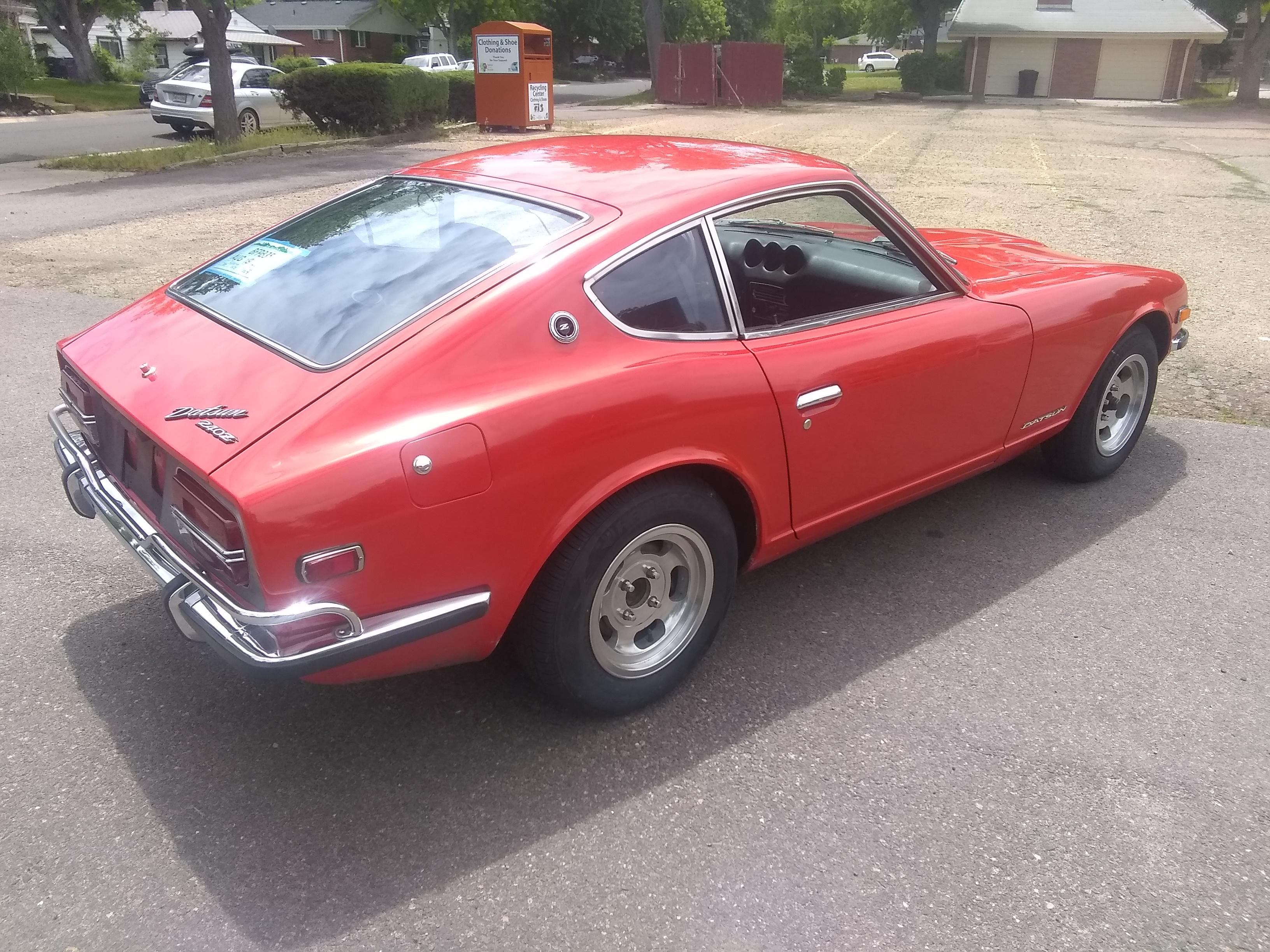

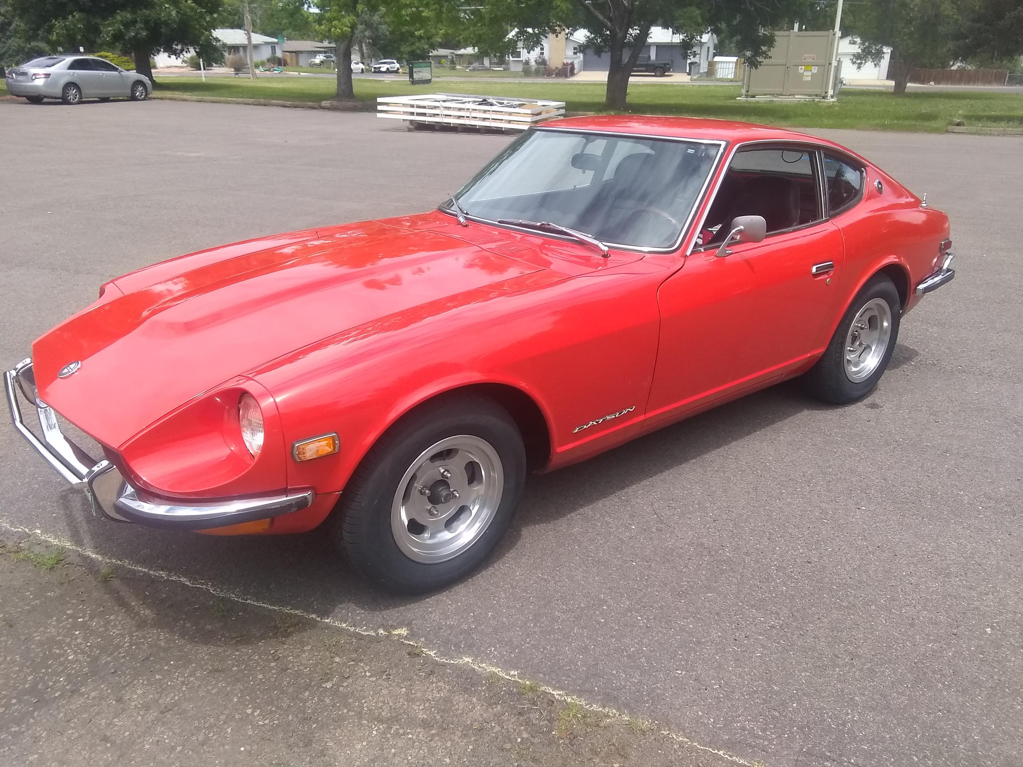

Posted June 27, 20195 yr Popular Post comment_578423 Hey Guys, I was sent here from the Hybridz forum. They said you do more factory and stock cars so it might be a better fit. I wanted to introduce myself. I bought this car 2 weeks ago from an old lady down the street. It was her husbands and he bought it in 1973. The build date is 6/1971. He never drove it in the rain and kept it nice. It hadn't been run in 7 years and hadn't left the garage in 10. I put gas in the carbs and tank, aired up the tires, fired it up and drove it home. It has 98k miles and service records since 1973. I have never owned a z before. I have been reading a bunch and getting familiar with it. So far I have changed the tires, belts, fuel lines, trans fluid, differential fluid, brake fluid, shoes, pads, and unstuck a brake cylinder. I have some interior parts coming to freshen up the interior. I polished the wheels today and tomorrow I am going to buff out the paint. This winter I am going to do the trans and differential seals, suspension, bushings, steering ect.. I am preparing a laundry list now. Aside from the suspension, the car runs and shifts well except when downshifting into third. It grinds every time, no matter what I do. None of the other gears grind. My buddy suggested double clutching but that hasn't worked. The fluid in the trans was thick and smelled like gear oil. I put in red line I think the PO used the wrong fluid. I was reading that the wrong fluid can damage the syncros. Is there anything else I can try to make downshifting into third smoother. Bill Link to comment https://www.classiczcars.com/forums/topic/62394-1971-240z-refurbish-in-denver/ Share on other sites More sharing options...
