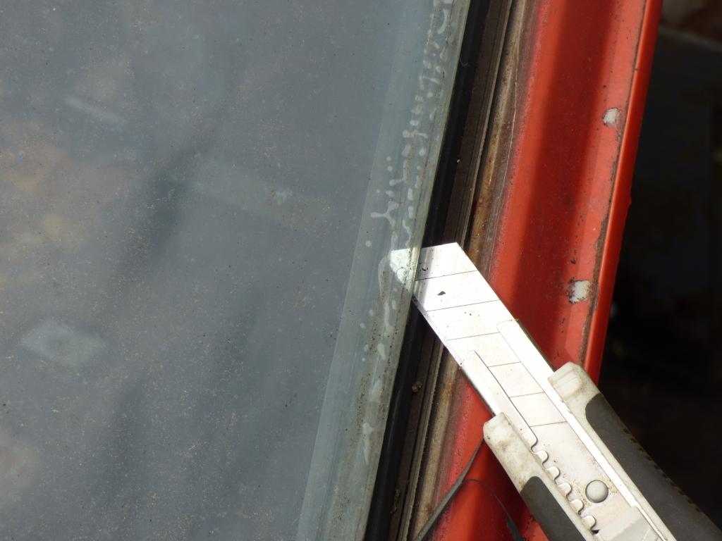

  1. Cut out the original rubber seal as much as you can before taking out the old glass.  First cut out above the glass so that the edge is exposed then get a knife blade behind the glass to free it.  Do all around before lifting.

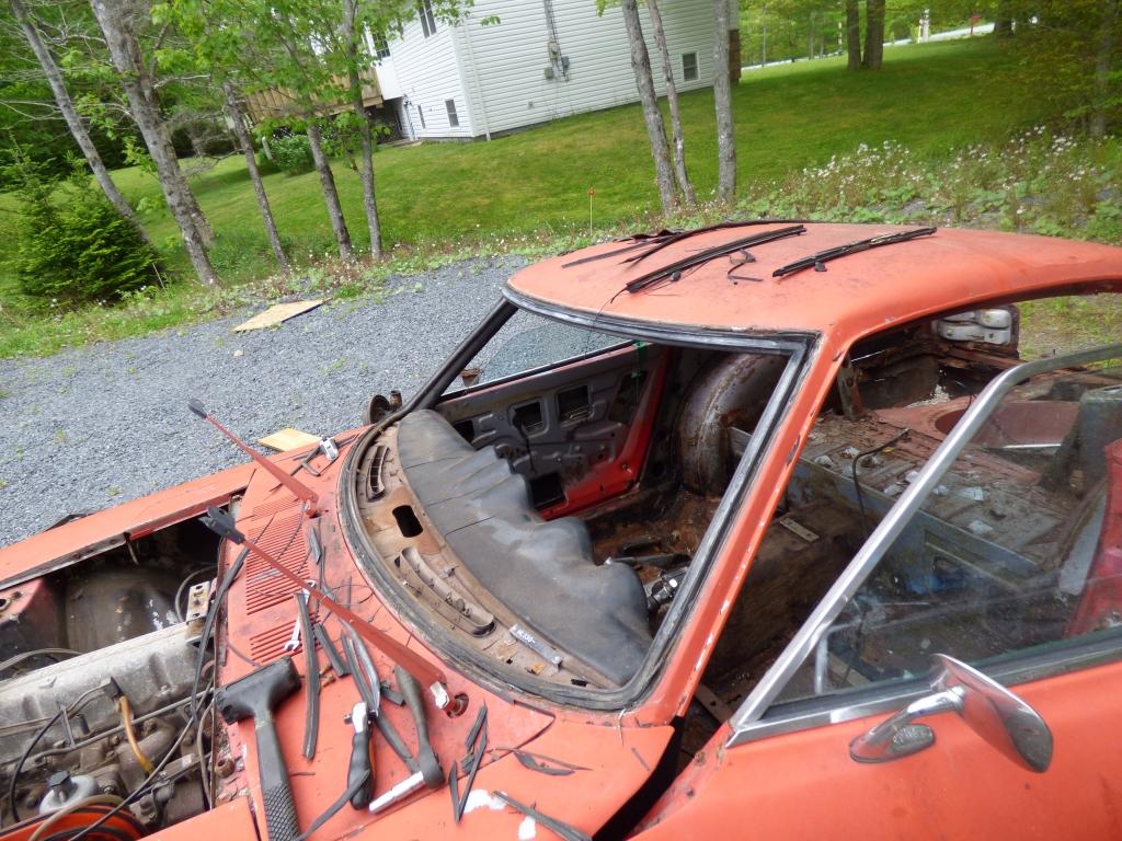

  2. Remove all old seal and sealant.  Address any rust on the pinch weld
