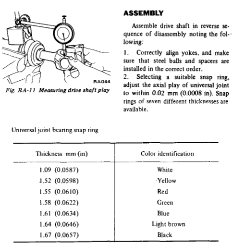

Use Nissan u-joints are probably tighter than new aftermarket u-joints.  Don't assume that new is better.  I replaced four of them, put the shafts in the car and drove it, then took them back apart and returned them to OReilly auto.  They were brand new but sloppier than the ones I took out.  Precision brand.  Only one of the four Nissan joints was bad but I thought that replacing all four was the thing to do.  Wasted three good Nissan joints.  Nissan sells precision made circlips to get the cap tolerance as tight as possible.
Your best option would be four new Nissan u-joints, but that will cost you about $320.
The FSM shows that Nissan's desired accuracy was down to 0.03 mm, edit actually 0.02 mm, by their own description.  The range shows that the yokes must have a very wide range of manufacturing tolerance if this wide range is needed to cover all of the yoke possibilities.  The aftermarket u-joints have one size to fit inside that range.
