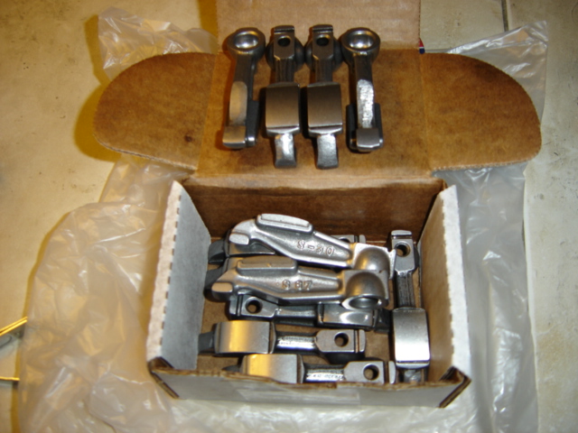

I sent Schneider Cams an original Nissan cam that has "JAPAN" stamped on it after reading about the failures of those CWC cams they will send you if you let them.
You might look at Schneider or isky's web site.  They have a few different profiles for our cars at a lot better price, send your rockers to Delta Cams for resurfacing.  Cost $50, $3 per - $36 plus $14 shipping.
