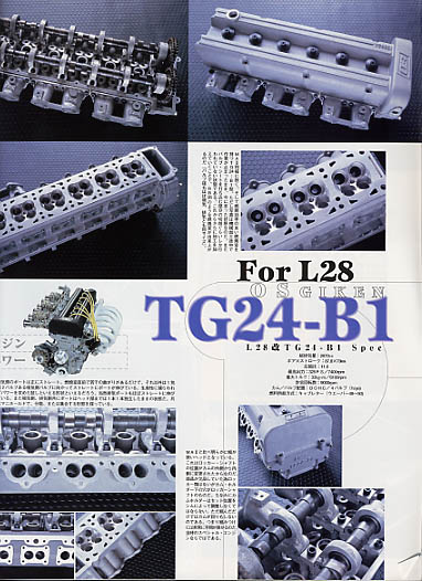

The other engine head that was crossflow was the O.S Giken head from what Alan has told me. These were expensive to make and most were destroyed in the 80's I think by all the street racers.

There was an aftermarket crossflow head design for both the L-series 4 and 6 cylinder engines, which was made by a company called "O.S.Giken". Their TC24-B1 design for the L-series 6 was a 24-valve, twin cam hemi design with the spark plugs located centrally in the top of the engine. This was a very complicated affair and was rather expensive, as has been noted! A special front timing case casting was necessary, as were special pistons and other ancillaries. Price was very expensive!

Personally, I love the Nissan L-series engines. However, a nice LY28 or TC24-B1 would do very nicely too thank you:classic:
