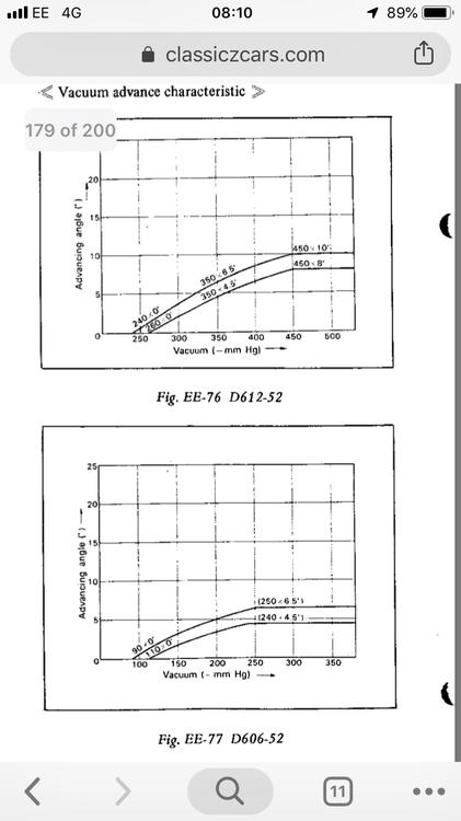

When you are happy with this, monitor the MAP gauge on the app or use a normal vac gauge and determine how much vac you are generating at idle and at 3000 rpm. Then set 10 degrees (your stock dizzy does 15 but I like to play safe on vac for various reasons one of which is the unknown “rate of attack” with the 123).
Here is FSM vac curve

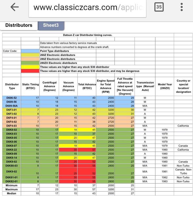

Here is a great table - see if you can find your stock dizzy
