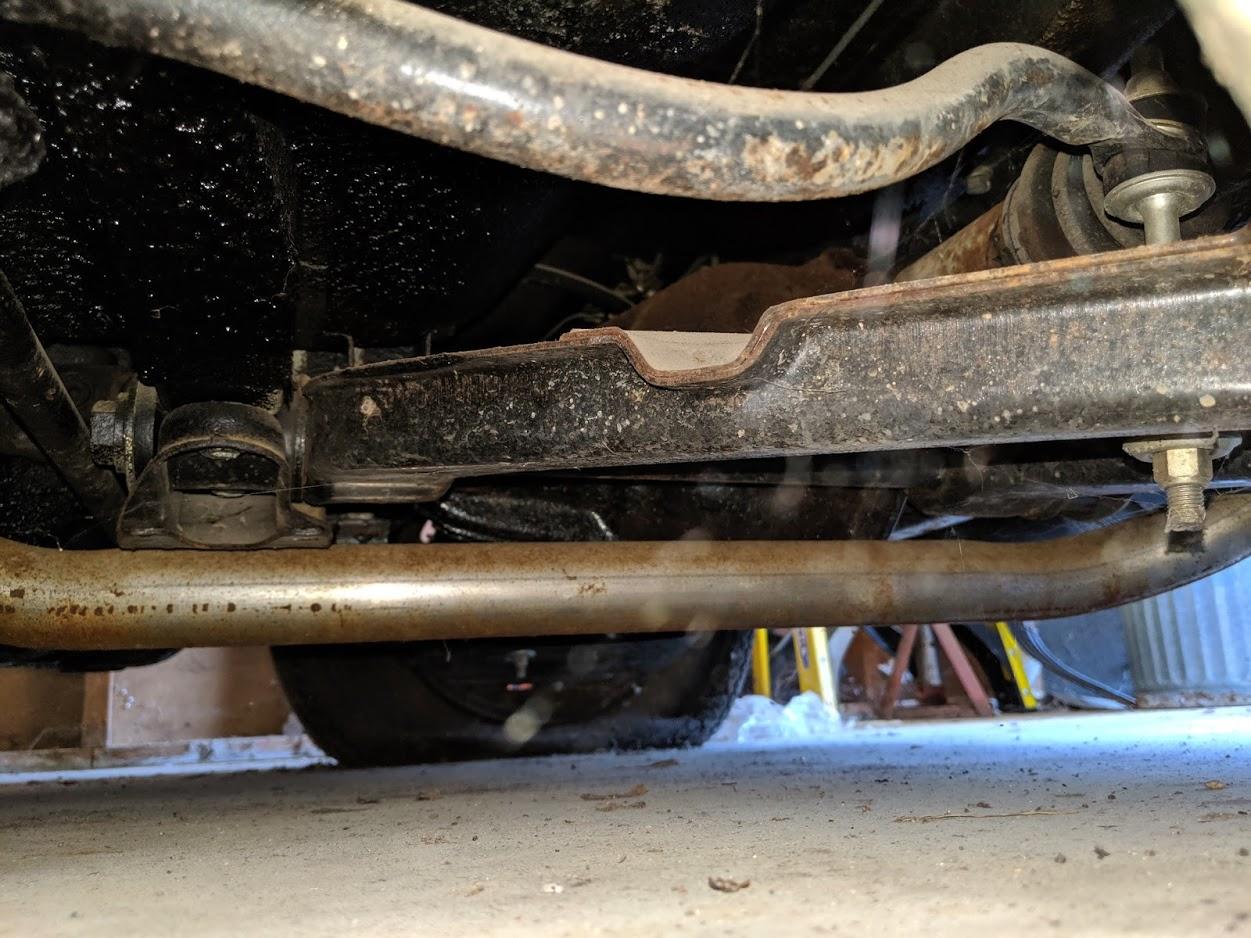

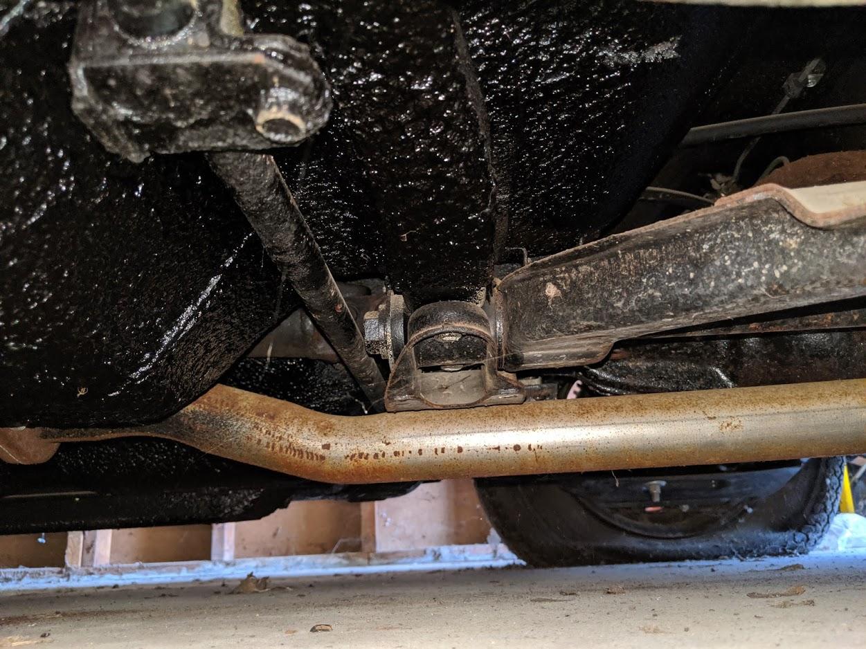

Between the re-paint (look at the ash tray pocket on the tunnel, always the exterior color), the road rash on the leading face of the suspension, and the discoloration of the exhaust (and where is its heat shielding), my dough's on 100,350mi.

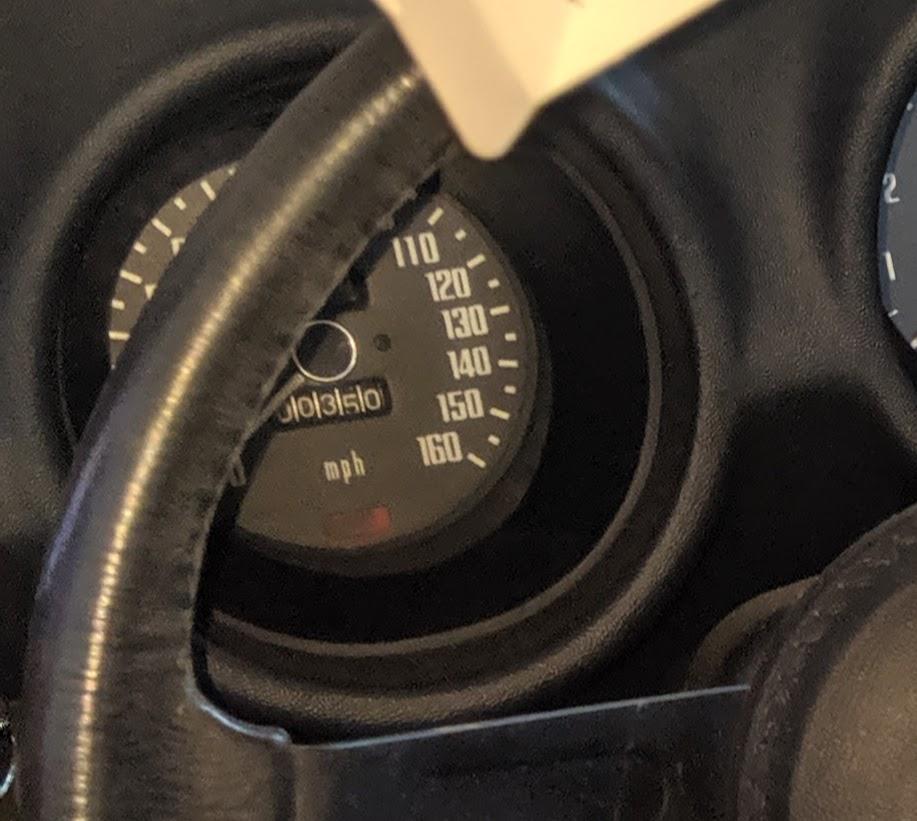

I zoomed in on the picture with the odometer. There will be more pictures after I get the car home on Saturday
The old way of telling if an odometer had turned over was to see if the 0's were on the same line.  Yours look pretty good.

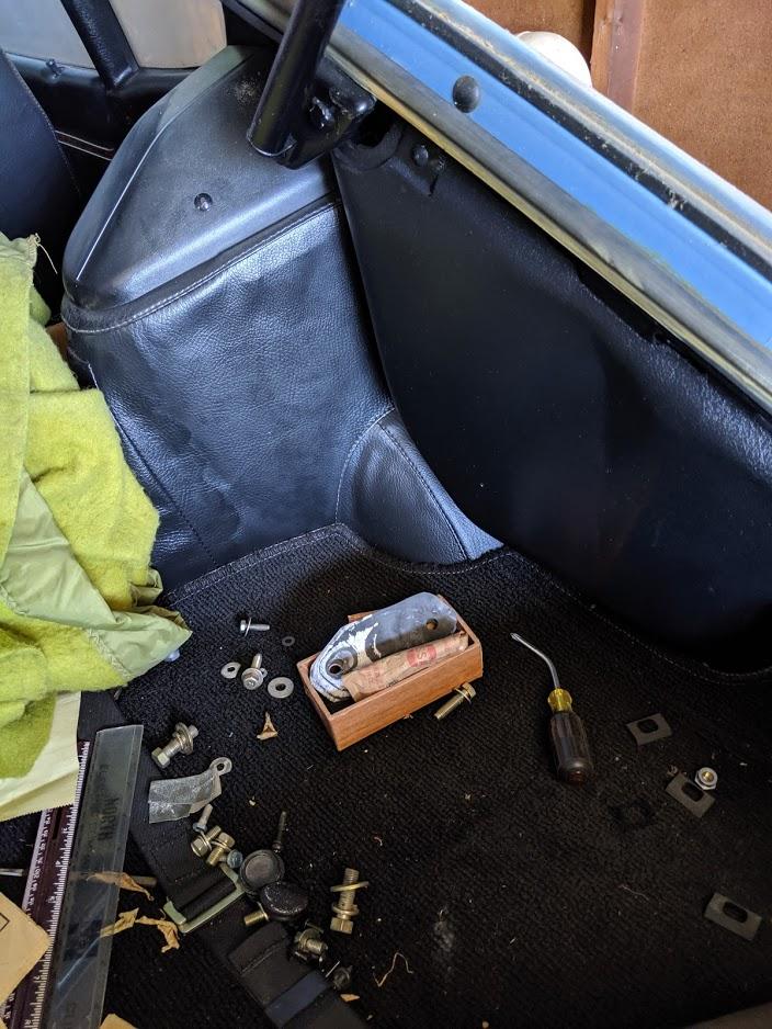

3rd pic in this post is missing fender bolts also.
Good eye. Apparently the owner noticed a ding in the left front fender when he got home. The dealer was going to putty the ding and re-paint the fender. The owner didn't want that, and had them give him a new fender. Apparently they gave him the new fender but didn't install it. He still has the original fender too. So I'll have a extra "Brand New" fender.

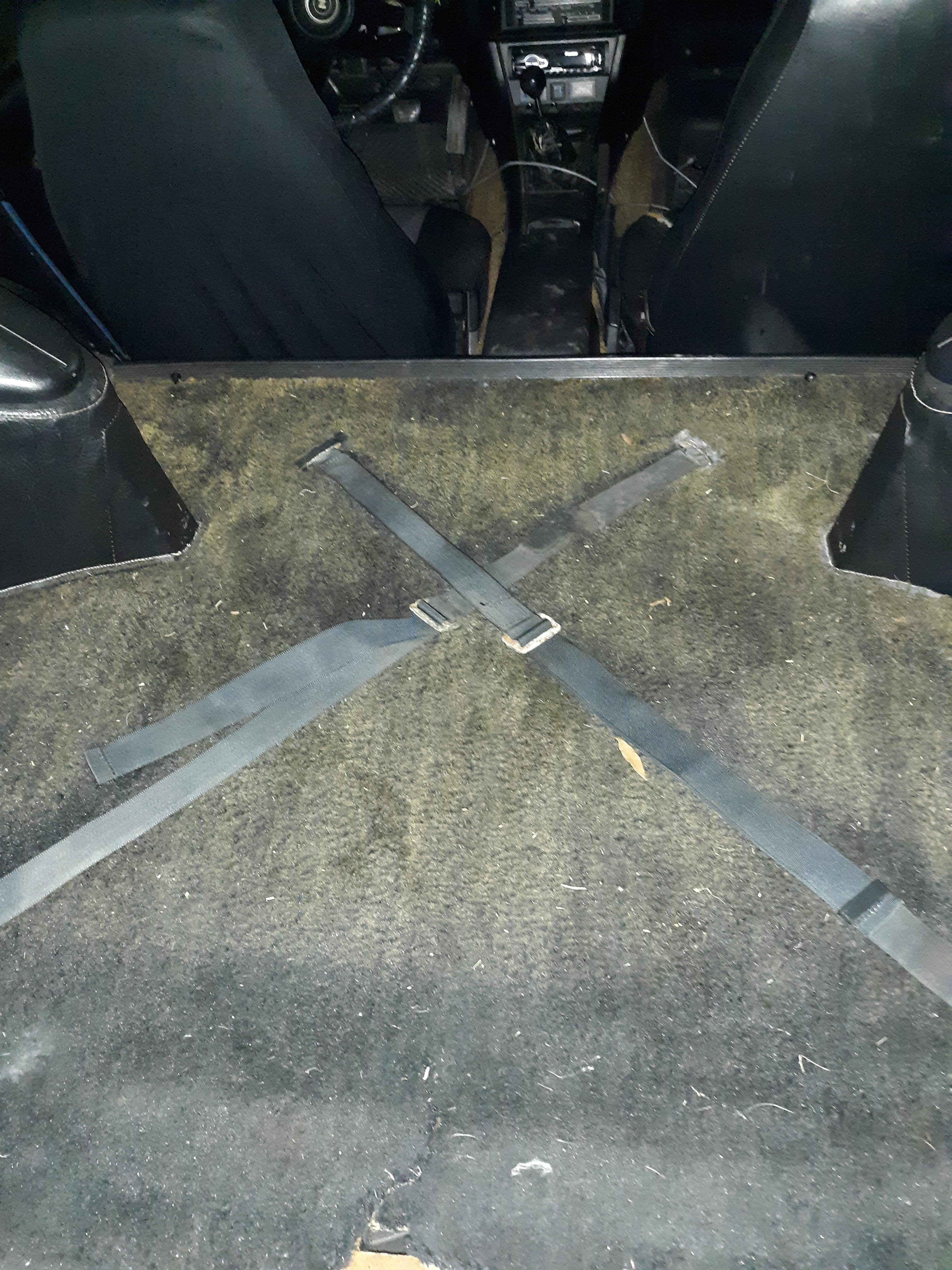

I can't wait for the photos, I'm a very bored guy.  The carpet/jute will be my tell.
9/76 original carpet even with rear louvers.
Here is the only current image I have of the rear carpet.

I am also confident that the undercarraige shots clearly indicate a fair number of miles on the chassis. The roll bar and its fixing bolt head, as well as the forward faces of the susp. arms are definitely not just muddy.
Going to the interior again, the steering wheel, the seat covers, and the shift boot show the kind of dust consistent with that found on the engine and exterior, while the rear carpet and tower vinyl look very fresh.
