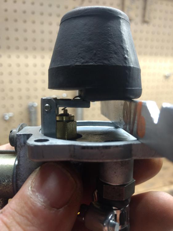

So I pulled the pistons and the fuel level looked low maybe 1/4" below the needle seat. I pulled the float chambers off and am trying to adjust the float and valve. In the Z Therapy video he says to set the float to .55". But he also mentions long and short eared float chambers and different levels needed. The FSM and other repair manuals give different gap measurments. What is the gap measurement that I am looking for my set up?

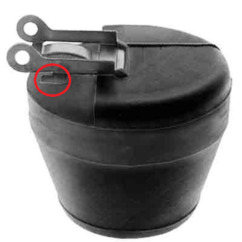

You cannot set the newer style needles like the dvd with Grose jets.  You have to hang them upside down from your picture above, actually right side up. LOL
I fooled with mine for many months before I realized this.  A lot of other guys have run into it too.  The newer needle jets are so sensitive they won't hold the weight of the floats like the dvd shows.
First off I would straighten the float tabs back into shape.  Disregard the red circle.  The tangs should look like an upside down slice of cantaloupe not like a ramp.
Then hold them right side up and blow through fuel bung while pushing the float upwards.  Have something that is .55" wide and hold it against the bottom of the lid. When you are at .55" you should not be able blow any air.  Valve is closed.  That worked for me.  I got bored last winter and did this to make sure they were right.
