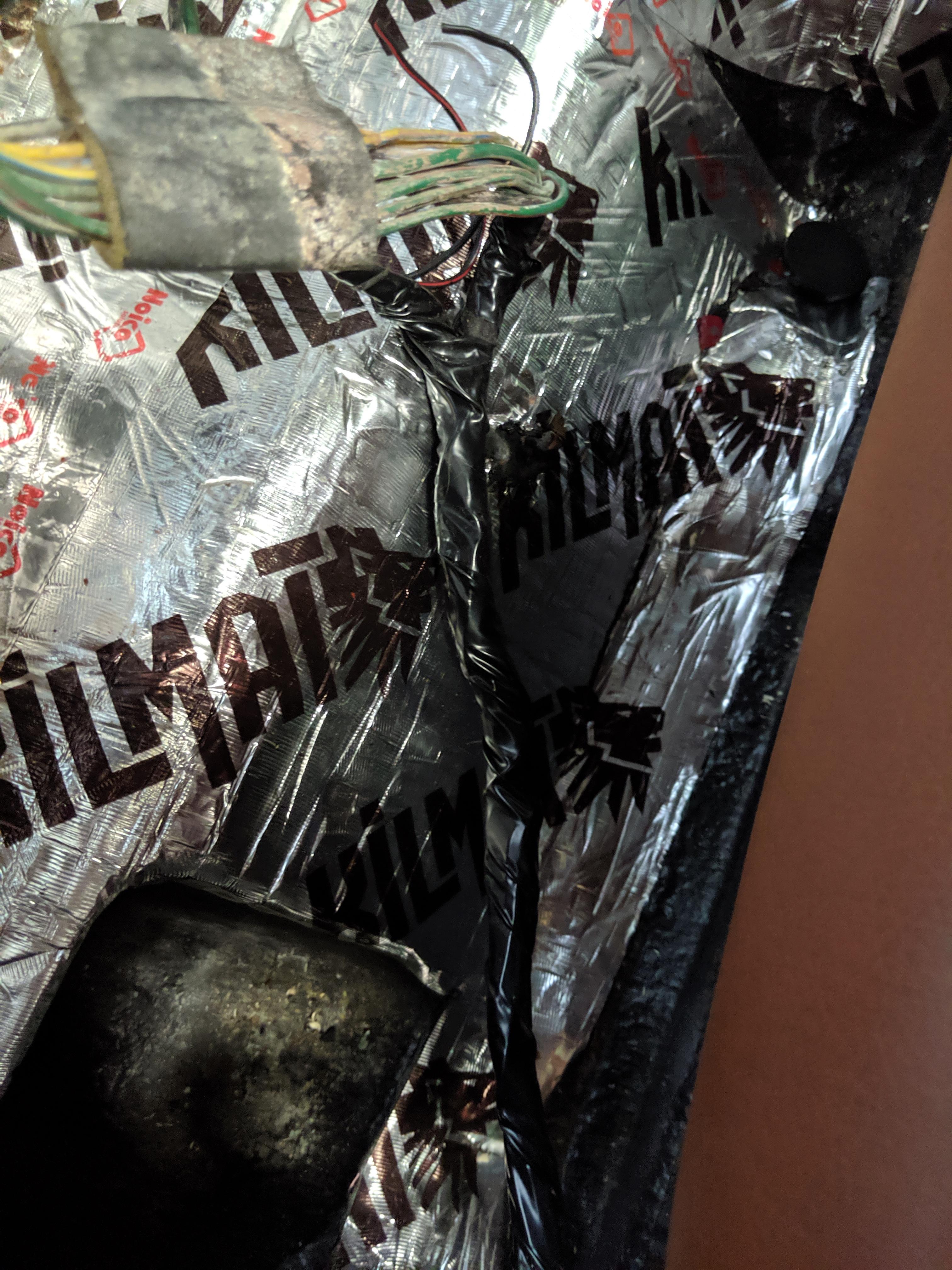

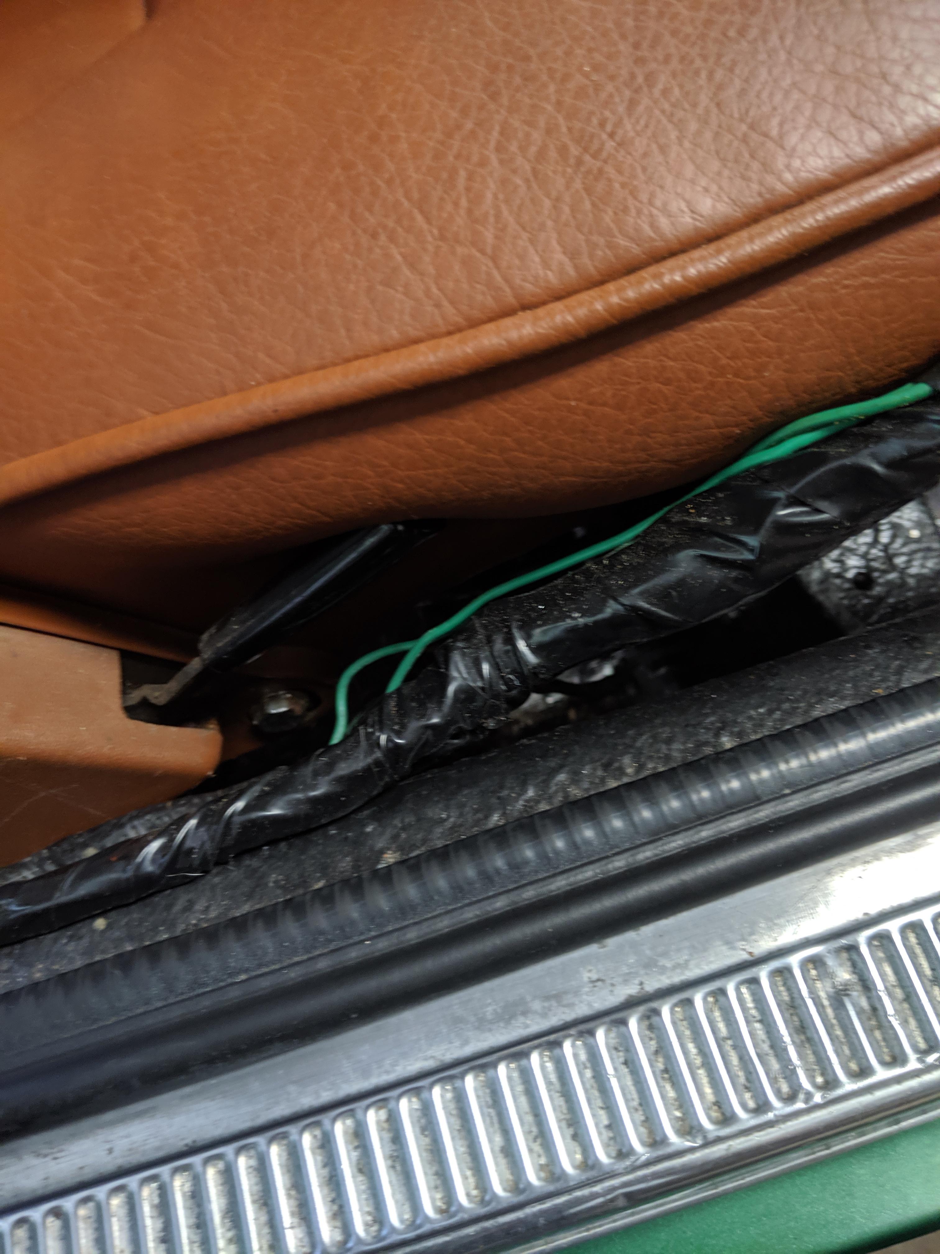

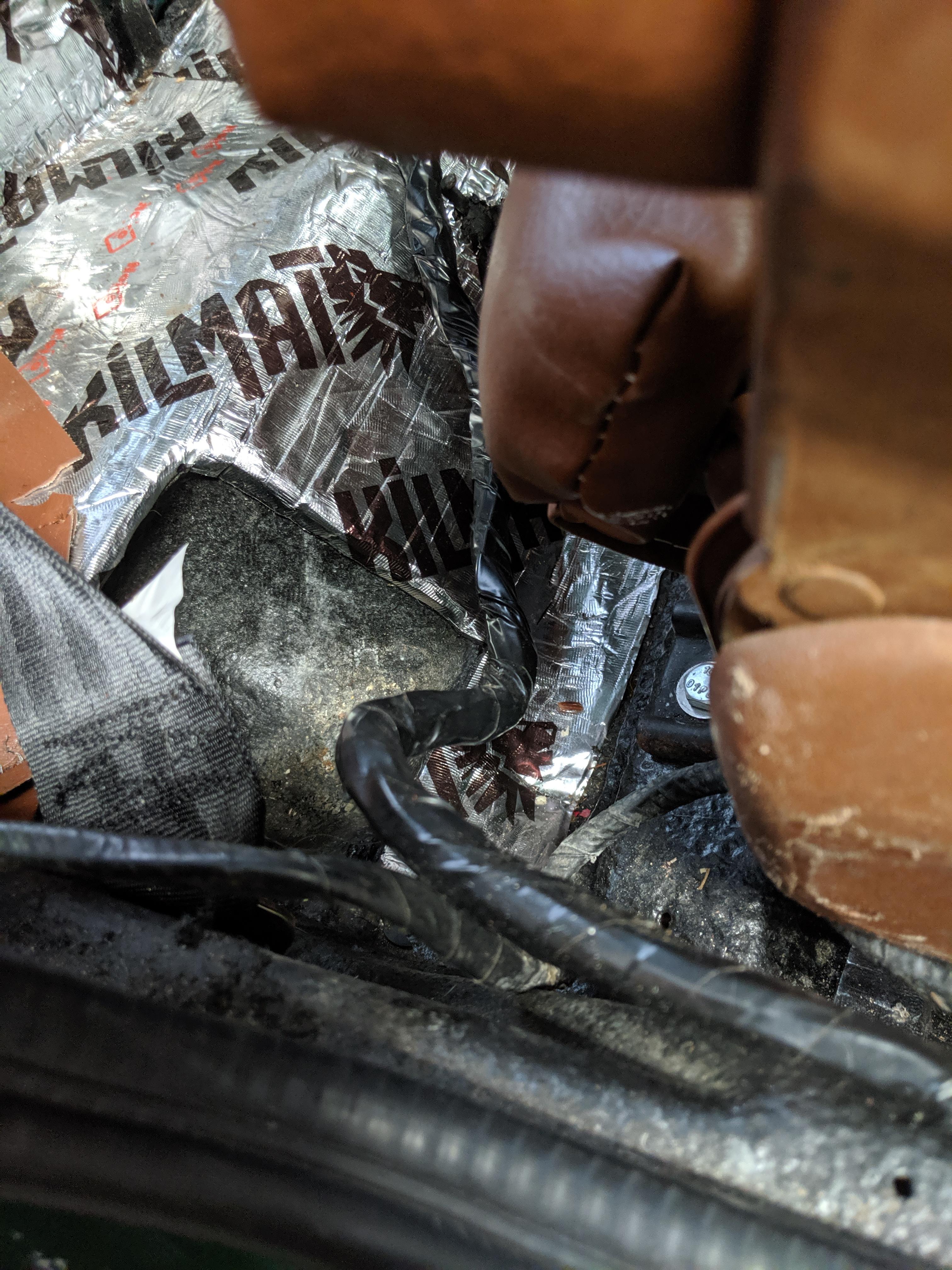

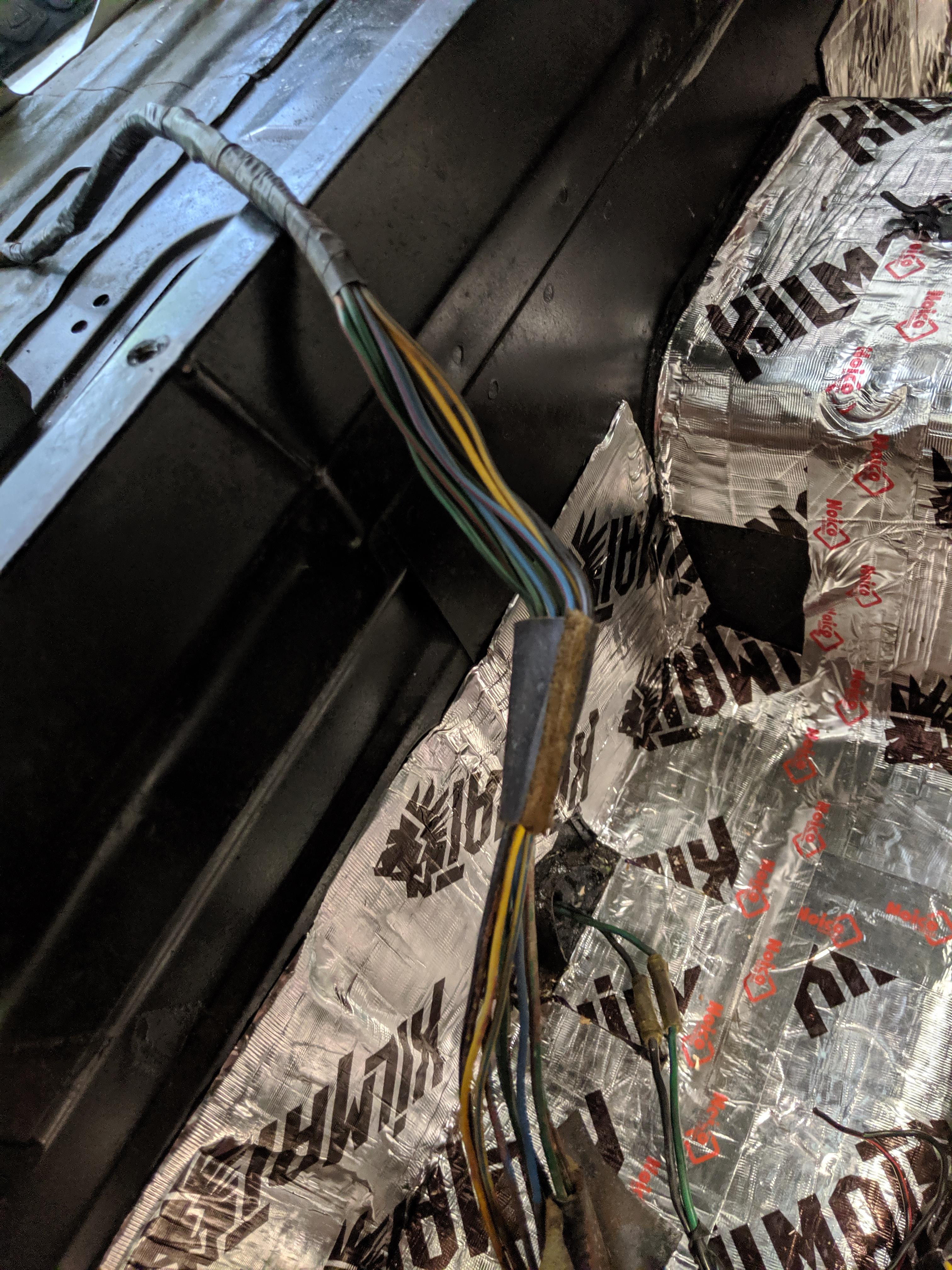

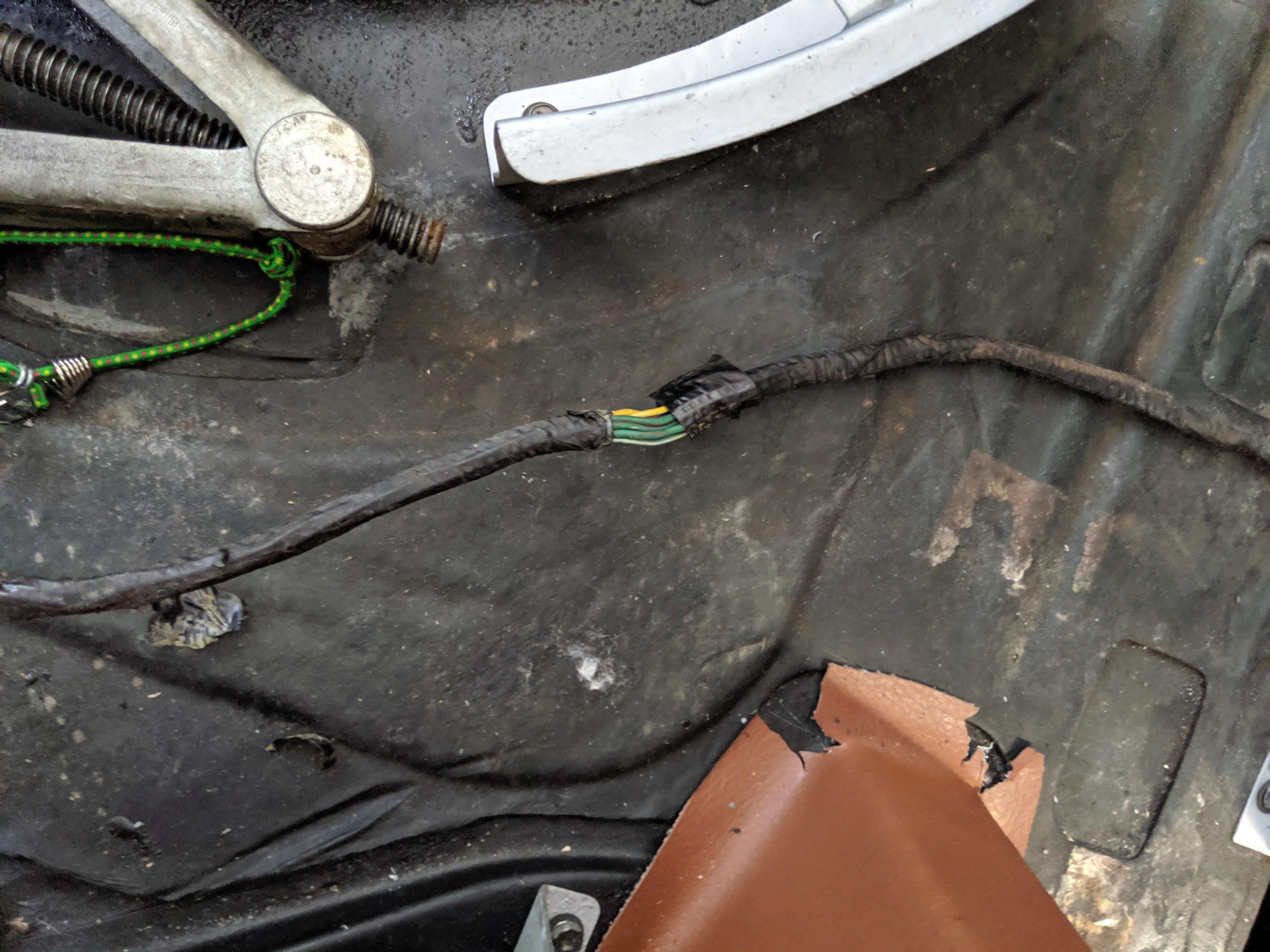

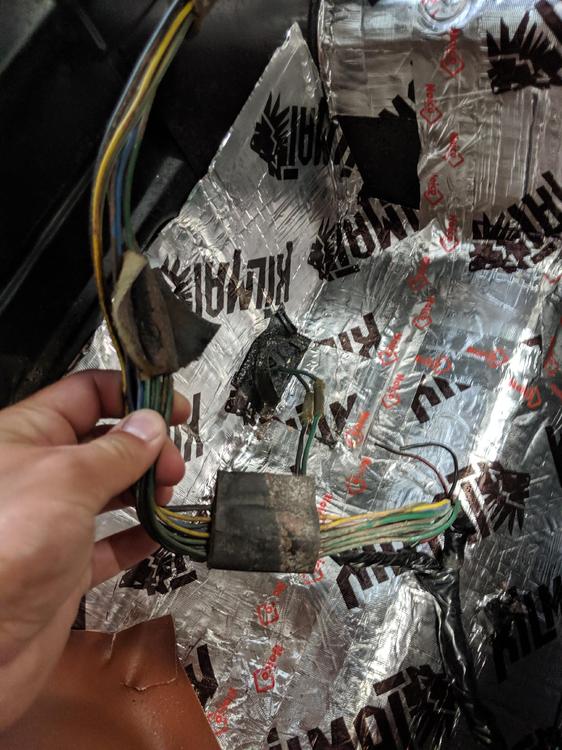

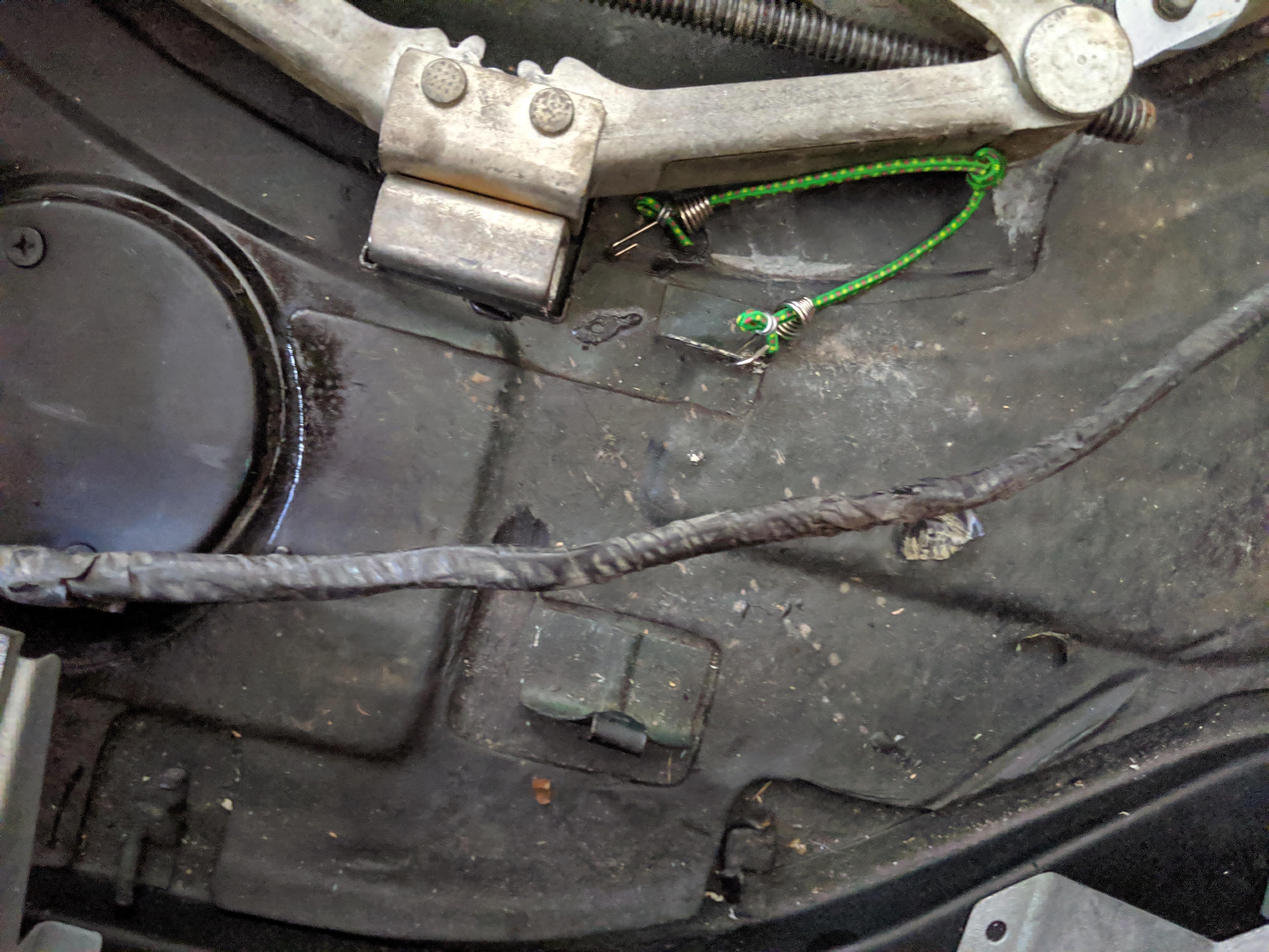

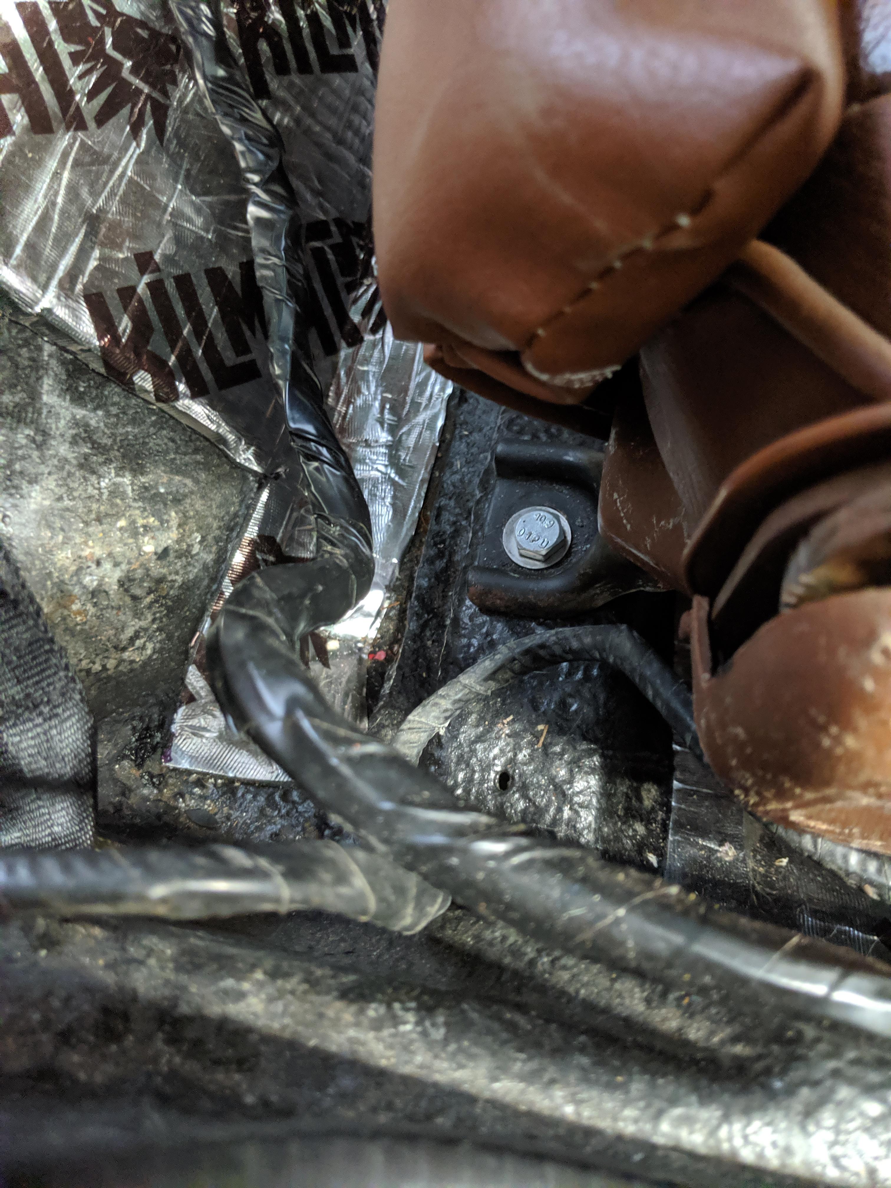

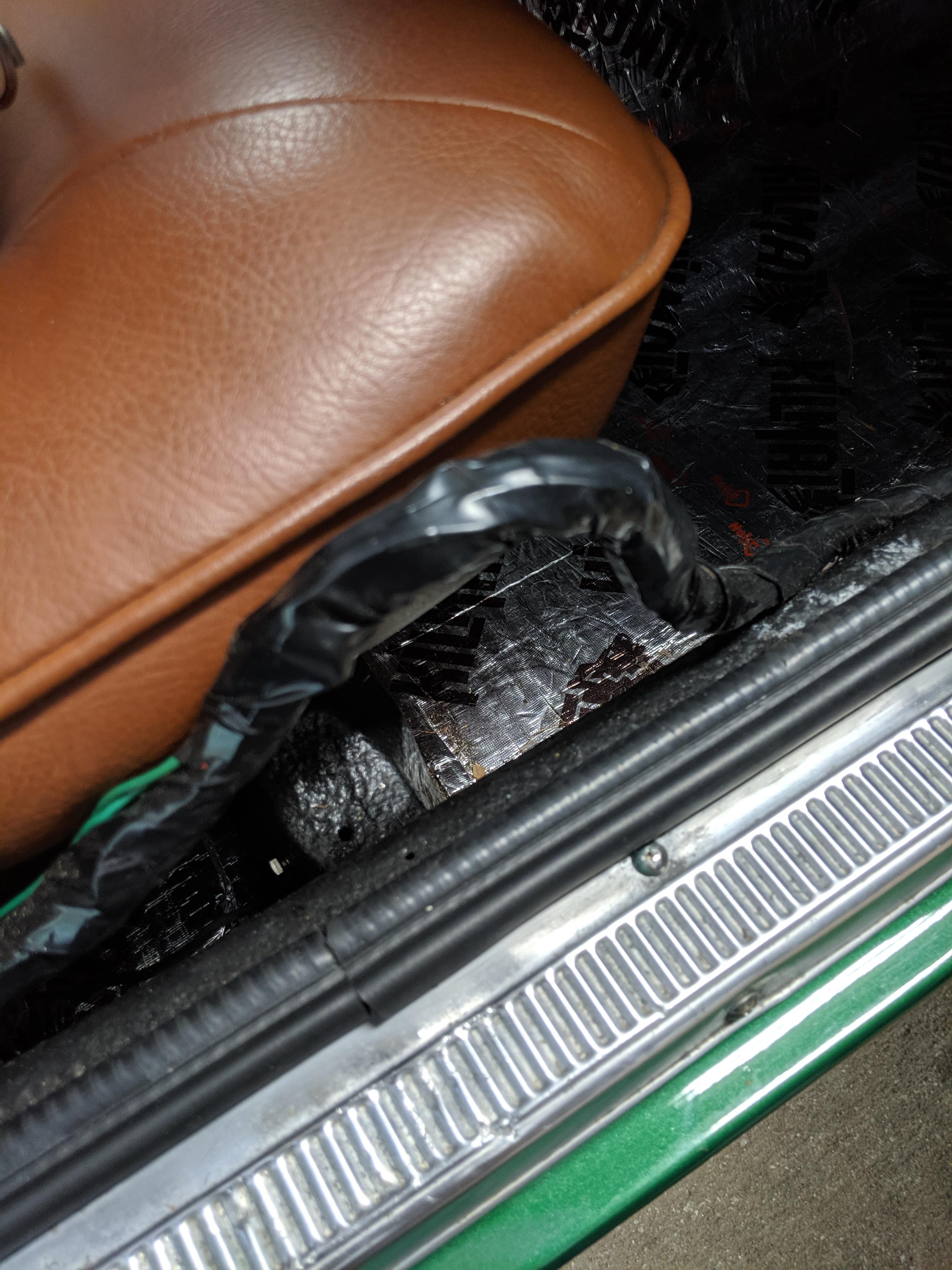

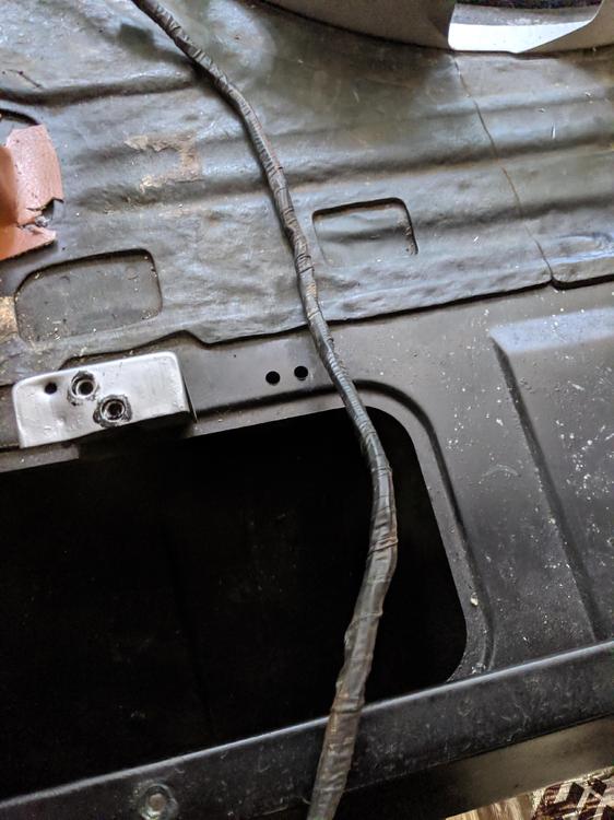

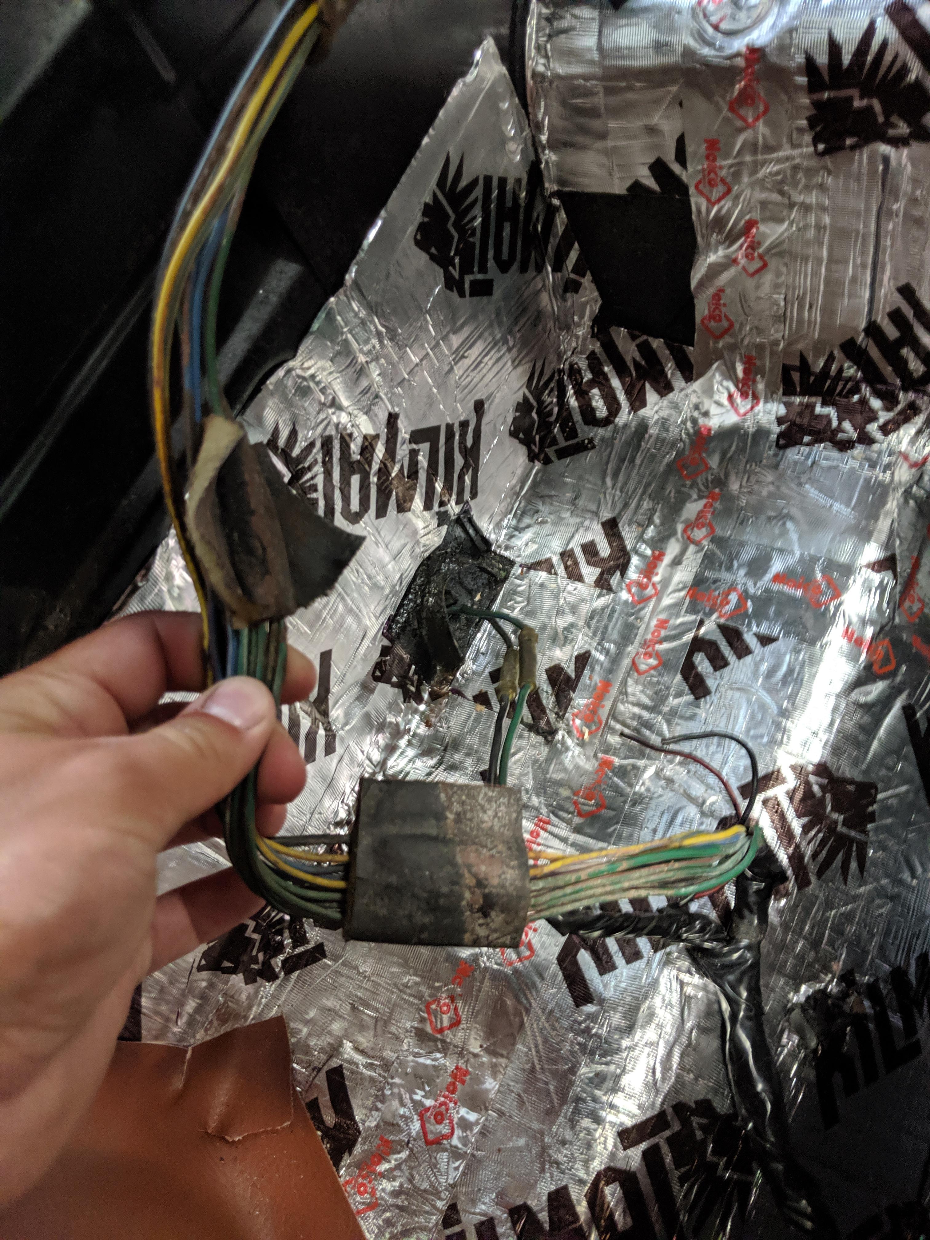

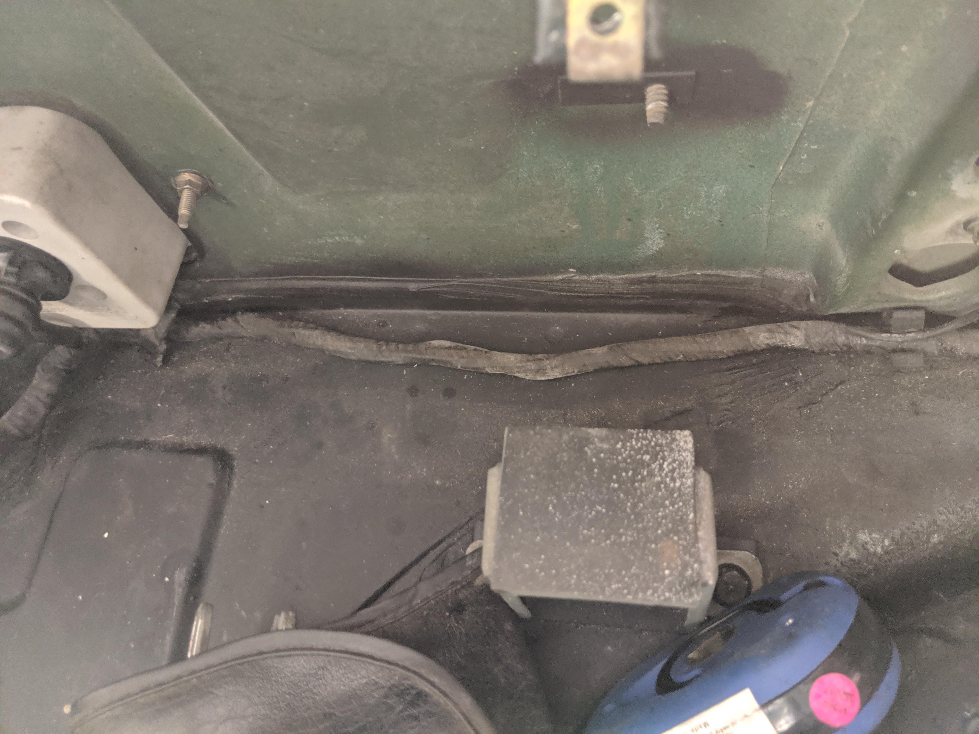

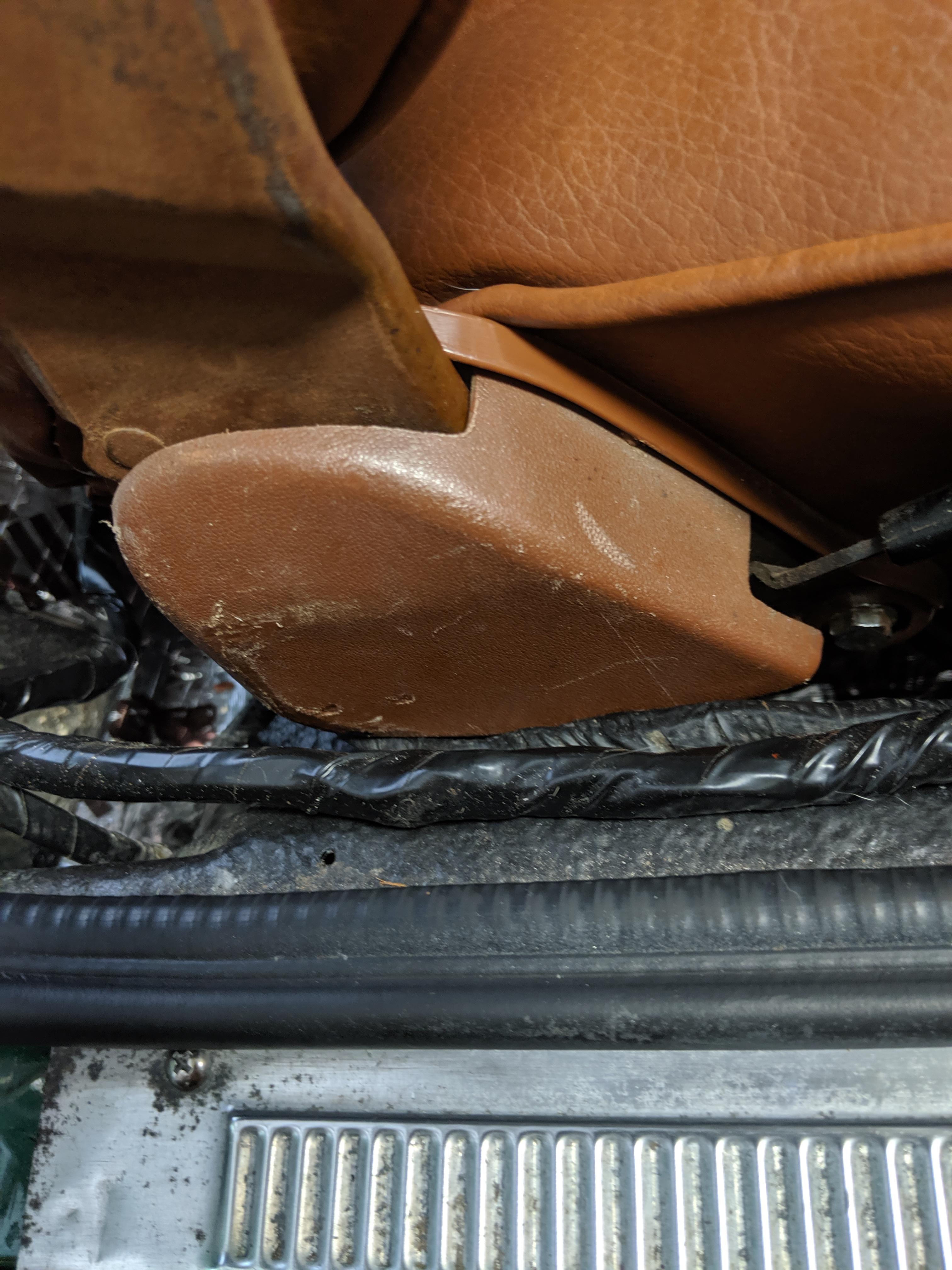

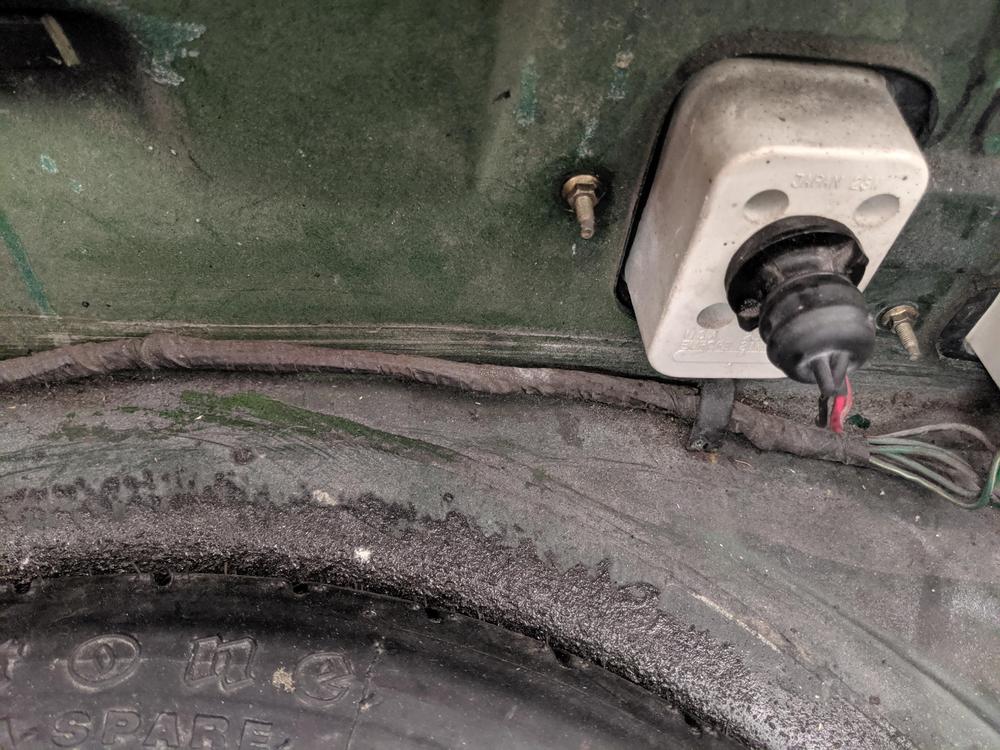

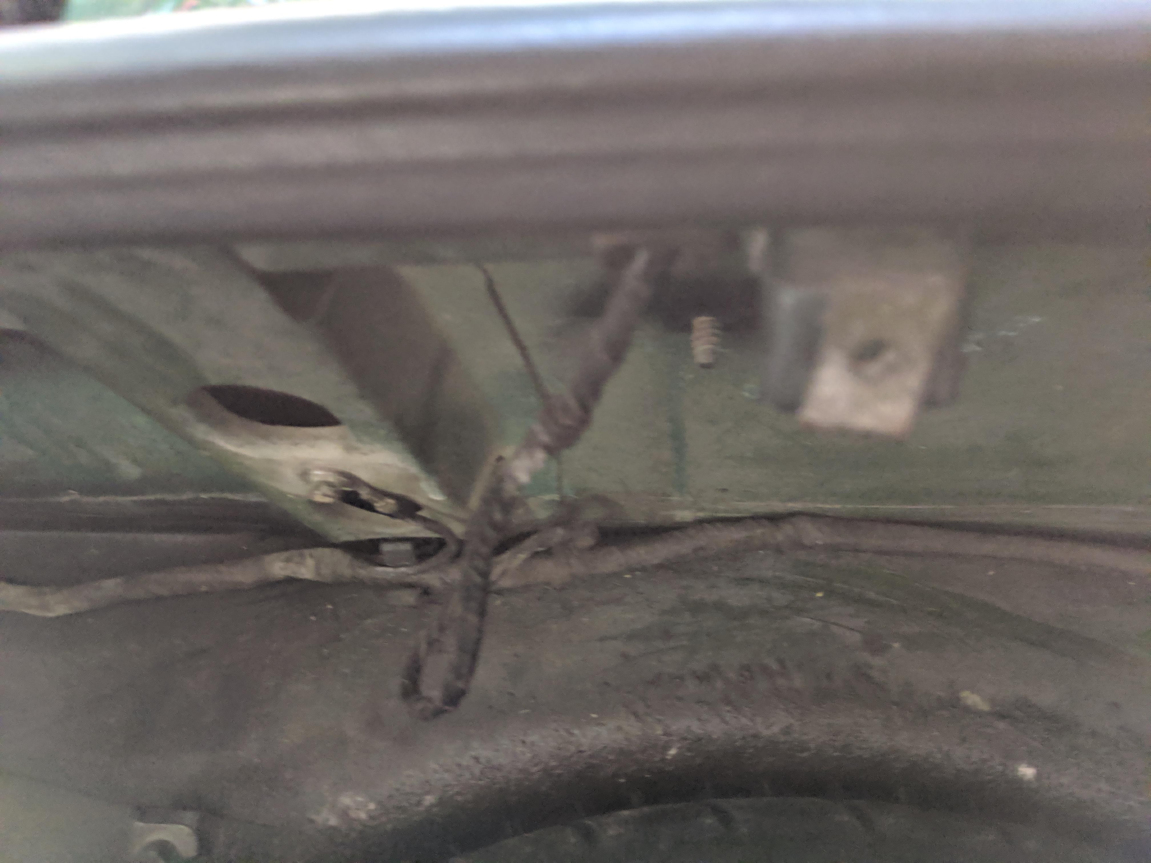

Took a look at the rear of the harness this morning and I don't see anything suspicious. The place where the electrical tape is where it was already peeling off so I peeled it back further to look. Attached are pictures

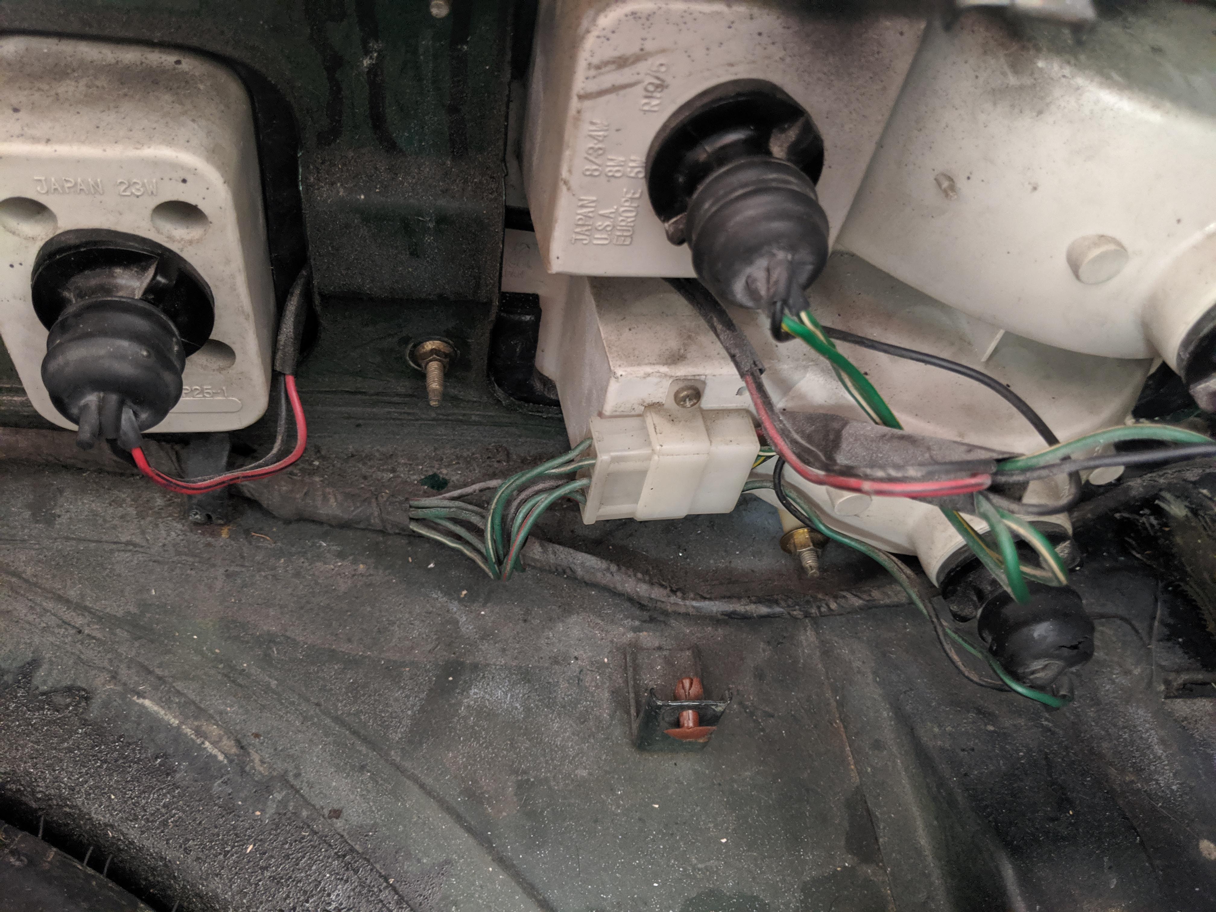

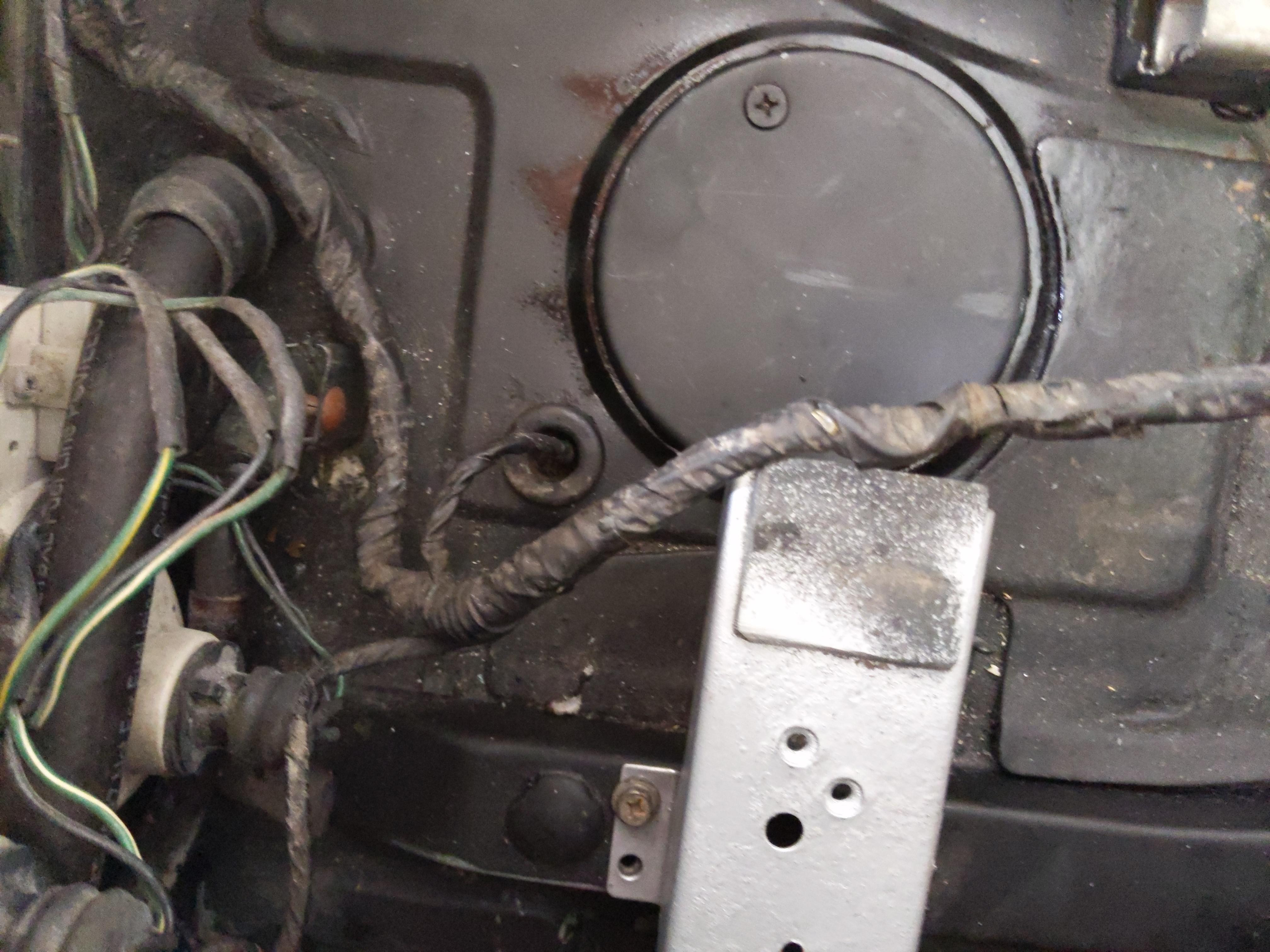

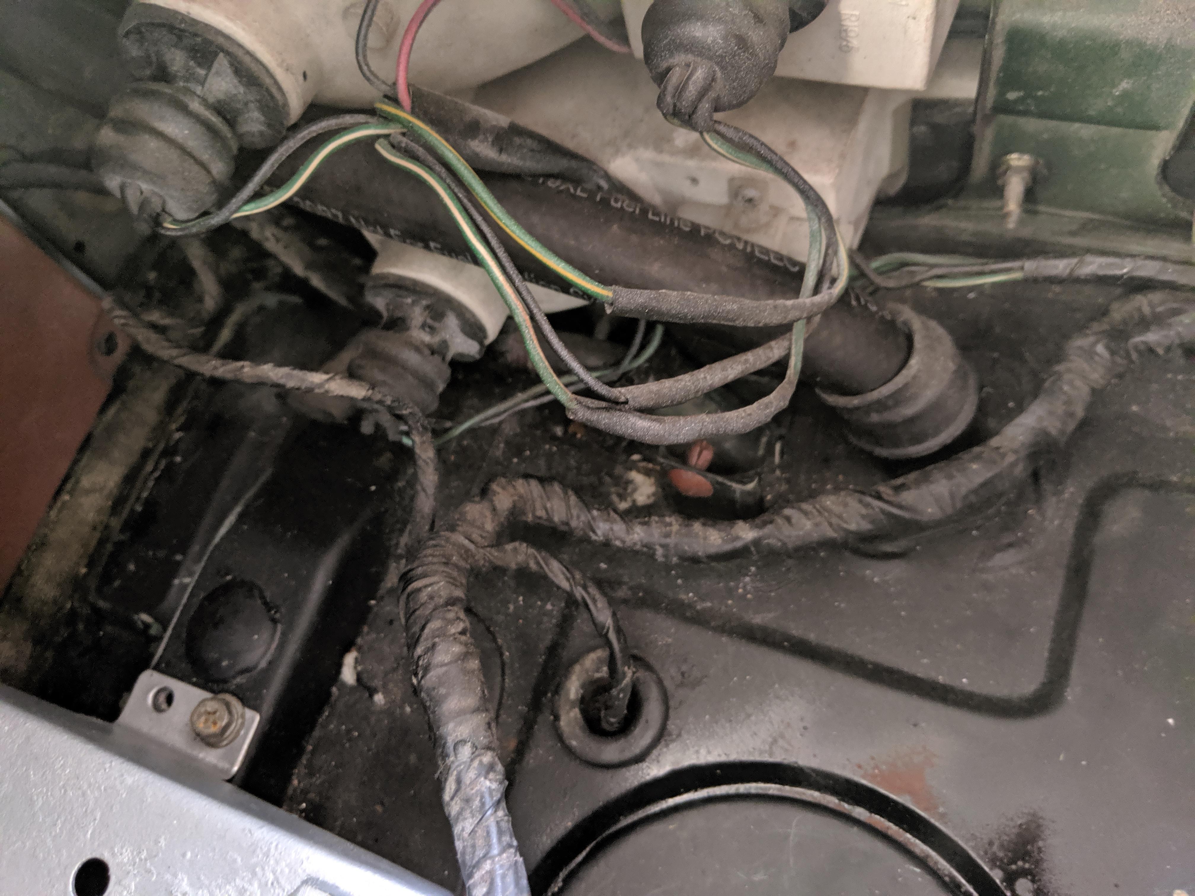

Is it me or does this taillight harness appear to be spliced? (black heat shrink)
This evening I disconnected the reverse switch to isolate that and it died with the left turn signal. I could hear the ignition relay clicking on and off with the blinkers. At this point I know of two instances where the left turn signal has killed the car not sure on the right turn signal.
