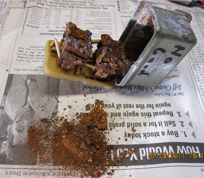

The 280Z's have the relay in a bad spot.  Gets wet if there's a leak.  They're easy to take apart, just bend the crimped lock tabs back and pull the cover off.
