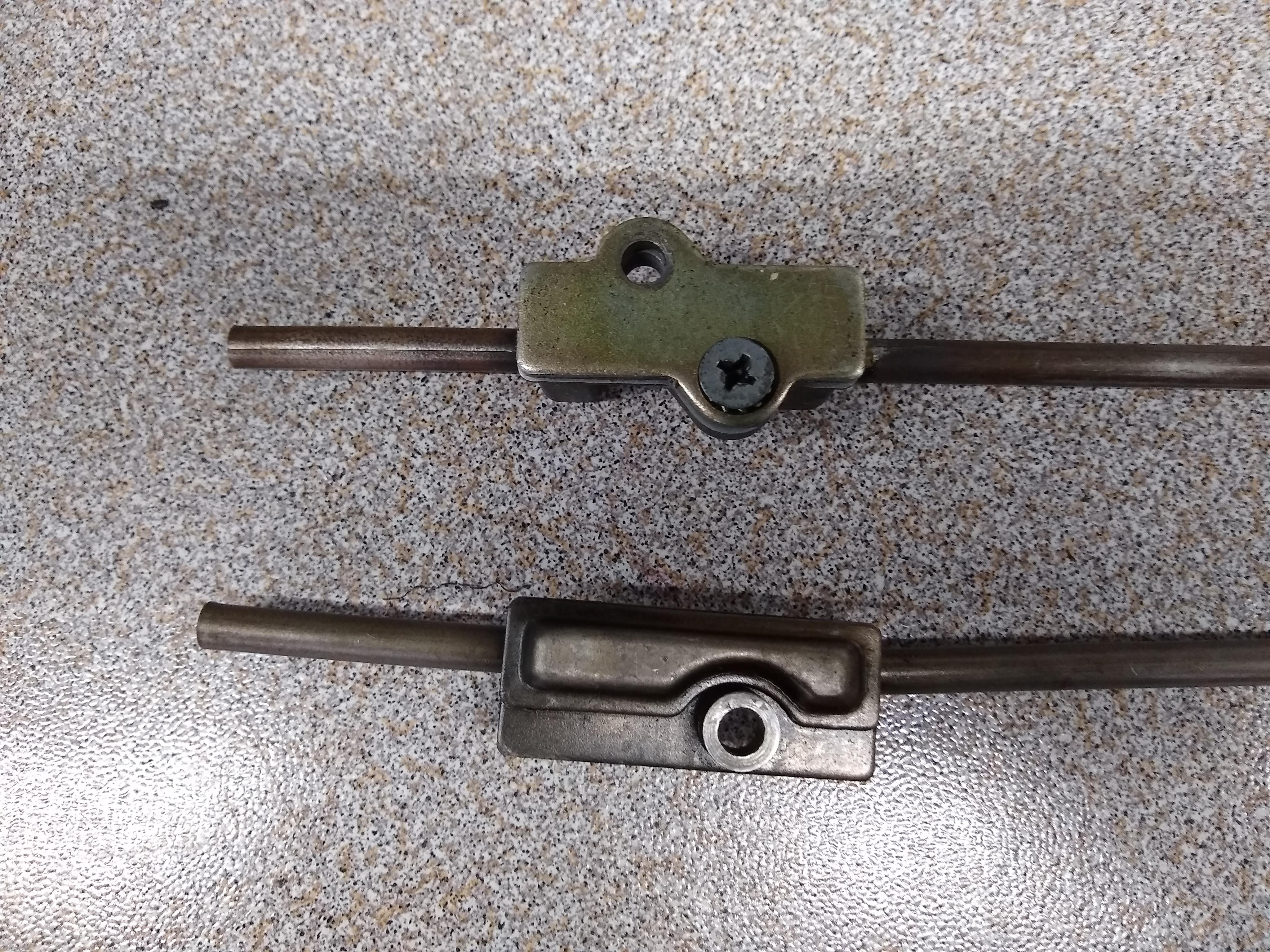

The link below is for the newer style Nissan oil spray bar. I know I have seen it on 75 and 76 280Zs. Not sure when it first appeared. I have seen it cheaper but like anything you may need to wait to find it cheaper. In my experience it is the early spray bar that is prone to failure.
https://rover.ebay.com/rover/0/0/0?mpre=https%3A%2F%2Fwww.ebay.com%2Fulk%2Fitm%2F173949822218

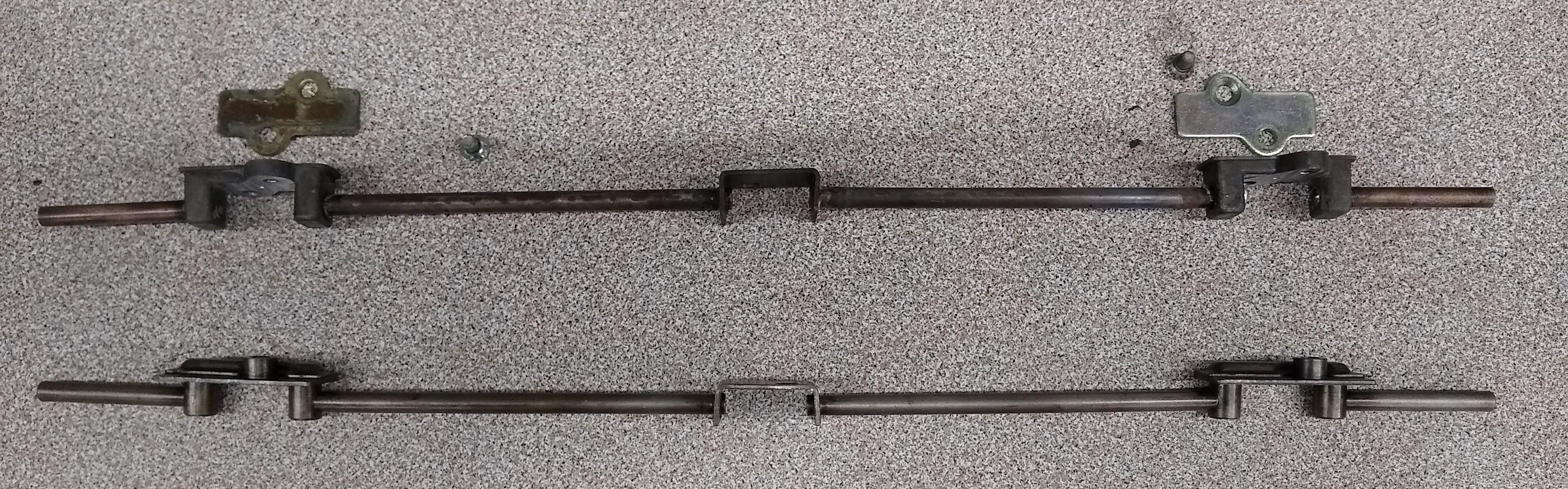

Mine is a 9/72 JDM FZ-L it had the top one on it. However it was broken, one of the pipes connected was loose. The the car came with a spare but it was also broken.
The casting quality on the junction sections is quite poor, I ended up machining the faces flat (with a router and a jig). I tried to resolder the pieces. Reasonable / workable job. However someone gave me one of the lower ones. May use that instead.
The symptom you are describing is consistent with the flaw I have seen with the older one. The soldered joints become loose and then the pipes move around, fall off, etc.
I would use the newer one.
Agree with Jonathan, newer is better.  I made a mistake above, my '72 came with the Phillips head screw type.  It has a newer style that I pulled off a junkyard '75 280Z now.
