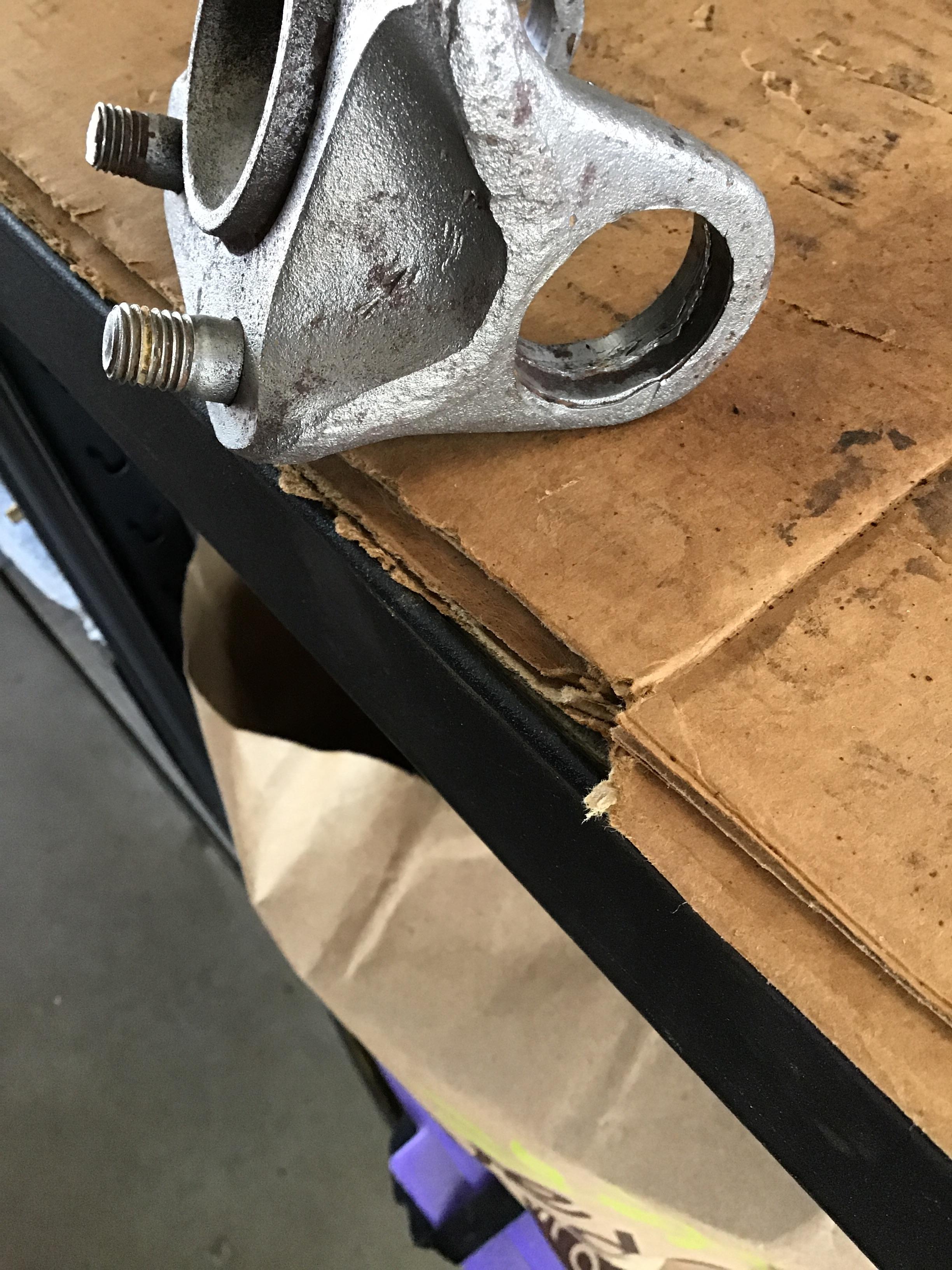

Does anyone have (or know where to buy) a rear axle flange for R180?
Looks like the PO tore it up on install.  Thinking about it, maybe I tore it up on removal, but don’t think so as I use a press and all other are good.

What is torn up about it?  Do you think the cap won't fit correctly?  If it's solid in the hole, the clip fits the cap on the inside.  The outside of the yoke can be pretty ugly with no ill effect.  It's the inside surface that really matters.

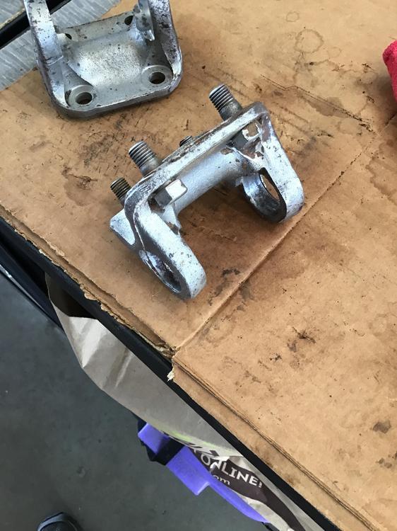

It's the inside on one of them.  I tried to capture it in the top picture...the inside gouged and rippled up.
