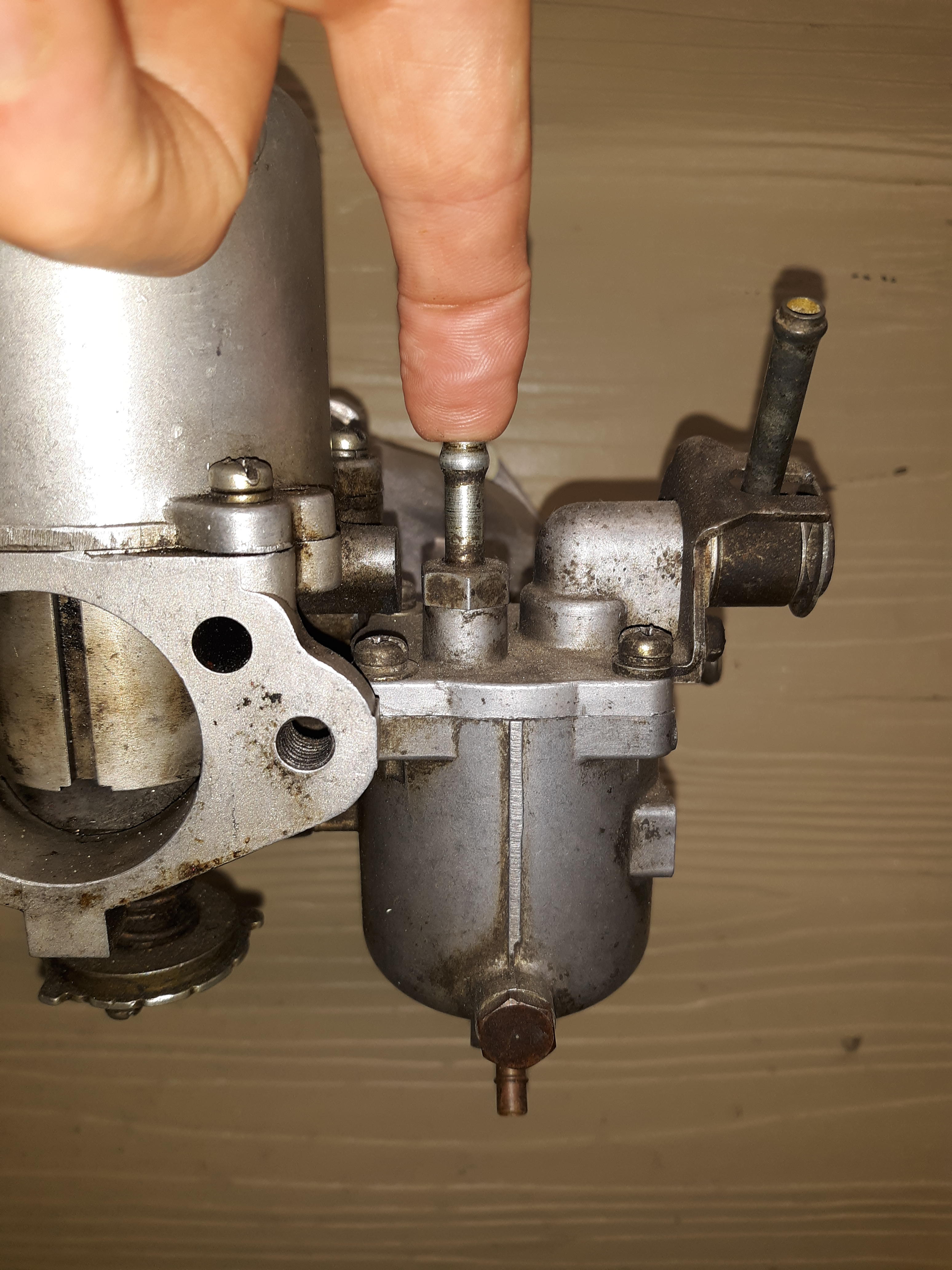

 "I've read on here where cars that sat needed fuel poured into the overflow bungs to get the floats moving up and down maybe unsticking the fuel valves? If you get the float chambers full of fuel at least it would run for a little longer than ether. "  Where are the overflow bungs /float chambers?
Pour gas down through here and fill the float chambers. I call them chambers but they're float bowls too. When you get them full try sticking a wd-40 red straw down and see if you call feel the floats moving up and down.
