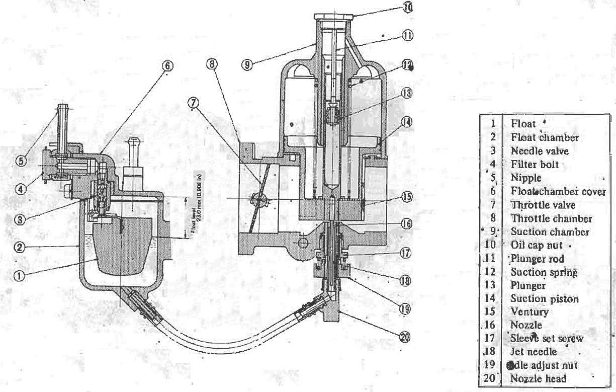

The fuel valves above the floats can and do get sticky/stuck after sitting. I've bought new ones, to me, that were. My thinking was if those valves aren't opening your fuel has hit a dead end. By filling those bowls the floats should raise and move the needles in close them off. BUT poking the floats with the straw should get them to bounce like a fishing bobber and move those needles. The floats are so close to the wall the straws movement will be minimal, maybe up and down a quarter inch?

Next I filled both float chambers (I had to order a squeeze bottle that holds fuel and the tube went over the nipple perfectly. The bottle is used for filling RC cars). While I was at it, I filled the fuel filter since I had the line disconnected, figured it wouldn't hurt to help with the priming. I used my wd-40 plastic tube and pushed the floats. They bobbed up and down with no problems. Reconnected the fuel lines hoses and the car started up perfect and runs perfect!!! So I don't know if the floats were stuck and were freed up when adding the gas thru the nipple or if there was just an air pocket in the lines.
Thanks everyone for the help and Cliff, great photo and descriptions. You made it real simple for me to follow.
