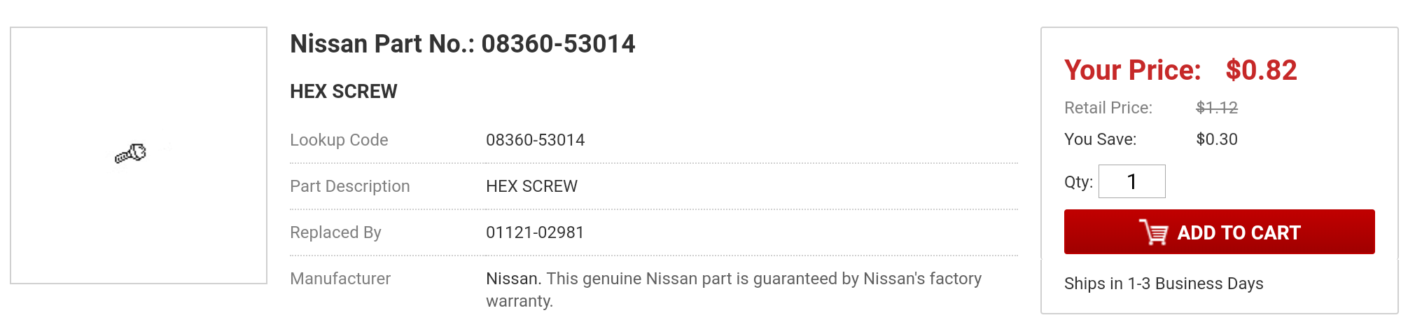

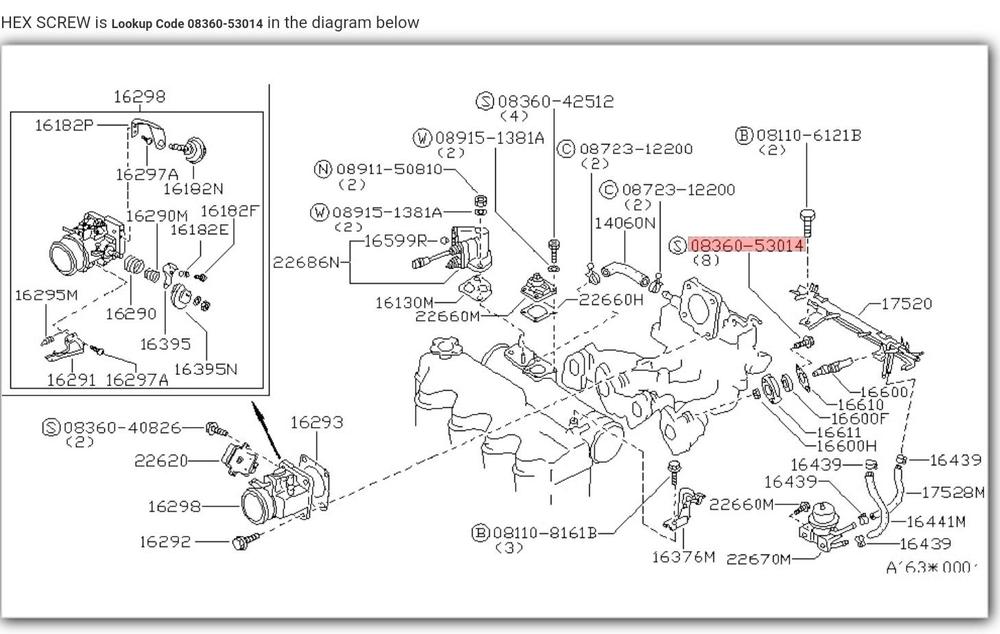

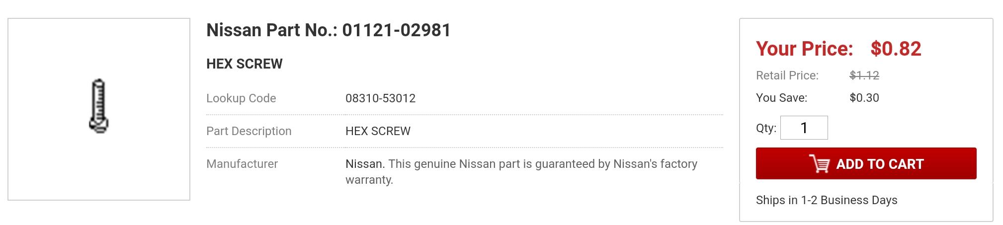

You can order the hex head bolts through your local Nissan dealer. I paid €0.68each two years ago.
The part number has changed a couple of times which makes it harder to find.
P/N: 08360-53014 or 01121-02981
I don't mind ebay sellers trying to make a buck by parallel selling. He is not too over priced ($14 to Nissan $9.85), but it's the shipping we have to pay to get it to Europe that bugs me.
