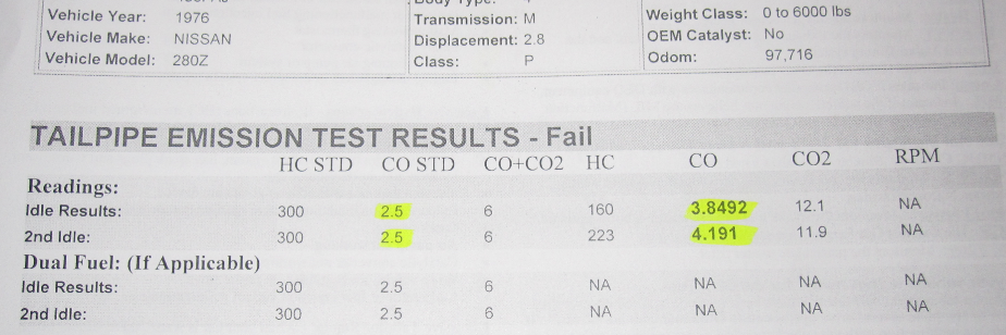

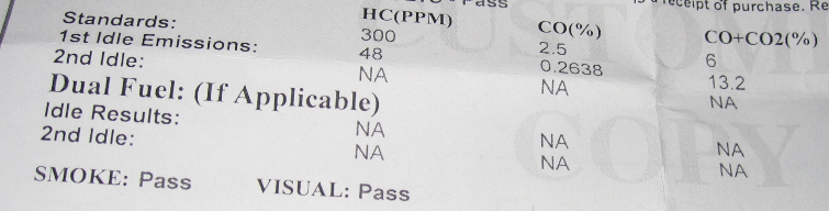

March 26, 20214 yr comment_618629 Here is one of my old emissions test in Oregon. It's idle only. What's weird about yours is that the CO is low but the HC is high. I seem to remember that if you had incomplete combustion your CO should be high also. I wonder if your problem is oil related and not fuel. Maybe leaky valve seals or rings. You might give it a good "Italian tune up" right before you go in to warm up the seals. Fail on top, then Pass, below. CO was the last thing i had to get tuned in, which I did by the idle air screw and lowering fuel pressure. They change the format for the printout, sideways for a Fail, up and down for a Pass. You can see that as I leaned things out the CO and the HC both dropped, but the HC was already okay. HC came in first, then CO. Or, as I think about it, the other possibility is an ignition miss. That produces only HC since there is no combustion at all. That actually seems more likely. CO shows combustion that started but did not complete, HC shows no combustion. Full combustion should convert the CO to CO2. With an ignition miss the gasoline (HC) passes right through along with the oxygen that is supposed to combining with it. Just thinking in print. I'd check those plugs and plug wires. Link to comment https://www.classiczcars.com/forums/topic/62758-failed-co-emissions-all-controls-removed-where-to-start/?&page=19#findComment-618629 Share on other sites More sharing options...
