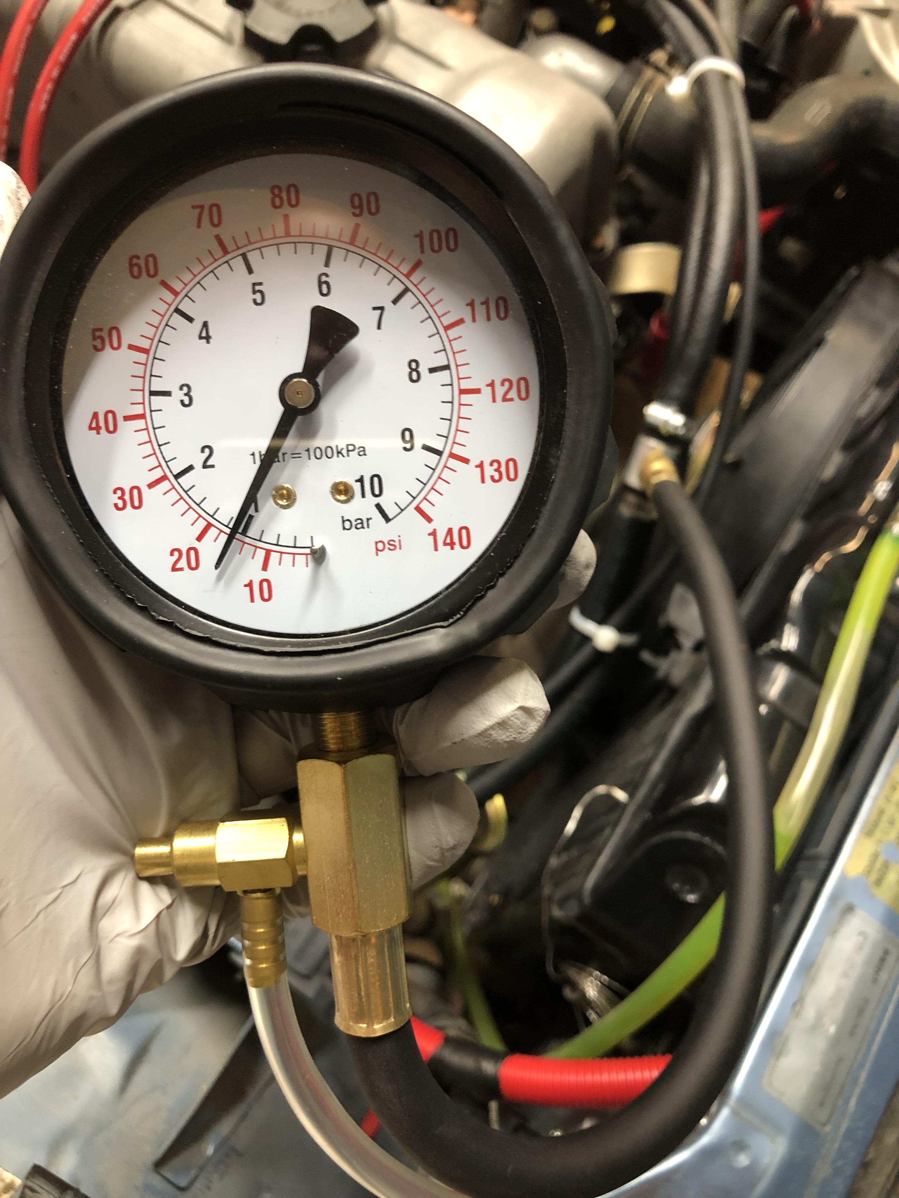

But I did receive a fuel gauge from Amazon yesterday. Put it in place of the Jegs inline fuel gauge and tested again. Got similar readings as before, and nowhere near 36. With the Begi fuel regulator hooked up, it sat at 10 psi. With not vacuum to it, fuel pressure was 16.
Will send off the injectors this weekend and hopefully get some answers on that next week. But fuel pressure doesn't seem nearly what it should be.

The pressure reading is actually great progress.  The numbers are the most important part of working with EFI.
You're at a point where you can calculate a cheapest path to where you want to be.  Find the atlanticz.ca page about calibrating your AFM and see if it has been messed with.  It might be most cost-effective for you to just buy the right injectors and calibrate your AFM.  If you send your injectors out and they're high flow rate you'll need to buy new ones anyway.

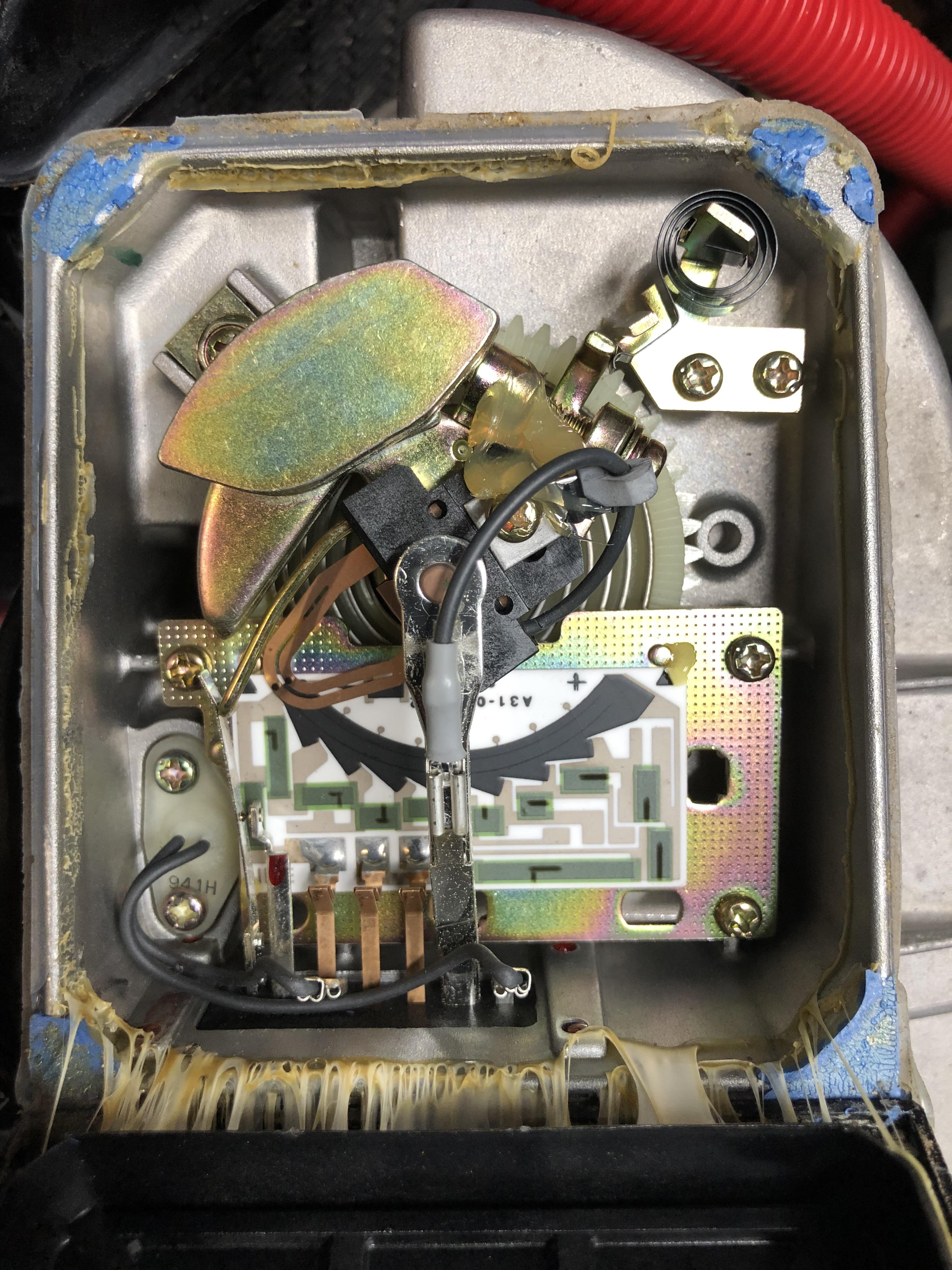

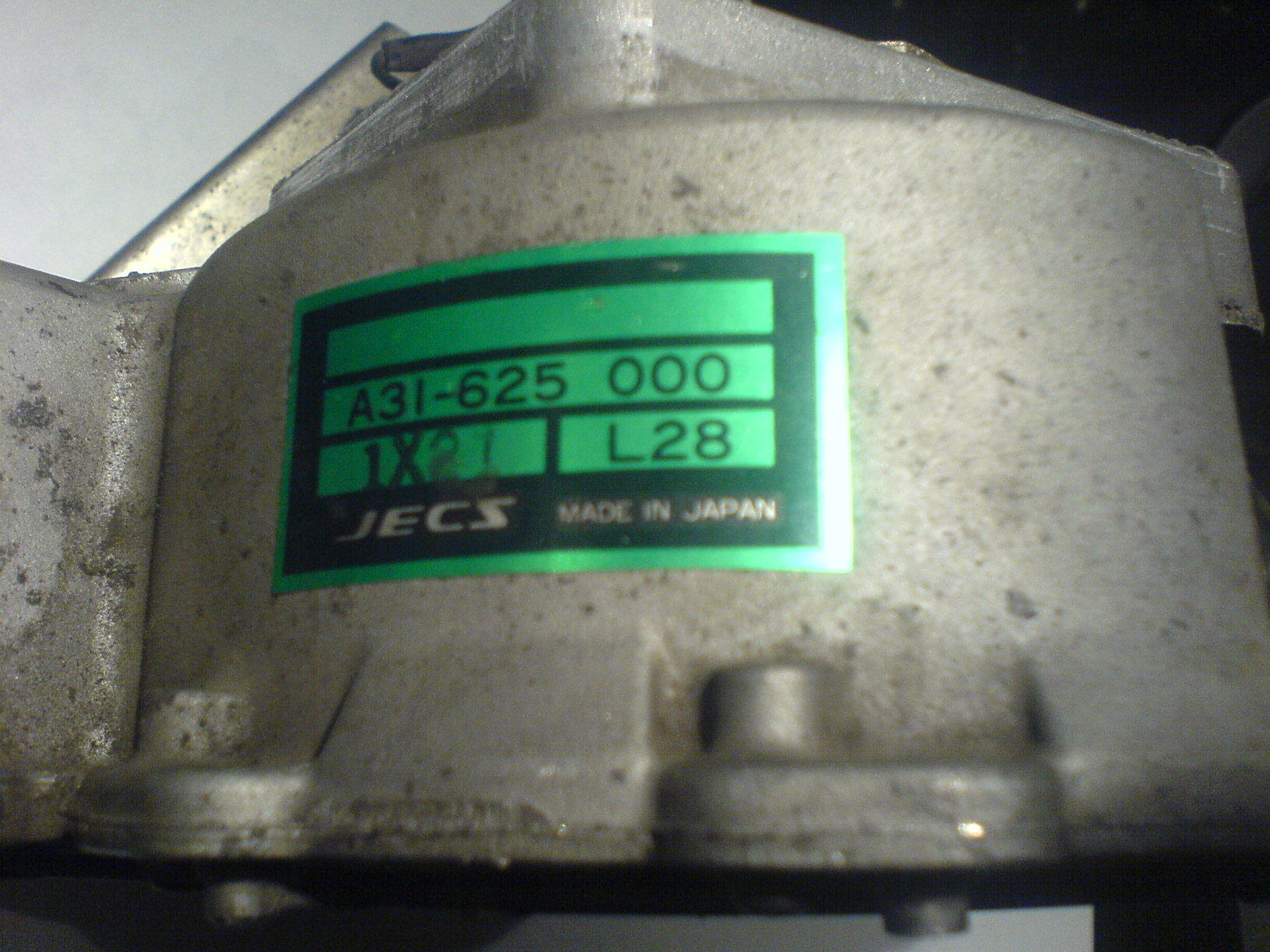

Have been reading through the AFM documentation, then went to the car. The AFM is not original. It's from JEGS. I can't find anything on their site with the model number on it (A31-625 000), but it seems to be listed for an L28 and there's some faded marker on the body that looks like it says 280ZX.
The cover was sealed, but popped with a bit of a pry from a screwdriver. Inside, it doesn't look exactly like what's in the documentation but is close enough to work on. Glue blob is intact and I can't see where it's been adjusted. I'll go through it in much more detail, but just doing the quick fingering check, moving more than about a tooth in either direction did bad things to idle. I'll dig into the tests and go through the other suggested checks from the document when I get more time.
That AFM has been messed with in the past. Don't know if it's been adjusted, but that cover was definitely removed and reinstalled in the past. The glue's wrong.
That said... Other than trying to verify that it's the correct AFM for the system, don't spend any time worrying about adjusting it right now. That would be one of the last things to mess with. Get the fuel pressure correct and tracking intake manifold vacuum first, Fix the PCV routing so you aren't pulling huge amounts of unmetered air. Get the AFM mounted properly so gravity has the correct effect. Search out and fix any other vacuum leaks in the system.

If the glue blobs were intact after you removed the cover then leave it where it was with the intact glue blobs.  Never adjust it.
The procedure I linked to is for getting it back to where it is supposed to be.  The AFM should never be adjusted from its factory position.  There are better ways to tune the air-fuel ratio.

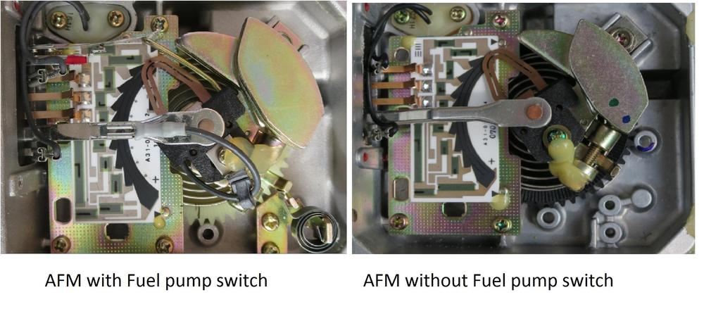

It's a standard looking 280Z pre August 1977 AFM. Definitely not 280ZX. You can tell by the contact switch for the fuel pump. I have one with the same part number.
They produced a lot of part numbers for the hole sries, but essentually you have two types for the non turbo model. With and without switch.

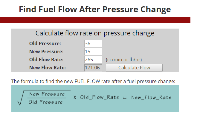

I used an online calculator just for fun and it comes up surprisingly close to "turbo" injector for your measured pressure.  Assuming that the 188 cc number is at 36 psi. Some flow rate charts aren't clear on what pressure they measure at.
