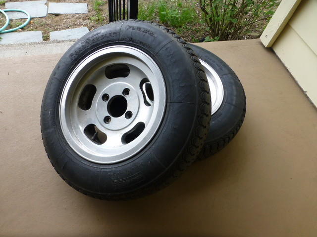

There are lots of 5-slots out there, and they're still reasonable affordable. The problem is finding the exact wheel. Many different versions of the 5-slot are out there. My Z came with two from one brand, two from another, and the spare was from a third company:
I think you have these
This style has more negative offset, and no raised disc at toward the center
If you want to find a replacement, write down all the markings on the back side, get the width and backspacing/offset measured, and learn how to spot the minute differences between the brands. I'm sure you'll find one.
