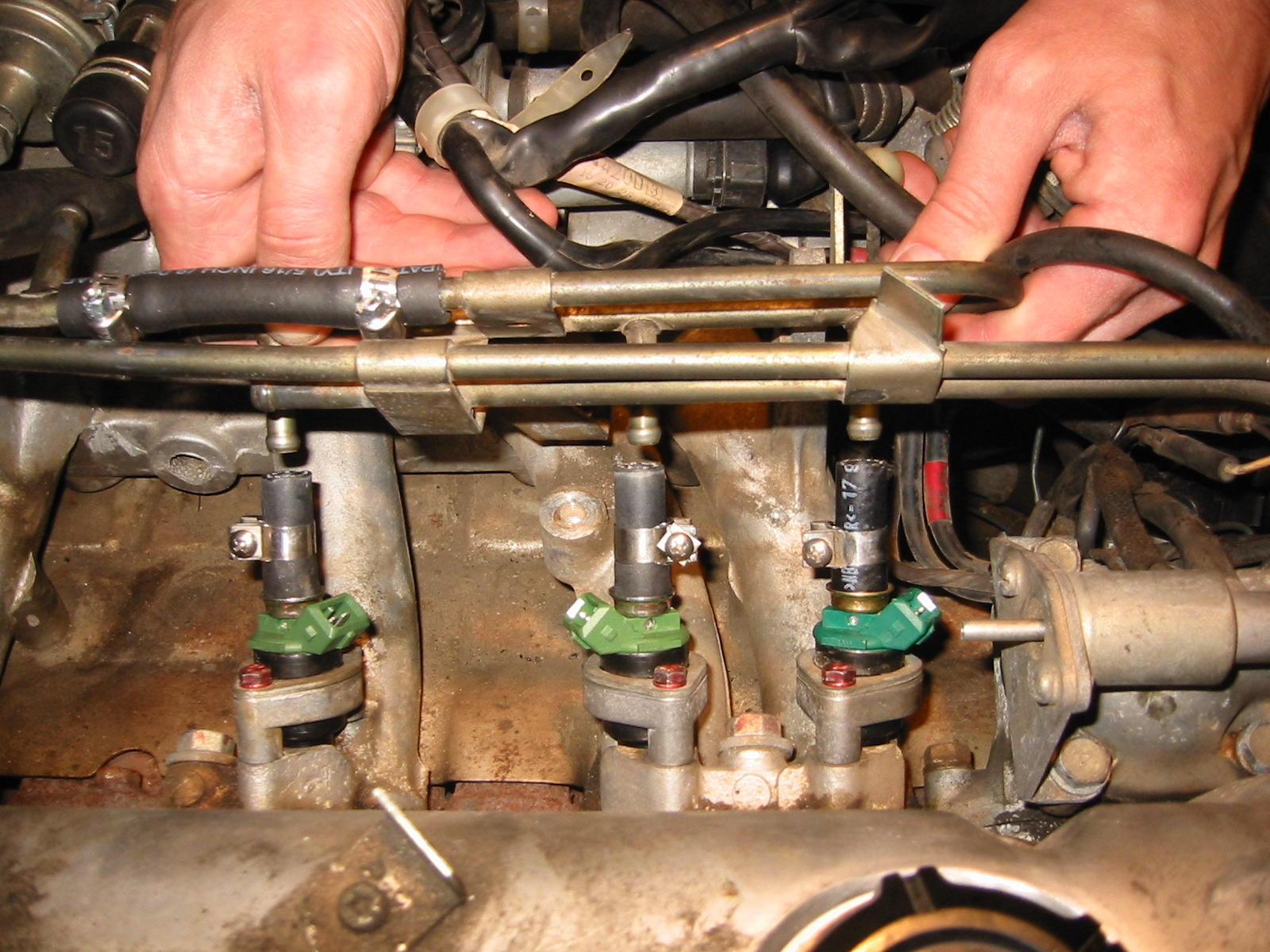

I received a donor 280z many years ago.  I had very strange problems until finally replacing the fuel injectors and soft fuel supply hoses.  The old hoses can deteriorate if left sitting dry for so many years and pieces can get stuck in the injectors.  If you do buy new injectors, I recommend replacing all of the fuel supply hoses (from the fuel filter to the engine) before you make the investment.  The fuel line from the tank to the engine isn't as important (until later) because the fuel filter should catch any debris that will clog the injectors.
Here are a few pics of my install:
