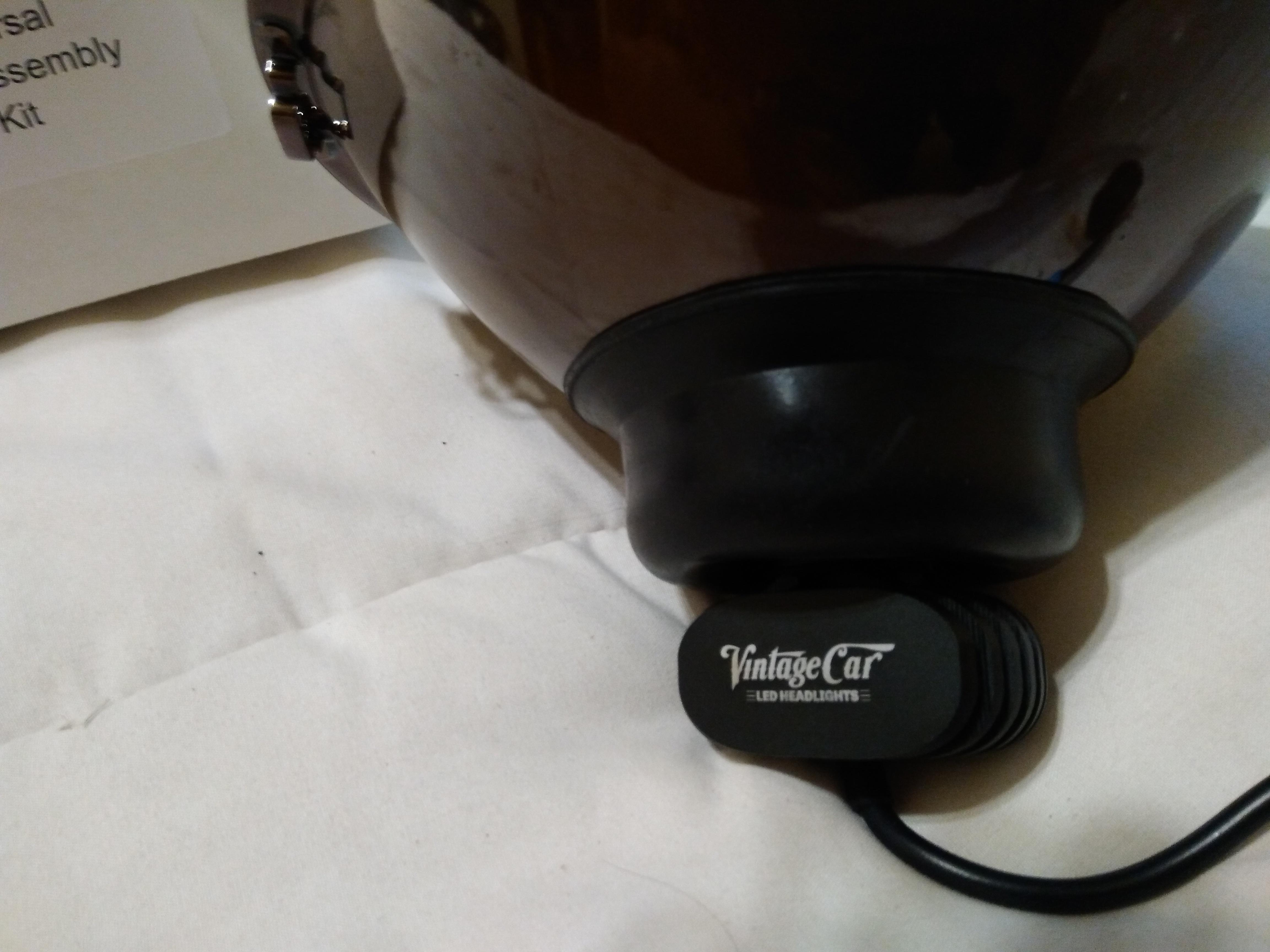

For the longest time, I have watched the evolution of the Led 7" round headlight technology and recently decided to upgrade to a set that fairly well mimic the look of the stock glass sealed beams at a reasonable price.  I did not want the projector Hid look, too high tech looking, plastic, fan cooling, or a blue light hue.   The set I found was from Vintage Car Leds who aim their products at the customer who wants the oem glass look with the advantages of Led bulbs.
I chose the 3500 series of their lamps which are moderately priced, and appeared that with the bulb (4000 LM) / heat sink installed (no silly fan) would fit in the confines of the S30 housing.

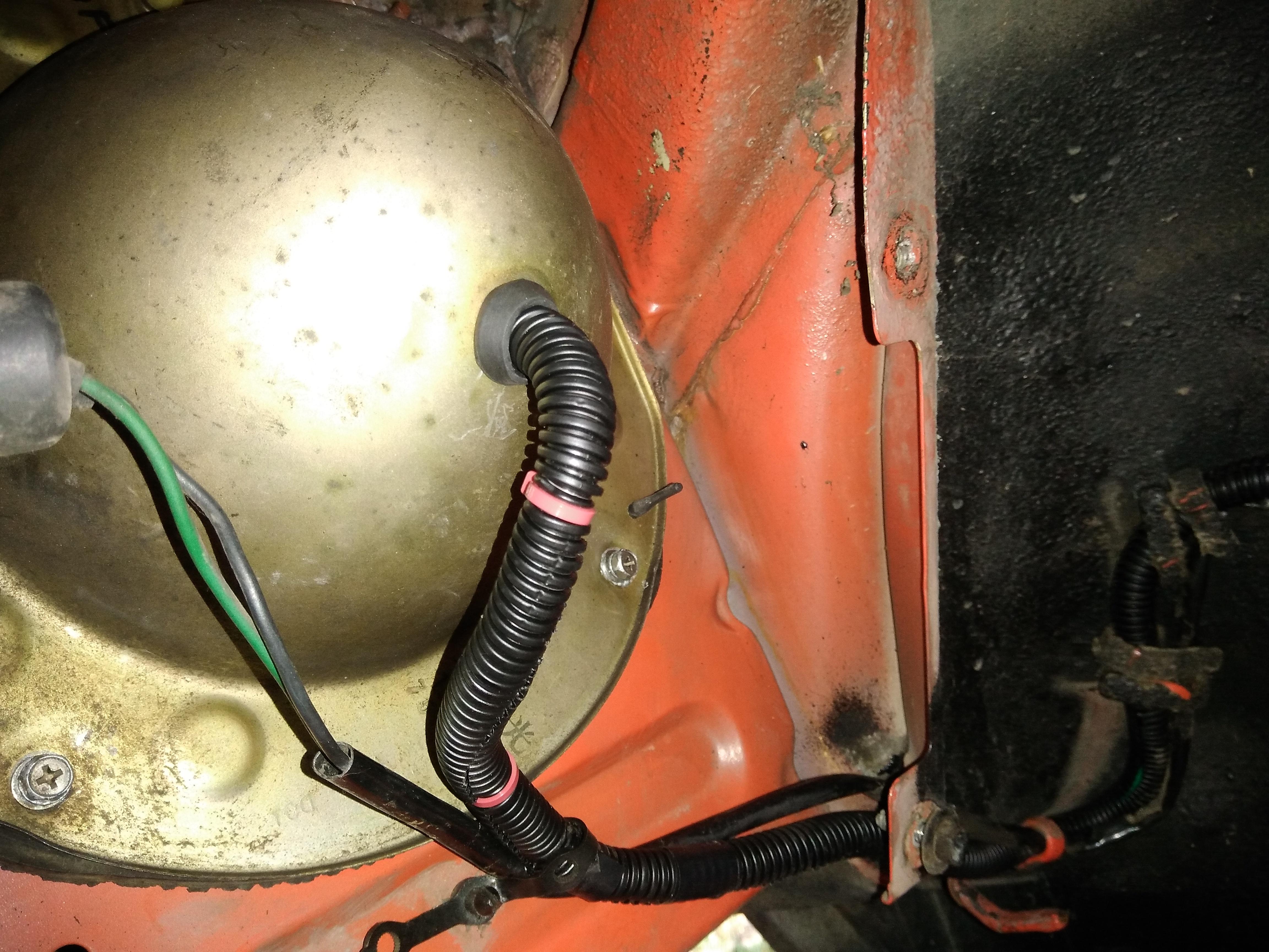

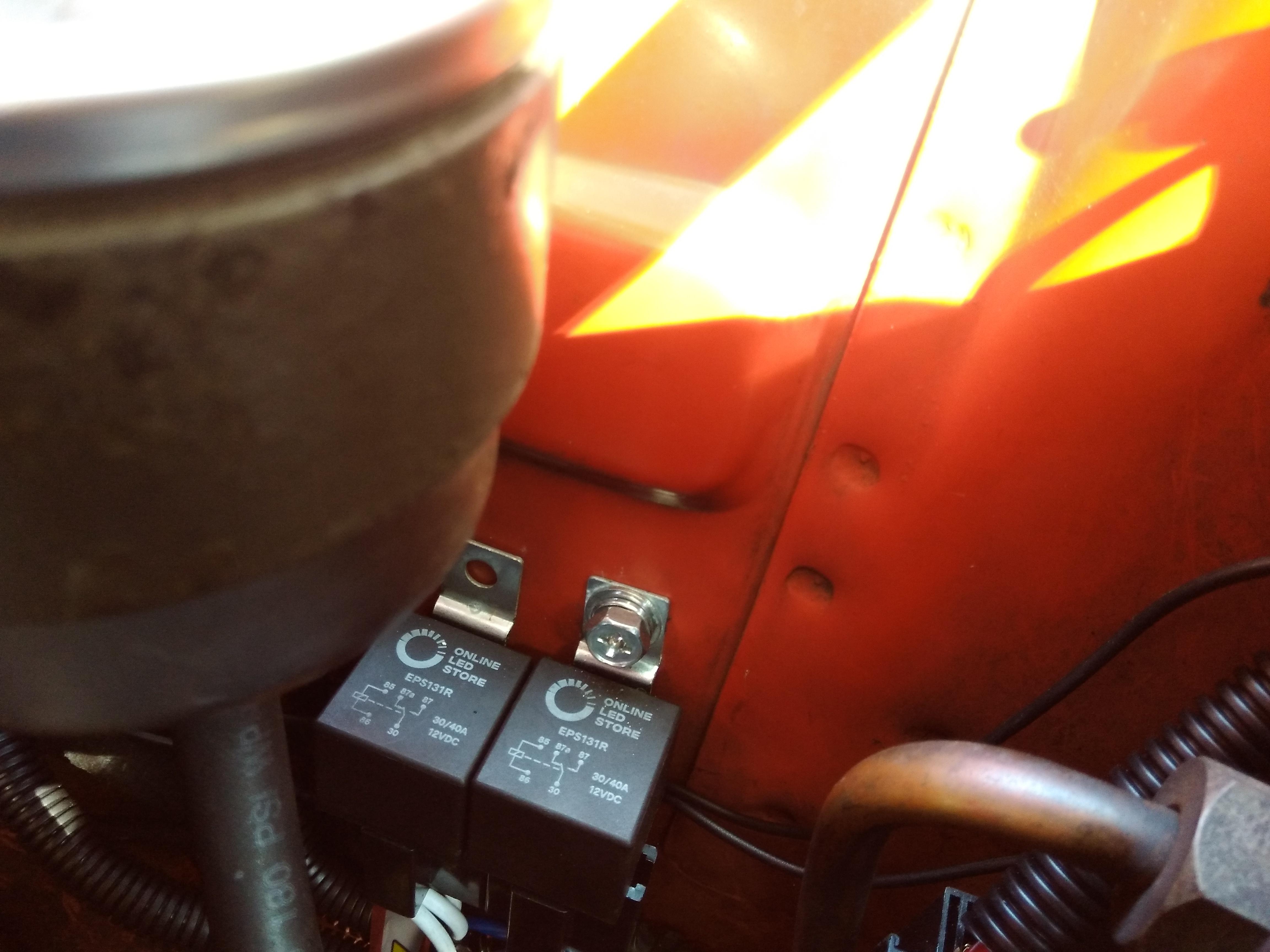

Of course as many are aware, Nissan and many other Japanese auto companies use negative switching of the ground side of the headlight system, the Led's expect the positive side to switch.  That being said & with Dave Irwin no longer an option to supply the 240 kit (easy to adapt to the 280 style round connectors) I decided to build my own high quality negative switched harness.   I did not want to hack the oem wiring, so I replaced the lighting harness all the way to the headlight buckets.
I used real 12 gauge copper wire for the main power source and 14 gauge on the heavy lifting side of the relays feeding the headlights.  On the low current trigger side from the combo switch to the relays is 16 gauge.
My main intent was to make everything reversible without any modifications should the day ever come to put the system back to factory spec.

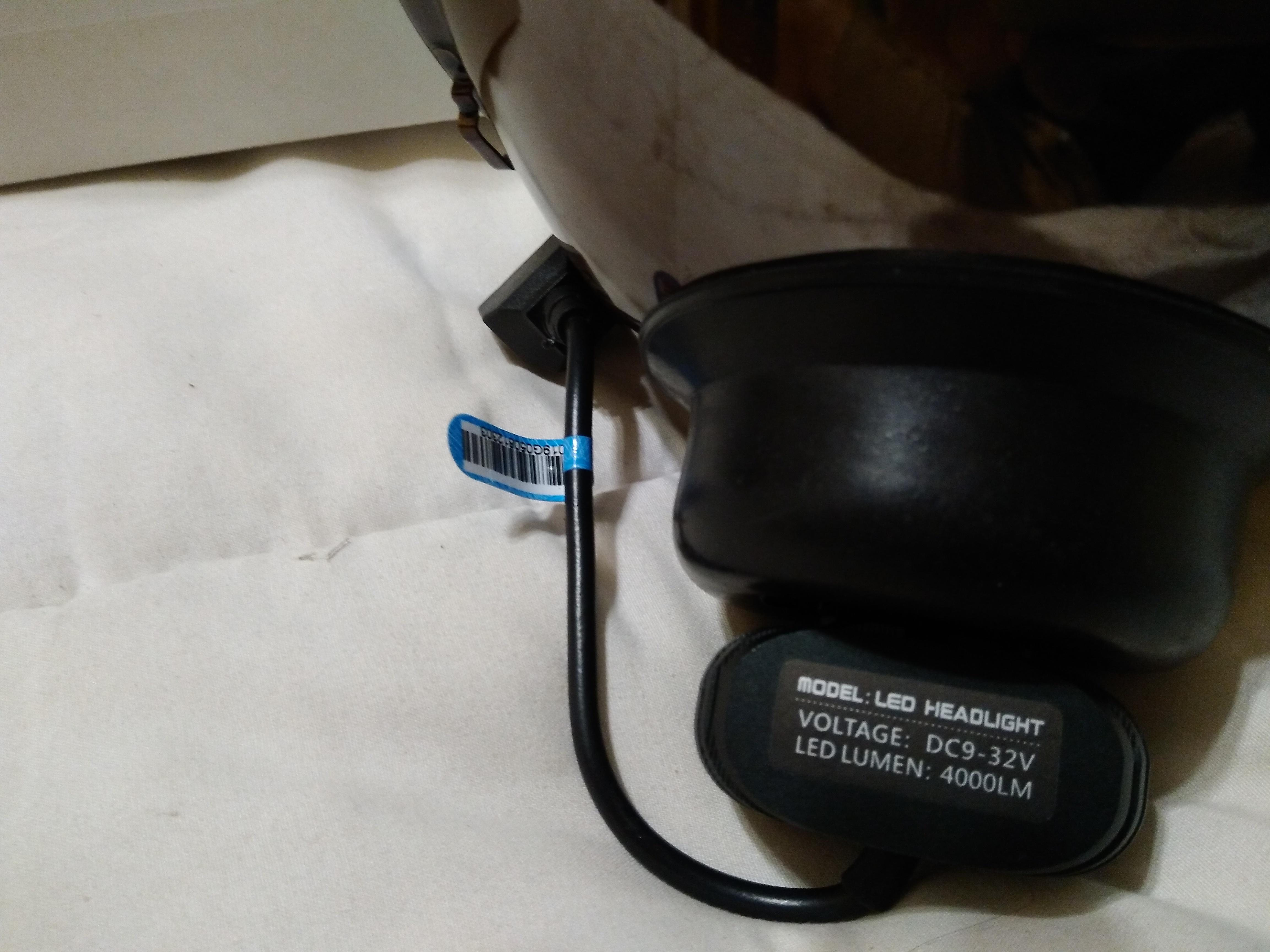

The headlight assembly fits in the stock housing and its inside bracket but its a close fit,   I tried using my bore scope camera thru the bucket grommet hole but could not get a worthwhile picture as it is difficult to maneuver in there.  Looked to be about 1/16" clearance.   The one gripe I have is that the pigtail from the bulb exits at the back of the heat sink, wish is was the side to provide more clearance.  I also upgraded the headlight plug connector to a more heat resistant porcelain type.  This plus into the pigtail from the Led bulb.

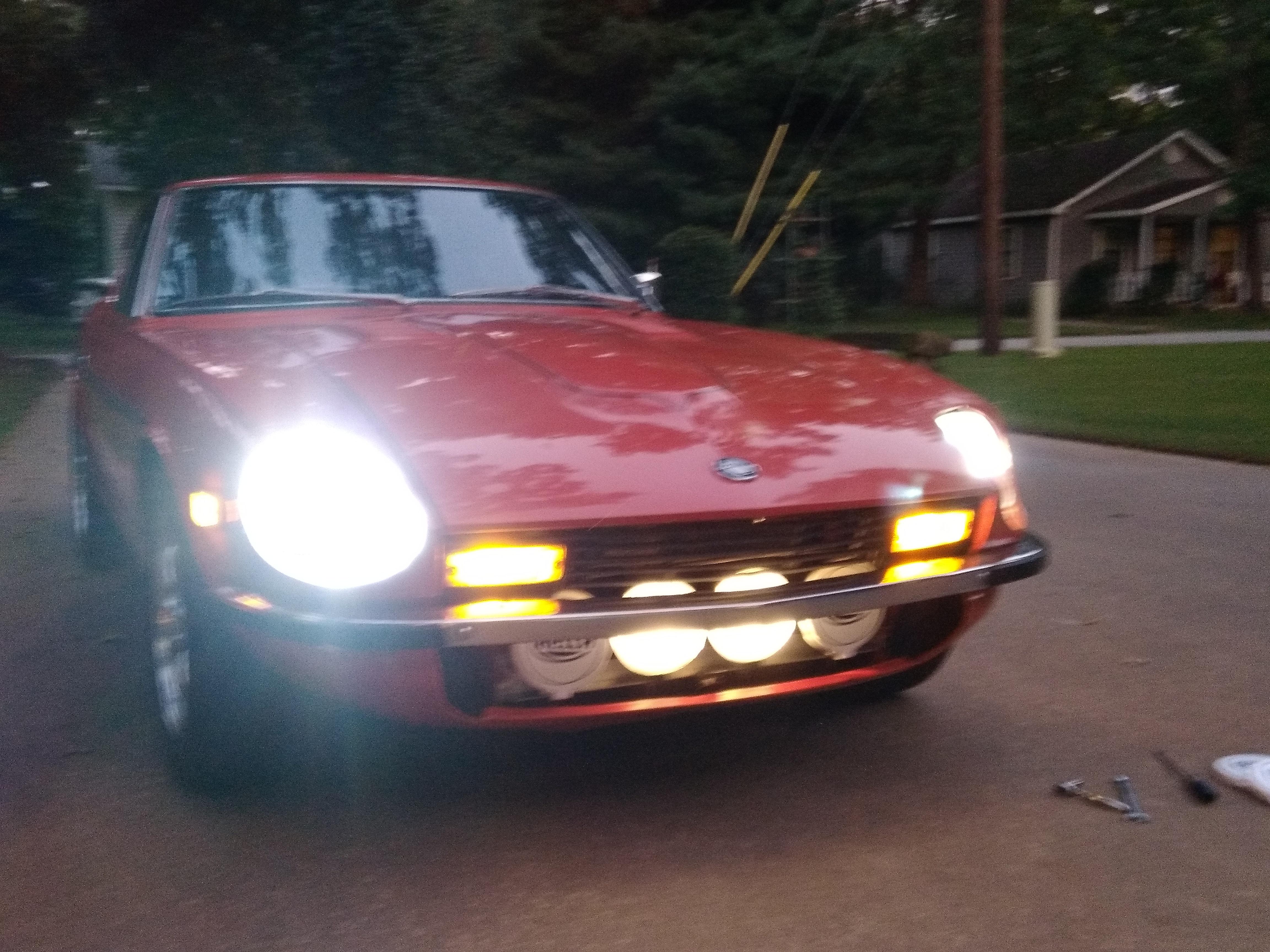

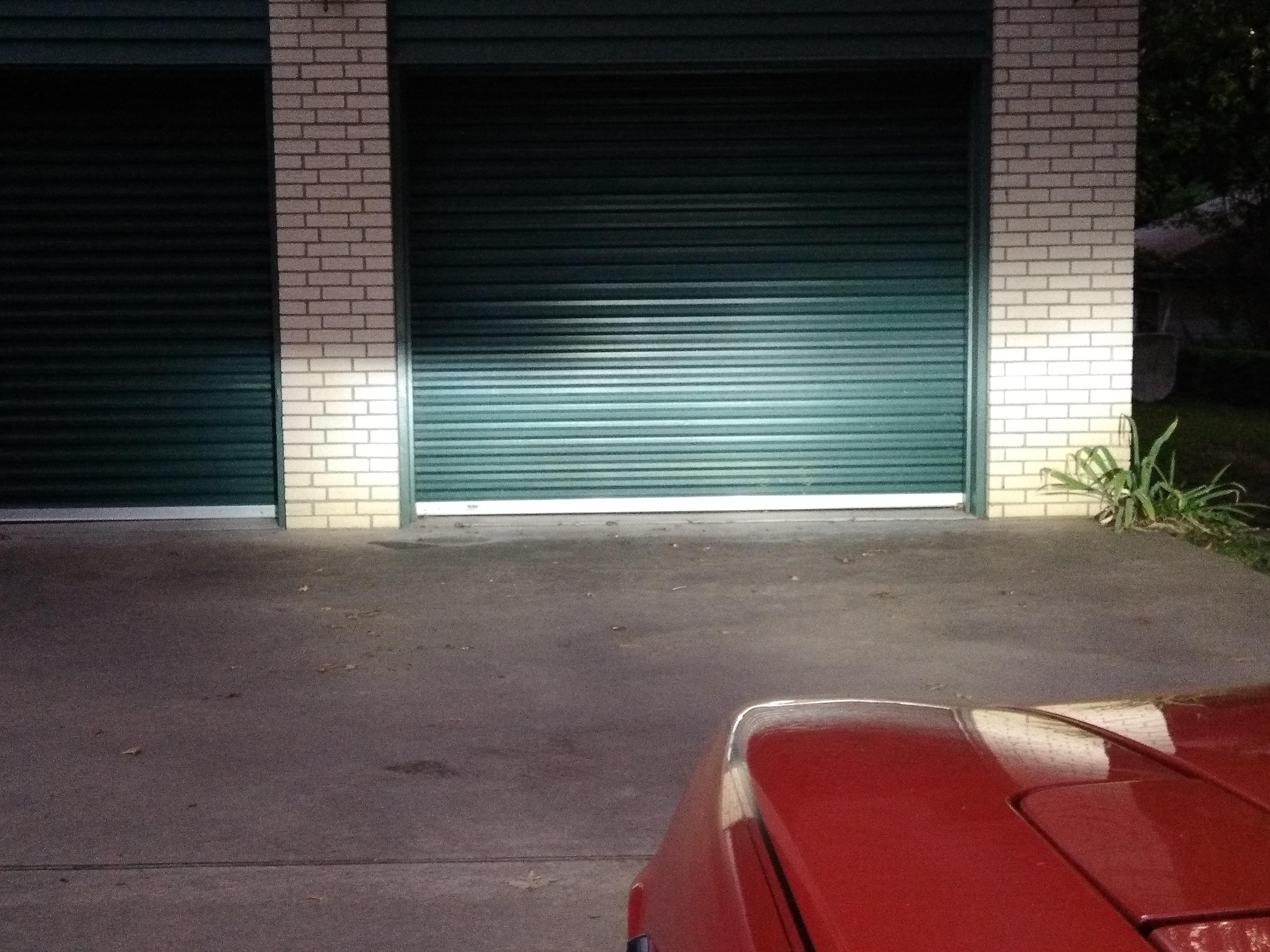

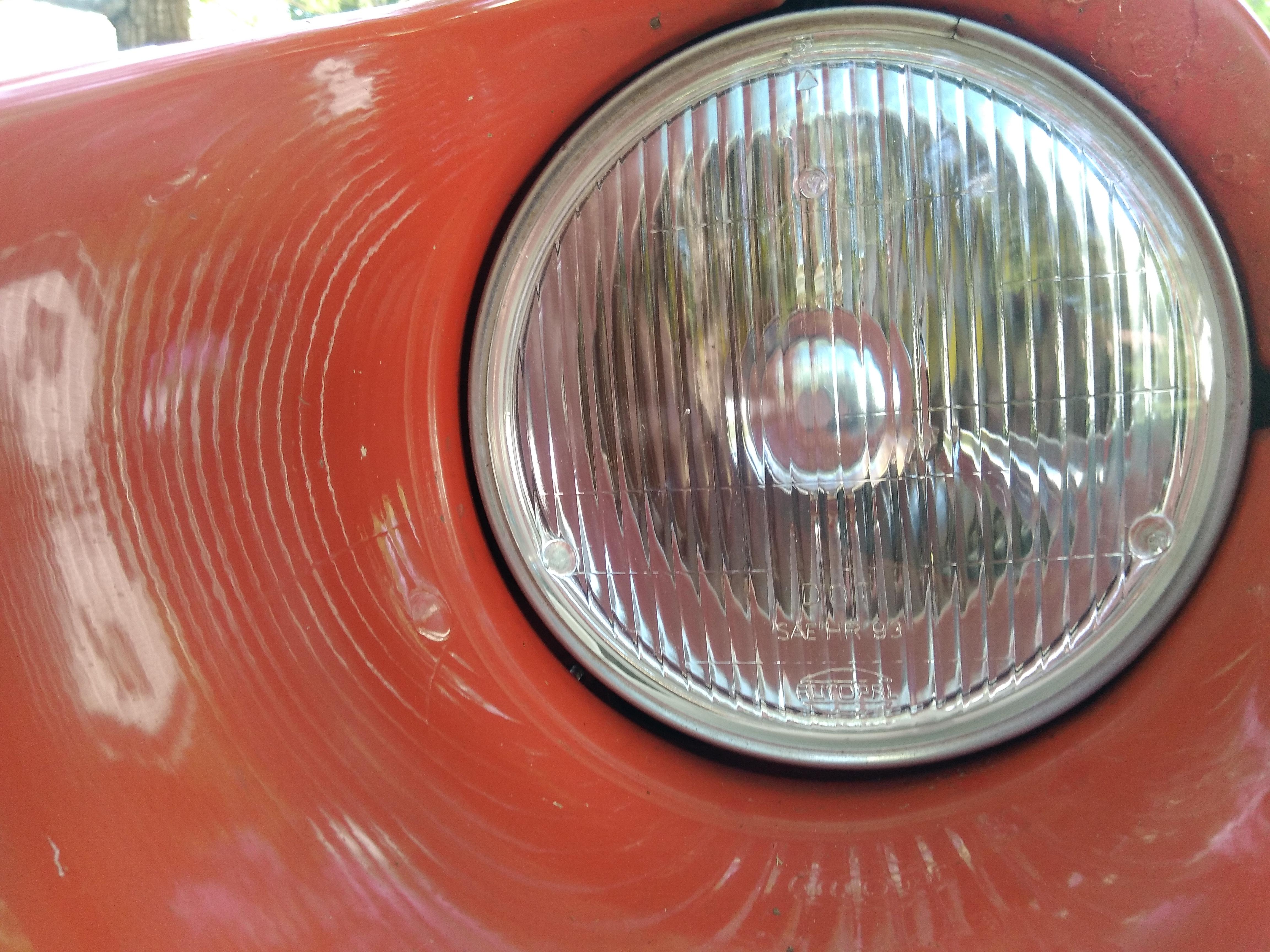

The upshot of all this is ........ a dramatic change in usable light compared to the sealed beams without blinding oncoming traffic.  Also,the very low current now thru the combination switch,  I was saving a nos combo switch that I just installed which has never seen full load current - it should last a very long time.
Impressed so far,  will try to get some action pictures driving after dark,  but so far - highly recommended.
Vintage Close.jpgVintage Led1.jpgvintage Led2.jpgVintage Relays.jpgVintage bucket.jpgVintage Alignment.jpgVintage Off.jpgVintage w fog.jpg

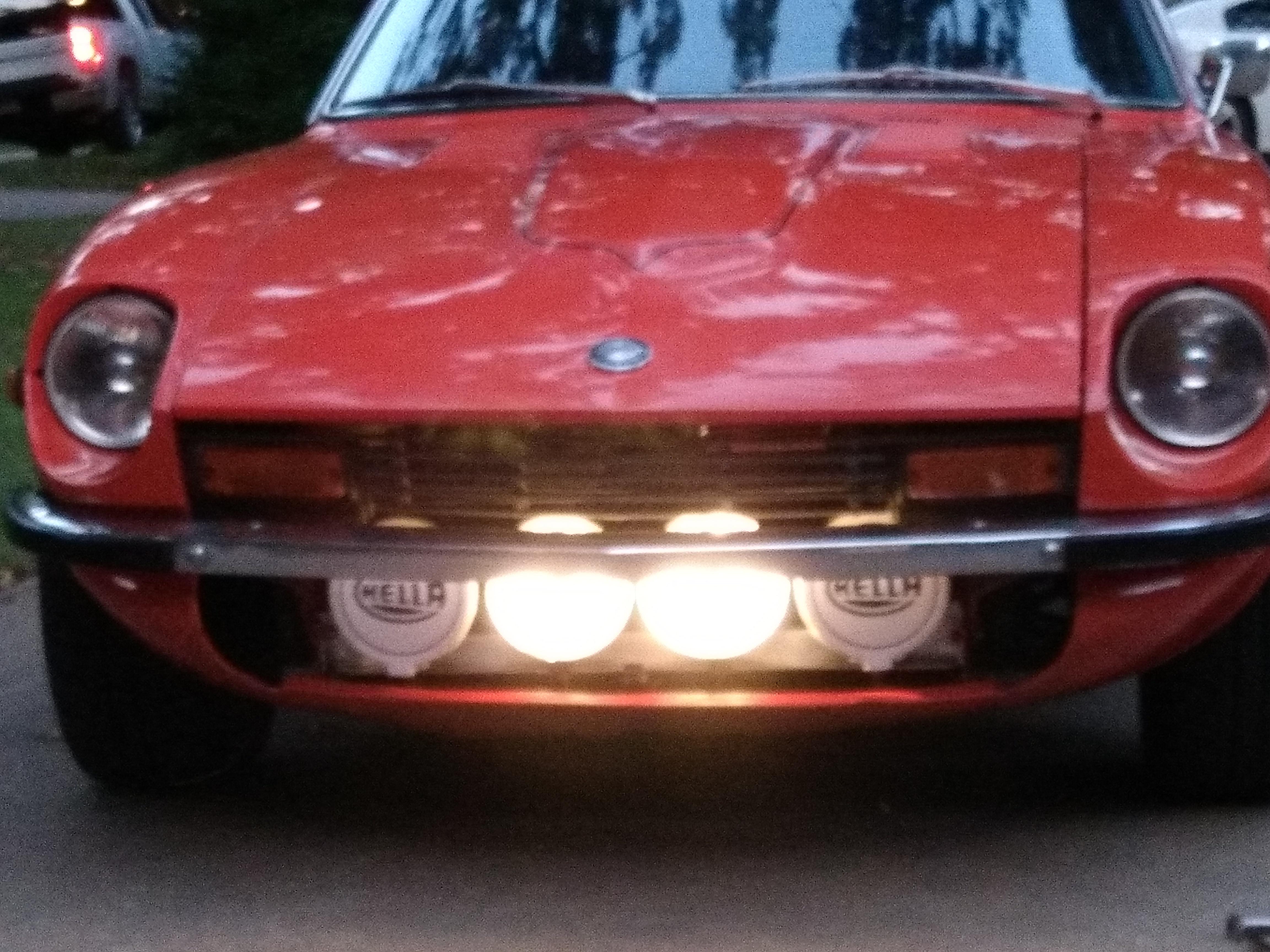

In other news .... I am playing around with the fog / driving lights as a inexpensive solution to fill the gap below the 240 bumper.  Its still in progress, a fun project, will notch the fabricated bar I made to clear the lower grill mount and get them about an inch or more lower.  Again, all factory mount holes were utilized, including relocating the horns.

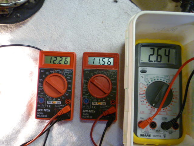

Here's the best I could come up with... Three meters at the same time. One measuring voltage on the battery terminals. Second measuring bulb voltage right at the back of the bulb. Third measuring current draw of one bulb. Here's an example from after I finished my headlight relay upgrade. Both bulbs are lit, but measuring one side.
Voltage measured on the battery terminals while under testing load (two bulbs lit) = 12.26V
Voltage measured right on the bulb prongs of one bulb = 11.56V
Current draw of one low beam bulb = 2.64A
This is low beam:

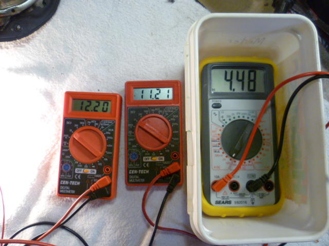

And this is high beam:
If you go through the math, I'm consuming about 30W per side on low beams and about 50W per side on high beams.

My total current draw on low beams should be approx. 5.3A (doubling my 2.64). And that's with relays installed which should increase the current because the system drop is lower. Questions are... 1) Did you have relays in place when you took your reading? And 2) What was your system voltage? (Was the engine running at the time?)
