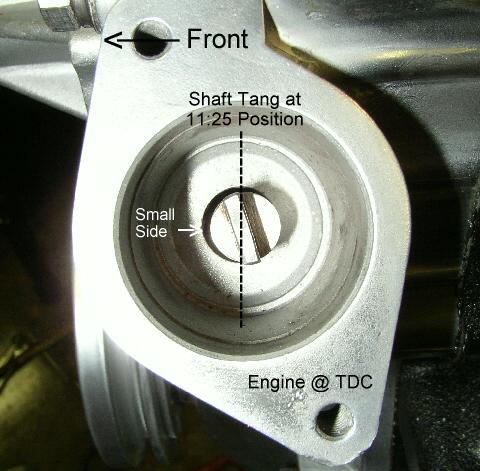

The distributor is at its limit of adjustment. Is it possible/recommended that I remove the distributor itself and move it by "one position" to fix the problem and get me back to the right range where I can make timing adjustments just loosening the distributor cap and adjusting?

If that's in 4th gear I'd leave it be. Pretty good numbers imo. But you could set it at tdc and remove the distributor and see where the spindle is. Should look like this...

Make sure that the rotor is actually pointed at #1 wire when the timing mark is close to zero.  Take the cap off to see.  Many possible causes for what you're seeing.
