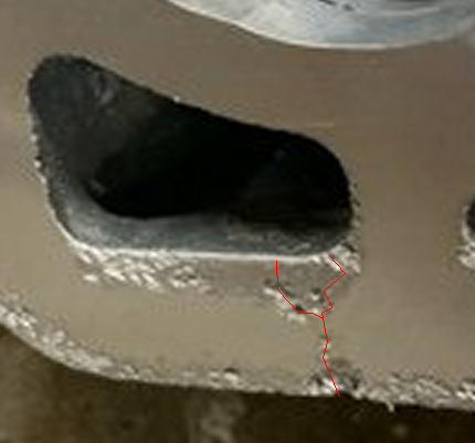

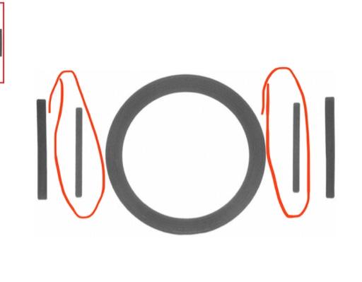

October 31, 20195 yr comment_586699 This area is weakest link. Red lines are leak paths: Edited October 31, 20195 yr by 240260280 Link to comment https://www.classiczcars.com/forums/topic/62852-l28-from-82-zx-teardown/?&page=13#findComment-586699 Share on other sites More sharing options...

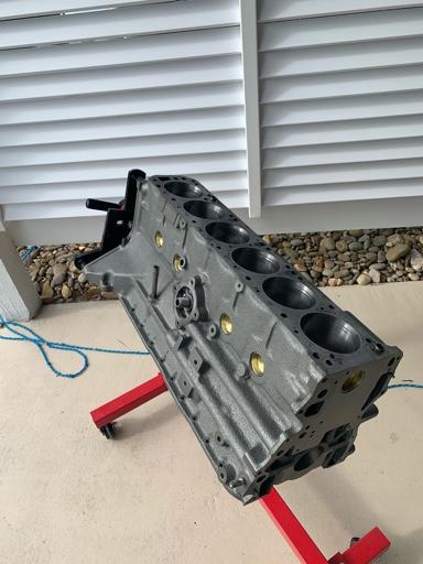

October 31, 20195 yr Author comment_586717 Ready for assembly...Got bearings, main seals and new head bolts. Waiting on my rings and head gasket. Reading trough the “ How to modify your Datsun OHC engine” last night he states that you only need to worry about shimming cam towers and chain slack when the head has be shave .0030 or more from stock. So I’m thinking I should be good with my .0014. Sent from my iPhone using Tapatalk Link to comment https://www.classiczcars.com/forums/topic/62852-l28-from-82-zx-teardown/?&page=13#findComment-586717 Share on other sites More sharing options...
October 31, 20195 yr comment_586721 For a full rebuild, shimming is not needed when you have access to tensioner and chain guides. Link to comment https://www.classiczcars.com/forums/topic/62852-l28-from-82-zx-teardown/?&page=13#findComment-586721 Share on other sites More sharing options...
November 1, 20195 yr comment_586734 On 10/30/2019 at 4:43 PM, 240260280 said: Some JB Weld to fill and a flat to knock down would do the trick. I concur. A little JB Weld "spackle" in those divots should be fine. I like the chain of lakes analogy. So I've never used that copper spray stuff... Is it "authorized" for use on head gaskets? Link to comment https://www.classiczcars.com/forums/topic/62852-l28-from-82-zx-teardown/?&page=13#findComment-586734 Share on other sites More sharing options...

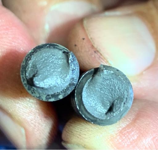

November 1, 20195 yr Author comment_586752 I had an “Oh Crap!” moment today installing the crankshaft. Was almost finished and torquing the main caps down. Followed the book exactly. While torquing cap #5 it happened. When the bolt goes from tight to loose all of a sudden. Yep, she broke. Torque wrench was set to 38 ft lbs. book says 33-40 ft lbs. I opted for something in the middle. Only good thing was there was enough threads sticking out after removing the cap that I was able to grab it with a vise grip and she came out easily. No tapping required. So, I’m at a work stoppage. I’ve lost confidence in the rest of the bolts so I’m ordering a new set. http://datnissparts.com/ld28-main-cap-bolts-set-of-14-for-datsun-l6-l24-l26-l28-240z-260z-280z-280zx-810-910-maxima-12293-v0700/Planning on buying these. Yes, I confirmed the torque setting, wrench is new and high quality and I didn’t miss the break point inadvertently. Sent from my iPhone using Tapatalk Link to comment https://www.classiczcars.com/forums/topic/62852-l28-from-82-zx-teardown/?&page=13#findComment-586752 Share on other sites More sharing options...
November 1, 20195 yr comment_586754 At least you got it out. Probably better it broke than get used and cause problems later Edited November 1, 20195 yr by Patcon Link to comment https://www.classiczcars.com/forums/topic/62852-l28-from-82-zx-teardown/?&page=13#findComment-586754 Share on other sites More sharing options...
November 1, 20195 yr Author comment_586755 I agree. Would have been far worse if it happened later while driving passing 5000 RPM. Now I wonder if I should change the rod bolts too. I know it’s not as easy as new bolts. I recall CO saying there needs to be something done to at the shop level to make the fitment correct. Sent from my iPhone using Tapatalk Link to comment https://www.classiczcars.com/forums/topic/62852-l28-from-82-zx-teardown/?&page=13#findComment-586755 Share on other sites More sharing options...
November 1, 20195 yr comment_586756 There as been a lot of discussion about large sizing if rod bolts are changed. Madkaw is dealing with that I believe Link to comment https://www.classiczcars.com/forums/topic/62852-l28-from-82-zx-teardown/?&page=13#findComment-586756 Share on other sites More sharing options...

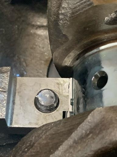

November 3, 20195 yr Author comment_586837 Question, I ordered my rear main seal from Zcardepot and it came with The main seal and two side seals but not side pins. This is supposed to be an OEM Nissan part (came in Nissan bag). It doesn’t come with The metal side pins. Do I need these? I’ve already set the rear main cap with seal and side seals and RTV in the corners and notches where side seal go. Do I need to redo this and add those metal shims in there? https://zcardepot.com/products/rear-main-seal-kit-engine-oem-240z-260z-280z?_pos=2&_sid=5908879bd&_ss=r Sent from my iPhone using Tapatalk Link to comment https://www.classiczcars.com/forums/topic/62852-l28-from-82-zx-teardown/?&page=13#findComment-586837 Share on other sites More sharing options...
