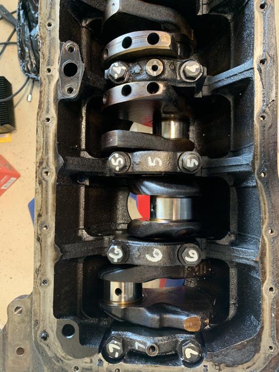

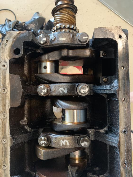

September 29, 20195 yr Author comment_584913 Okay, pulling crank now. I decided to label with a paint pen after wiping the areas with denatured alcohol. My kids have a habit on moving crap in my garage. They’d be sure to mix them up while I’m on a work trip.Sent from my iPhone using Tapatalk Link to comment https://www.classiczcars.com/forums/topic/62852-l28-from-82-zx-teardown/?&page=5#findComment-584913 Share on other sites More sharing options...
September 29, 20195 yr comment_584918 Some folks just use a starter punch and put dots on the caps . It doesn’t take much to mark them so you don’t have to wack them hard or anything . They won’t wash away either Link to comment https://www.classiczcars.com/forums/topic/62852-l28-from-82-zx-teardown/?&page=5#findComment-584918 Share on other sites More sharing options...

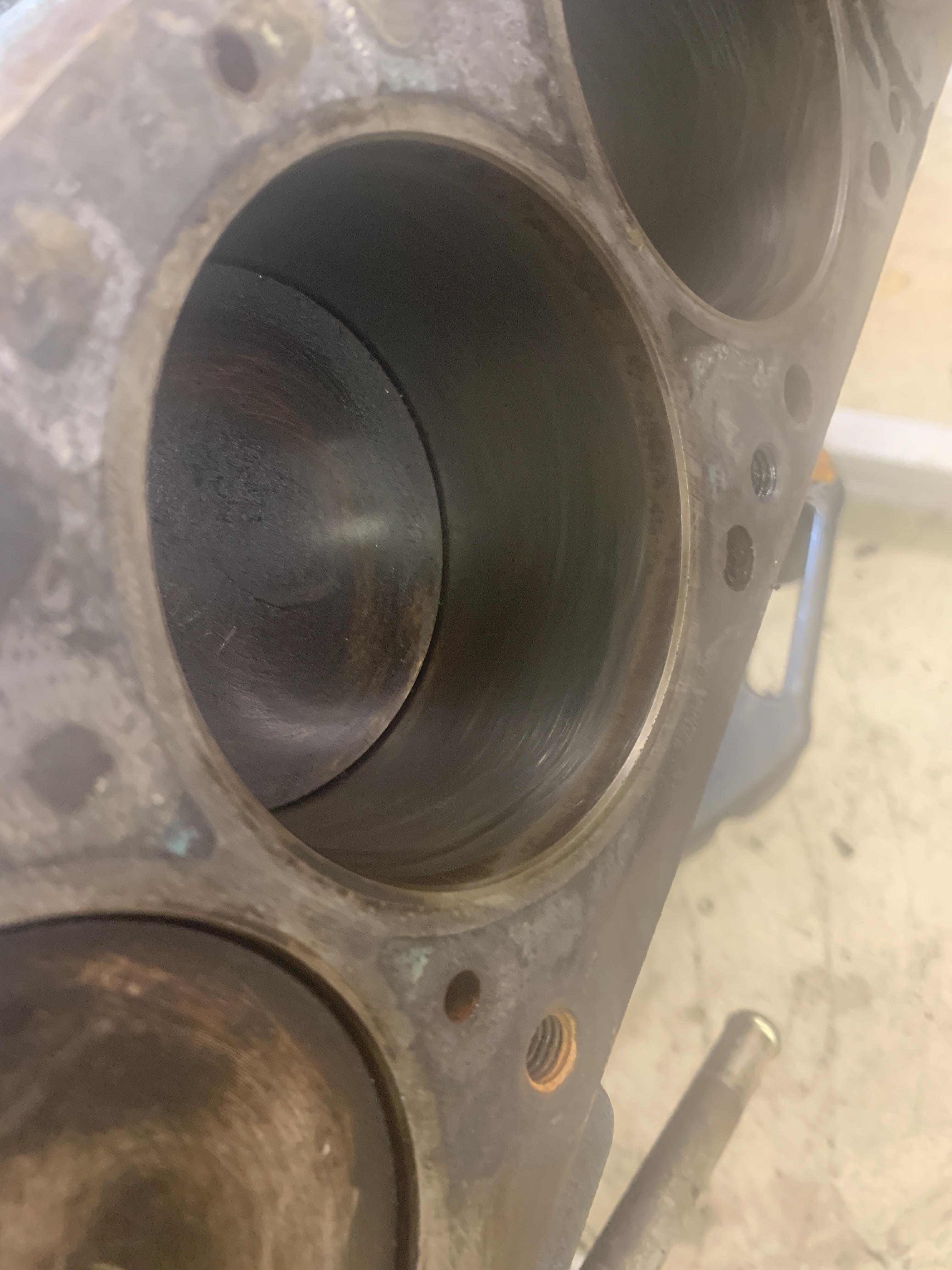

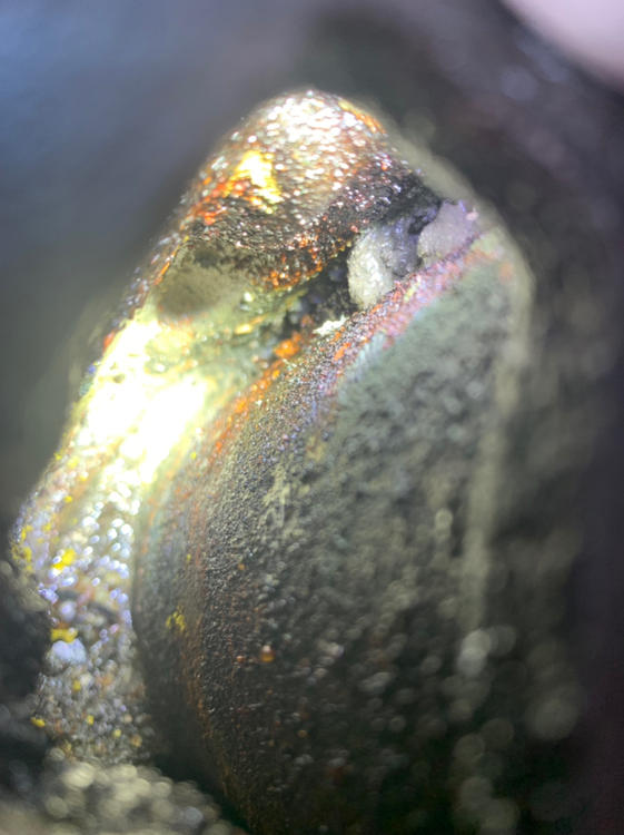

September 29, 20195 yr comment_584919 I just pulled the same engine apart that had been sitting in someone’s garage for over 10 years on a stand . I was pleased to see these cylinder walls Link to comment https://www.classiczcars.com/forums/topic/62852-l28-from-82-zx-teardown/?&page=5#findComment-584919 Share on other sites More sharing options...

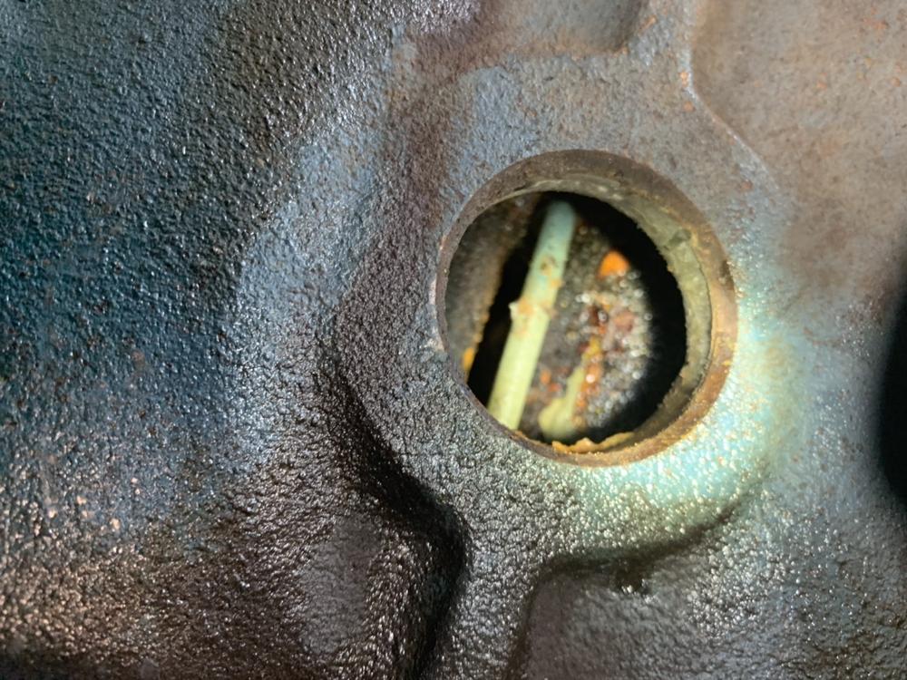

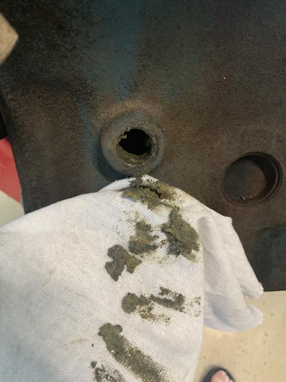

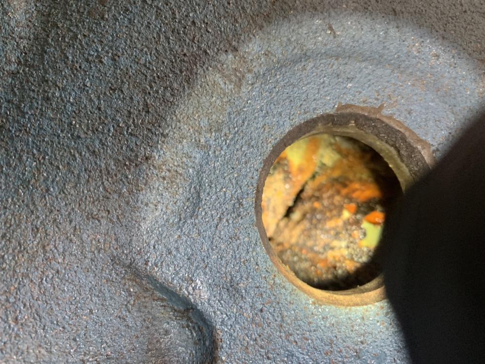

September 29, 20195 yr Author comment_584928 Almost got all the freeze plugs out, except the front and back ones. They don’t want to move. There appears to be a bunch of rust in the engine behind all the plugs I pulled. Behind the coolant drain plug is was packed full of debris. This block needs a nice hot tank to clean all this up. Probably need the shop to remove front and rear drain plugs. Sent from my iPhone using Tapatalk Link to comment https://www.classiczcars.com/forums/topic/62852-l28-from-82-zx-teardown/?&page=5#findComment-584928 Share on other sites More sharing options...
September 29, 20195 yr comment_584930 34 minutes ago, Av8ferg said: Almost got all the freeze plugs out, Core. https://en.wikipedia.org/wiki/Core_plug Link to comment https://www.classiczcars.com/forums/topic/62852-l28-from-82-zx-teardown/?&page=5#findComment-584930 Share on other sites More sharing options...
September 29, 20195 yr comment_584932 They do serve as a high pressure "path of less resistance". I've read on here where someone romped on their Z before the thermostat opened and one blew out. I've seen one that was pushed out of a water filled frozen block on an old pickup of my Dad's. They're the duct tape of the liquid cooled motor. Started out as one thing but ended up useful as others. Link to comment https://www.classiczcars.com/forums/topic/62852-l28-from-82-zx-teardown/?&page=5#findComment-584932 Share on other sites More sharing options...

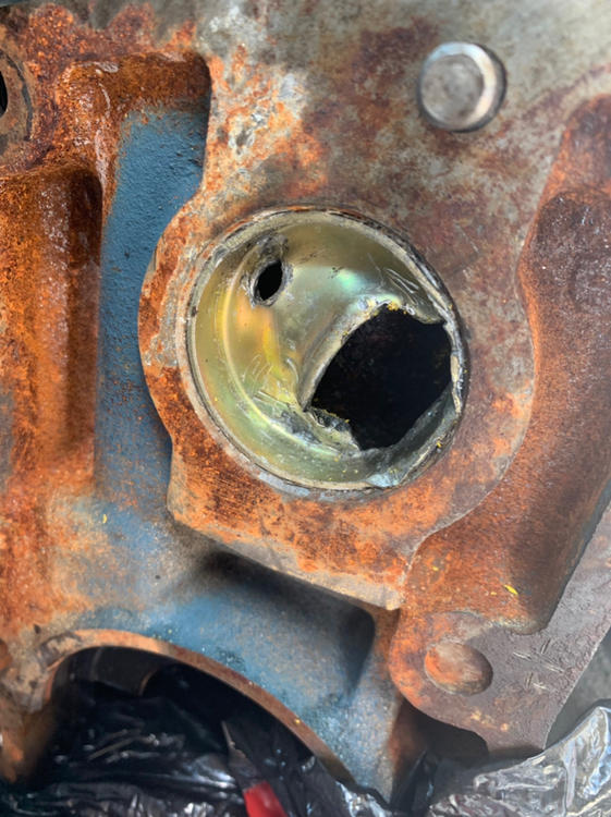

September 29, 20195 yr comment_584936 I ruined an f54 trying to get that rear plug out. Drilled a small hole in it to thread a screw in to pull on with some vise grips. It's so close to #6 I drilled through the soft plug and before I could stop I'd drilled all the way into the bore. Stupid, stupid, stupid or maybe 1beer, 2 beers, 10 beers? Link to comment https://www.classiczcars.com/forums/topic/62852-l28-from-82-zx-teardown/?&page=5#findComment-584936 Share on other sites More sharing options...
September 29, 20195 yr Author comment_584940 I ruined an f54 trying to get that rear plug out. Drilled a small hole in it to thread a screw in to pull on with some vise grips. It's so close to #6 I drilled through the soft plug and before I could stop I'd drilled all the way into the bore. Stupid, stupid, stupid or maybe 1beer, 2 beers, 10 beers? I can see that happening without beers. I drilled a hole to put in a small bolt, screwed the self tapping bolt in with my drill and almost hit the bore. Whew....had to flash a light in there to verify I didn’t hit it. That plug is in there good. I need to have a professional remove it. I tore it up good trying.   Sent from my iPhone using Tapatalk Link to comment https://www.classiczcars.com/forums/topic/62852-l28-from-82-zx-teardown/?&page=5#findComment-584940 Share on other sites More sharing options...
September 29, 20195 yr comment_584941  Looking at its current state, in my mind, it's begging for a hook of some sort, attached to my slide hammer with a lot of heat around the edges. Beer is optional.  Link to comment https://www.classiczcars.com/forums/topic/62852-l28-from-82-zx-teardown/?&page=5#findComment-584941 Share on other sites More sharing options...
