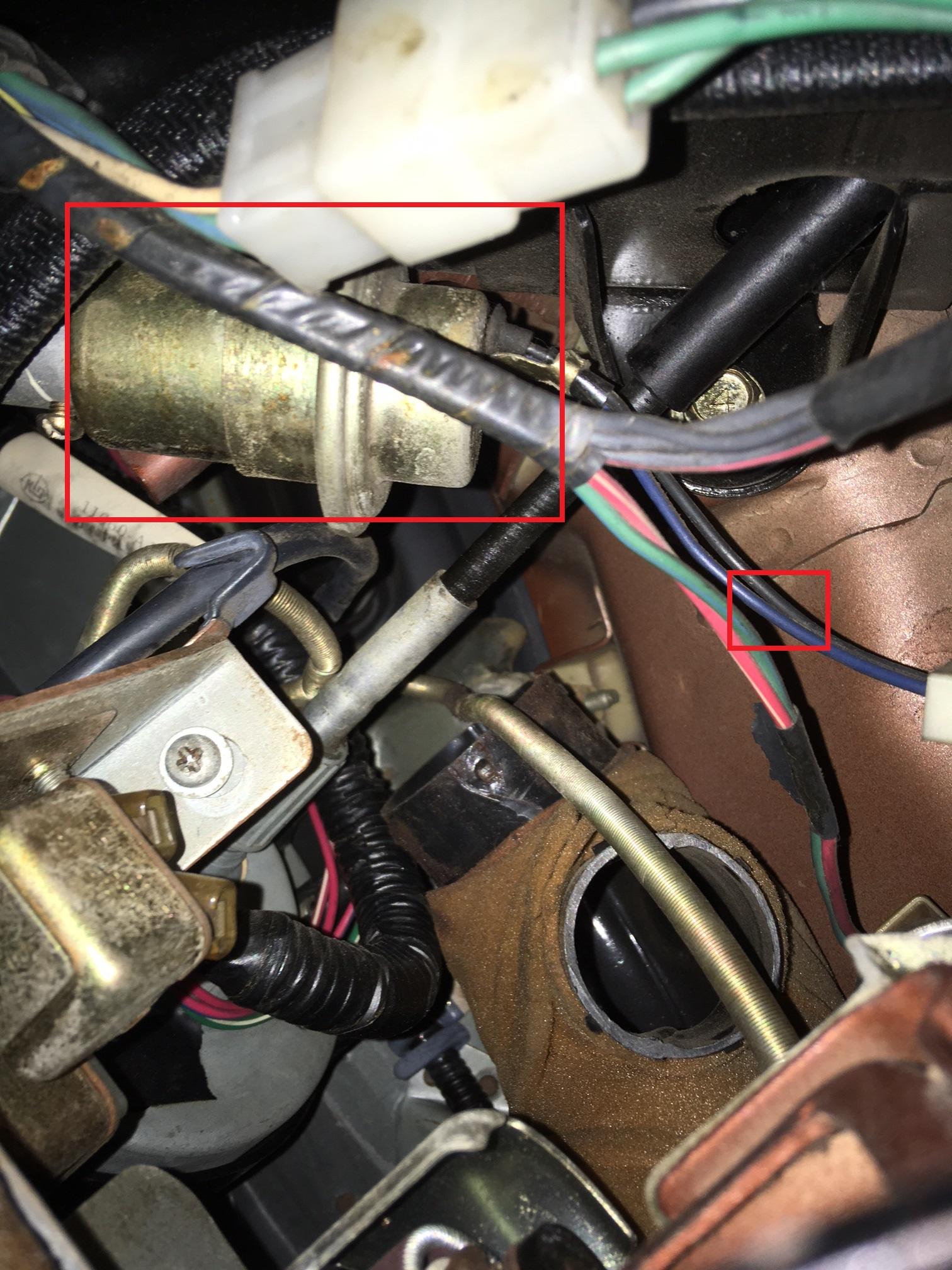

Is there a way to trick the ECU into going into high-altitude mode?
IIRC there are pins on the ECU, your wire harness may not be have matching pins so you would need to figure out a work around for that. IIRC its a simple on off switch that connect the pins that activates it. You should be able to find it in the wire diagrams for the harness.
I have a california car so I'm guessing its there somewhere haha - I'll check the fsm
EDIT: I found it - check and see if you have it, it is this gold pod and the wires going to it are solid blue and solid black.  I'm guessing to engage that we just bridge those 2 wires?
Edited by chaseincats
Update for you guys.  I created a bypass switch to enable high-altitude mode using a standard flip switch and two spade connectors (one plugged into each of the plug's 2 sockets).  I gave it a quick test and it seems to be working (after confirming continuity).
If your bypass switch is working, you will notice the following with the car warmed up and any vacuum line unplugged:
  • Switch on: the car should have a fairly noticeable stumble
  • Switch off: the car should have a mild stumble if at all
  • Thanks 1
