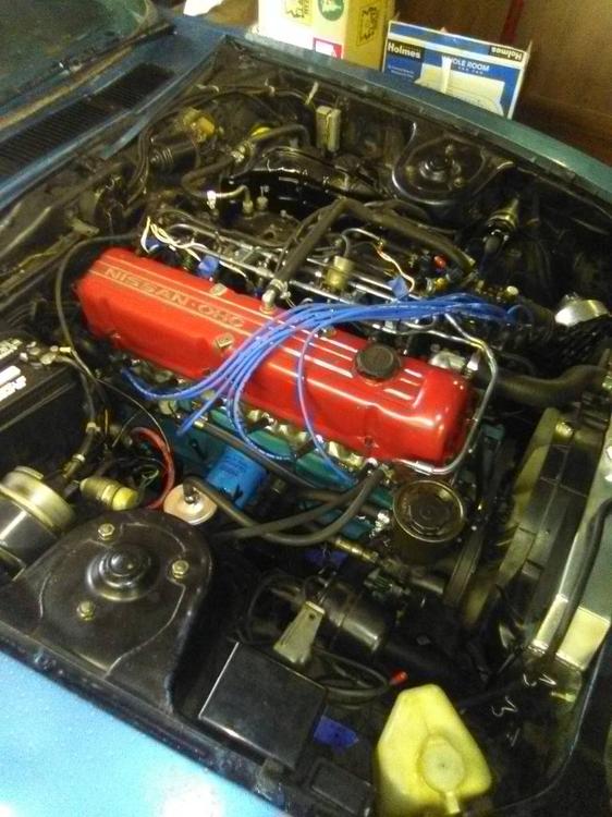

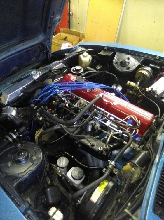

Posted September 22, 20195 yr comment_584511 So I fired this thing up and got a good test drive in our fine Washington rain today. All in all I'm pretty happy with it. The .080 head mod makes a pretty noticable difference. I must say however, that my original engine was pretty worn out, so any improvement must seem major to me. I'm running the same transmission and differential that came out of the '82 that the engine came from. I had removed the dash weeks ago to replace the heater hoses through the firewall, and in replacing the dash, I must've gone and knocked my temp gauge in just the right way to make it peg all the way to the top indicating total meltdown in the dash. But the meat thermometer in the radiator indicates 180deg after a 20 min drive. It feels normal if you touch the valve cover and I can see circulation too so I feel pretty good about it. The gauge read high ever since I've owned the car. The only leak is a small drip from the heater hose coupler that runs along the passenger side of the engine. Easy fix. I ended up running the stock flywheel, and MSA's headers and 2 1/2" exhaust. Drives and sounds good. So I guess this mod works well for anyone looking to do it. Now I can tear down the original motor haha. Edit: I didn't notice any pre ignition detonation. I'll be keeping an ear out as my drives get longer. With 3k RPM cruising and 4k rpm shits I hope I don't get any. I have a tank of premium fuel in right now. Link to comment https://www.classiczcars.com/forums/topic/62878-p79-head-mod/ Share on other sites More sharing options...

September 23, 20195 yr Author comment_584578 I apologize for being lazy but are using the stock cam and EFI on your car? I'm wanting to pep up my 280 now after reading all you guys build threads. I've got the stuff and the car runs great but I'm bored... Yes. I'm totally using stock EFI and stock cam. I'm using my 1980 throttle body so I can have the idle air adjustment screw(1982 screw is not on the throttle body) . I have also deleted the CSV and warming plate and all EGR equipment. It starts and runs fine in our current 55 degree temps. Link to comment https://www.classiczcars.com/forums/topic/62878-p79-head-mod/#findComment-584578 Share on other sites More sharing options...

September 24, 20195 yr Author comment_584604 I took it out on the freeway for about 15 miles and got on it a little bit. The performance increase is pretty noticeable, but I also noticed a bit of detonation under a bit of a load(I only took it to 4k rpm) on a slight incline at around 60MPH@ roughly 3kRPM. It went away after a few seconds. I'd guess it would be worse if i lugged the engine. I'll have to get used to finessing the throttle to avoid it. Maybe a bit less of a shave would prevent it. Haven't run a compression check yet, but it sure wants to do evil stuff haha. Link to comment https://www.classiczcars.com/forums/topic/62878-p79-head-mod/#findComment-584604 Share on other sites More sharing options...
September 24, 20195 yr comment_584618 So what dizzy are you running and what’s your timing? Link to comment https://www.classiczcars.com/forums/topic/62878-p79-head-mod/#findComment-584618 Share on other sites More sharing options...
September 24, 20195 yr Author comment_584624 My original 1980 distributor, with ignition timing set to 10 deg. Sent from my Coolpad 3310A using Tapatalk Link to comment https://www.classiczcars.com/forums/topic/62878-p79-head-mod/#findComment-584624 Share on other sites More sharing options...
