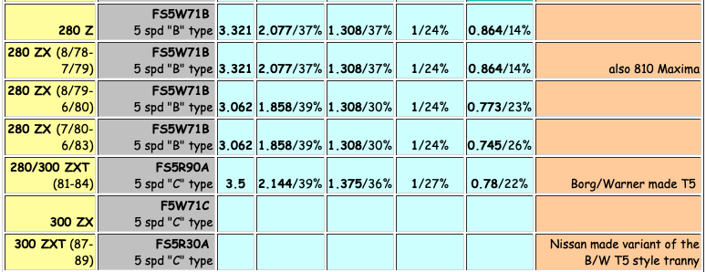

People use "short" and "tall" differently and many use them incorrectly.  Not sure what you mean by short.  A 3.54 will give you the "tallest" 5th you can get with any transmission, unless you find a 3.36 diff.  If you install a 3.9 5th will get shorter.  I'm using tall and short as I understand them  Tall is lower RPM, short is higher RPM, or faster acceleration.  With short you run out of RPM sooner.
There are only three 5th gear ratios available.  80-81 is in between the other two.  After 81 gives you the lowest cruising RPM.  "Tallest" 5th.

There was that one ZX transmission shown for 10 months in '79-'80 that had the in between ratio, but that is hard to find.
The tallest diff would be the 3:36, standard on the 4 speed 240's and some 280's. The 3:54 came in the automatics. 240 280 and ZX.
Actually the early 5 speeds are the one with the gap between 2nd and 3rd.  The later "close ratio" boxes are well spaced.
