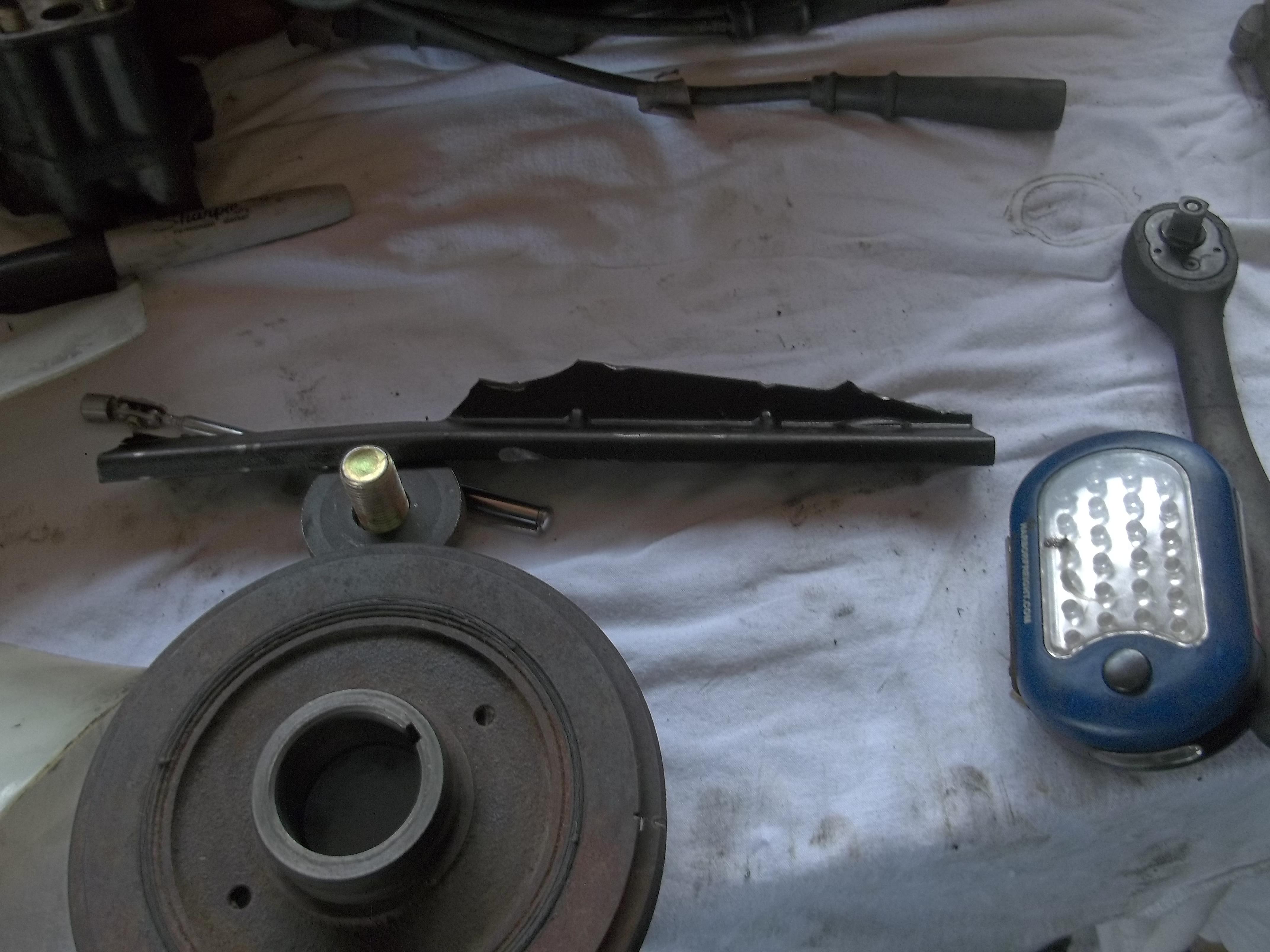

I was planning to just replace the broken piece, but since I don't know what happened, maybe I should pop for the whole setup. I see there is the cheap one and then the japan ones on the Z stores.

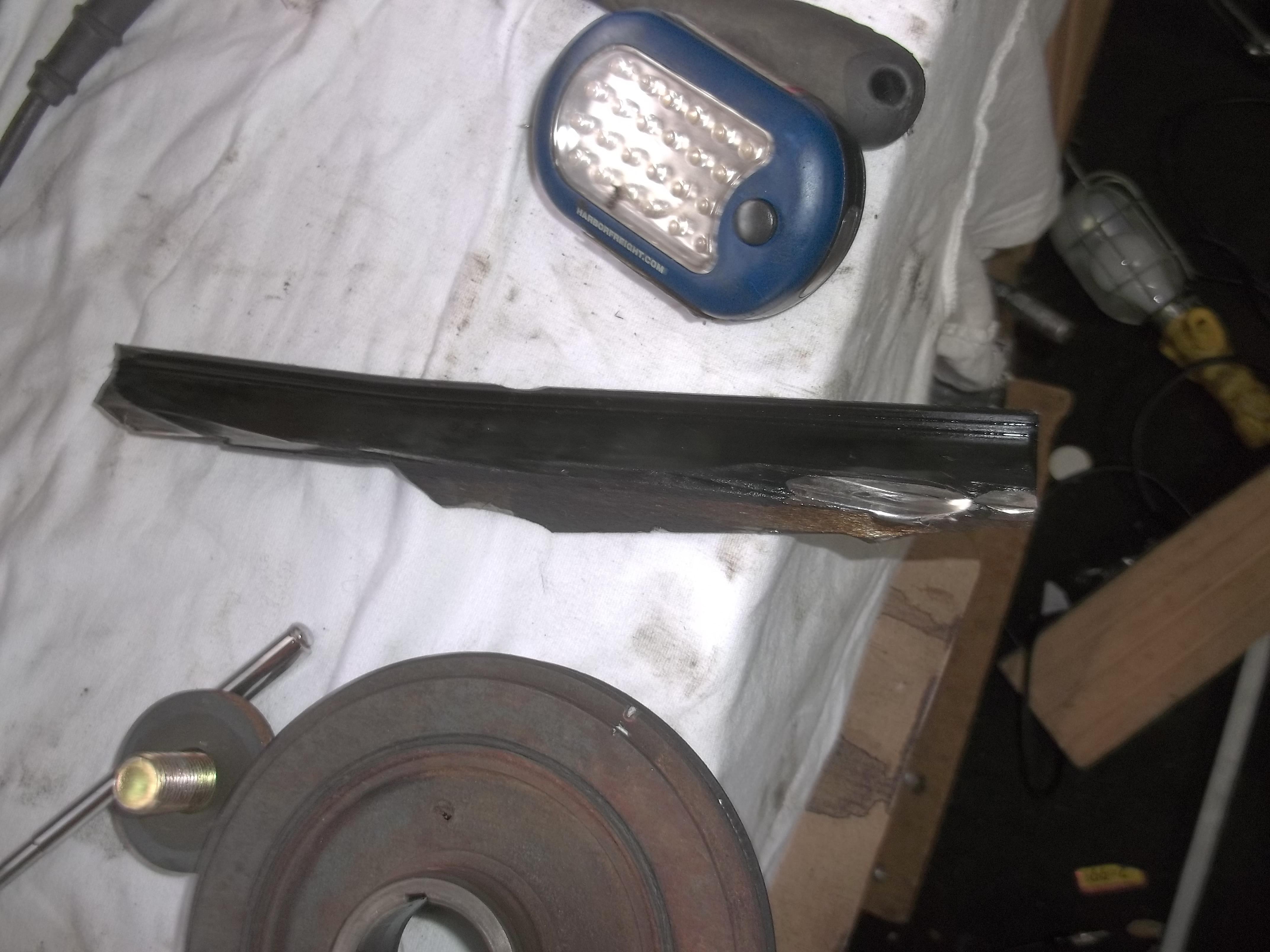

Not really sure why It failed, looked like the top mount just fractured, but I cant see how that could happen. Maybe just metal fatigue? not a materials expert here.
I did nothing around the timing chain for the T stat housing recently, and the problem seemed to happen at least 3000 miles into the trip. I have good oil pressure (3/4 of the 90 psi gauge at 3k), so I assume the tensioner was working well, but if for some reason it did not apply enough tension could that allow the chain to whip and maybe cause a cascade failure? just wondering if anyone has seen a fail like in the photo.
Edited by Dave WM
Woof. That's not pretty. Would be really interesting to figure out exactly what happened with that.
Did the mounting tabs crack off first and then the guide got pulled into the chain?
Or did the guide get snagged by the chain somehow and when it got pulled in, the mounting tabs snapped.
Maybe the mounting bolts came loose and it was in there flopping around until it got snagged. And then the snag snapped the tabs.
So your tensioner shoe was still in the hole? It didn't pop out, right?
