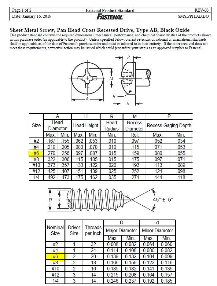

I have a Jan/1971 240Z that the previous owner recovered the seats and removed the seatbelt hooks.
What size is the screw that attaches the hook to the side of the seat?  If anyone with an original could post up a photo that would be great.  I went to the hardware store and picked up some #6 and #8 sized screws.  Both work, but I can't tell from pictures online which is closer to original.

Sheet metal screws work well for this application. The screw doesn't bottom out when tight, allowing the hook to swivel and not do damage to the vinyl seat back covering.
