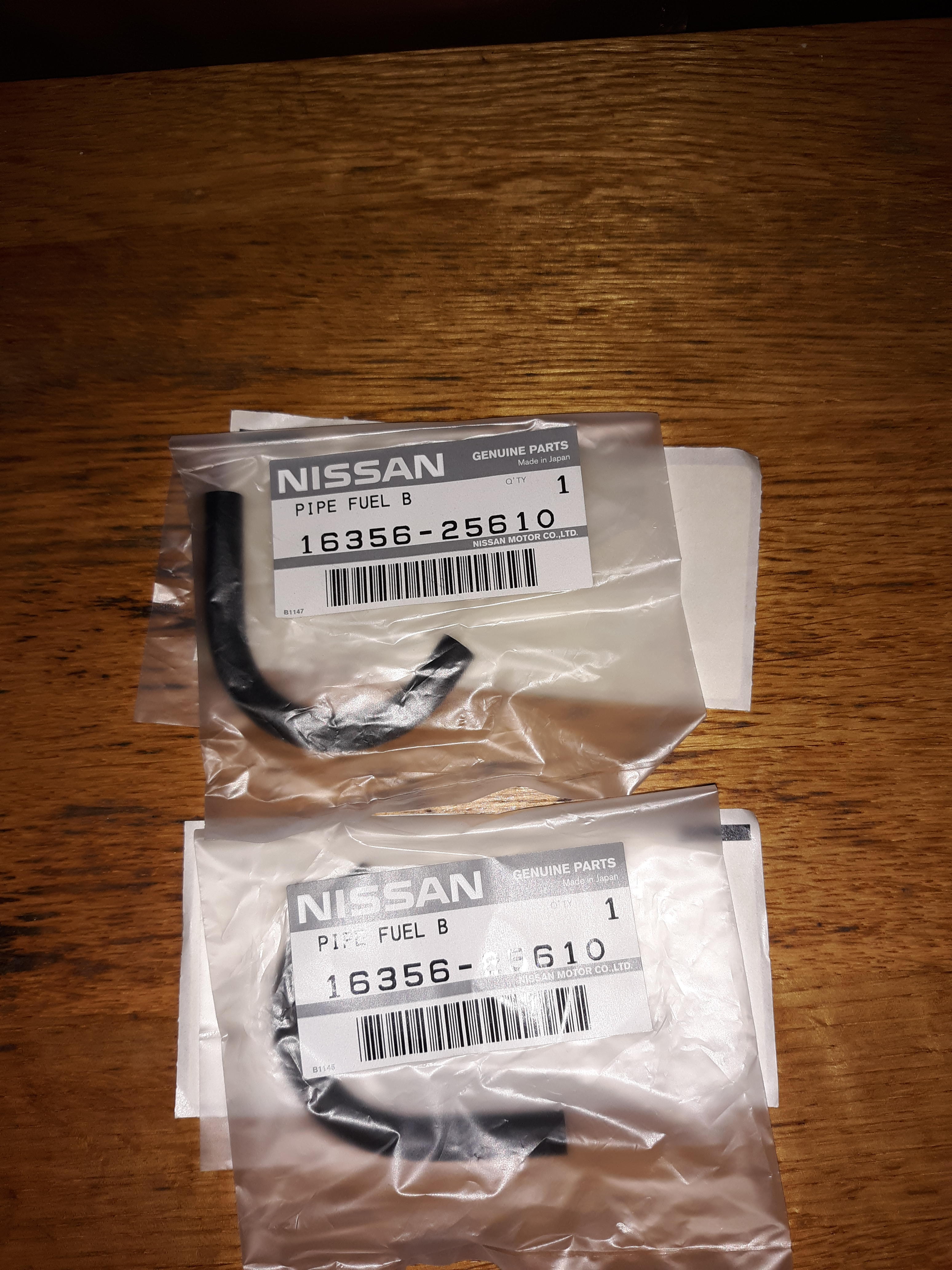

@siteunseen Cliff is the expert on needle valves. The hoses from the float bowls to the nozzles were not braided as I recall. The hoses need to be SUPER FLEXIBLE (think al dente pasta) otherwise the hoses will bind the nozzles, usually preventing the nozzles from sliding up (returning) to the unchoked position. Ztherapy supplies very nice hoses that I believe are made of silicone.
Here's the hoses you can get from Nissan. I bought these a year or so ago. Maybe they're still available? Zcardepot.com has them also. They definitely aren't braided.

Thanks for your responses. I can tell that the braided hoses I have from another source are not right. They were actually too large for the original hose clamps, although I was able to get them on with some help from a needle nose pliers. I will get some proper replacements.
