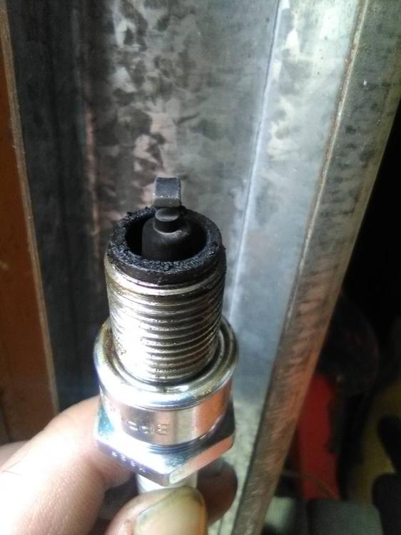

The plugs are difficult for me to read as well. Again, I've seen oil fouled plugs with the old motor, but the ones in my new engine seem like their on the verge of both carbon fouling and oil fouling. To me at least. What do you guys think. This one picture represents the condition of all 6 plugs with roughly 150 miles of use.
Edit: my TVS has not been adjusted per the FSM since installation on the new engine.
Edit #2:  A quick 6 -8 flick of the wire brush over the spark plug removes almost all of the deposits, and I'm mostly seeing powdery residue, not so much oily residue.  I'm thinking I have one of those odd situations where a rich condition is thinning out oil, making it enter the combustion process, and give symptoms of both rich condition, and oil consumption.  Perhaps someone has seen this before, and can shed light on it.

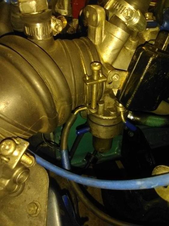

I could be confused as to wether or not I have actually disabled my BCDD and if that has any correlation to anything. If I plug it off with vacuum line plugs, it will smoke upon resuming acceleration after deceleration. If I run a line from the uppermost forward large port on the BCDD to the intake manifold, then it will not smoke under those circumstances. I wonder if my manifold pressure is all jacked up? 41953d5d2bf4a073425eb1b555889a46.jpg&key=d749ac4ac53307add424a26ea8c0a5feee6ad7528724143b5ec45cb08c6a1c60

Looks like a bit of both fuel and oil, but mostly carbon if it brushes off that easy.
