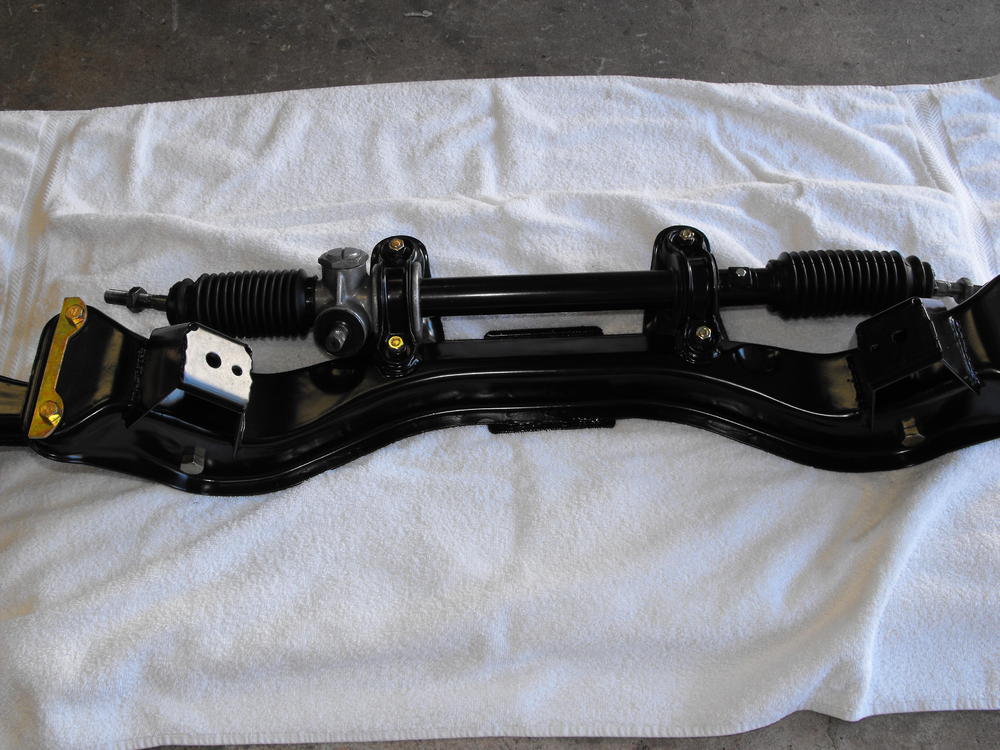

April 29, 20204 yr comment_598363 Your Steering Rack looks great. I am getting all of my suspension parts ready for powder coating. Did you just paint your steering rack? I am trying to decide what to do with the upper and lower shaft on mine. The small U joints appear to be "Staked" in place. I have been replacing any wear parts when possible for what will hopefully be the next 50 years of driving my car but I am not sure its worth trying to dismantle those joints. From other posts it looks like those little joints may be hard to come by and difficult to remove. Maybe just paint them and the Shafts with the joints in place? Link to comment https://www.classiczcars.com/forums/topic/62992-the-orange/?&page=11#findComment-598363 Share on other sites More sharing options...
April 29, 20204 yr Author comment_598368 13 minutes ago, Clay C said: Your Steering Rack looks great. I am getting all of my suspension parts ready for powder coating. Did you just paint your steering rack? I am trying to decide what to do with the upper and lower shaft on mine. The small U joints appear to be "Staked" in place. I have been replacing any wear parts when possible for what will hopefully be the next 50 years of driving my car but I am not sure its worth trying to dismantle those joints. From other posts it looks like those little joints may be hard to come by and difficult to remove. Maybe just paint them and the Shafts with the joints in place? Yes, I stripped and painted the steering rack gloss black. I also lubed the assembly near the steering input and the rack portion at both ends. Then cycled the rack back and forth to work the grease in. Installed new boots. For the steering input shaft that attaches to the rack, I usually just clean and paint. The U-joint is typically in pretty good condition. If it were loose, I would replace it. Also, for what it is worth, I think the Japanese bearings on the Z cars are very high quality. Unfortunately most replacement bearings are Chinese and I don't think the quality is as good as the originals. Link to comment https://www.classiczcars.com/forums/topic/62992-the-orange/?&page=11#findComment-598368 Share on other sites More sharing options...

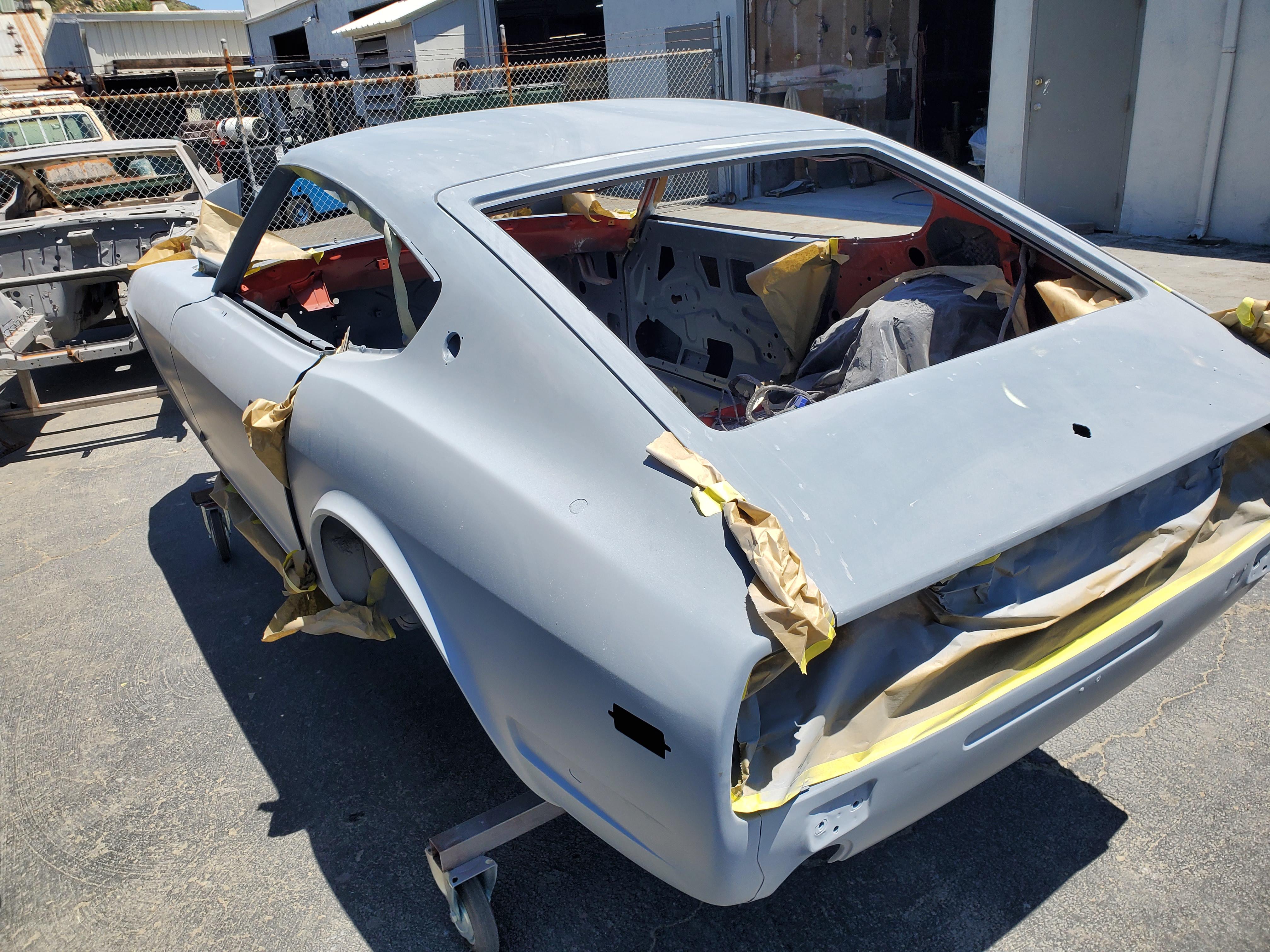

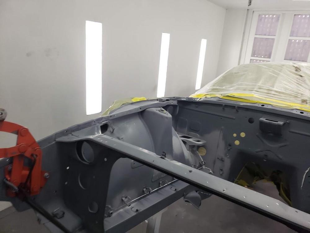

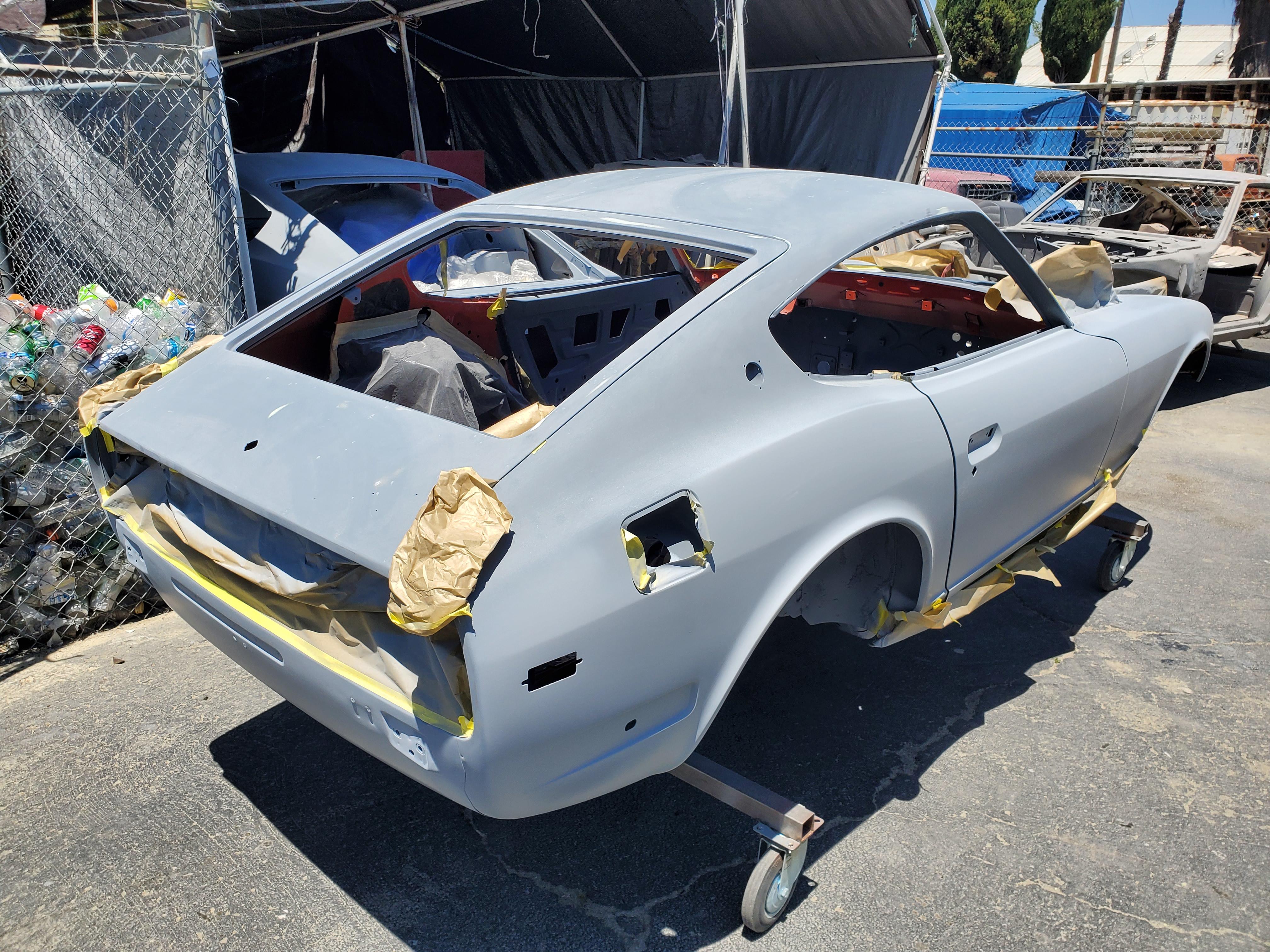

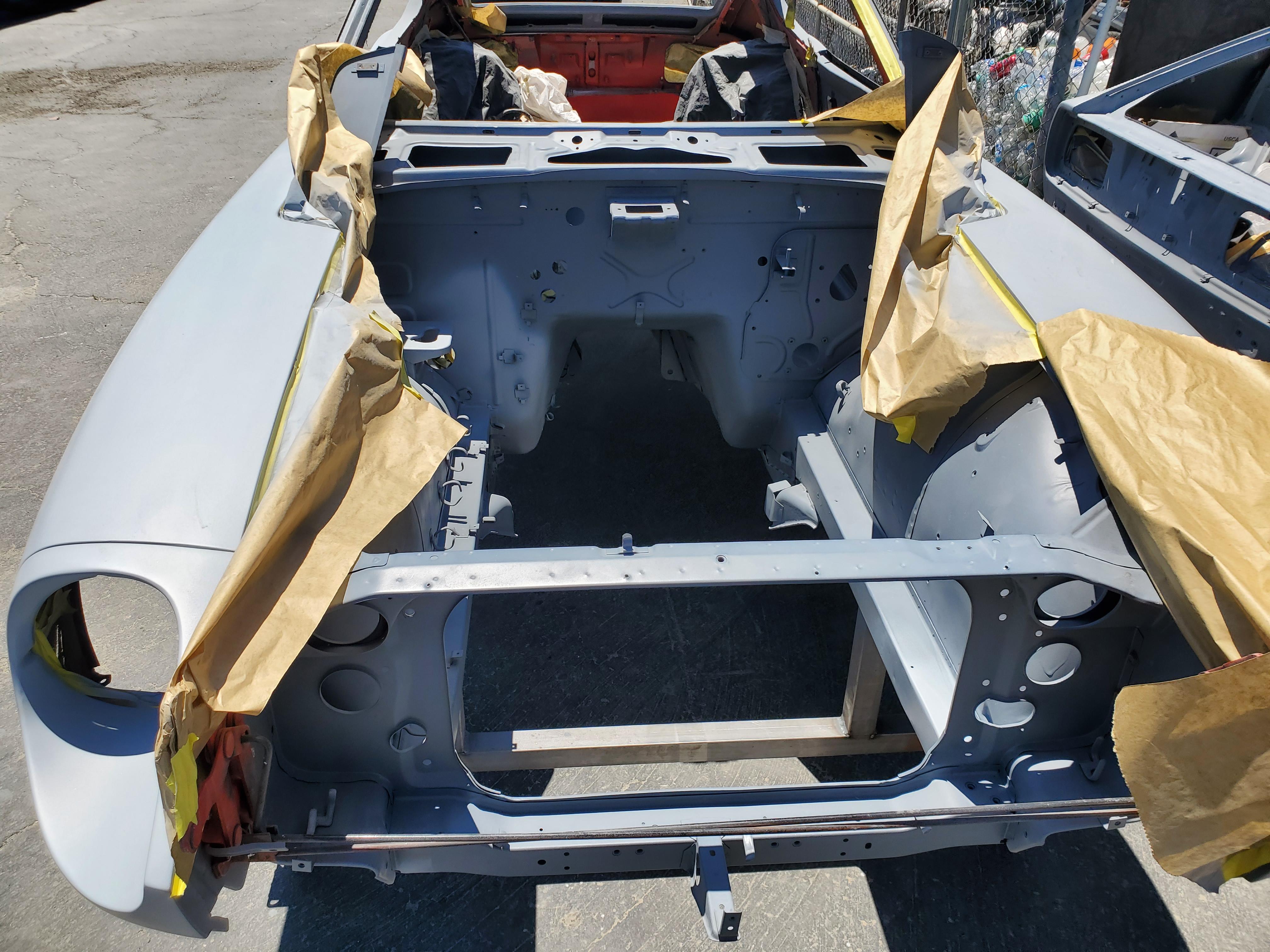

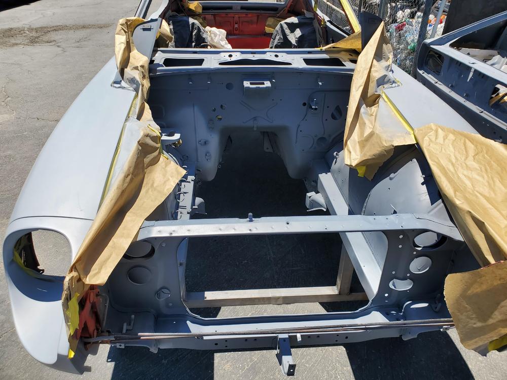

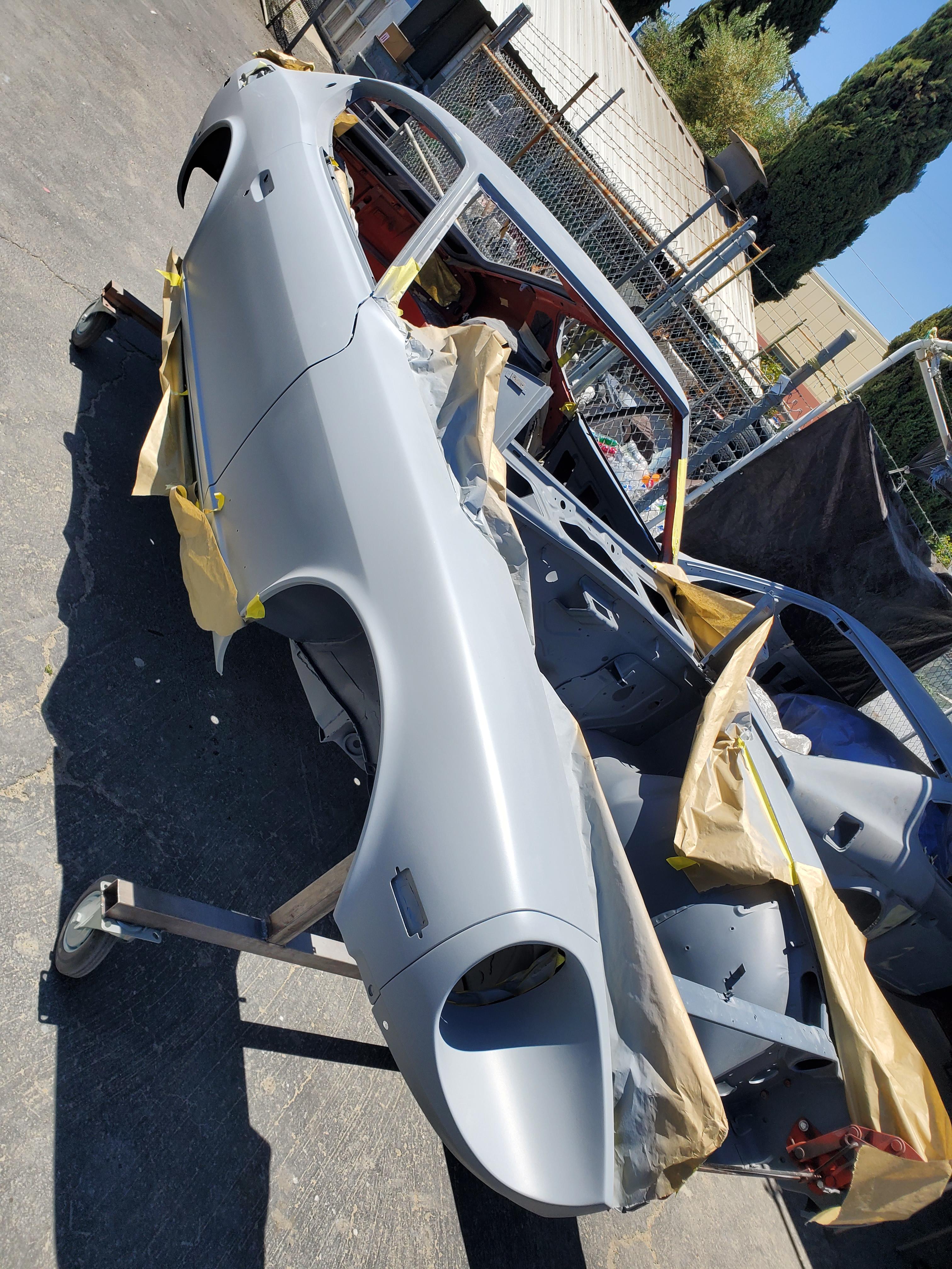

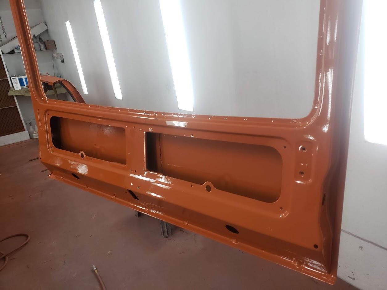

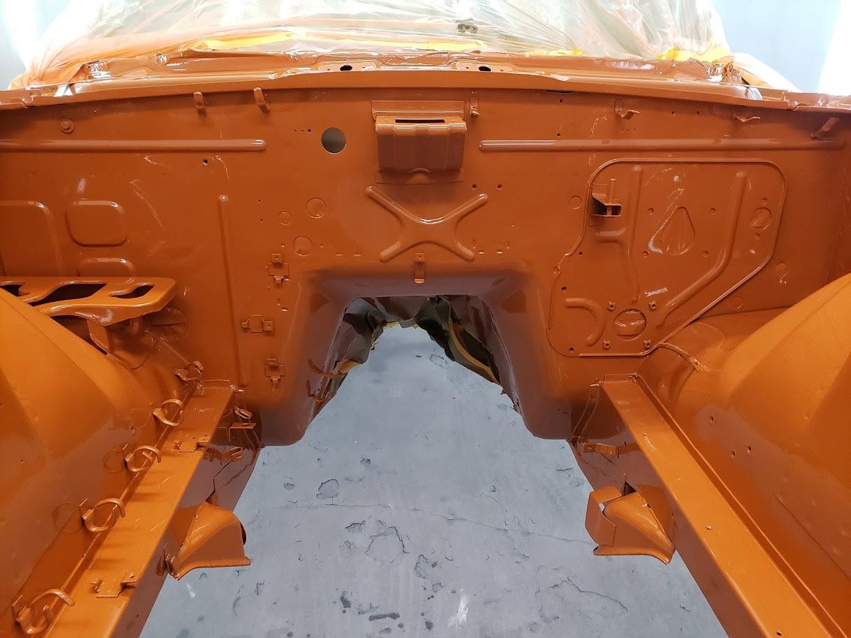

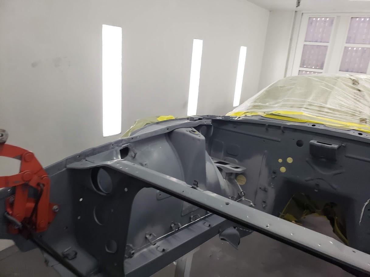

May 11, 20204 yr Author comment_599279 Pics from the paint shop. Got the grey primer on now.....we're getting closer. Link to comment https://www.classiczcars.com/forums/topic/62992-the-orange/?&page=11#findComment-599279 Share on other sites More sharing options...

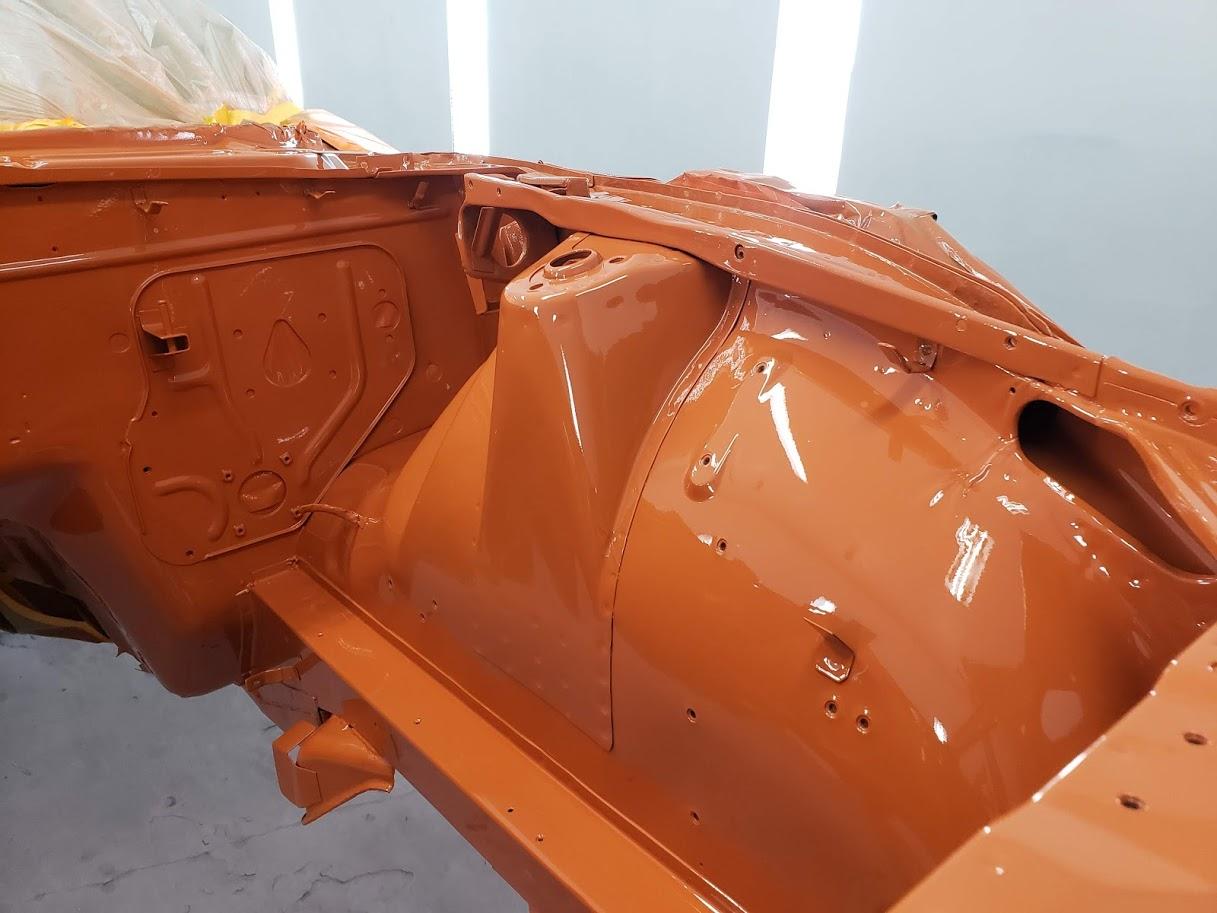

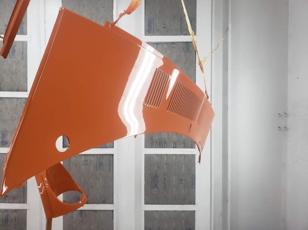

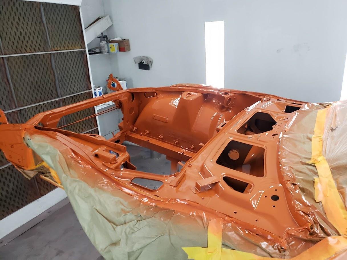

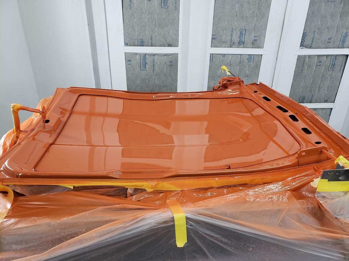

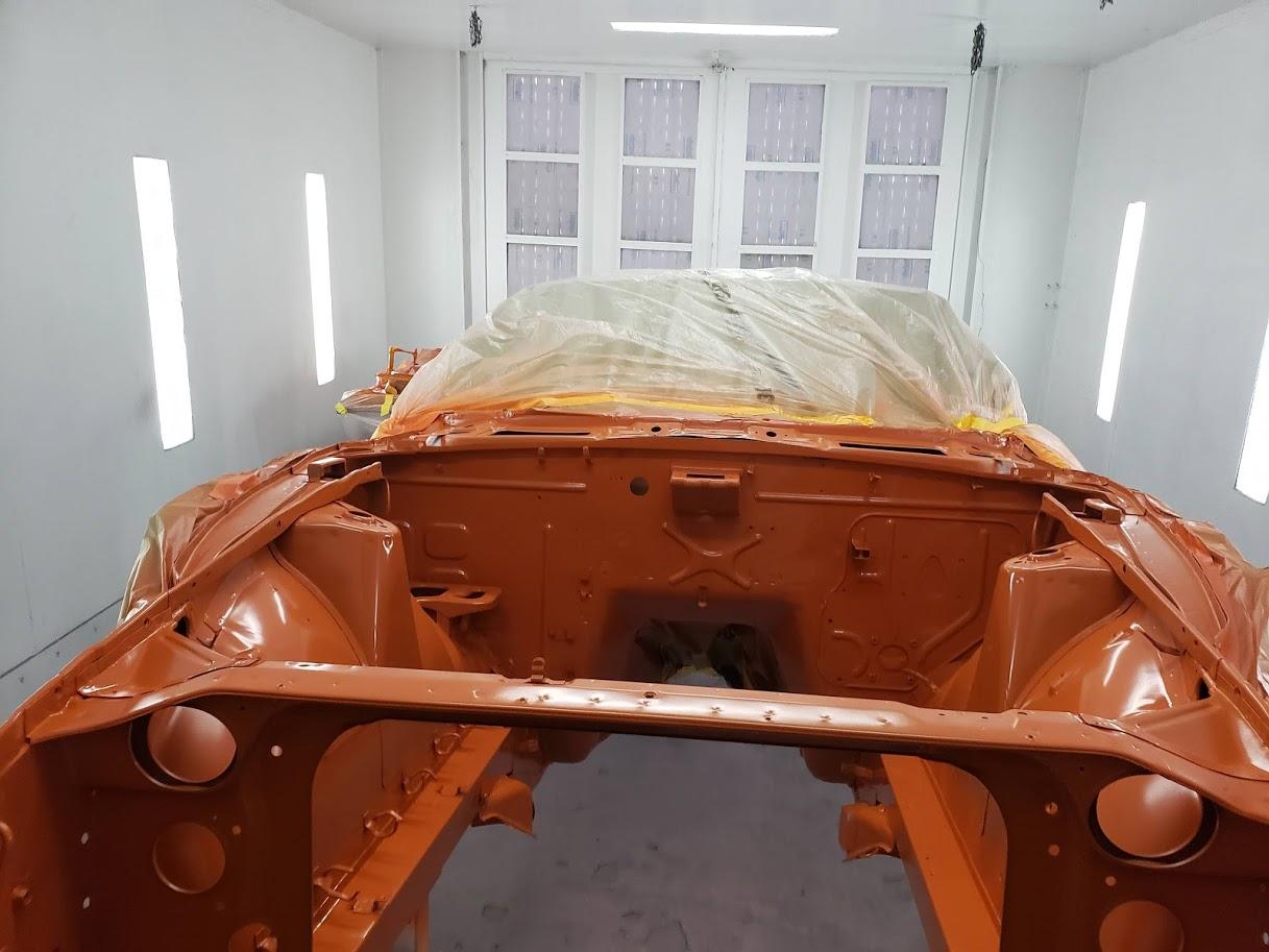

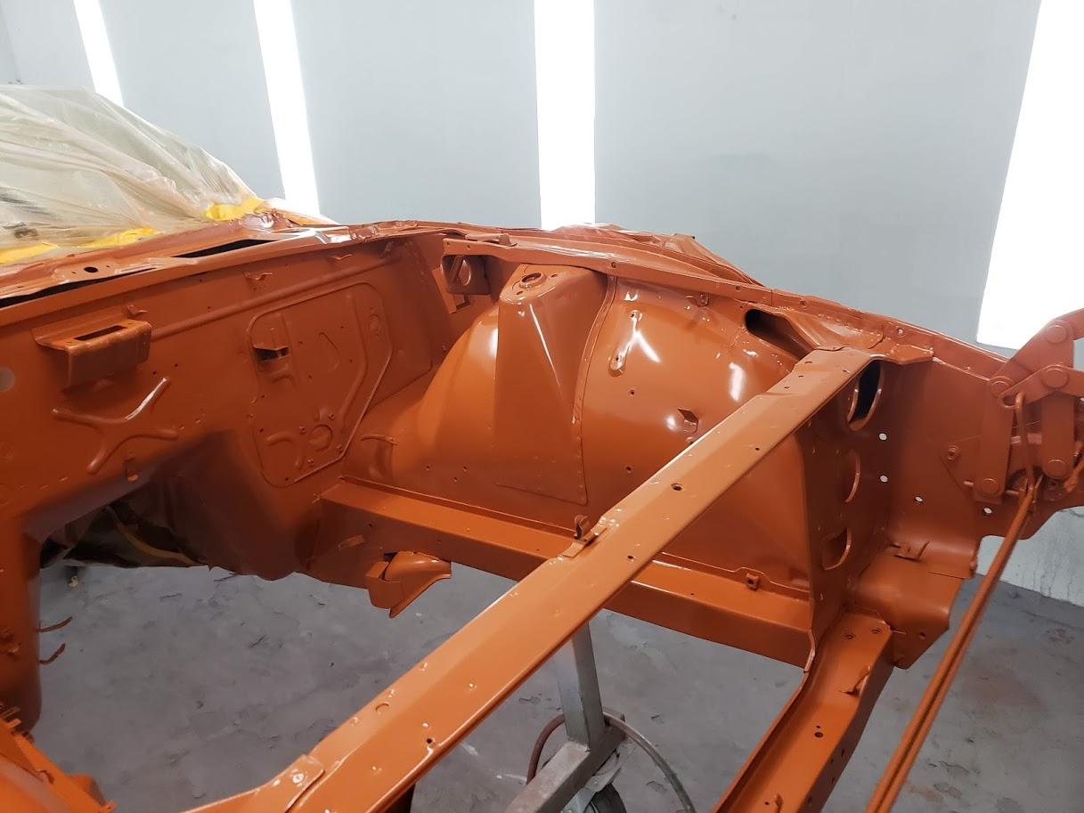

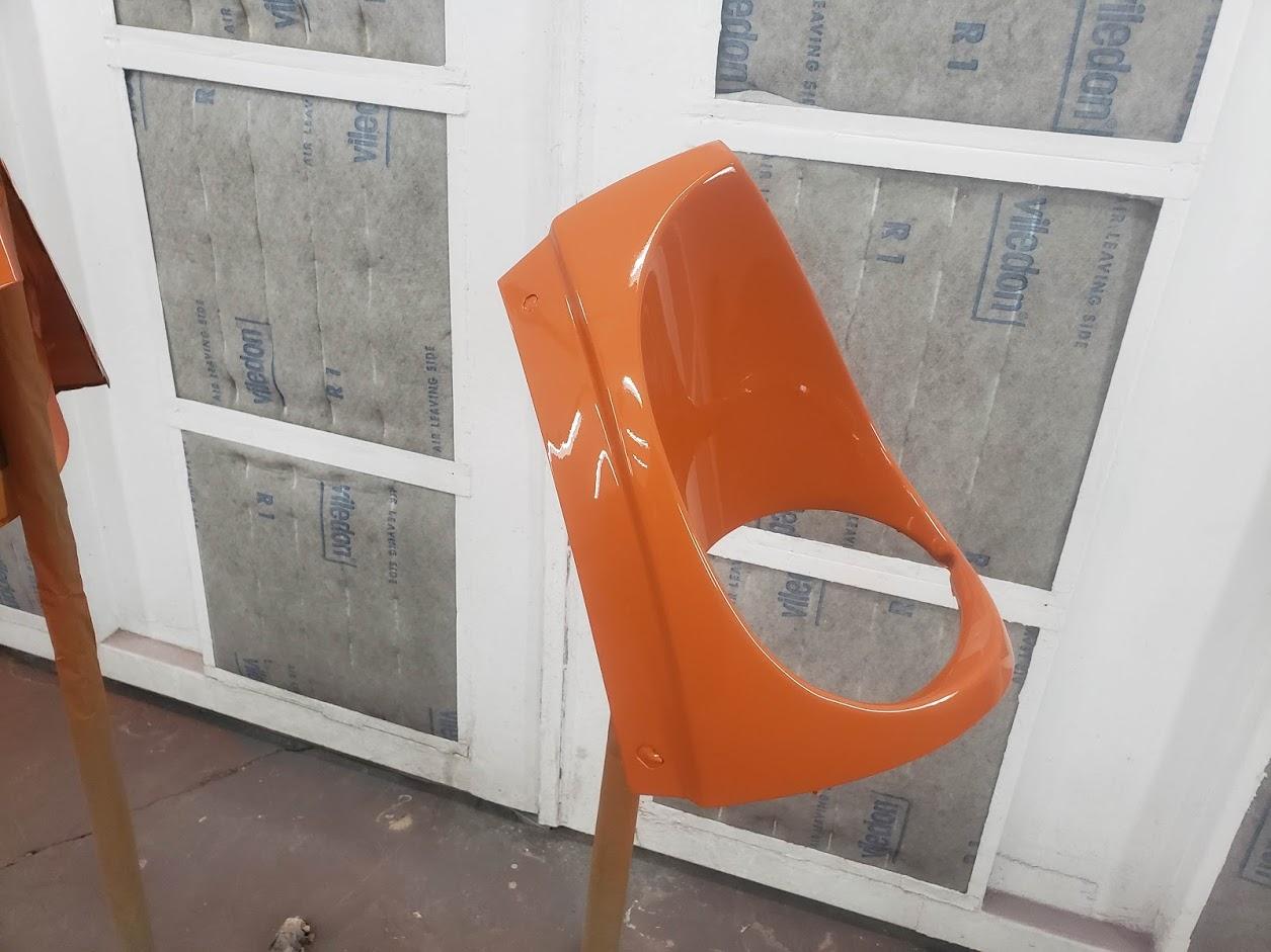

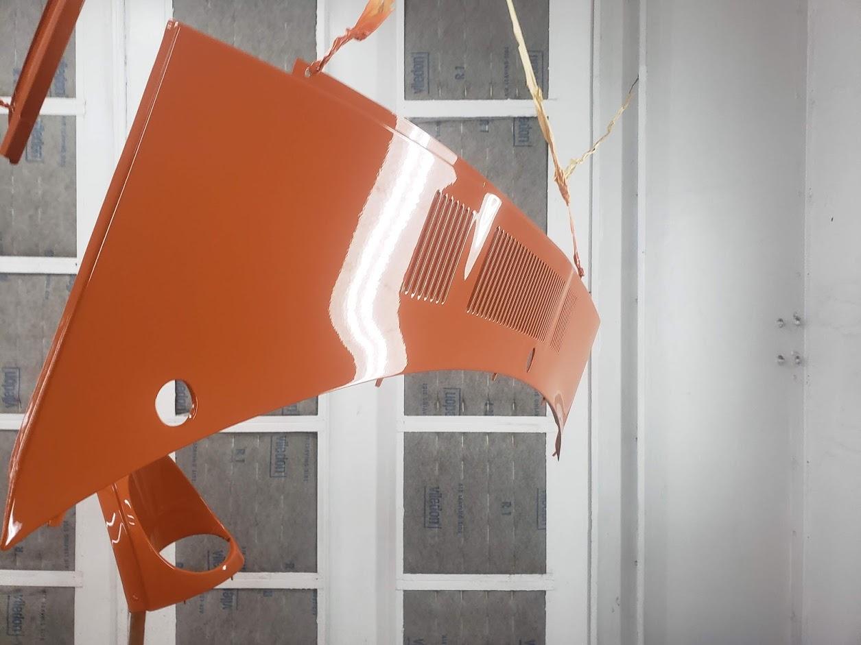

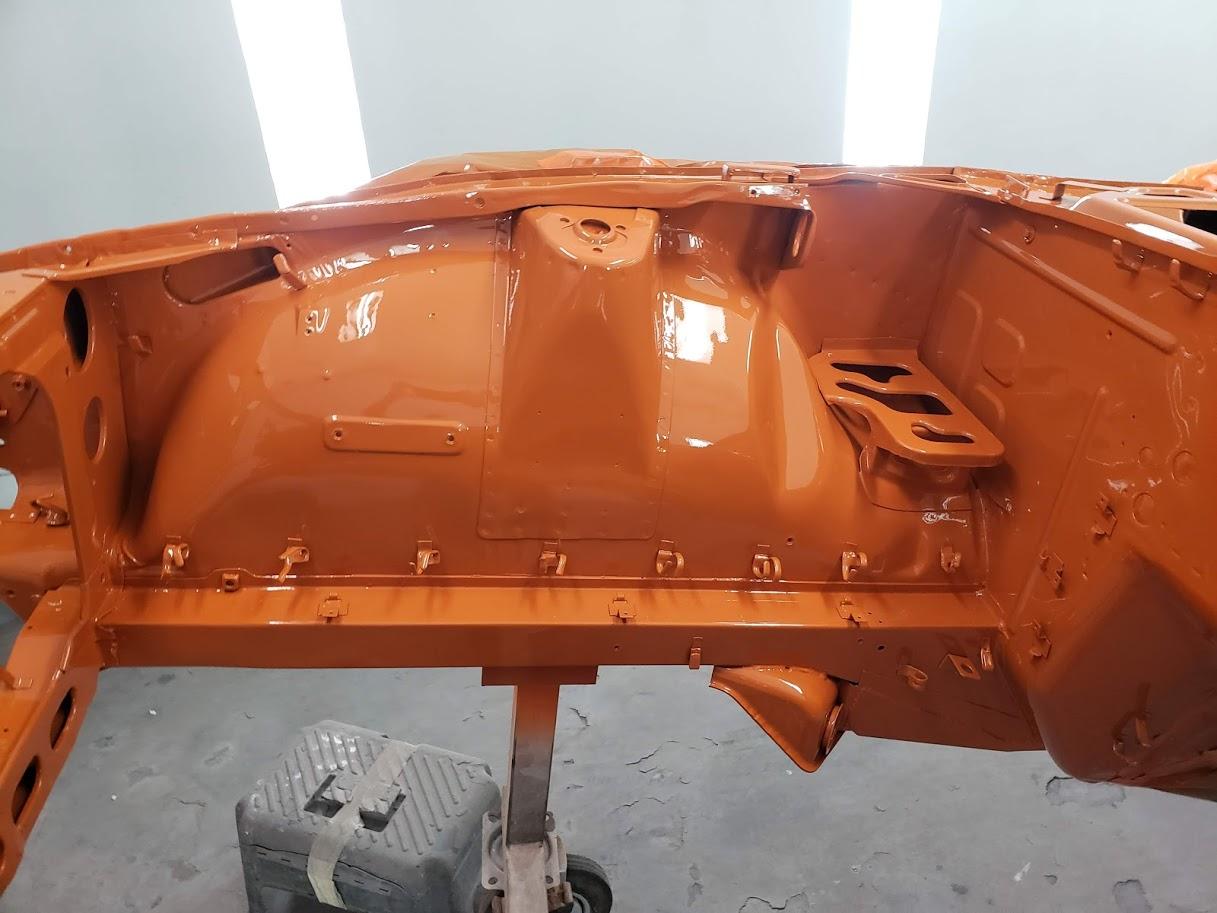

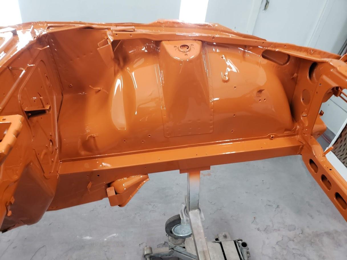

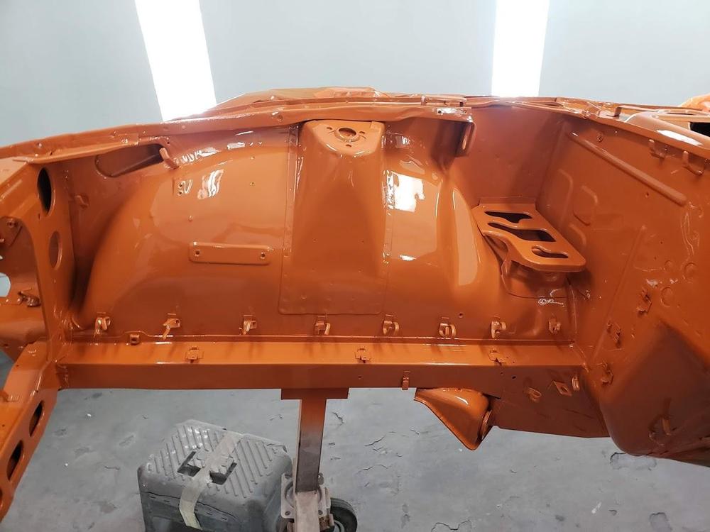

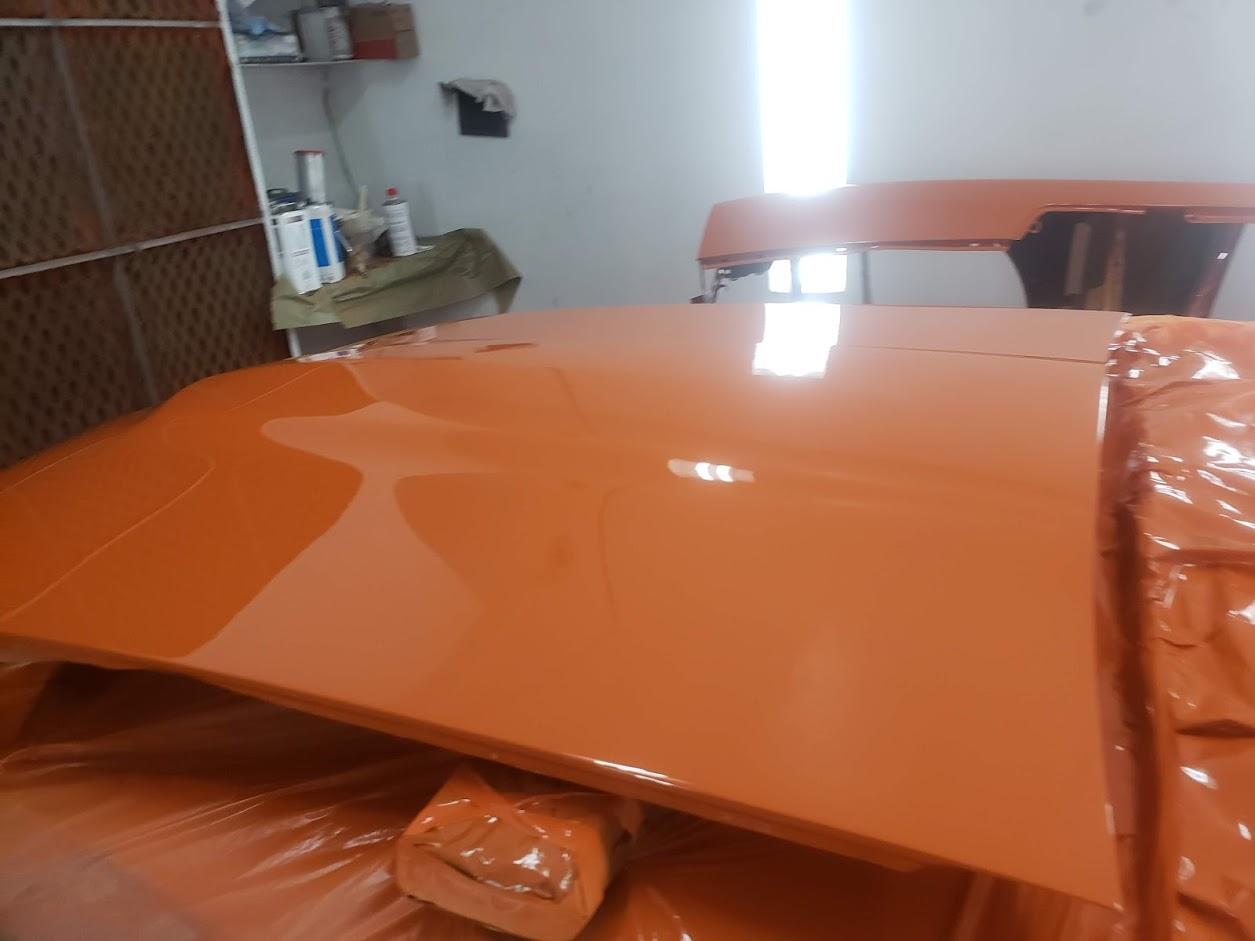

July 20, 20204 yr Author comment_603144 FINALLY! Orange paint. This is great to see. Parts are ready to install as soon as she arrives at my place. Still probably going to be a few weeks. Needs final body paint and color sand and polish. Link to comment https://www.classiczcars.com/forums/topic/62992-the-orange/?&page=11#findComment-603144 Share on other sites More sharing options...

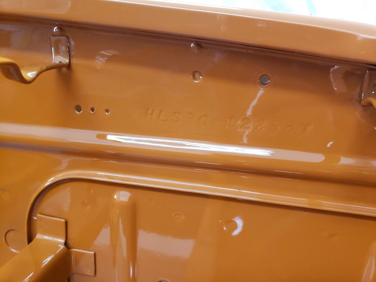

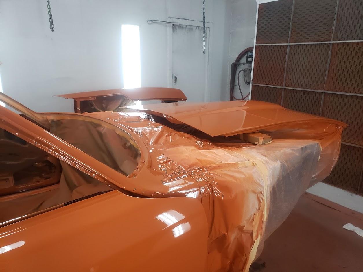

July 22, 20204 yr comment_603195 Getting close... Link to comment https://www.classiczcars.com/forums/topic/62992-the-orange/?&page=11#findComment-603195 Share on other sites More sharing options...

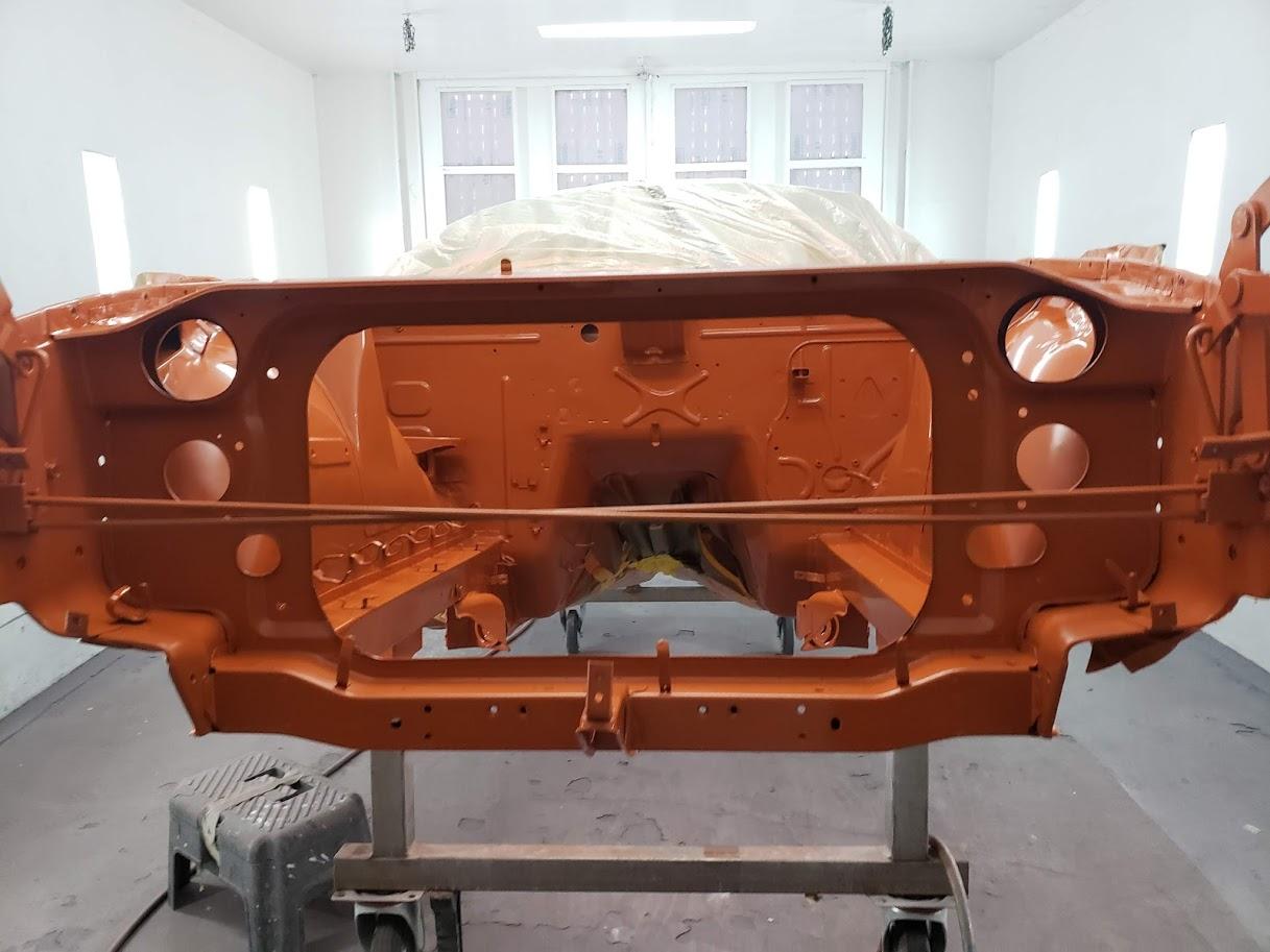

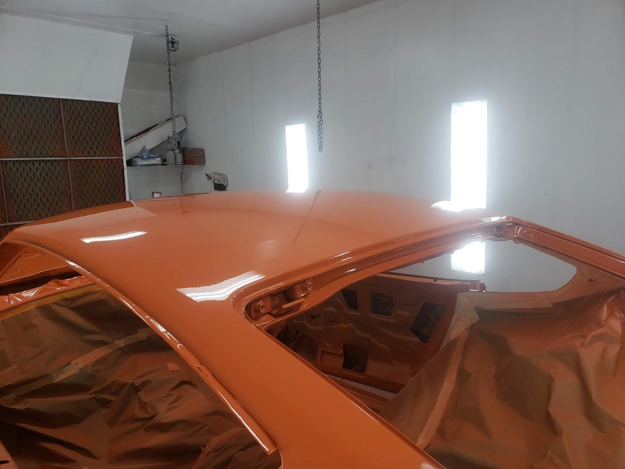

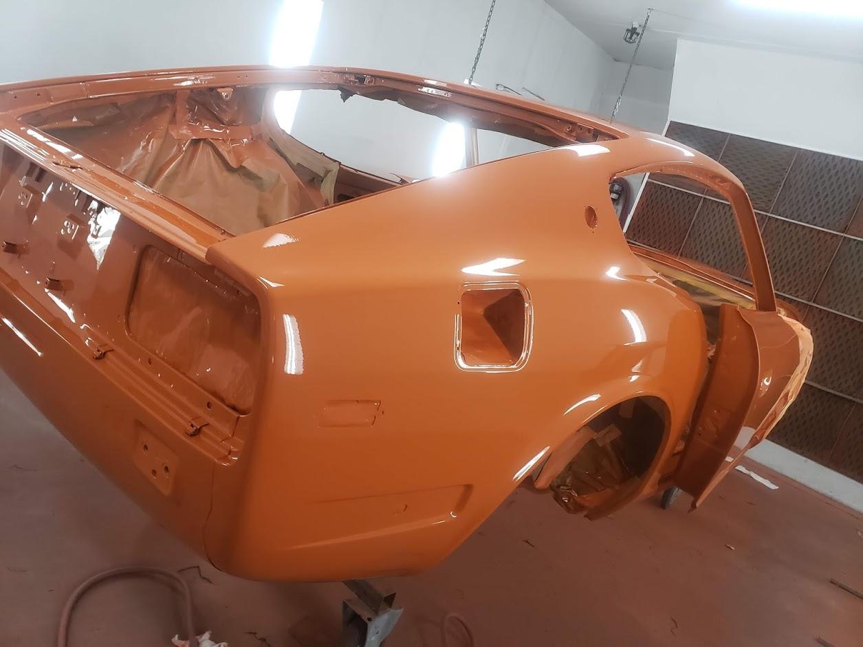

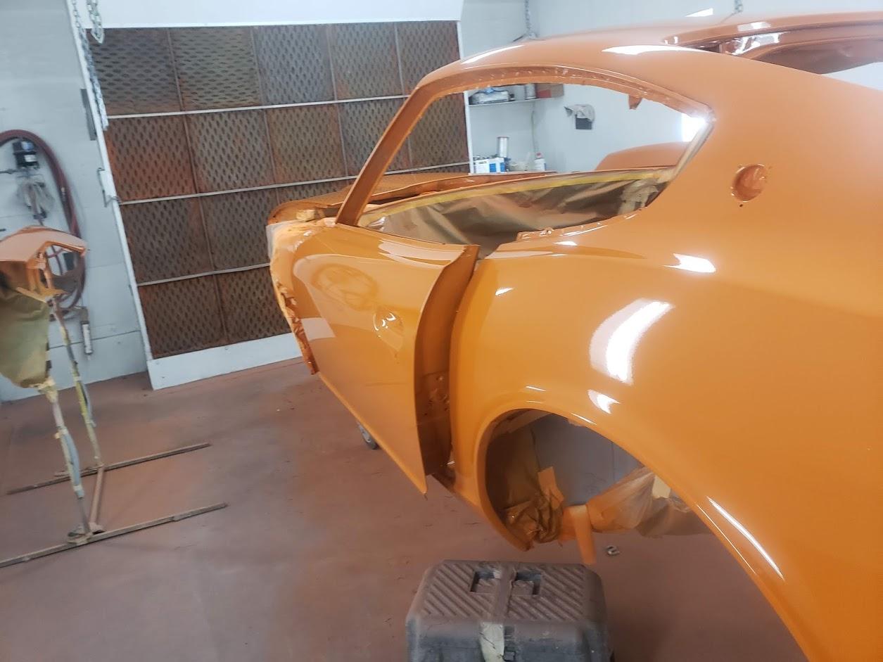

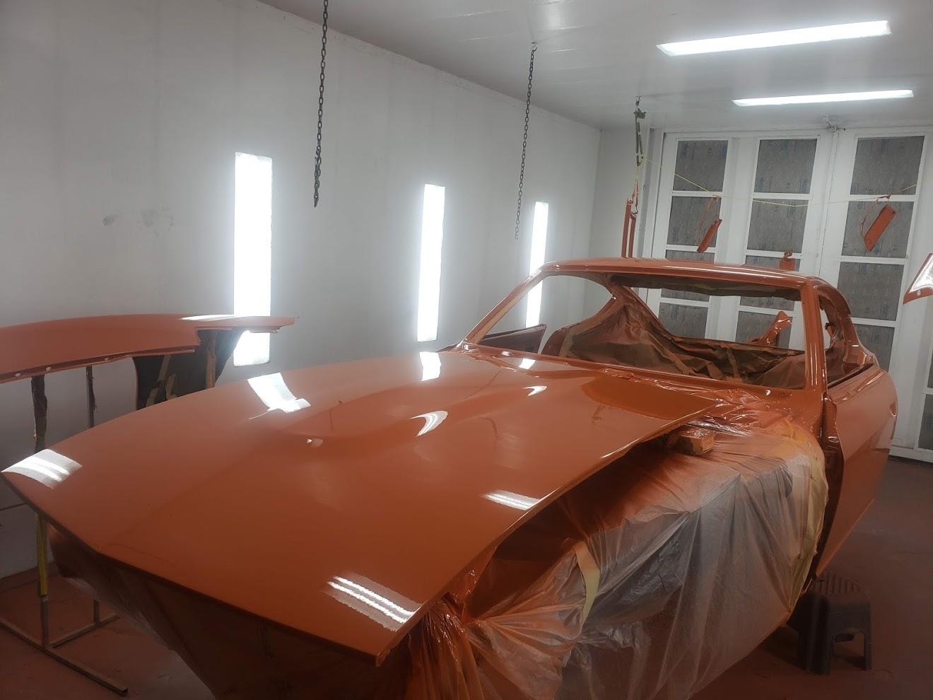

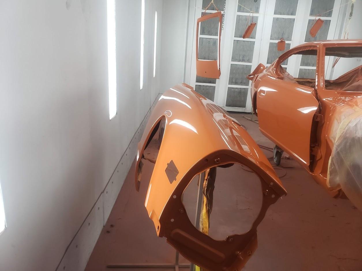

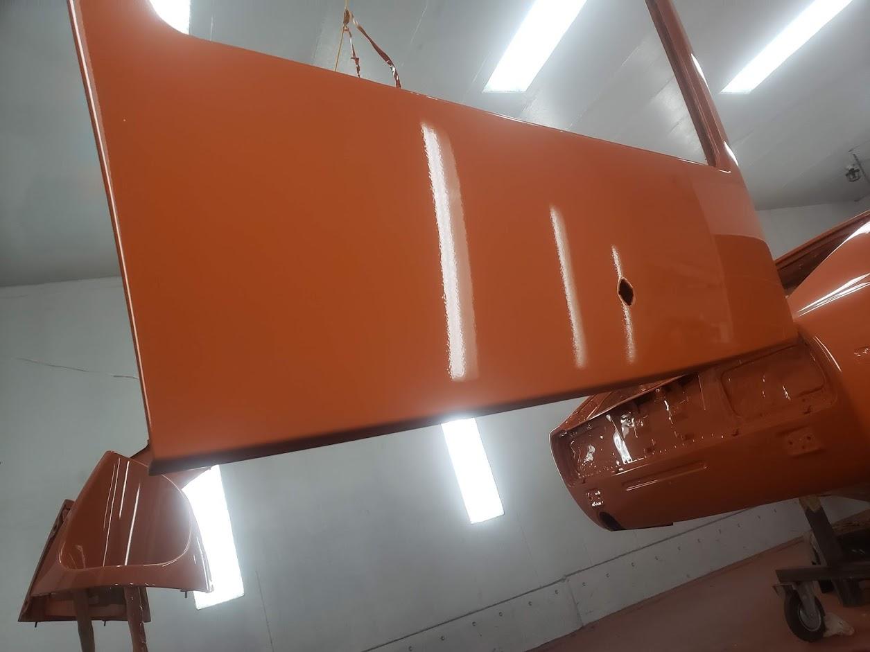

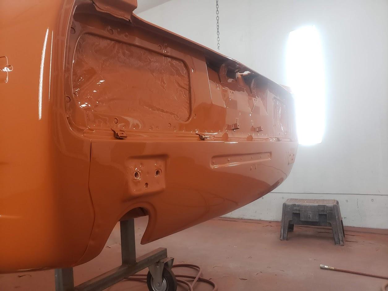

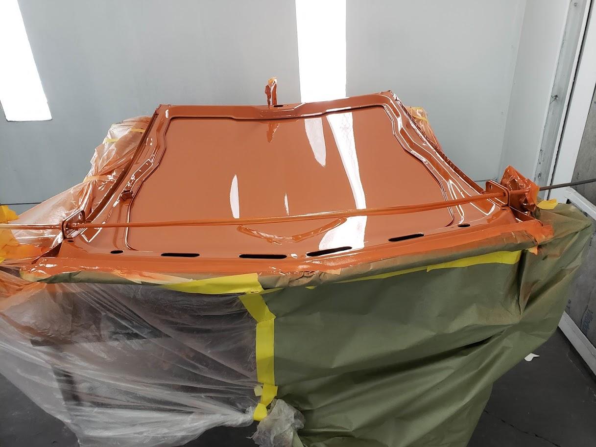

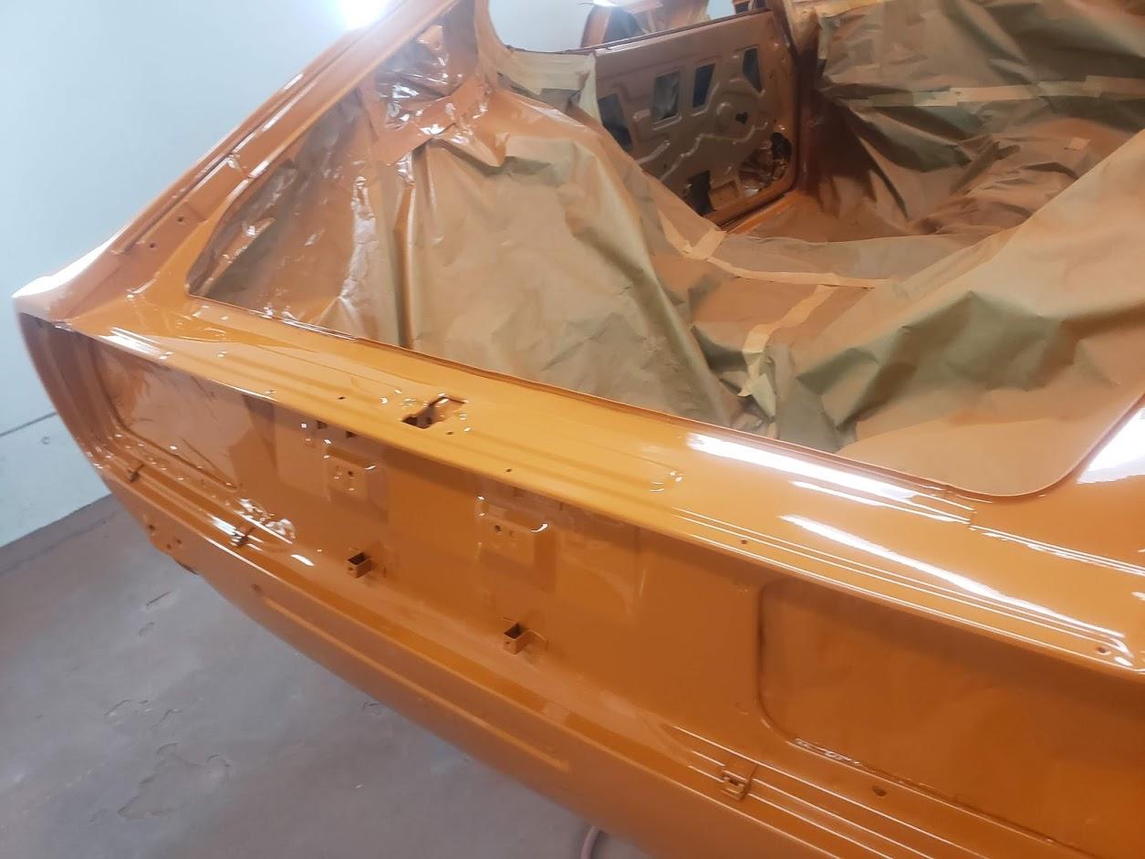

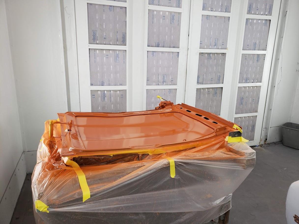

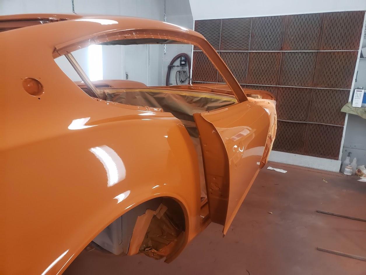

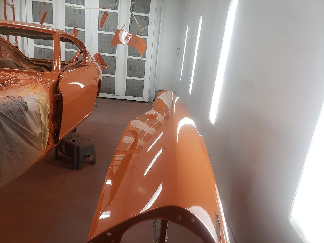

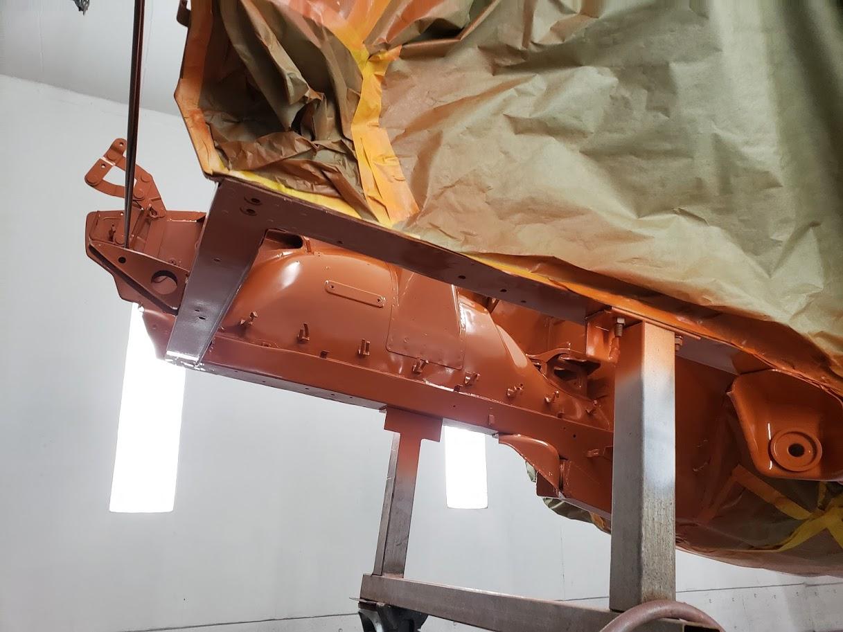

August 3, 20204 yr Author comment_603704 She's Orange! Nice to have the paint done. Will dry and then get color sand. This might be at my place in a couple weeks. I am so ready. Link to comment https://www.classiczcars.com/forums/topic/62992-the-orange/?&page=11#findComment-603704 Share on other sites More sharing options...
August 3, 20204 yr comment_603716 Looks Peachy! I mean really nice. And; peachie... Link to comment https://www.classiczcars.com/forums/topic/62992-the-orange/?&page=11#findComment-603716 Share on other sites More sharing options...
