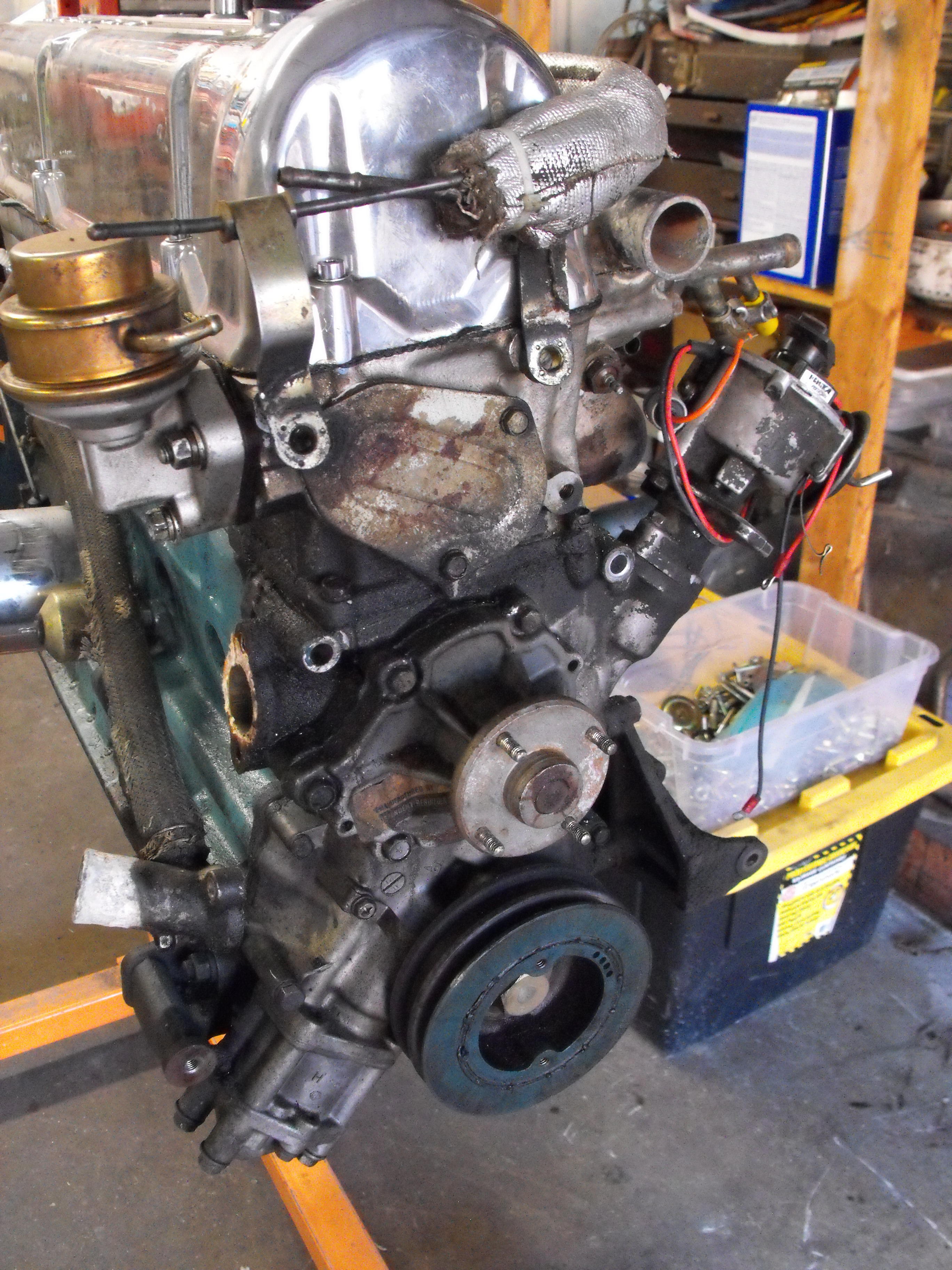

October 23, 20195 yr comment_586218 Are you rebuilding the motor? Link to comment https://www.classiczcars.com/forums/topic/62992-the-orange/?&page=2#findComment-586218 Share on other sites More sharing options...
October 23, 20195 yr Author comment_586220 Just now, TMagda said: Are you rebuilding the motor? Yes. Typically, I will have the cylinders honed and install new bearings (Rod and Crank) and piston rings. I will also have the valves and new seats done on the head, plus whatever else it may need; surfacing, welding, etc. Will also replace the chain tensioner among other things Sometimes the cylinders need to be bored which would require new pistons, however, based on the low miles, I am betting the machine shop just recommends a hone. The only funky thing on the motor was the front crank pulley is a little loose. Seems like the key that holds it in place is either very worn or not installed. The pulley rotated about 5-10 degrees while installed on the crank. Will address that issue once the body is off to the paint shop. Link to comment https://www.classiczcars.com/forums/topic/62992-the-orange/?&page=2#findComment-586220 Share on other sites More sharing options...

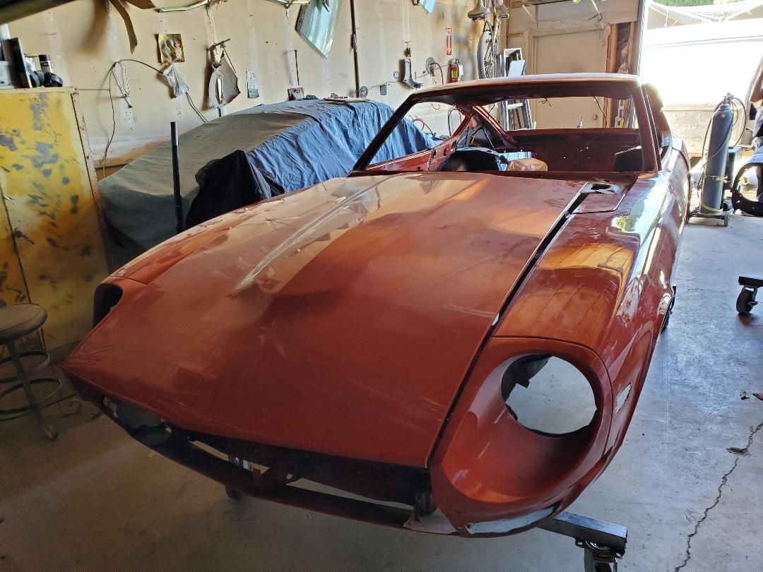

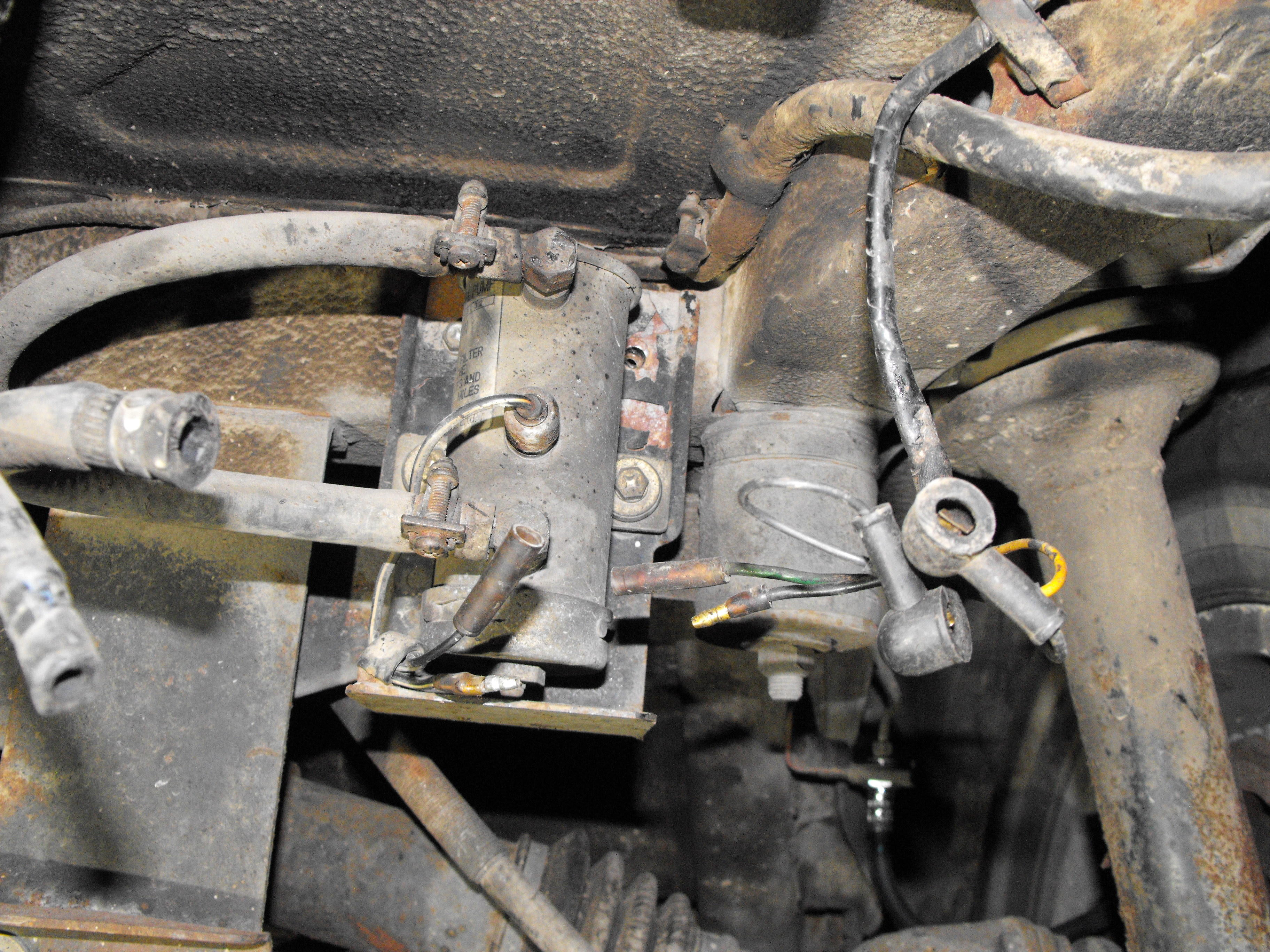

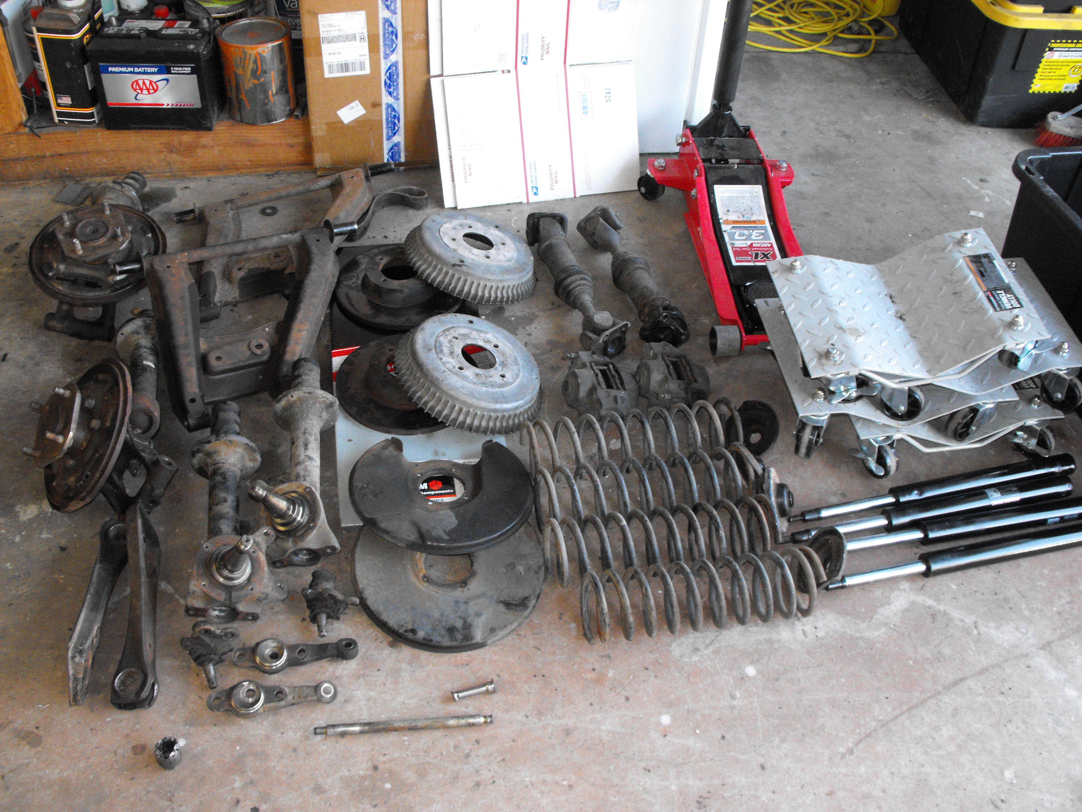

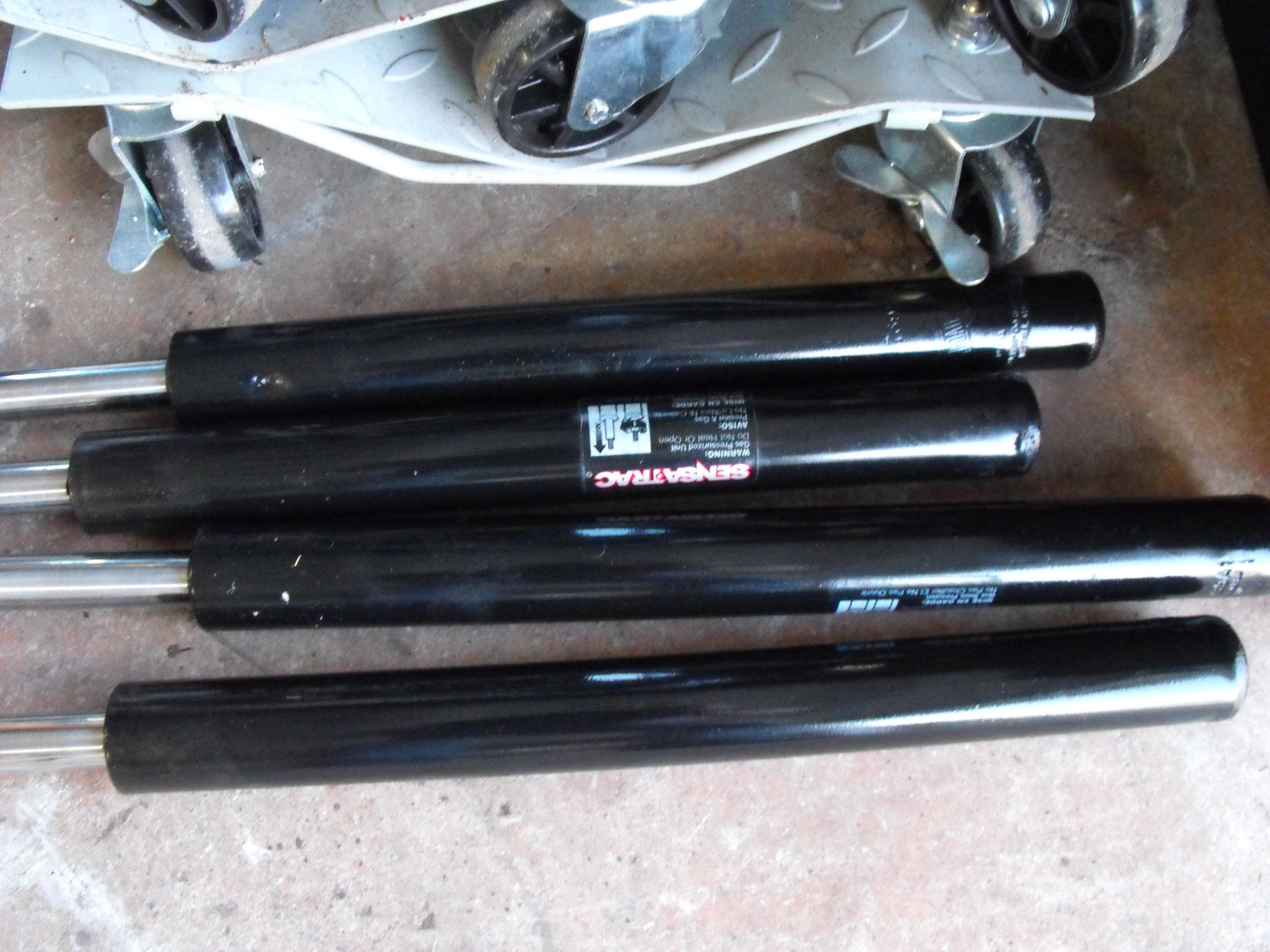

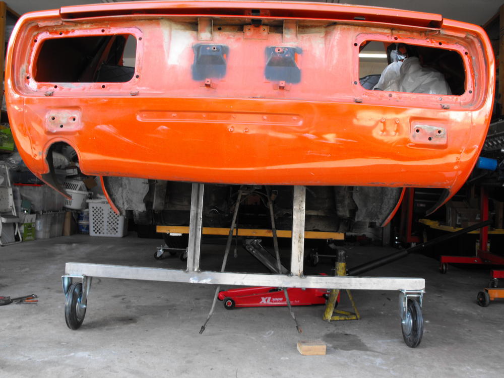

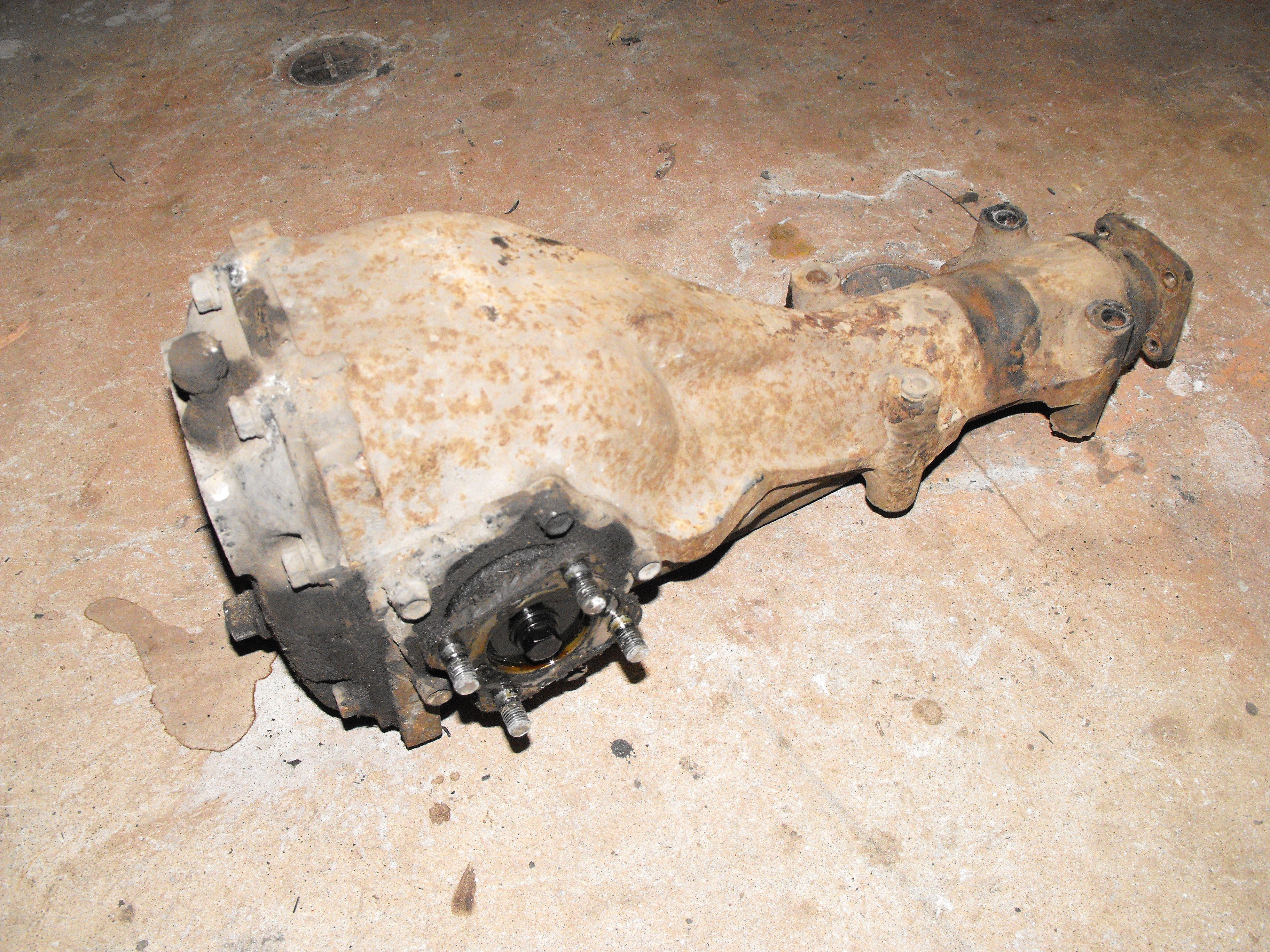

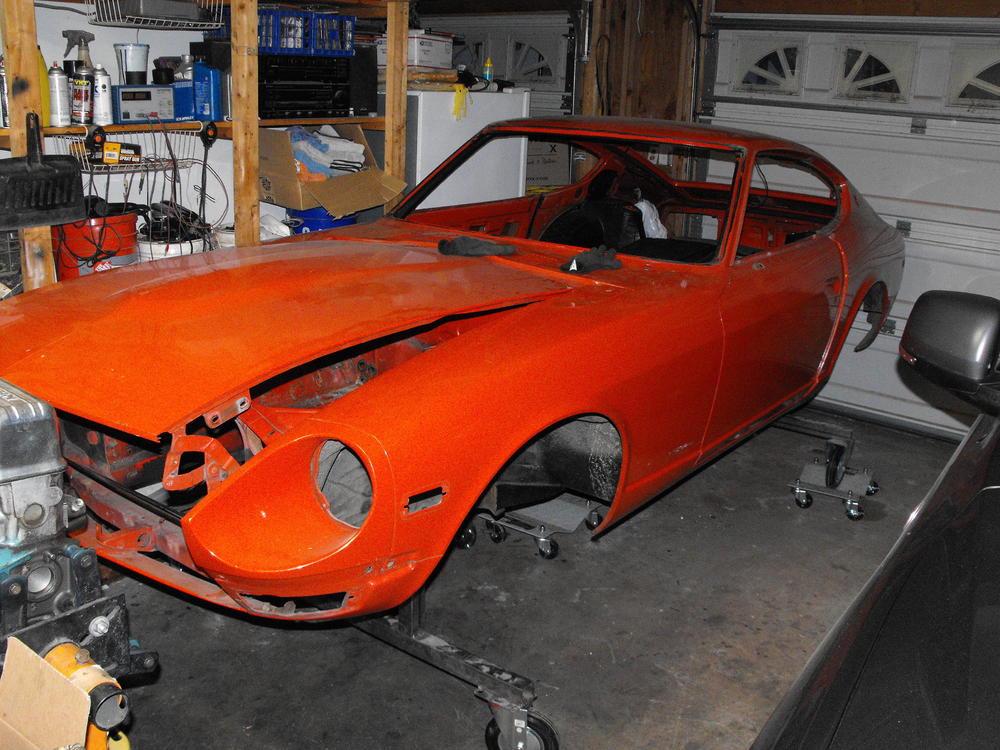

October 28, 20195 yr Author comment_586526 Continued parts removal and now have the car just about completely stripped and ready to ship off to Miguel. I will clean off the remaining weather stripping and do a bit more general clean-up on the body this Tuesday and then have this transported to his shop on Wednesday. Miguel insisted that I install the 'Low Rider' 5 inch rims with solid rubber tires on the body in preparation for paint shop delivery. You can see them in the pictures. I thought the car would look better with some 16 inch Panasports, but he likes these wheels. I did veto the hydraulics, however.....just kidding ? Actually, the stands work out great and it was nice to be able to assemble them on the car at my place. That way I get to keep all of the suspension and fasteners in order. The fuel pump is interesting. It is a different model than the Blue 73 I just did. I should do a bit more research on this. The differential looks like it spent some time at the bottom of the sea. Actually, it is just a lot of dirt. Edited October 28, 20195 yr by motorman7 Link to comment https://www.classiczcars.com/forums/topic/62992-the-orange/?&page=2#findComment-586526 Share on other sites More sharing options...

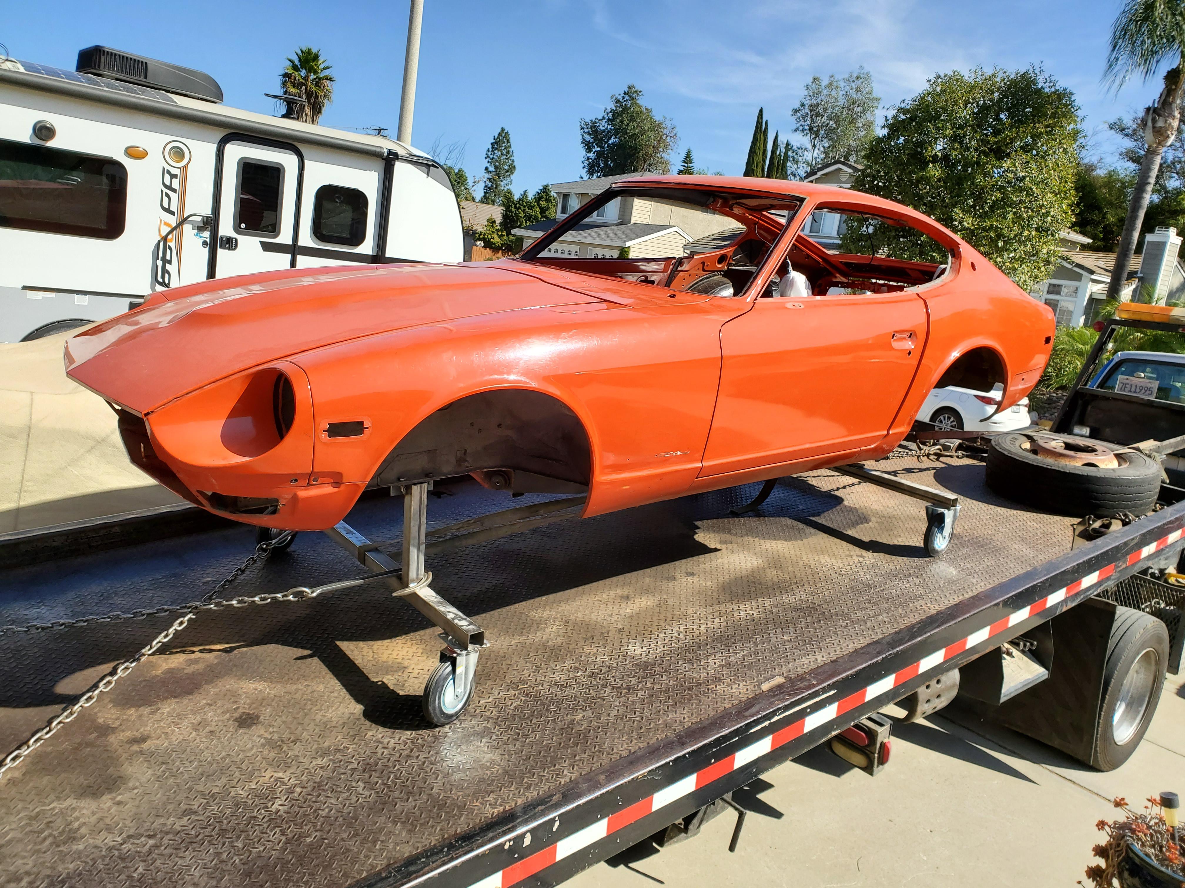

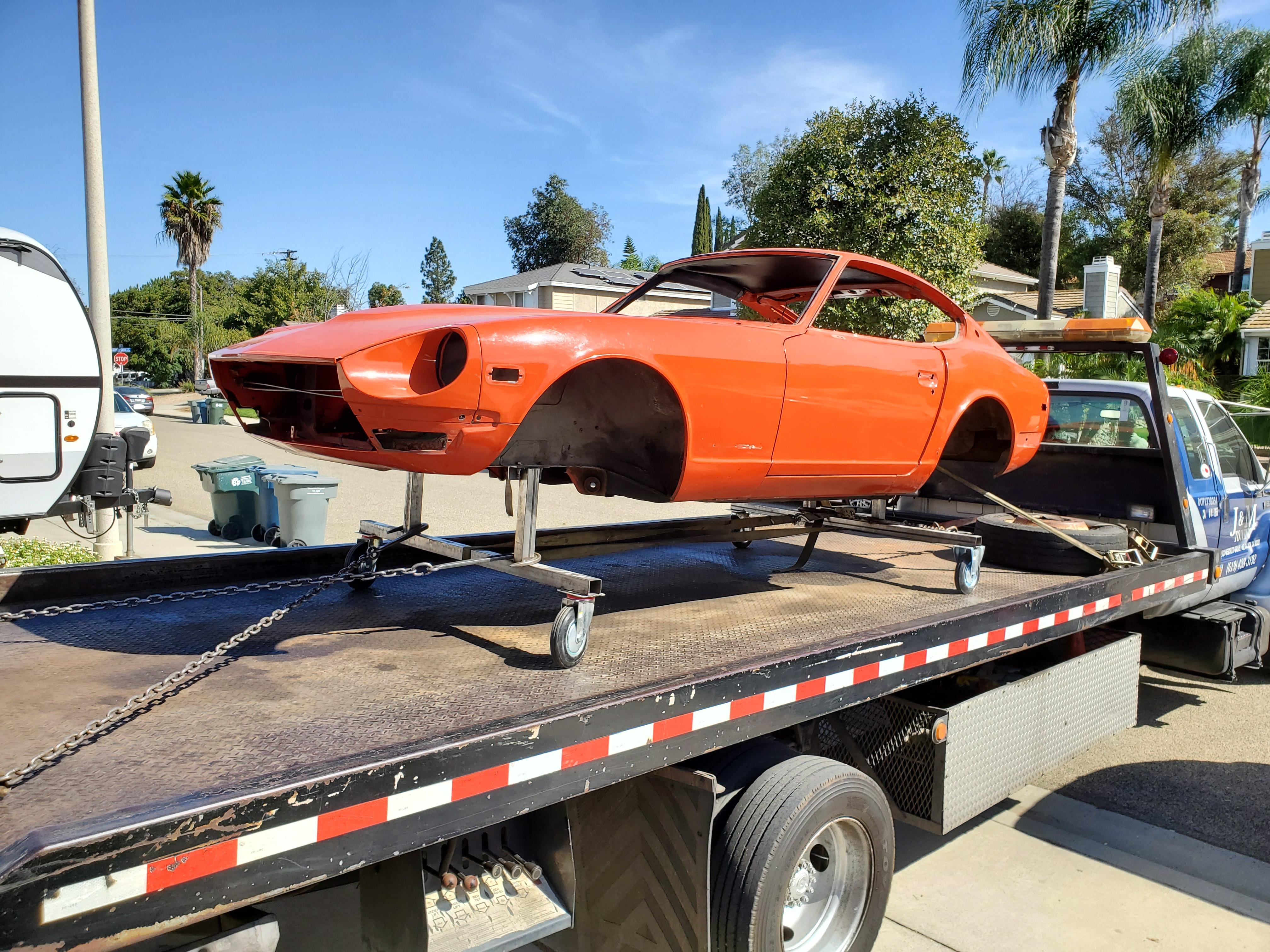

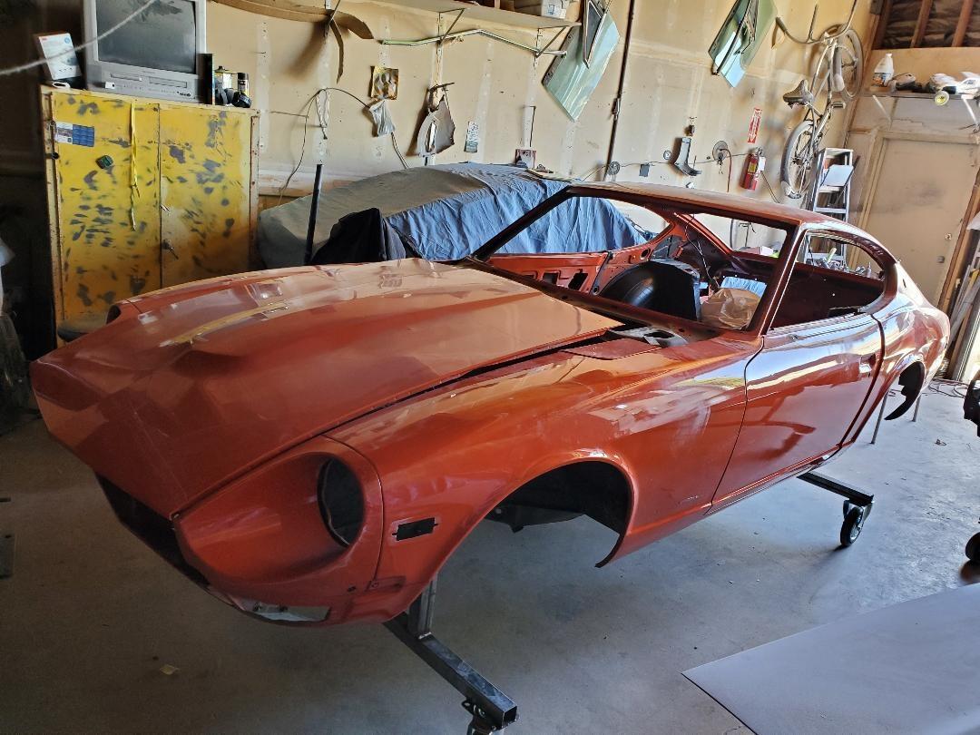

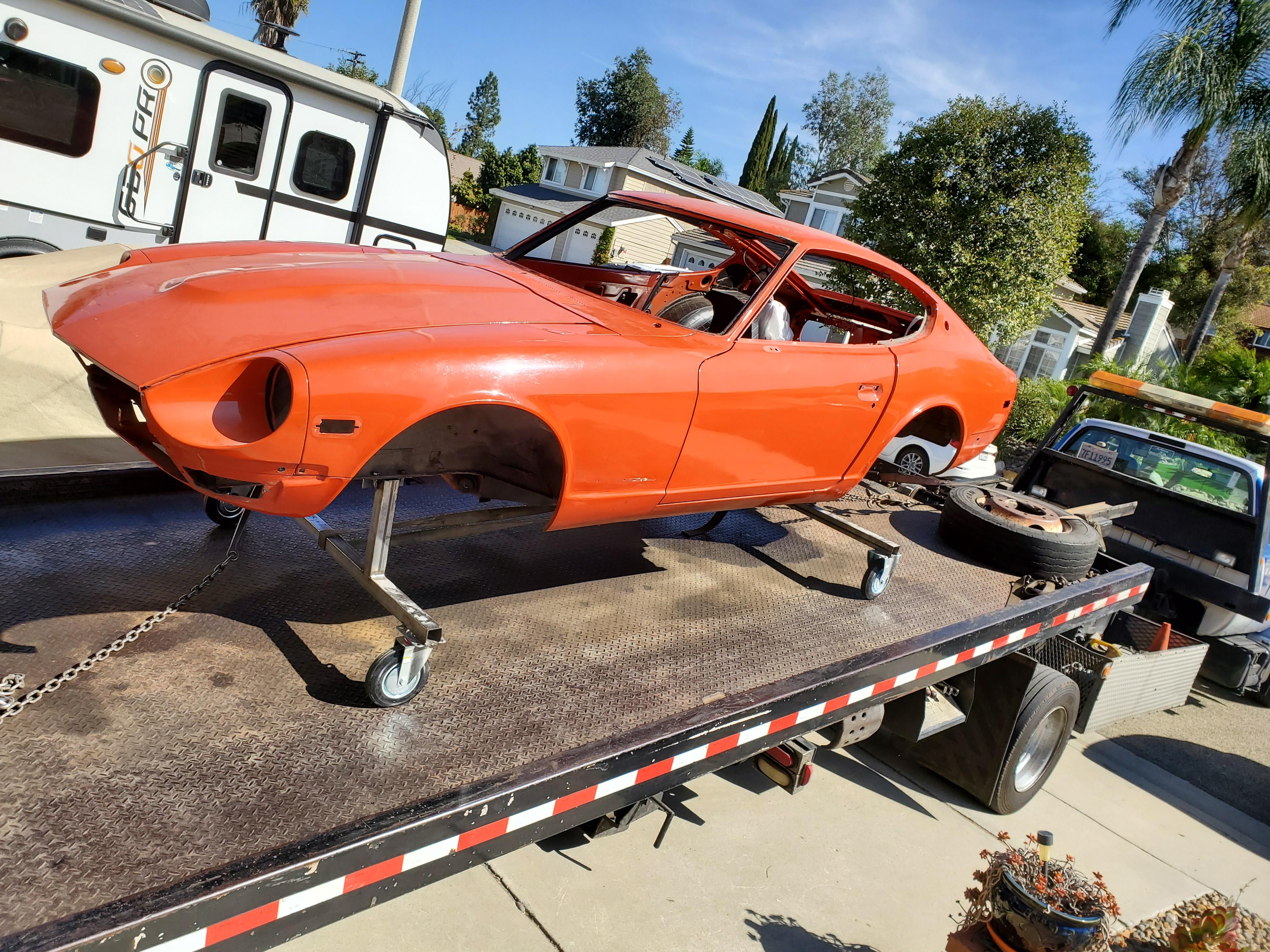

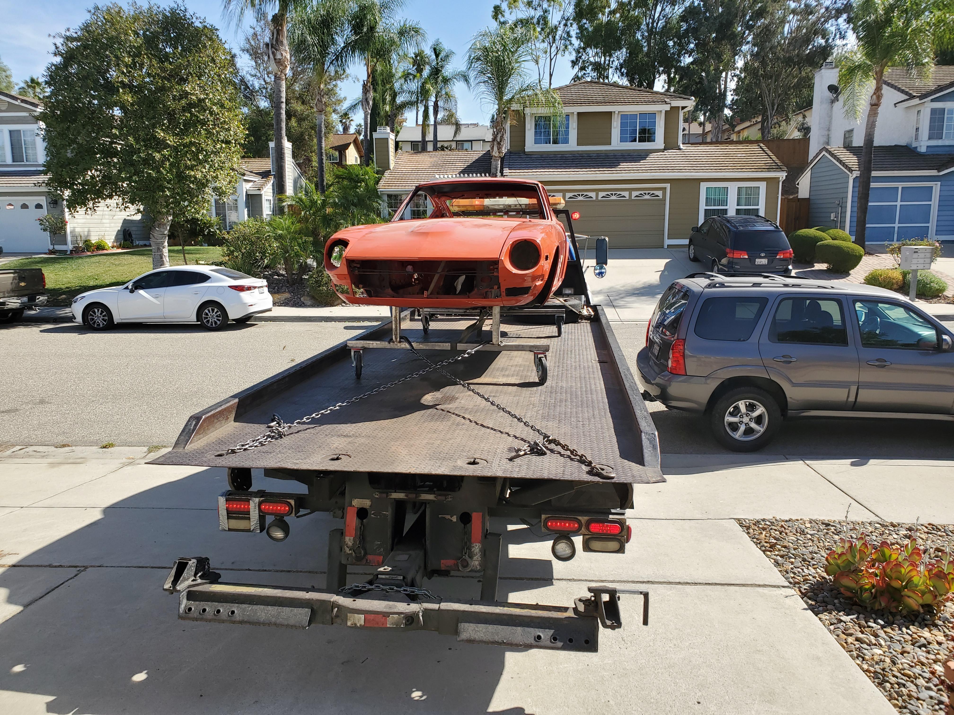

October 30, 20195 yr Author comment_586679 And she's off to the paint shop! Will switch to part detailing here while Miguel starts work on the body. Link to comment https://www.classiczcars.com/forums/topic/62992-the-orange/?&page=2#findComment-586679 Share on other sites More sharing options...

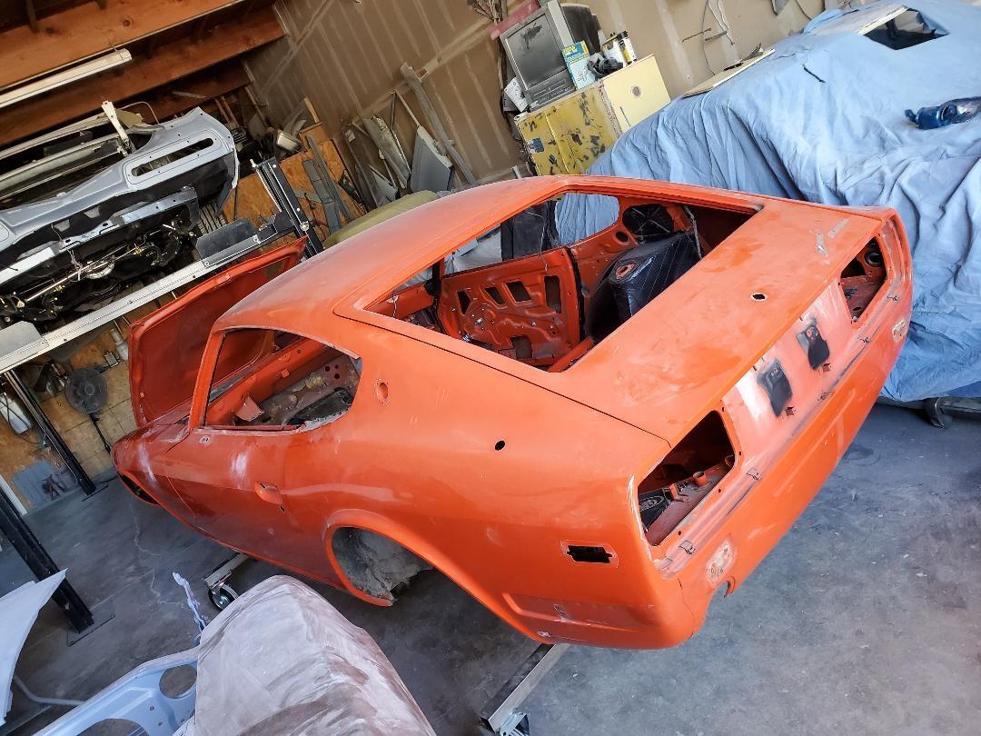

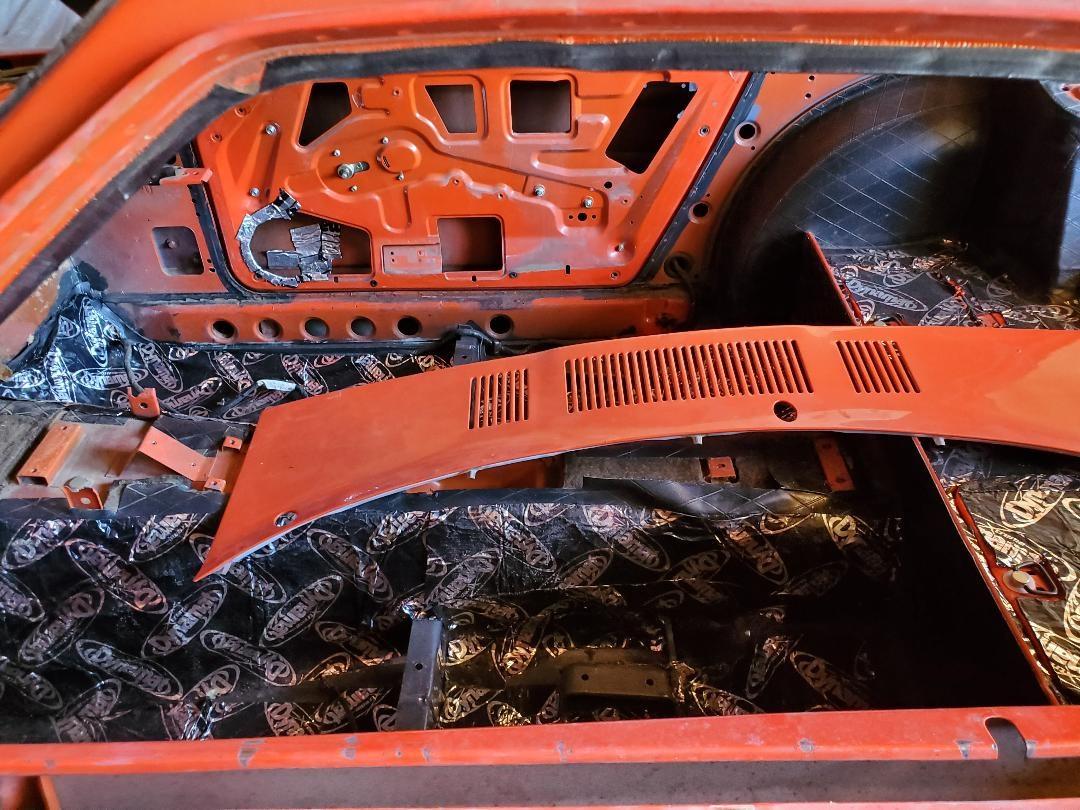

November 1, 20195 yr Author comment_586759 Here are a couple pics from the shop. Went over the car with Miguel and discussed the plan with the body. Ironically, he said the body looks pretty reasonable with rust in the typical areas which was good to hear. However, the floor was not as nice as I had thought. Apparently the nice flat floor is new and was welded in on top of the existing floor. Will know more once the Dynamat is removed from the drivers and passenger floor and the car comes back from sandblasting. In some of the earlier pics that were posted, you can see where the original undercoating was removed (It's very thick) and the newer area is thinly coated. Edited November 1, 20195 yr by motorman7 Link to comment https://www.classiczcars.com/forums/topic/62992-the-orange/?&page=2#findComment-586759 Share on other sites More sharing options...

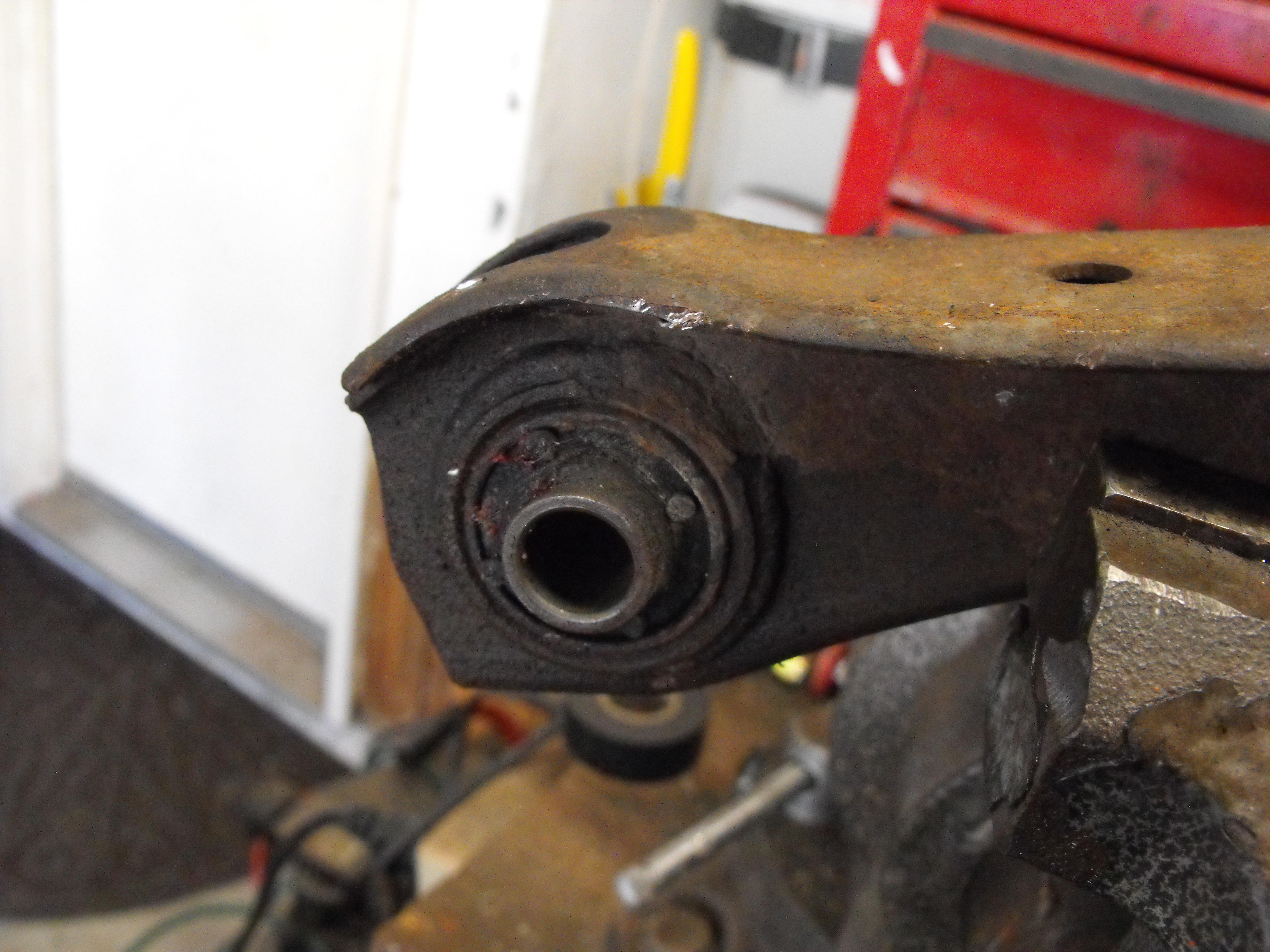

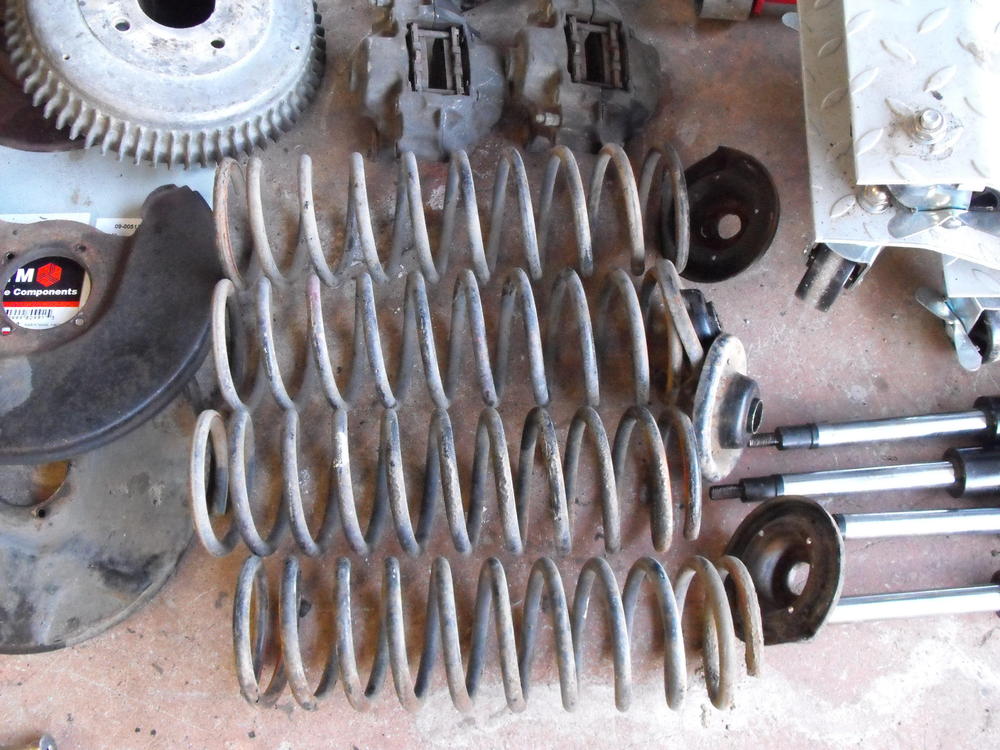

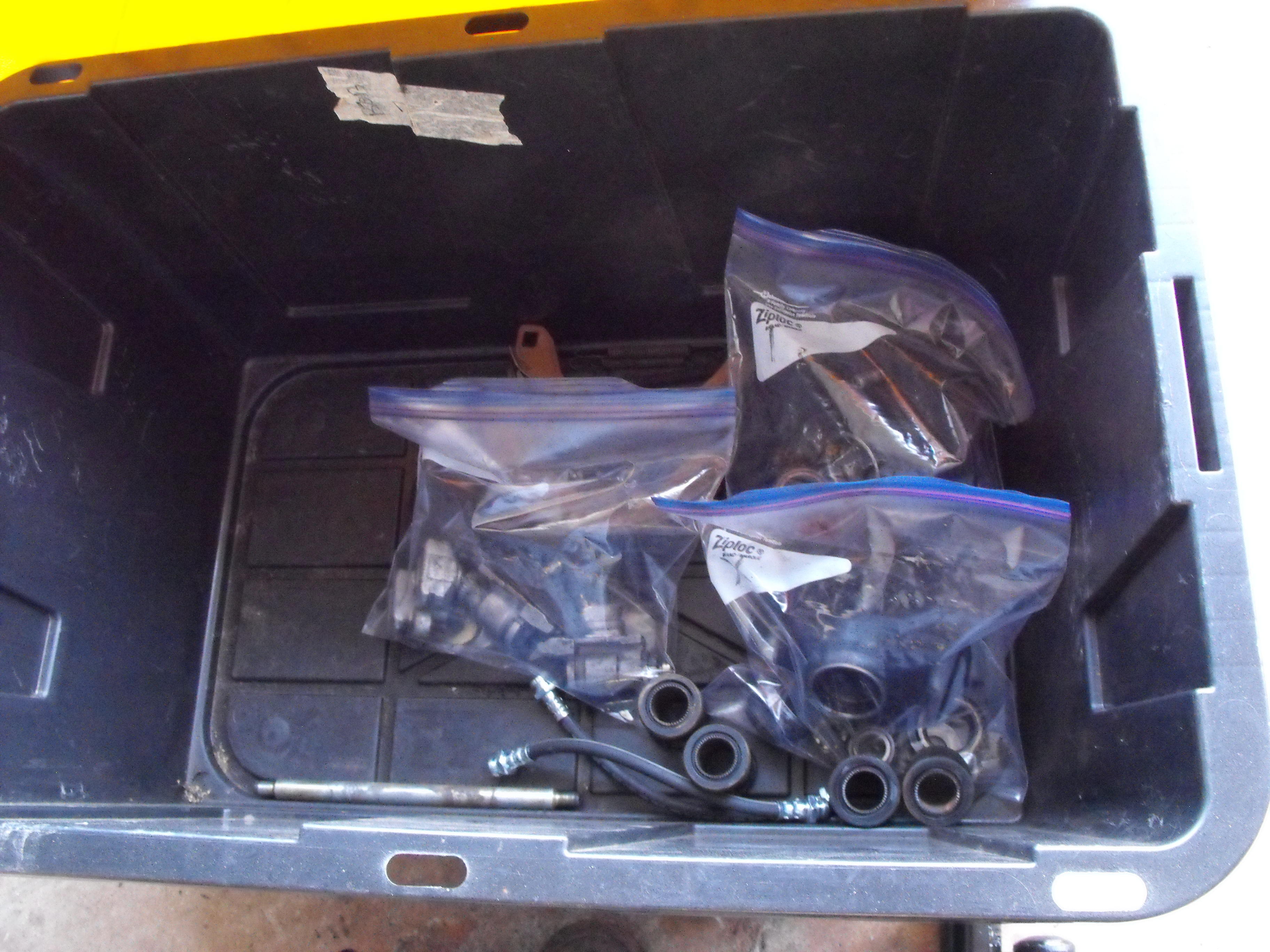

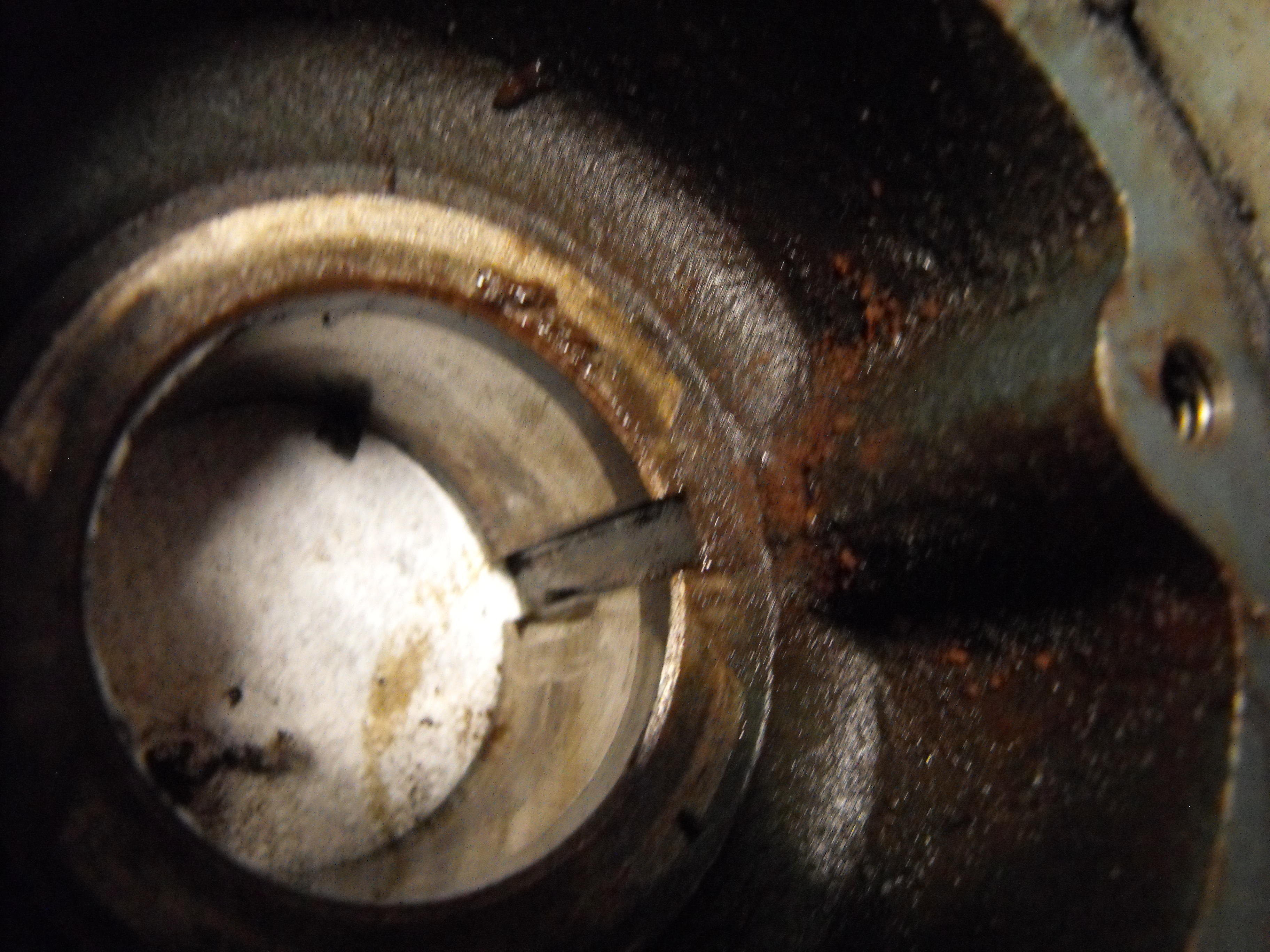

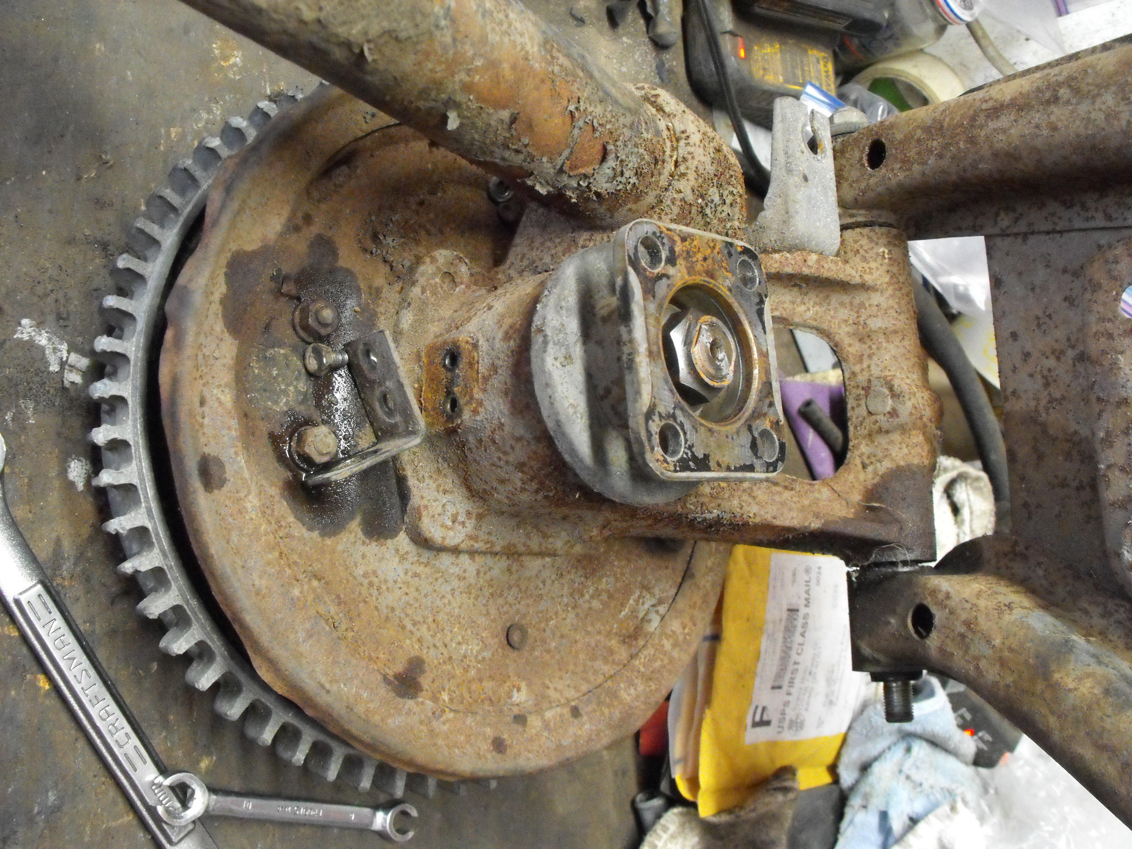

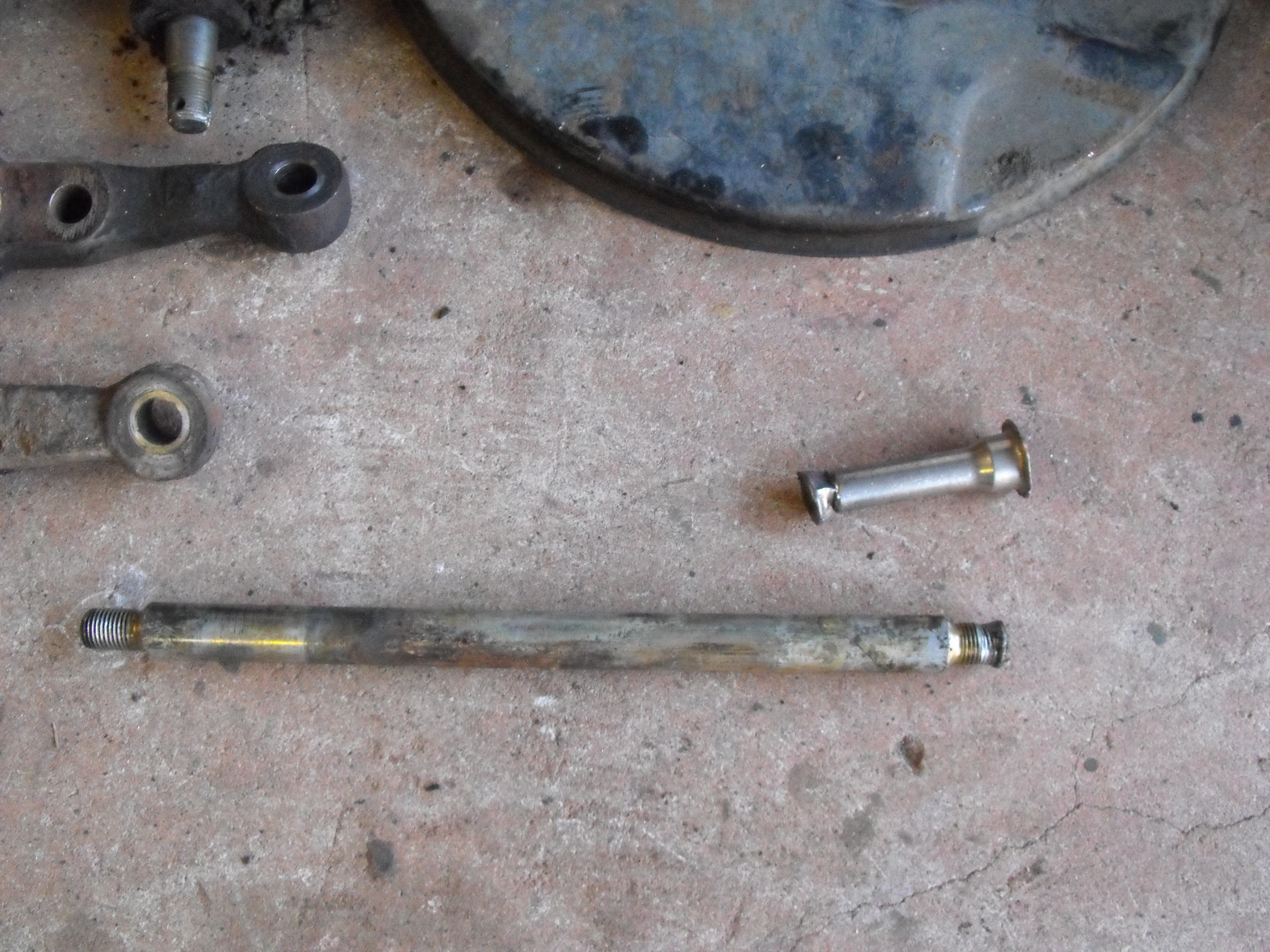

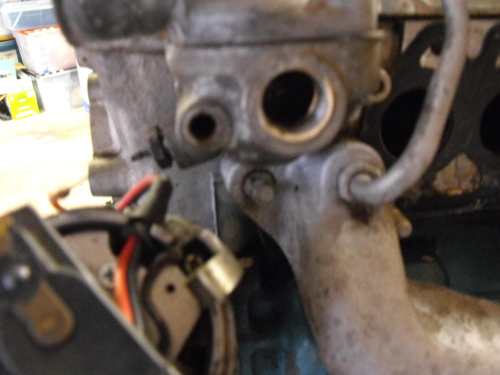

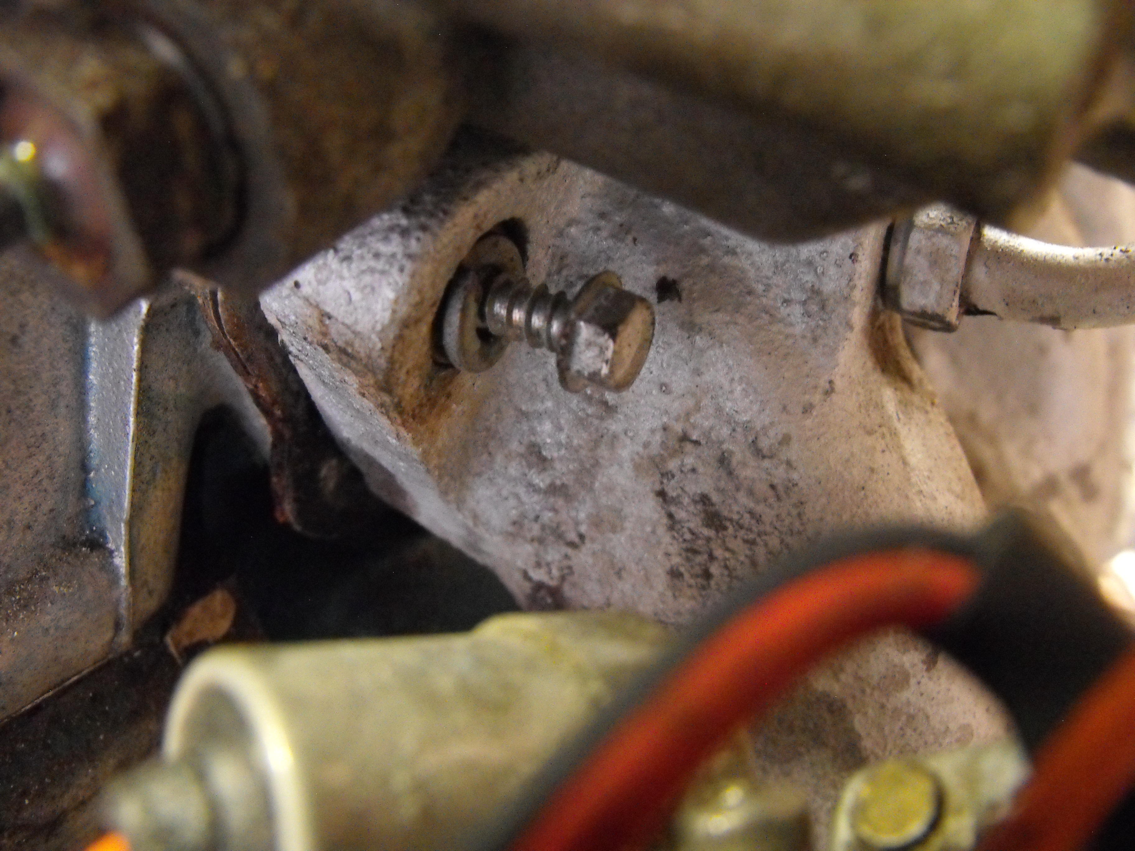

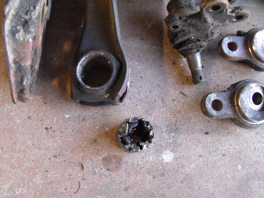

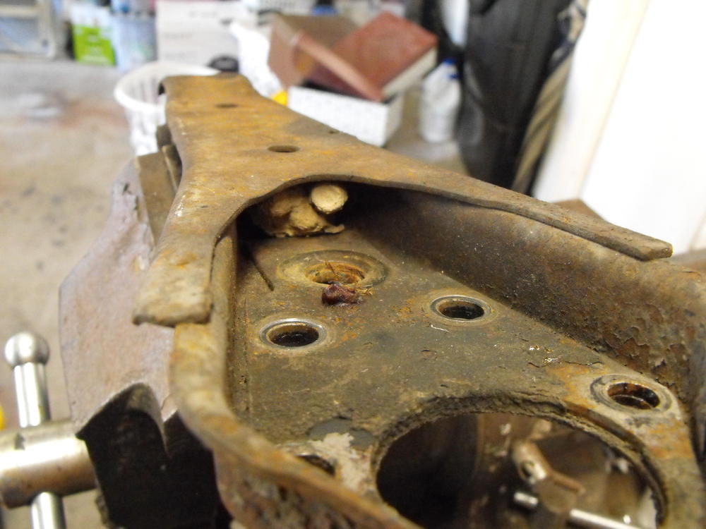

November 4, 20195 yr Author comment_586905 Disassembled all of the suspension components today. Most of this will be sent out for powder coating. Will look nice when it comes back. Got both the spindle pins out. As always, one was pretty easy to remove and is probably re-usable. The other took a lot of pounding to remove as you can see in the pics. Probably won't be using that short extension anymore. Same thing with the front suspension lower arm, one bushing came out pretty easy, the other was a challenge. (wasp nest included) Not sure why this happened to the front crank key, but definitely will replace this part. I am thinking that the pulley bolt was not torqued which led to the key being deformed. Interesting, first time I have seen that. And yes, that is a wood screw 'securing' the manifold to the head. Probably just need to tap the hole so I can put in the correct fastener here. Link to comment https://www.classiczcars.com/forums/topic/62992-the-orange/?&page=2#findComment-586905 Share on other sites More sharing options...
