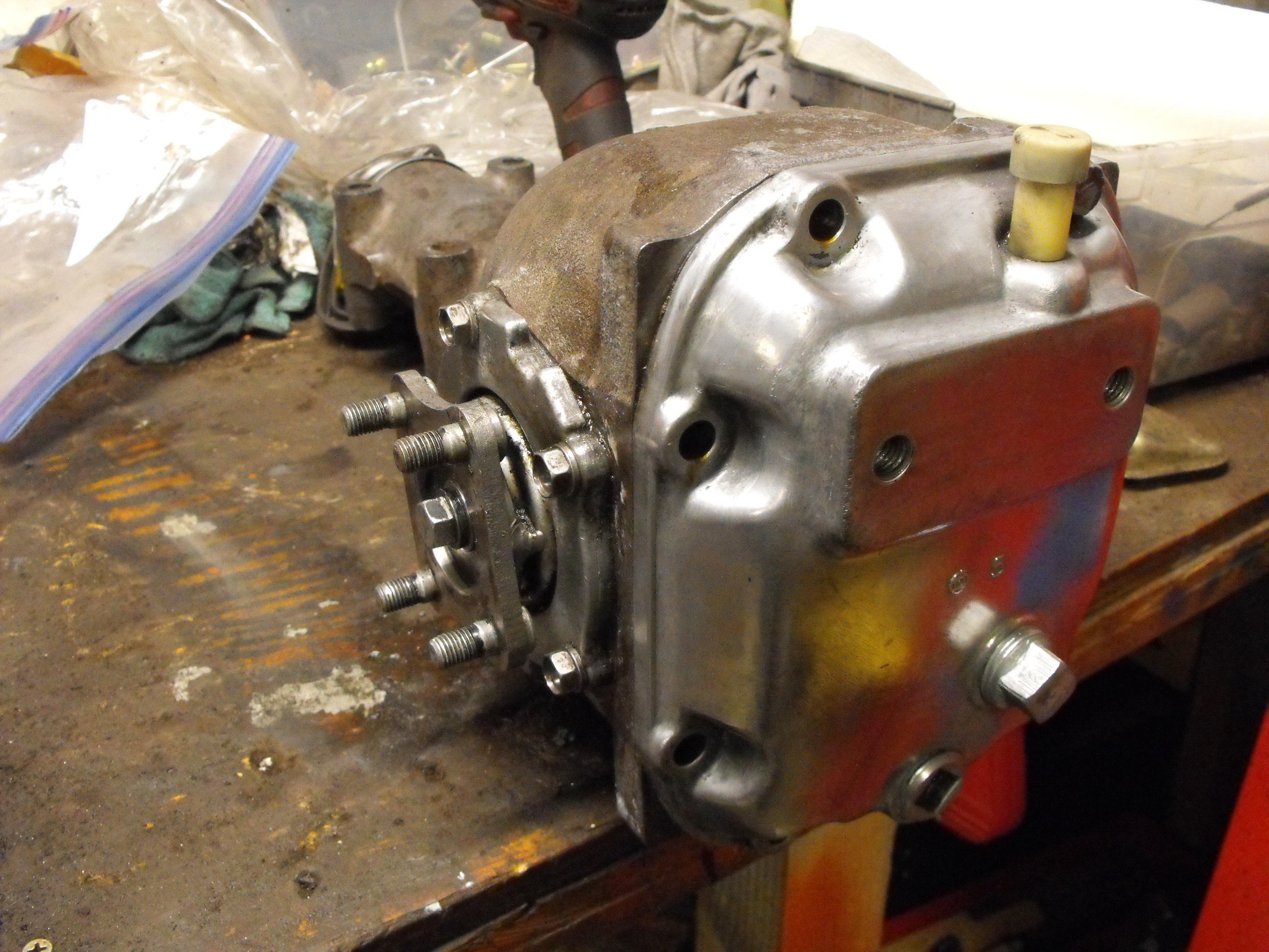

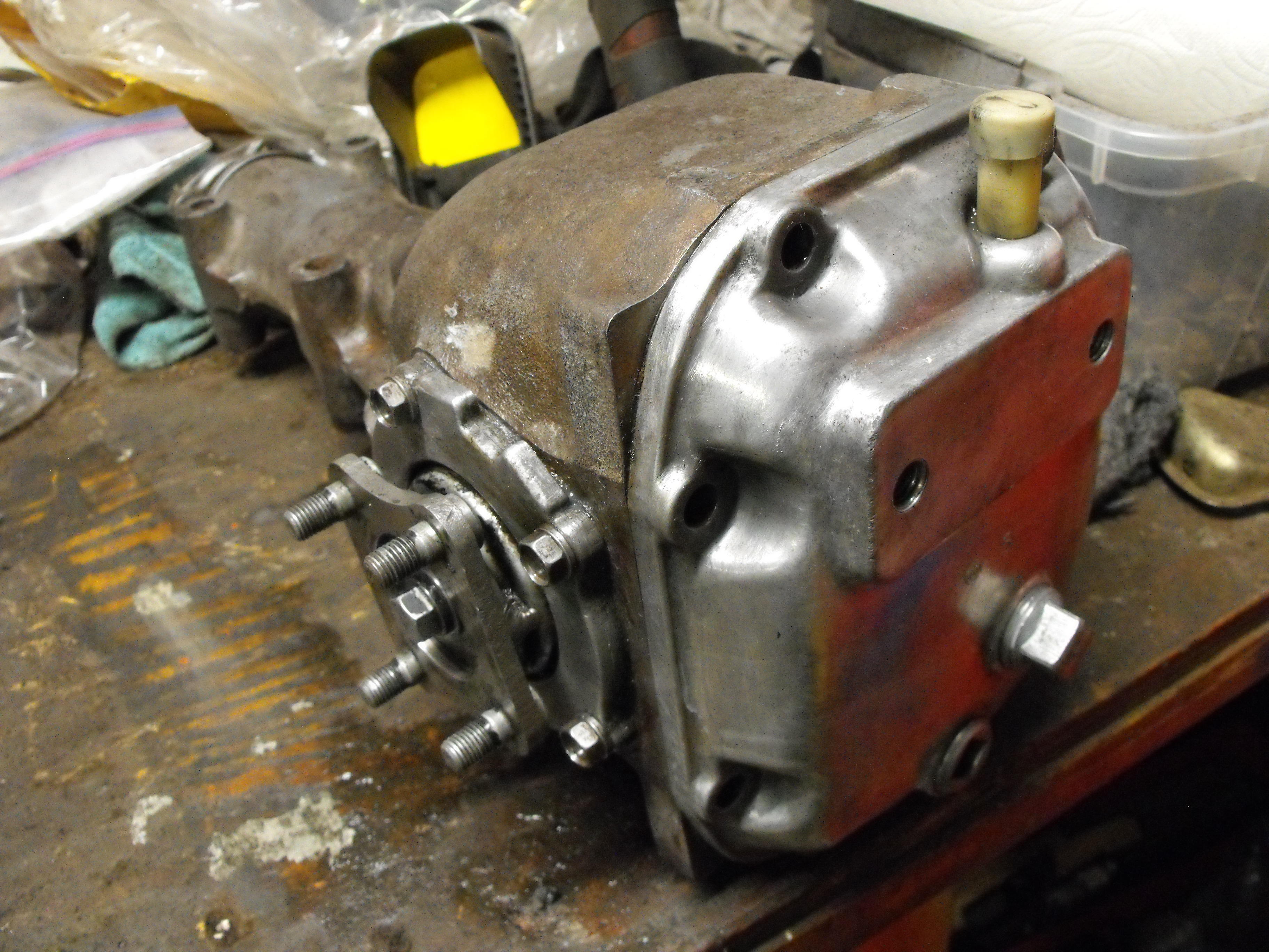

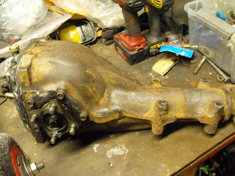

Started cleaning up the differential.  I will leave the back cover bare aluminum and paint the main housing the standard black color.  Would have painted the diff tonight but it is actually raining out.  Doesn't happen very often here in So-Cal.  Cover bolts are out at the plating shop and should be back in a couple weeks.
The Energy Suspension Kit and shocks will arrive tomorrow.  Hopefully the engine will be back from the machine shop by the end of the week,
15 minutes ago, Patcon said:
I am working on a similar looking diff. I was going to use a wire wheel to clean it up. What did you use?
Do all of the mounting studs thread out of the covers?
Yes, used wire wheels for clean-up.  I have a number of different styles and used most of them.  Will use the steel wool and phosphoric acid for final rear cover clean-up and shine.  That seems to work well together.
The mounting studs came out 'by themselves'.  The locknuts seem to hold on to the studs better than the rear cover.

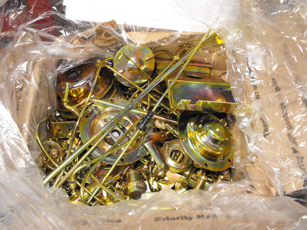

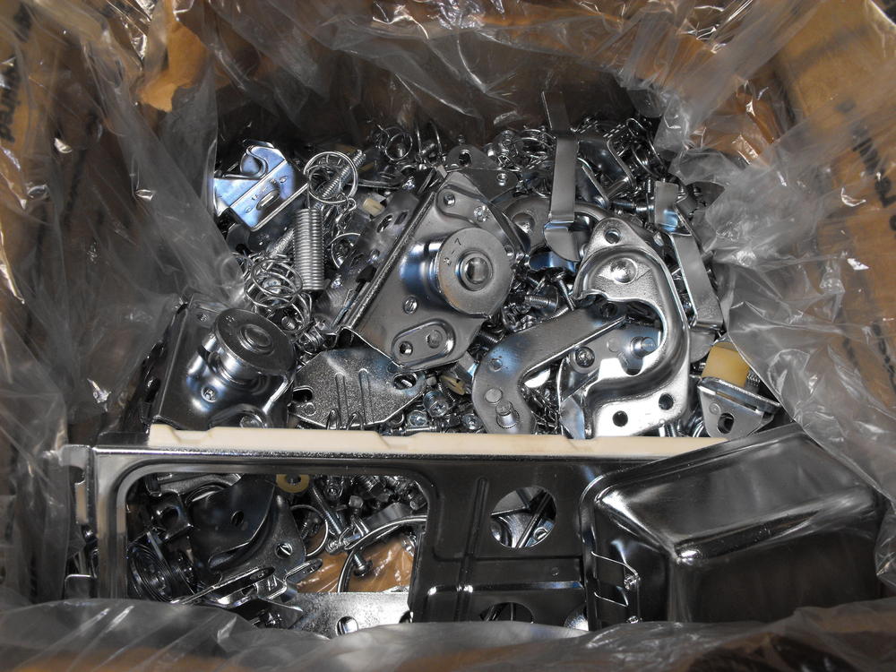

Still cleaning up parts here while I am waiting for the zinc plated parts to return from the plating shop.  Got the engine re-build kit on order along with new brakes pads, shoes and their respective rebuild kits.  So, should have a lot of stuff coming in over the next week.

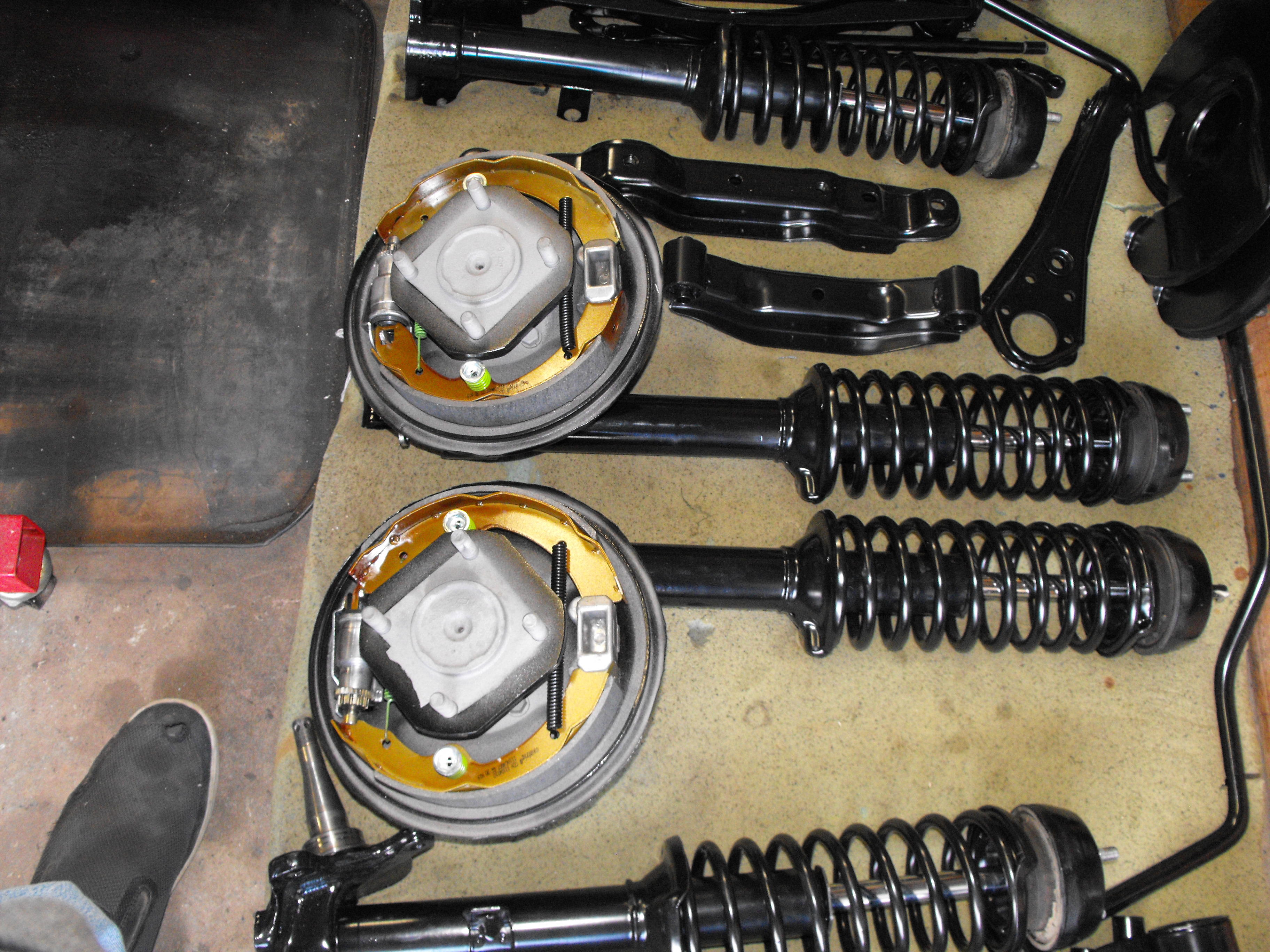

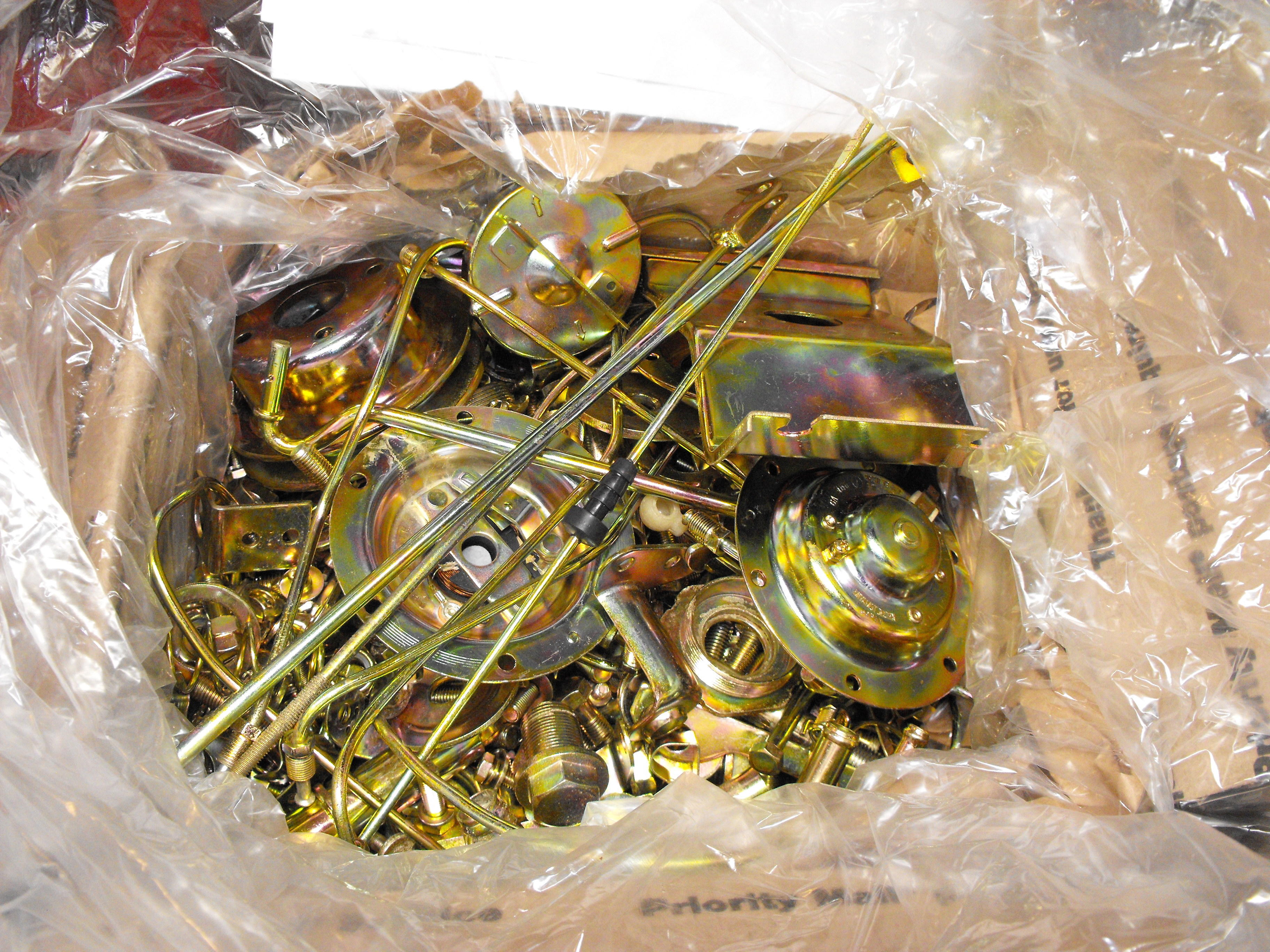

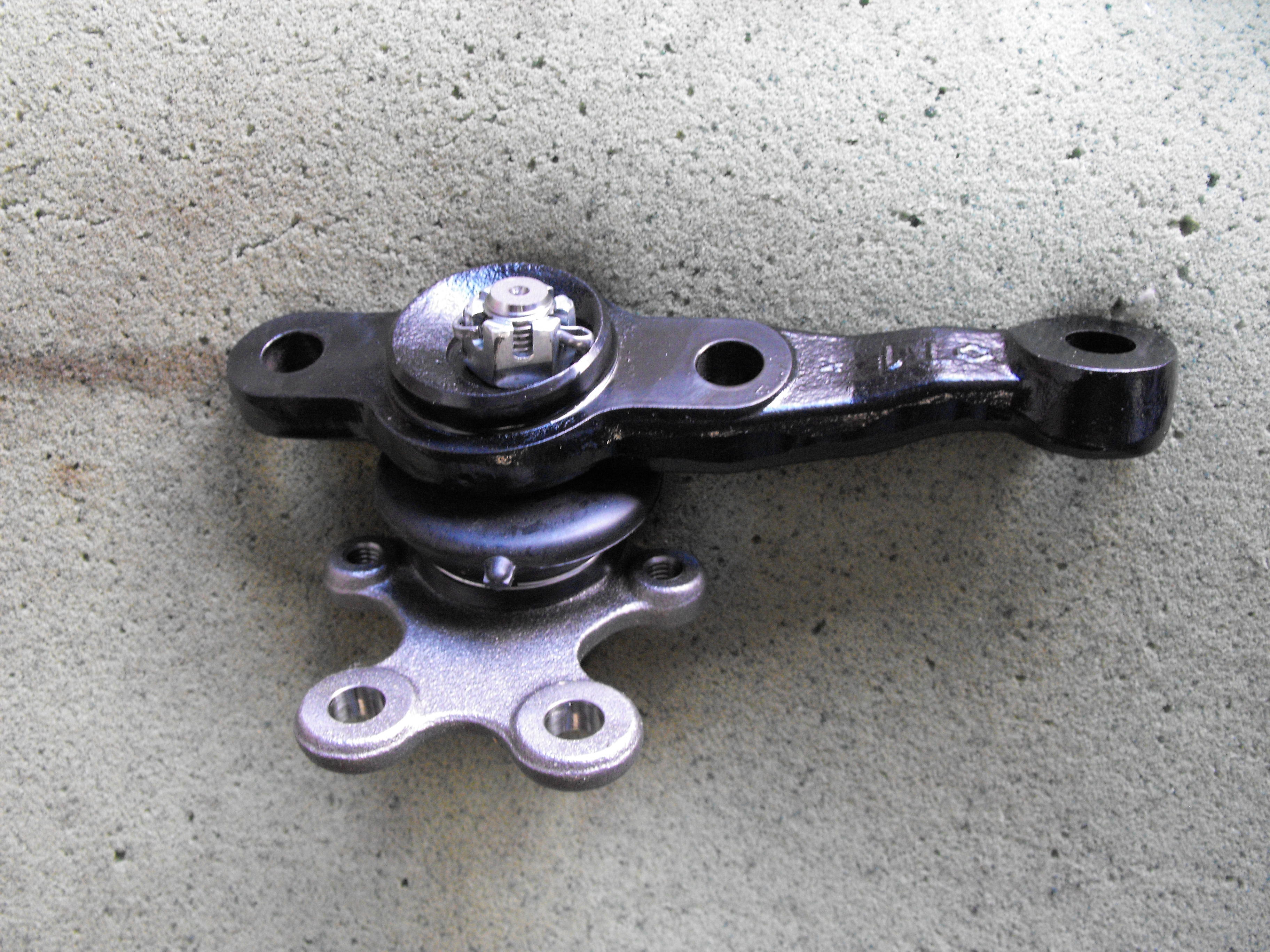

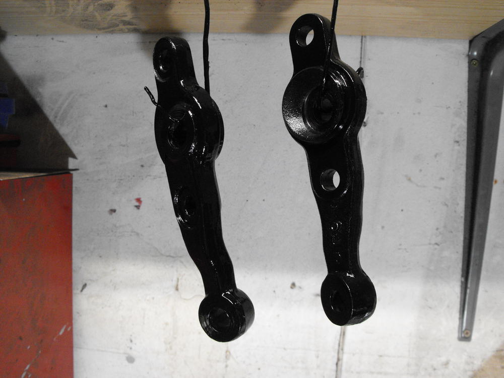

It's like Christmas here....lots of parts coming in. Got the 'clear' zinc back from the plating shop.  Also received more engine parts and suspension parts.  Started installing shocks and will finish up the struts over the next couple days.

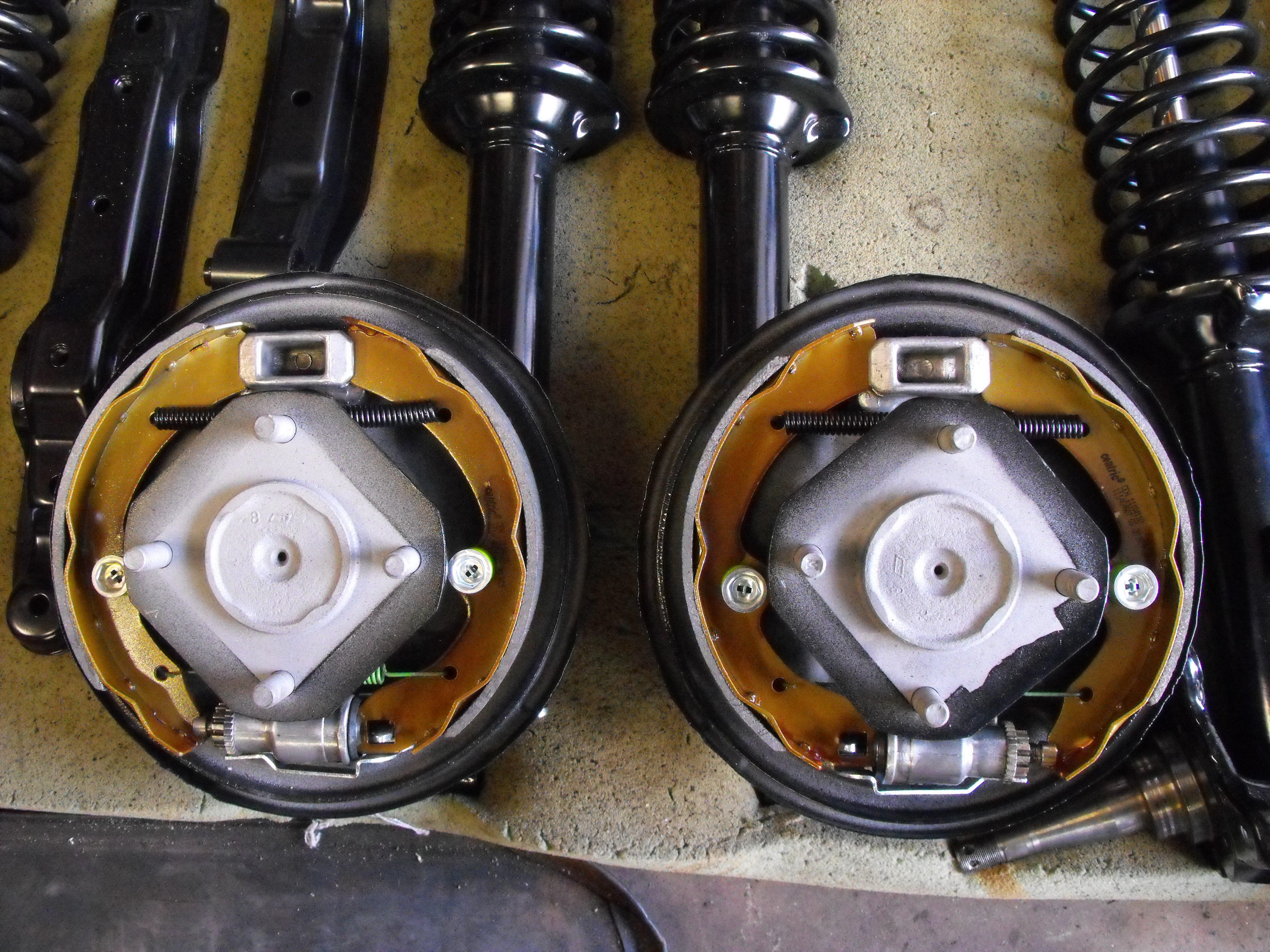

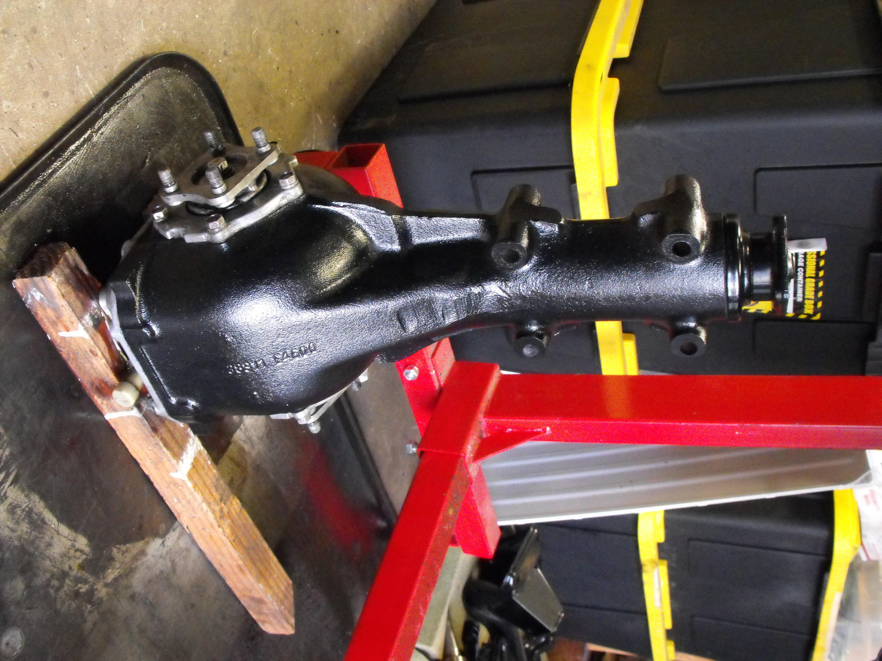

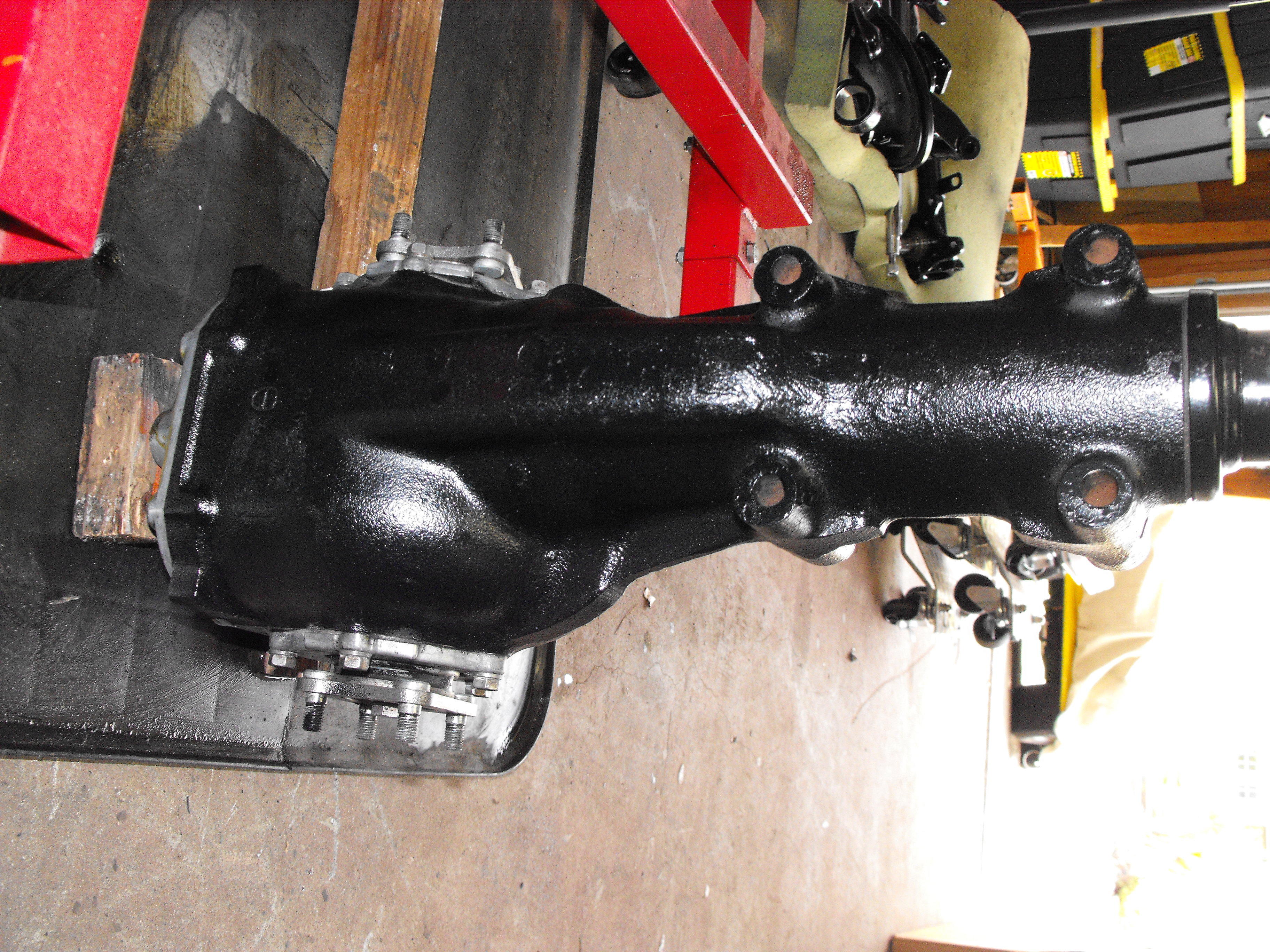

Got the springs on the struts after cleaning and painting the top mount caps.  Re-built both rear brake cylinders and installed new springs and shoes on rear struts.  Also painted the differential.  Started work on the front calipers.  Also got my yellow zinc parts in today so now I can start the suspension assembly.
