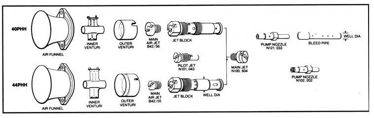

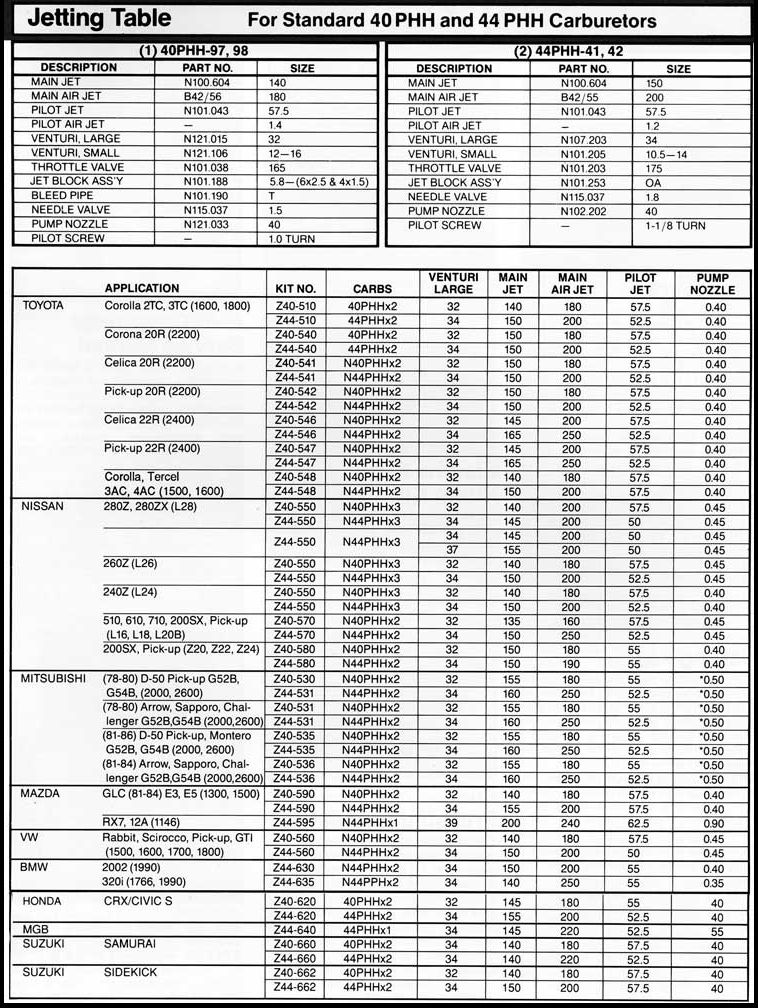

I did find this website with more information about recommended jetting.  It does have recommendations for 240z-280zx.
https://www.upgrademotoring.com/performance/mikuni/mikuni_jettingparts.htm
