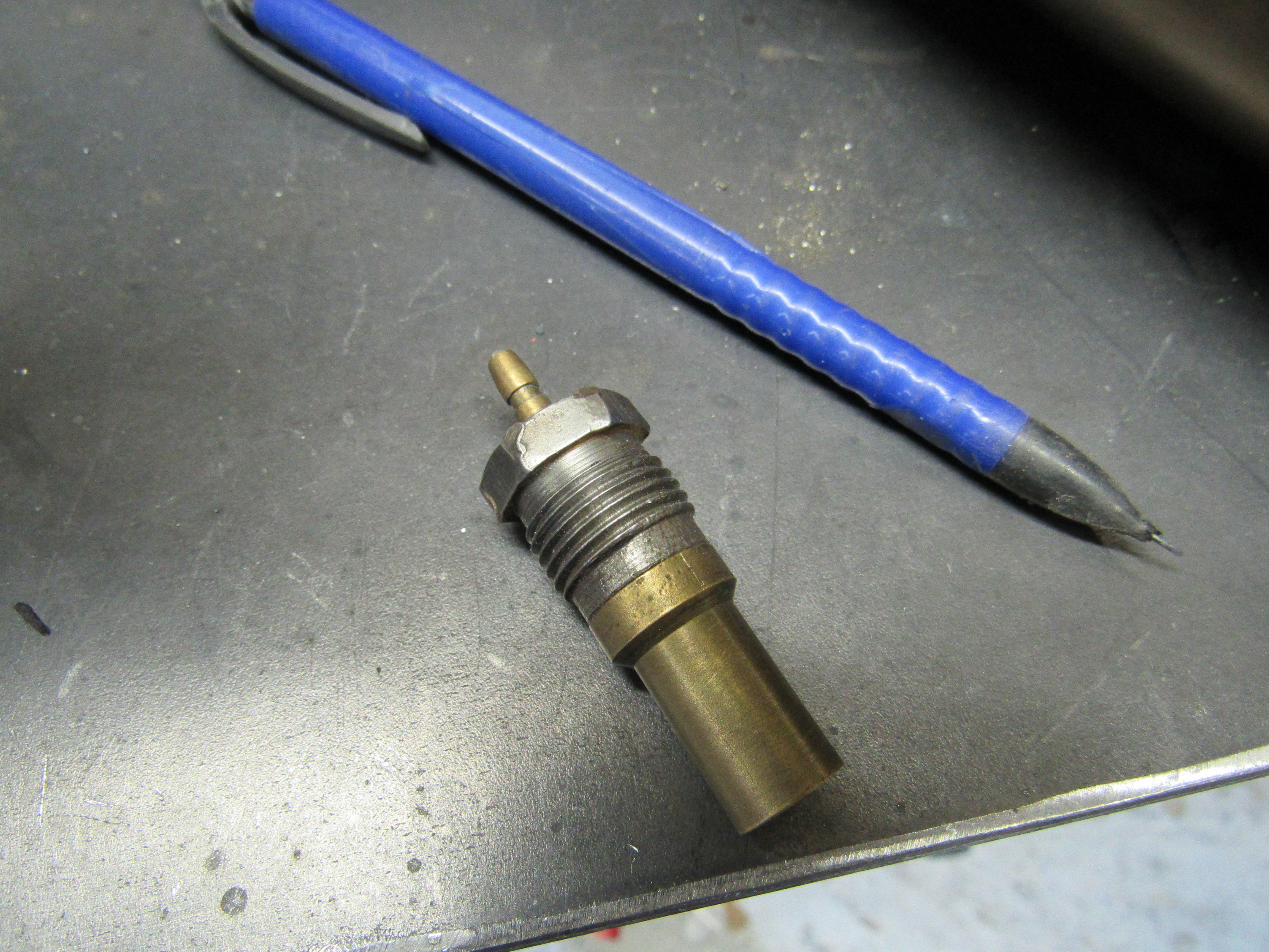

It looks to be M16 x 1.75
I can measure the 1.75 thread pitch, but I don't have a bolt that big to check it fits.  Looks like an M16 as a 16mm deep socket takes it off, and the threads are nearly the same size width as the ‘head’
But as I said, just buy one, it’s like $10

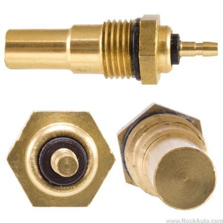

Rockauto-temperature-sender-1T1181
It fits all these Nissan cars: Nissan cars & trucks:
200SX 1977-1983
240Z 1970-1973
260Z 1974
280Z 1975-1978
280ZX 1979-1983
B210 1974-1978
F10 1976-1978
Maxima 1982-1983
Pick Up 1968-1985
Pulsar 1986
Sentra 1982
Stanza 1982, 1984-1986
210 1979-1982
310 1979-1982
510 1968-1973, 1978-1981
610 1973-1976
710 1974-1977
810 1977-1981
1000 Series 1968-1973
2000 Series 1968-1970

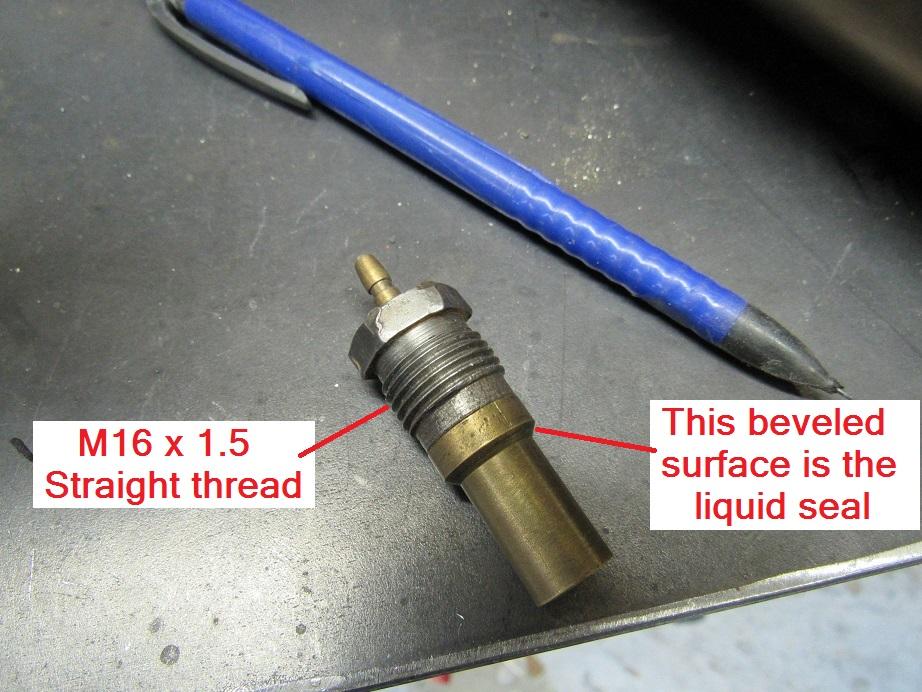

And although nobody asked (rarely stops me), here's some additional info about those sensors.
The original sensors are actually two pieces. A steel threaded portion and a brass sensor portion. The steel part uses a straight thread and the reason they can get away with a straight thread (not tapered) is because that's not what holds back the coolant liquid. The liquid sealing surface actually has nothing to do with the threads. The liquid is sealed by the small beveled edge further down the sensor. Taking liberties with Granny's photo:
Some of the newer aftermarket sensors are all one piece brass like the below. Note that the O-ring does not hold back the coolant. All it does is keeps dirt and junk out of the threads. The same beveled surface is what keeps the coolant in:

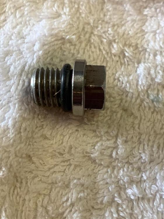

I just confirmed this week that the temp sensor is a M16 x1.5. I went to specialty bolt shop to buy two plugs for my housing since it from a ZX and has extra holes. The guy measured all the holes for me. That’s what he measured for the temp sensor.
They are pretty nice plugs. I went to several places including Fastenal and nobody had anything other than a typical bolt. So they do look like a pan plug and have a flat flange base with a rubber o-ring. They were like $2.50 each. CO if you need some let me know and I’ll grab them for you. I need to reduce my beer tax I have going with you so far.
