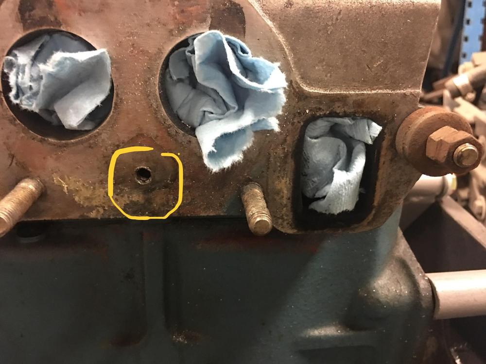

October 26, 20195 yr comment_586397 JB Weld it . Prep is key . Link to comment https://www.classiczcars.com/forums/topic/63053-what-is-this-hole/?&page=3#findComment-586397 Share on other sites More sharing options...
October 26, 20195 yr Author comment_586398 JB Weld it . Prep is key . Fully jb weld it or use it as dealer around the ready rod? Also how would one prep?Sent from my iPhone using Tapatalk Link to comment https://www.classiczcars.com/forums/topic/63053-what-is-this-hole/?&page=3#findComment-586398 Share on other sites More sharing options...

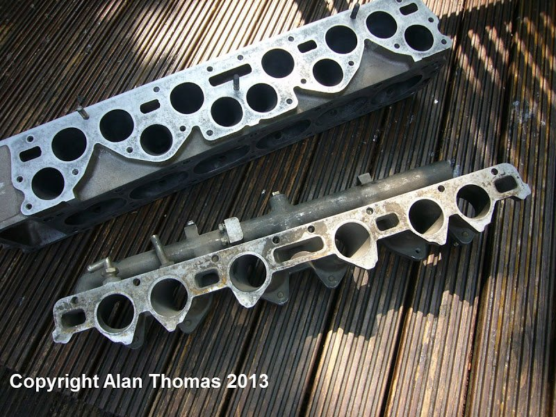

October 26, 20195 yr comment_586399 LY Head HS30-H has posed some info on the net on the Safari E4621 heads and shared cooling connection details: Link to comment https://www.classiczcars.com/forums/topic/63053-what-is-this-hole/?&page=3#findComment-586399 Share on other sites More sharing options...
October 26, 20195 yr comment_586400 40 minutes ago, toastedboy54 said: Fully jb weld it or use it as dealer around the ready rod? Also how would one prep? Sent from my iPhone using Tapatalk I would drain coolant , and use a drill bit or mini file to clean hole and rough insides of hole if you can. Blow it out good and follow instructions with JB. Drilling and tapping would work , but maybe feel more comfortable not drilling . You won’t know if you drill into a completely open cavity or partial which would make tapping a little harder. There’s not much pressure there so some kind of epoxy would work. Also heat wouldn’t be bad since it’s a coolant passage . Just my thoughts Link to comment https://www.classiczcars.com/forums/topic/63053-what-is-this-hole/?&page=3#findComment-586400 Share on other sites More sharing options...
October 26, 20195 yr comment_586402 I had a similar hole in my E88 head from @zKars stroker motor. The original builder may have used a coolant system on the head like others have mentioned. Jim had a leak from under the manifold he could never locate until I took everything apart and found this leak. I used a threaded rod to plug it. Link to comment https://www.classiczcars.com/forums/topic/63053-what-is-this-hole/?&page=3#findComment-586402 Share on other sites More sharing options...
October 26, 20195 yr comment_586403 I have a few recent Hondas that have bleeder screws on the top of the engine to get the air pockets out of the coolant system. Link to comment https://www.classiczcars.com/forums/topic/63053-what-is-this-hole/?&page=3#findComment-586403 Share on other sites More sharing options...
October 26, 20195 yr comment_586405 30 minutes ago, 240260280 said: I have a few recent Hondas that have bleeder screws on the top of the engine to get the air pockets out of the coolant system. My old 240sx had something similar to release gas. if you start drilling and using power tools to clean up there, make sure you throw some rags into the intake and exhaust ports, you don’t want any shards of metal falling in there at all. I think the drill/tap/loctited bolt would work fine. Maybe you should test this out on something old before you do it on your car. Junk yard had a bunch of scrap you can test it out on before you actually go to the head. Link to comment https://www.classiczcars.com/forums/topic/63053-what-is-this-hole/?&page=3#findComment-586405 Share on other sites More sharing options...
October 26, 20195 yr comment_586407 Don't over-complicate things. ~14 psi coolant mixture is all it needs to seal. The bigger you make the hole the more difficult it will be to seal. You could probably put a piece of tape over it and the manifold force on top of the tape would keep it sealed. Or even just a blob of silicone as you place the gasket. It's not a head gasket leak, it's just a coolant leak. Link to comment https://www.classiczcars.com/forums/topic/63053-what-is-this-hole/?&page=3#findComment-586407 Share on other sites More sharing options...
October 26, 20195 yr comment_586408 And, if the metal is thin there you won't have enough to form threads if you decide to drill and tap. Just be sure you have a solid plan before you start. Link to comment https://www.classiczcars.com/forums/topic/63053-what-is-this-hole/?&page=3#findComment-586408 Share on other sites More sharing options...
October 27, 20195 yr Author comment_586468 Ok so good news!! I used some jb quick in a syringe and pushed a tiny bit down the hole and it sealed up. Although the car doesn’t run yet but it does spit and try to thanks for all the help!Sent from my iPhone using Tapatalk Link to comment https://www.classiczcars.com/forums/topic/63053-what-is-this-hole/?&page=3#findComment-586468 Share on other sites More sharing options...
