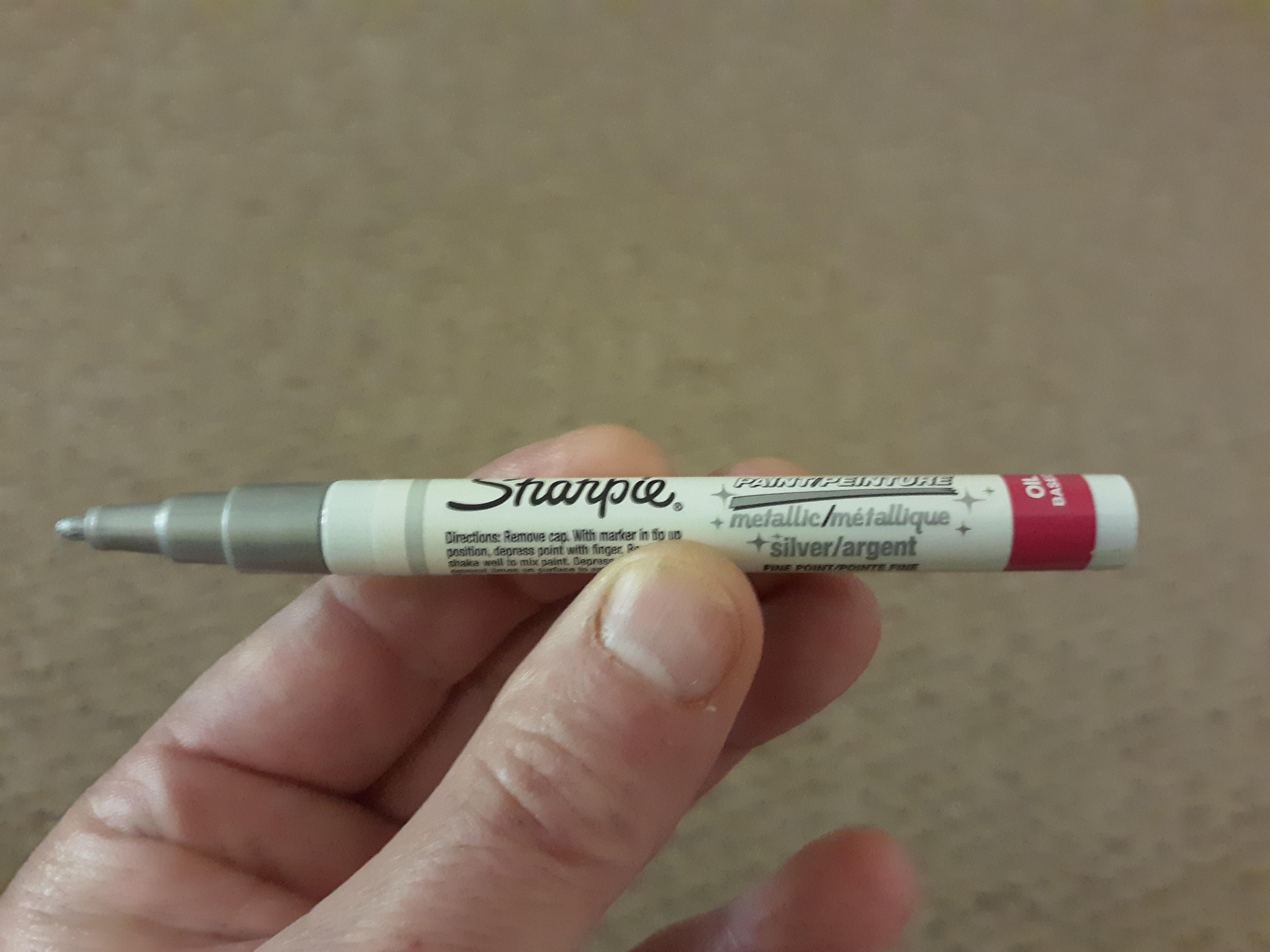

April 26, 20204 yr comment_598078 These work good on the bigger lines. Oil based fine point sharpie, silver and white. Heater panel, radio and the console, horn pad etc. Thanks for that tip @psdenno Link to comment https://www.classiczcars.com/forums/topic/63087-restoration-of-bringatrailer-240z-hls30-35883/?&page=11#findComment-598078 Share on other sites More sharing options...
April 26, 20204 yr Author comment_598079 1 minute ago, siteunseen said: These work good on the bigger lines. Oil based fine point sharpie, silver and white. Heater panel, radio and the console, horn pad etc. Thanks for that tip @psdenno Nice. Thanks for sharing. Link to comment https://www.classiczcars.com/forums/topic/63087-restoration-of-bringatrailer-240z-hls30-35883/?&page=11#findComment-598079 Share on other sites More sharing options...
