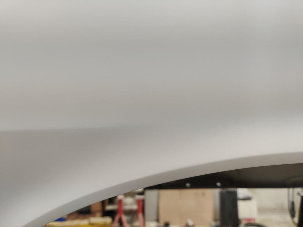

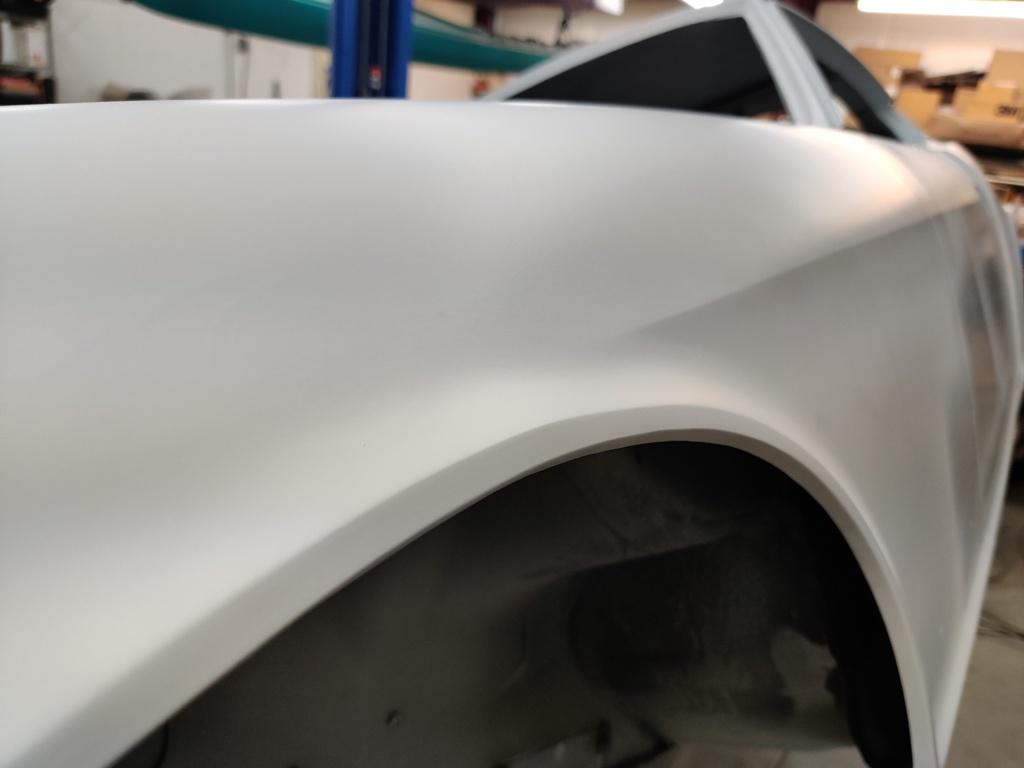

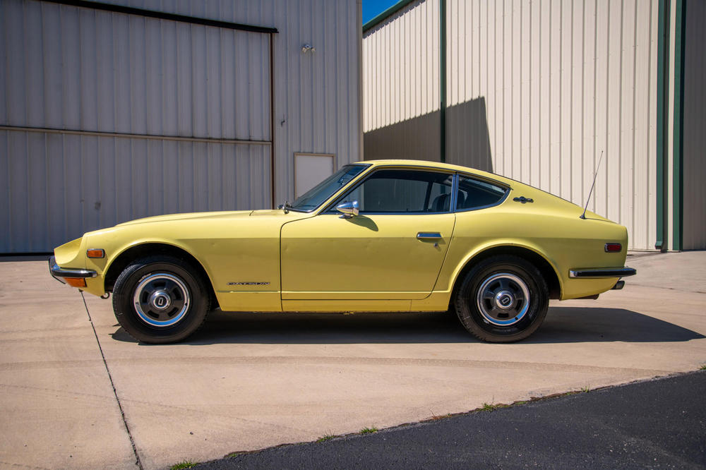

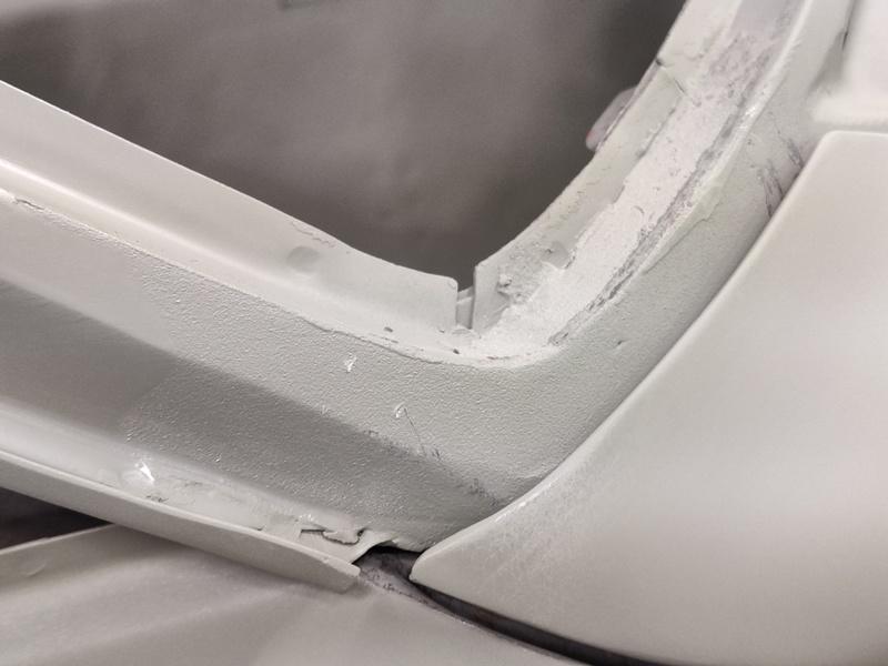

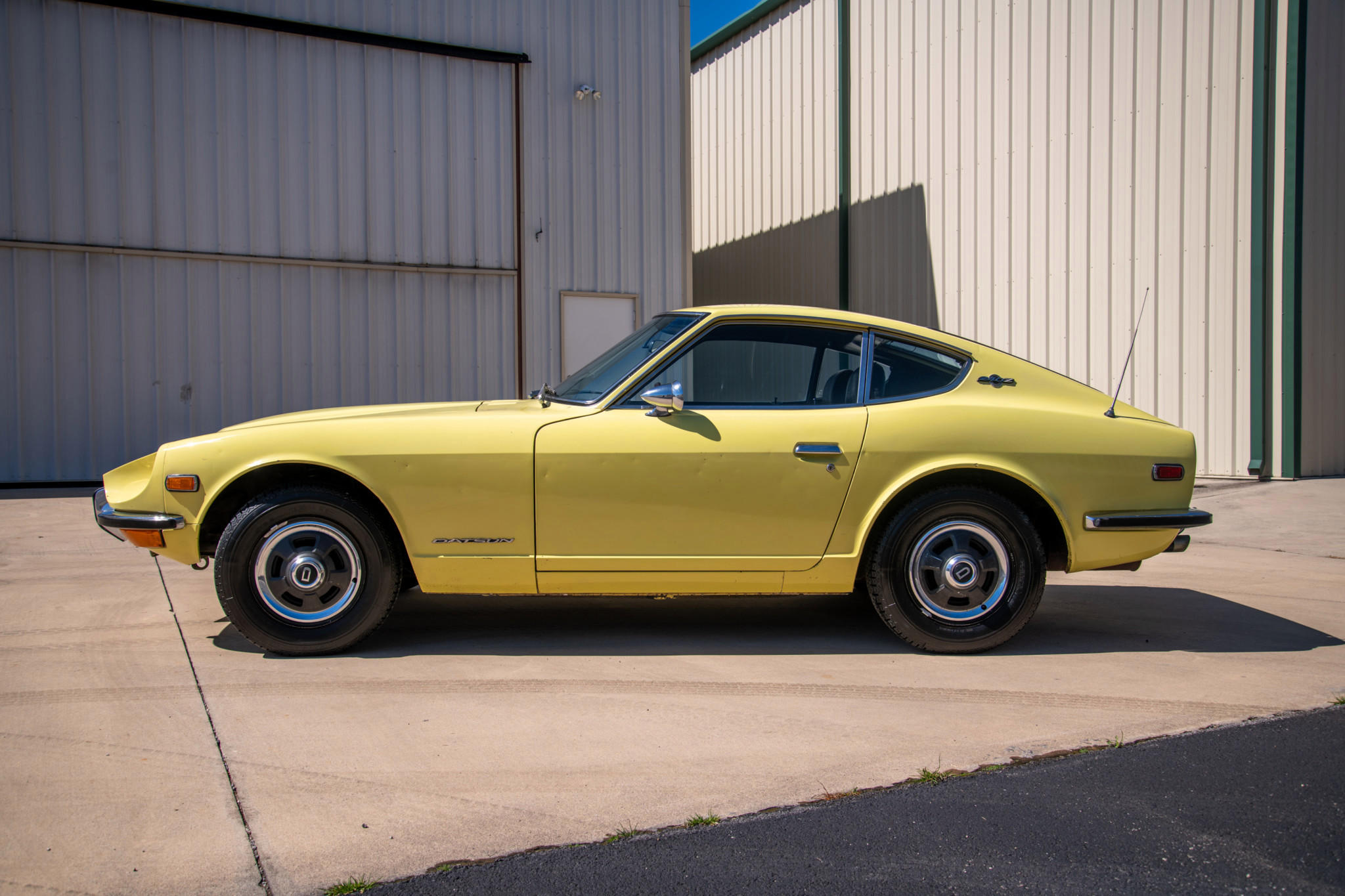

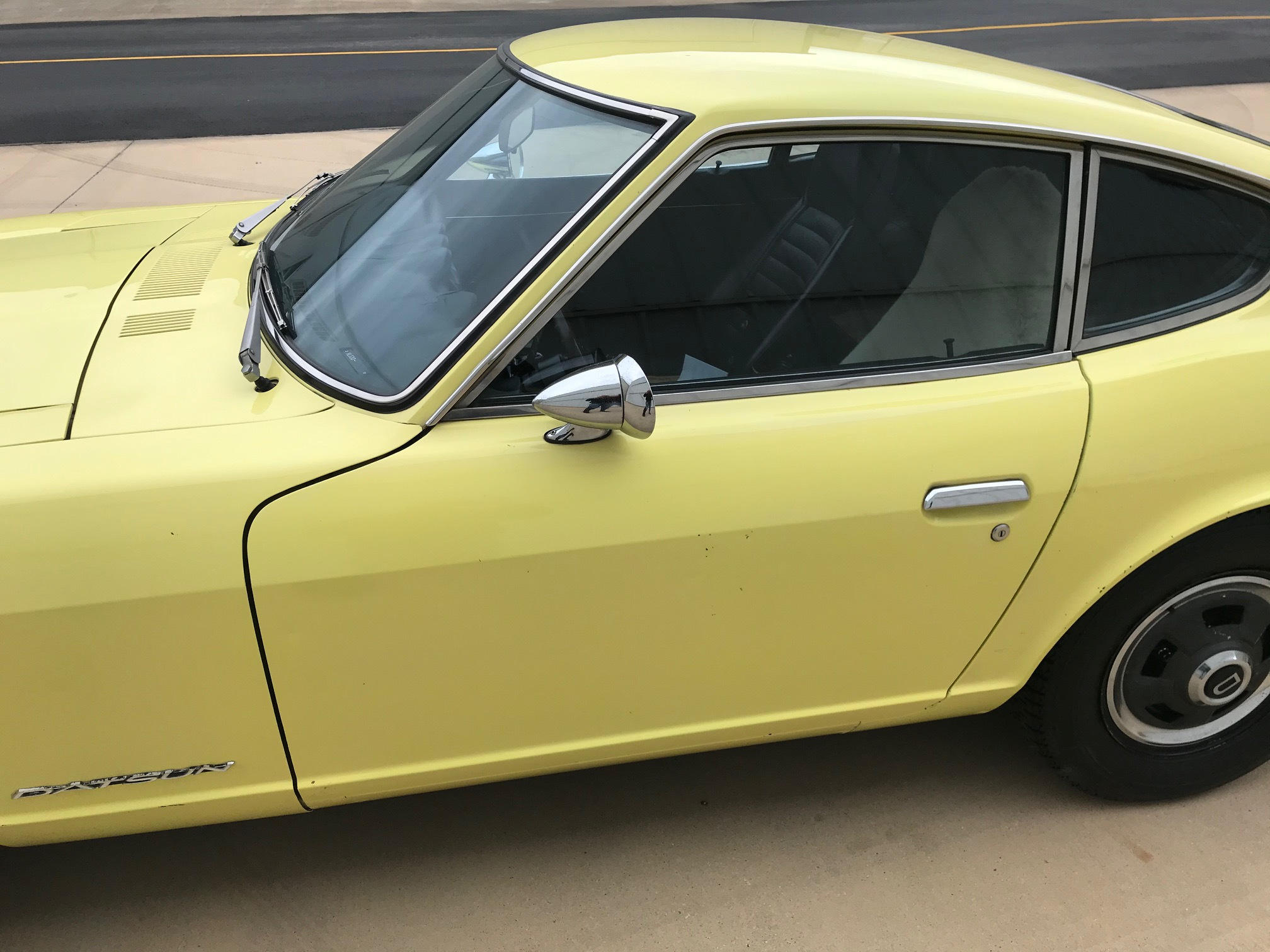

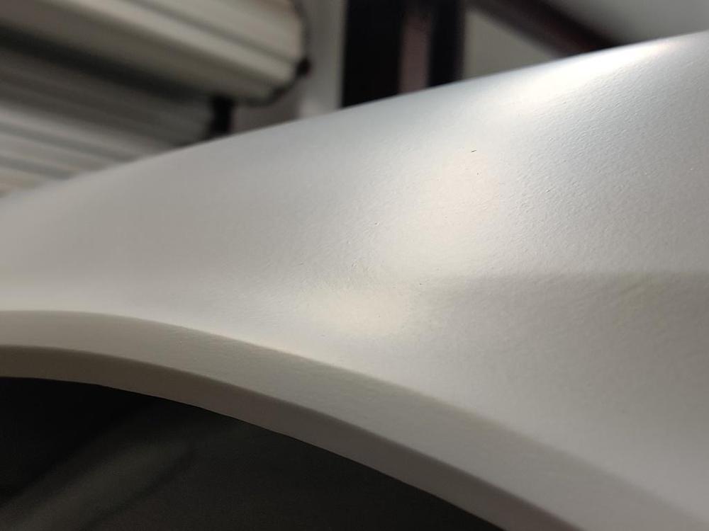

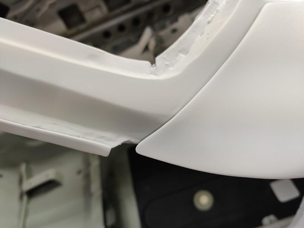

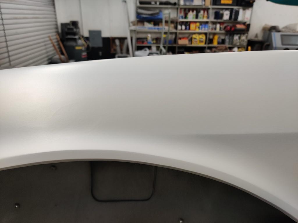

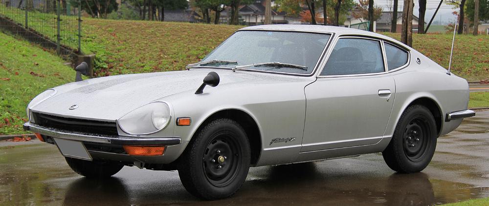

July 3, 20204 yr Author comment_602062 I find myself looking at certain body lines and wondering exactly how they should look. For example, the "belt" line on the side of the car originates in close proximity to the front fender well. But how close? And how sharp should they be? Consulting earlier pics of fenders in bare metal gives me some idea, but my car had light impact damage to both front fenders that had to be straightened, so, I am not certain. Currently: This original paint car currently on BringaTrailer looks like a good reference car. This pic is a nice one, as the lighting is contrasting the above and below belt line nicely. Also, this area of the A-pillar needs to be done right. Light sand blasting of the original revealed this on the passenger side - the sharp line down the outside of the pillar appears to soften just before the top edge of the passenger fender: How it looks now - but I have seen pictures of other Z's that show this line stays sharper than this. Here are a couple that show this area "ok" (the same car on Bringatrailer.com): Anyone out there have an original paint car and who would be willing to take some detailed pics for me? Edited July 3, 20204 yr by inline6 Link to comment https://www.classiczcars.com/forums/topic/63087-restoration-of-bringatrailer-240z-hls30-35883/?&page=13#findComment-602062 Share on other sites More sharing options...
July 3, 20204 yr comment_602063 I suggest asking Chet for some close-up looks at his cars. Link to comment https://www.classiczcars.com/forums/topic/63087-restoration-of-bringatrailer-240z-hls30-35883/?&page=13#findComment-602063 Share on other sites More sharing options...
July 3, 20204 yr comment_602065 I think you fender line looks good Link to comment https://www.classiczcars.com/forums/topic/63087-restoration-of-bringatrailer-240z-hls30-35883/?&page=13#findComment-602065 Share on other sites More sharing options...

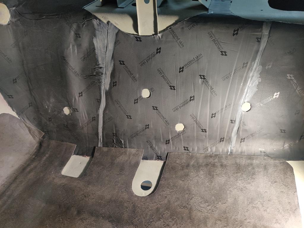

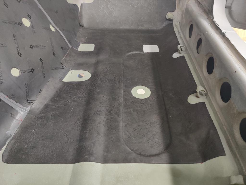

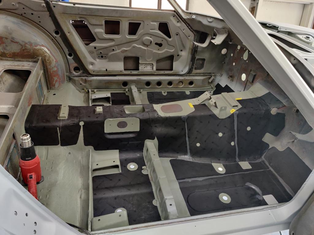

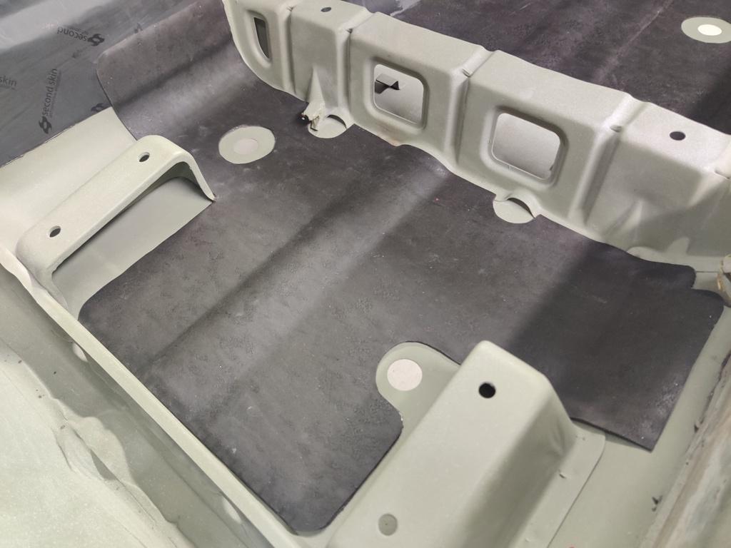

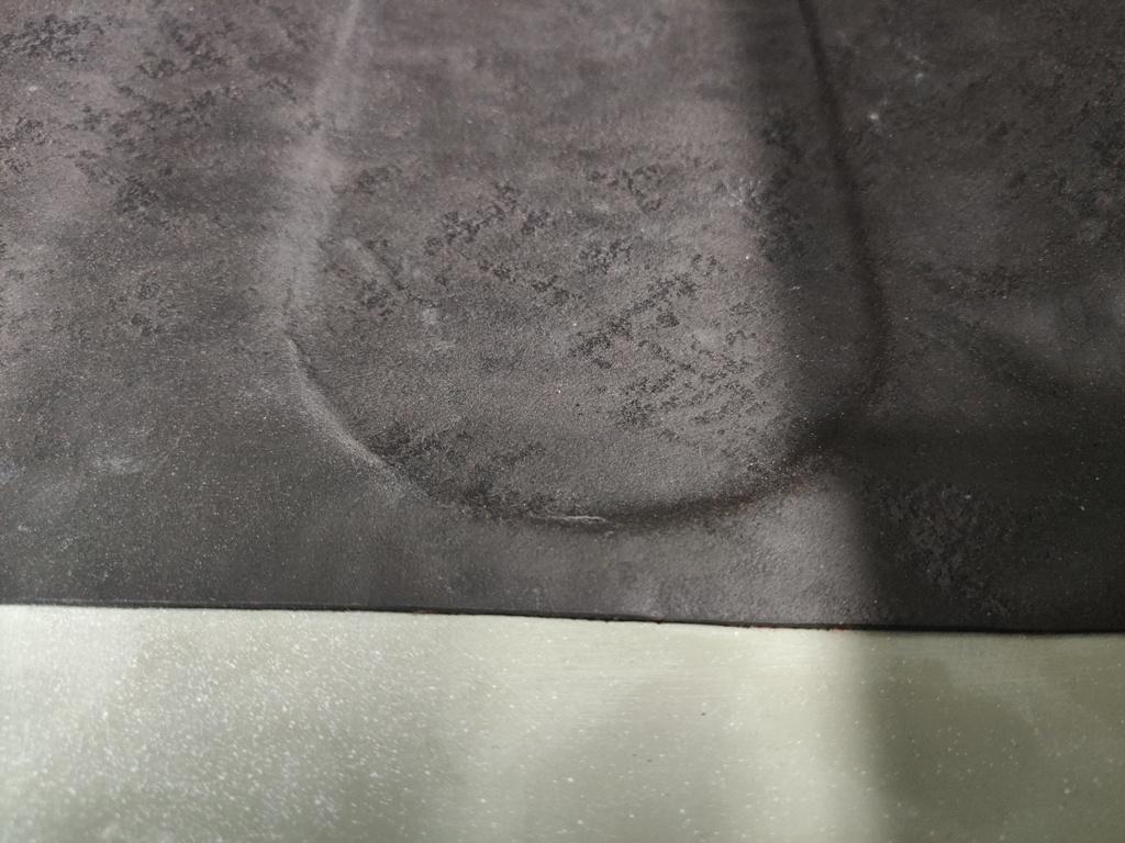

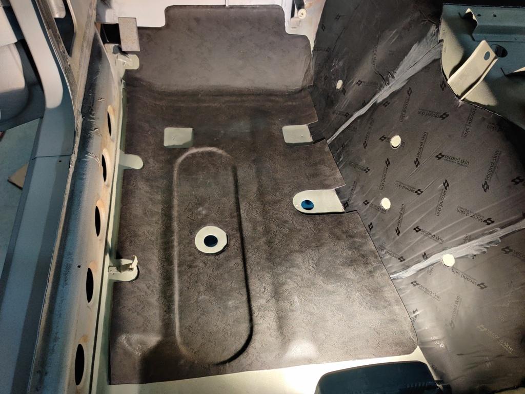

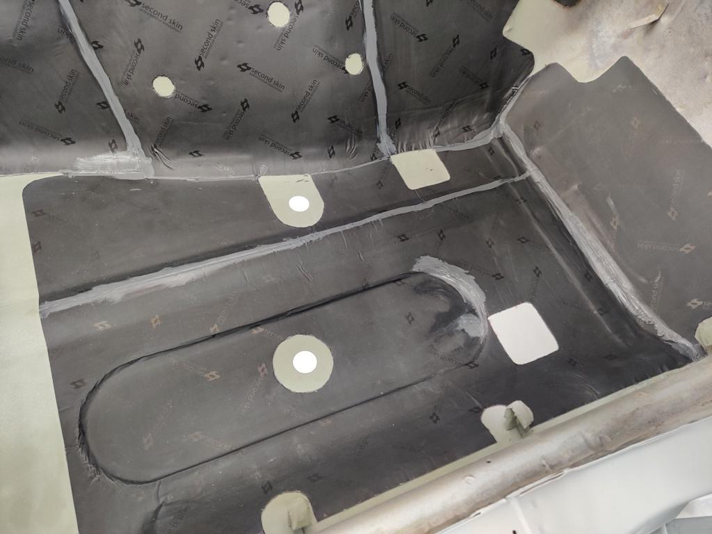

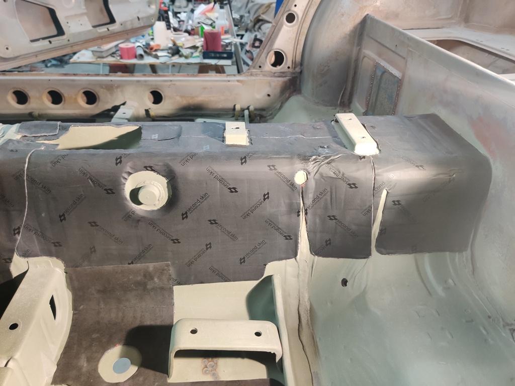

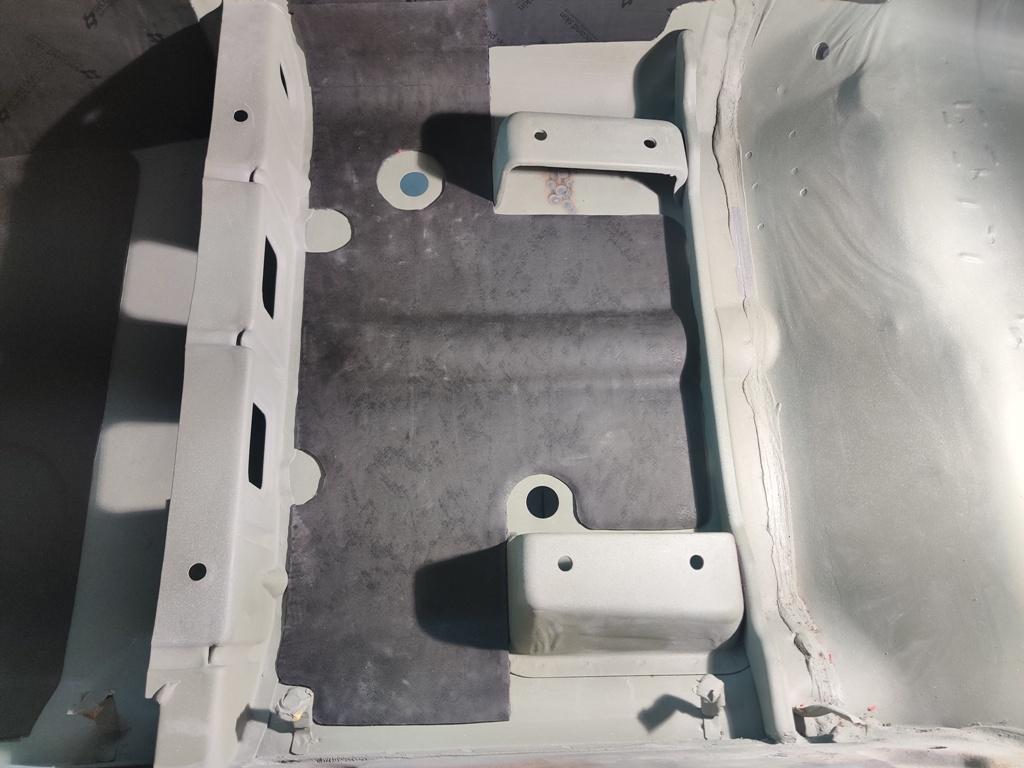

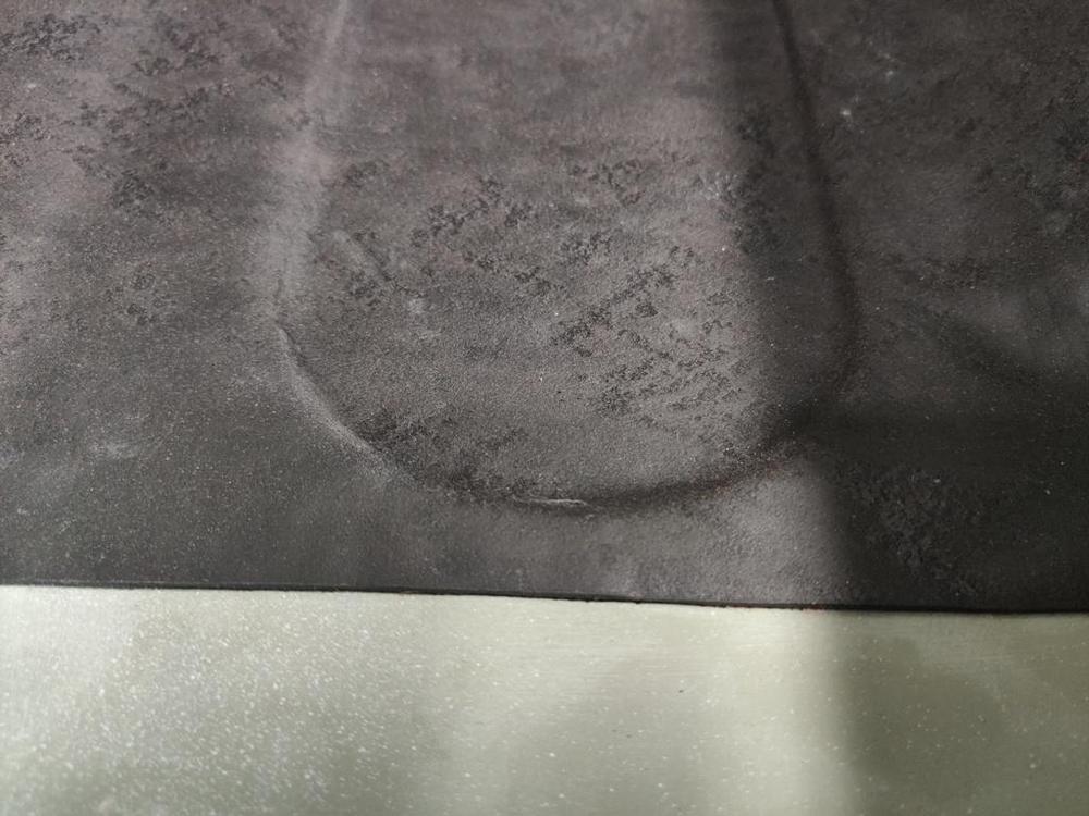

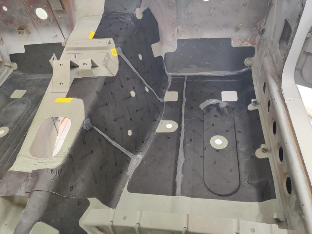

July 4, 20204 yr Author comment_602093 11 hours ago, SteveJ said: I suggest asking Chet for some close-up looks at his cars. Hmmm. Good thought. 9 hours ago, Patcon said: I think you fender line looks good It might be close. I continued with the sound deadening mat today. Unfortunately, one of my packets of OEM stuff had only one sheet inside instead of two like it was supposed to. Too late to do anything about that, as I have had it for maybe a year now. I will have to order another two pack and hope it is still available. Damplifier Second Skin being installed - seam sealer applied to crevices between individual pieces. I did not use the heat gun for these pieces as they have a thick foil layer on top. I used a roller with a hard rubber wheel to conform the sheets to the metal. OEM bitumen material put on top. You can see the difference as the logos are present on the foil, but obviously not on the OEM stuff. I cut the bitumen about a 1/16" of an inch larger than the pattern which ensures that the piece underneath doesn't show. The bitumen shapes nicely with the heat gun - looks better than the foil with the wrinkles. Edited July 4, 20204 yr by inline6 Link to comment https://www.classiczcars.com/forums/topic/63087-restoration-of-bringatrailer-240z-hls30-35883/?&page=13#findComment-602093 Share on other sites More sharing options...

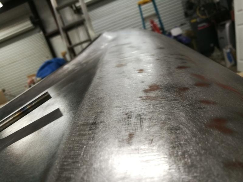

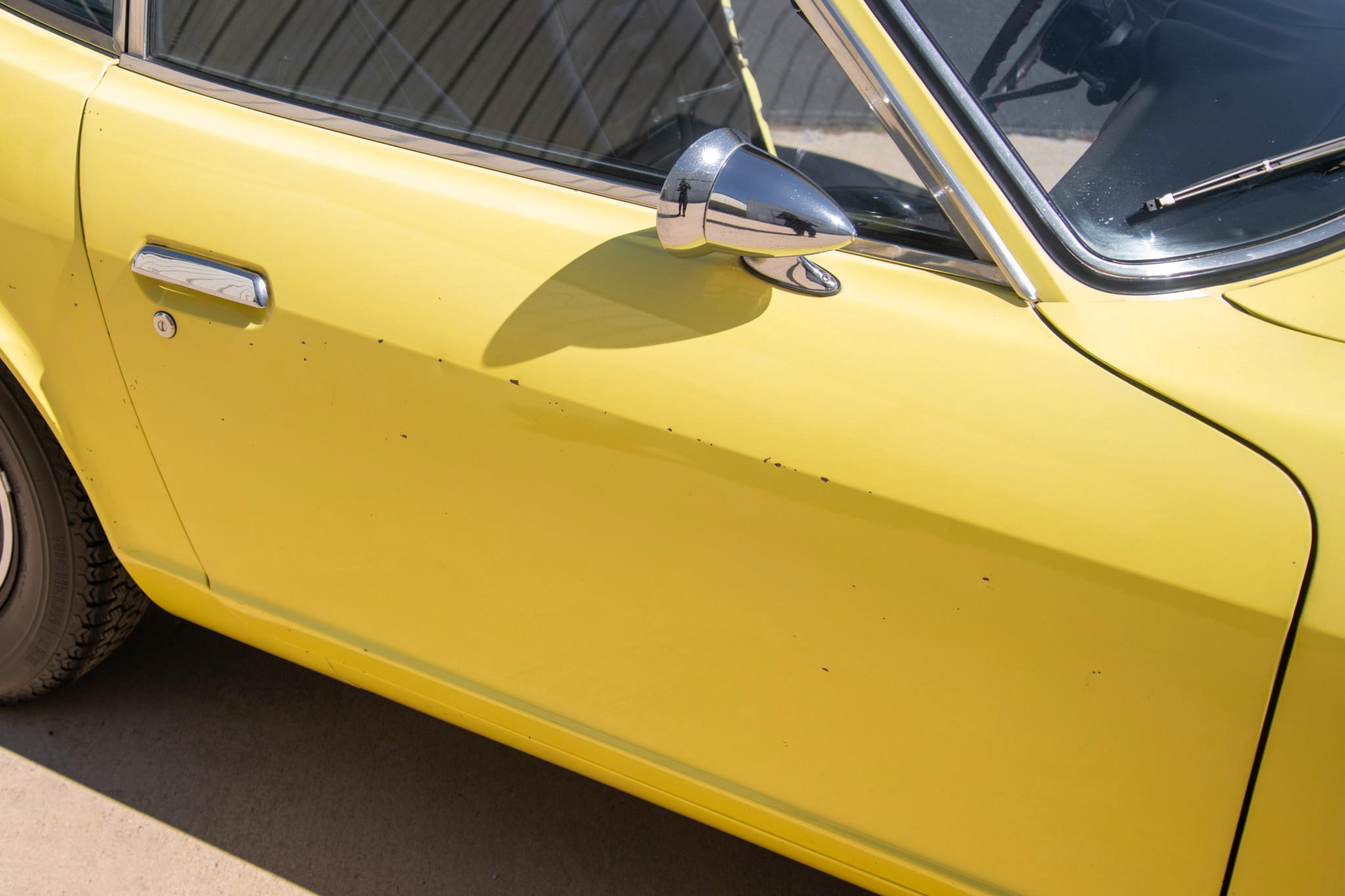

July 4, 20204 yr Author comment_602118 I happened to come across this pic while researching (again) pics of 901 silver. This picture illustrates what I am seeking to avoid the final look of the "belt" line of the car. High resolution pic available: When you examine the body line closely, you can see that it varies both in direction and in sharpness. At its origination point at the fender, it is a bit soft (instead of sharp). As you move your sight from there towards the back of the fender, the line sharpens and then softens at the rear fender edge. Moving onto the door, the first couple inches is soft and actually moved down. Then you can see the line move up and down along the door. That stuff is what I am looking to avoid. Link to comment https://www.classiczcars.com/forums/topic/63087-restoration-of-bringatrailer-240z-hls30-35883/?&page=13#findComment-602118 Share on other sites More sharing options...
July 4, 20204 yr comment_602134 5 hours ago, inline6 said: That stuff is what I am looking to avoid. A stiff long board should take care of those soft areas. Link to comment https://www.classiczcars.com/forums/topic/63087-restoration-of-bringatrailer-240z-hls30-35883/?&page=13#findComment-602134 Share on other sites More sharing options...

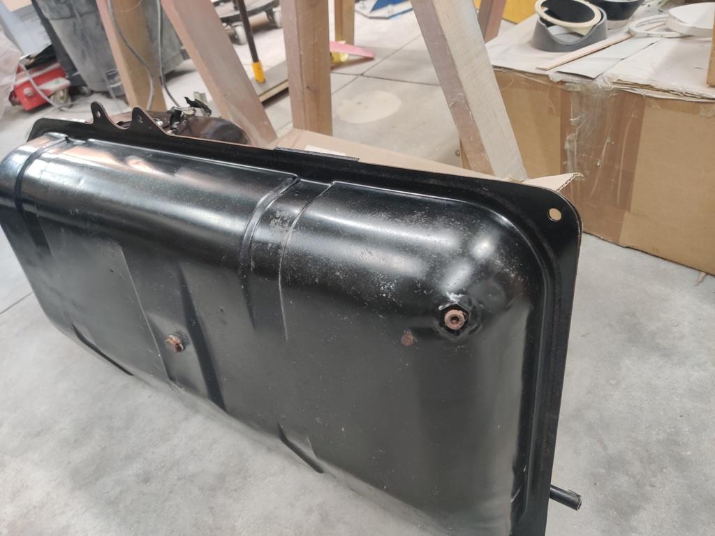

July 21, 20204 yr Author comment_603156 Anyone ever see this on the 240z gas tanks? A second drain on the corner? I didn't notice it until it came back from the shop that cleaned it out. If not stock, looks like I have another welding project. Edited July 21, 20204 yr by inline6 Link to comment https://www.classiczcars.com/forums/topic/63087-restoration-of-bringatrailer-240z-hls30-35883/?&page=13#findComment-603156 Share on other sites More sharing options...
July 21, 20204 yr comment_603157 I've seen a couple of tanks that had a leak and repairs in that spot, maybe a PO put a drain bolt there to release the water from pooling. Link to comment https://www.classiczcars.com/forums/topic/63087-restoration-of-bringatrailer-240z-hls30-35883/?&page=13#findComment-603157 Share on other sites More sharing options...
July 21, 20204 yr comment_603166 That would've been an issue for me. That weld looks terrible. Get them to buy you a new one that's been on here last month. I mean call somebody when changing/disregarding your instructions and a plan for restoration. Jeez, everyone ASSumes they doing what's best for you. Link to comment https://www.classiczcars.com/forums/topic/63087-restoration-of-bringatrailer-240z-hls30-35883/?&page=13#findComment-603166 Share on other sites More sharing options...
July 21, 20204 yr comment_603167 If it doesn't leak, I would leave it and paint it black Link to comment https://www.classiczcars.com/forums/topic/63087-restoration-of-bringatrailer-240z-hls30-35883/?&page=13#findComment-603167 Share on other sites More sharing options...
