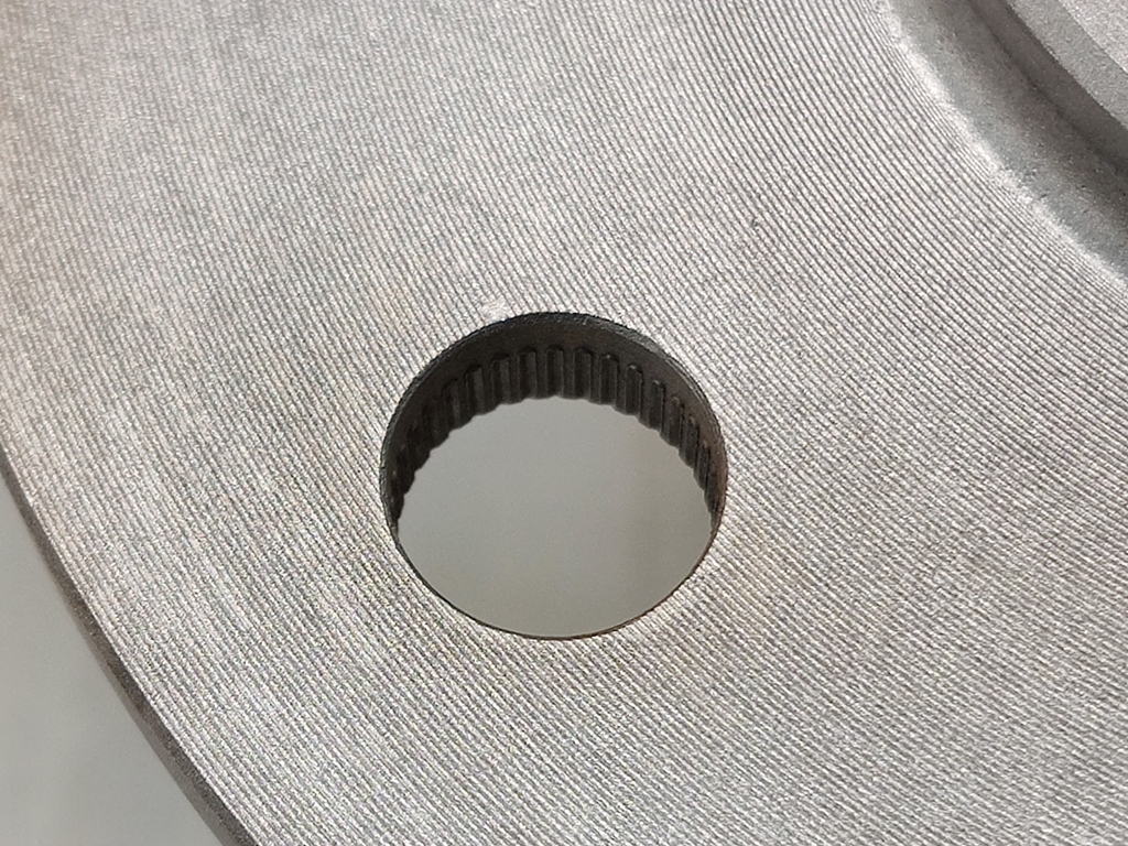

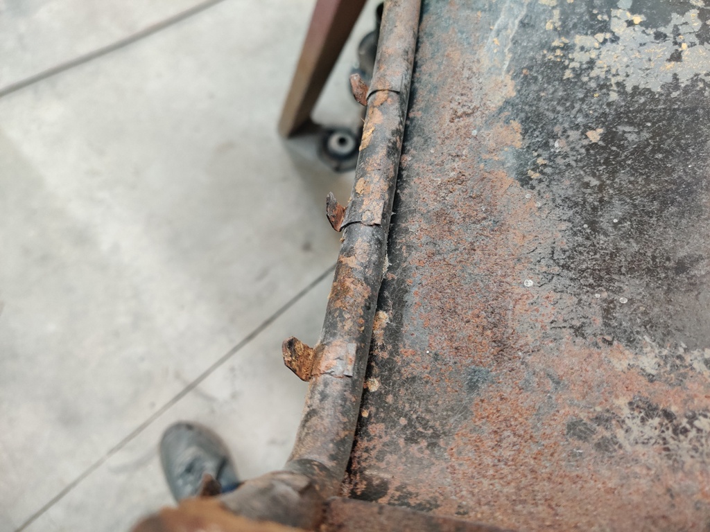

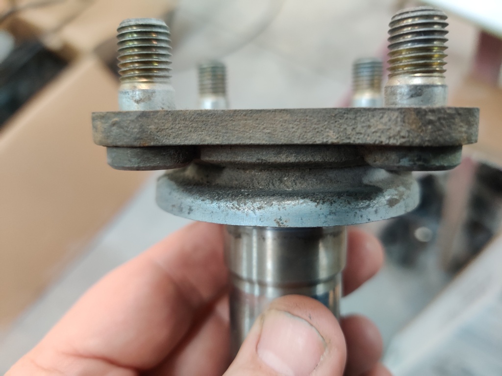

Surface rust removed from rear hubs by glass beading.  Nice to see so little rust damage (first two pics).  Plate behind hubs has an interesting grey coating (pic 3 and 4):

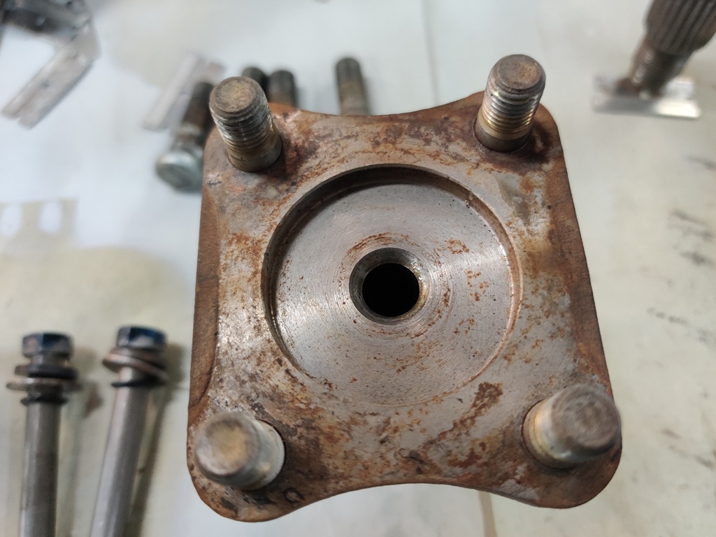

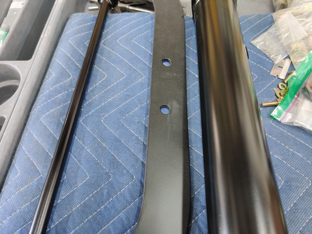

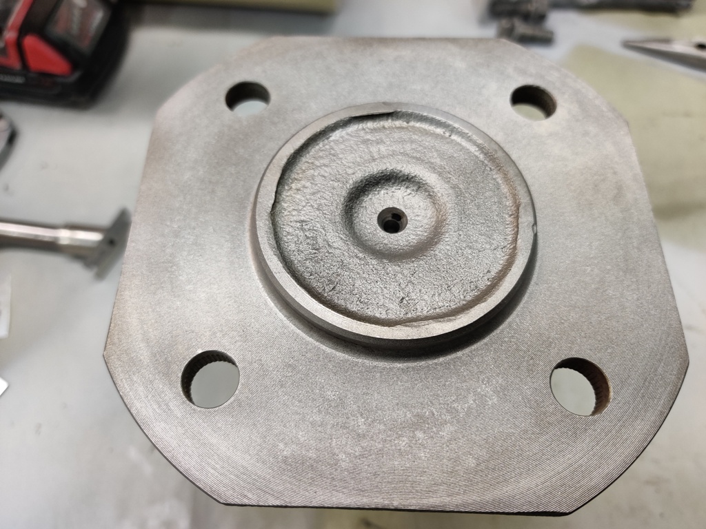

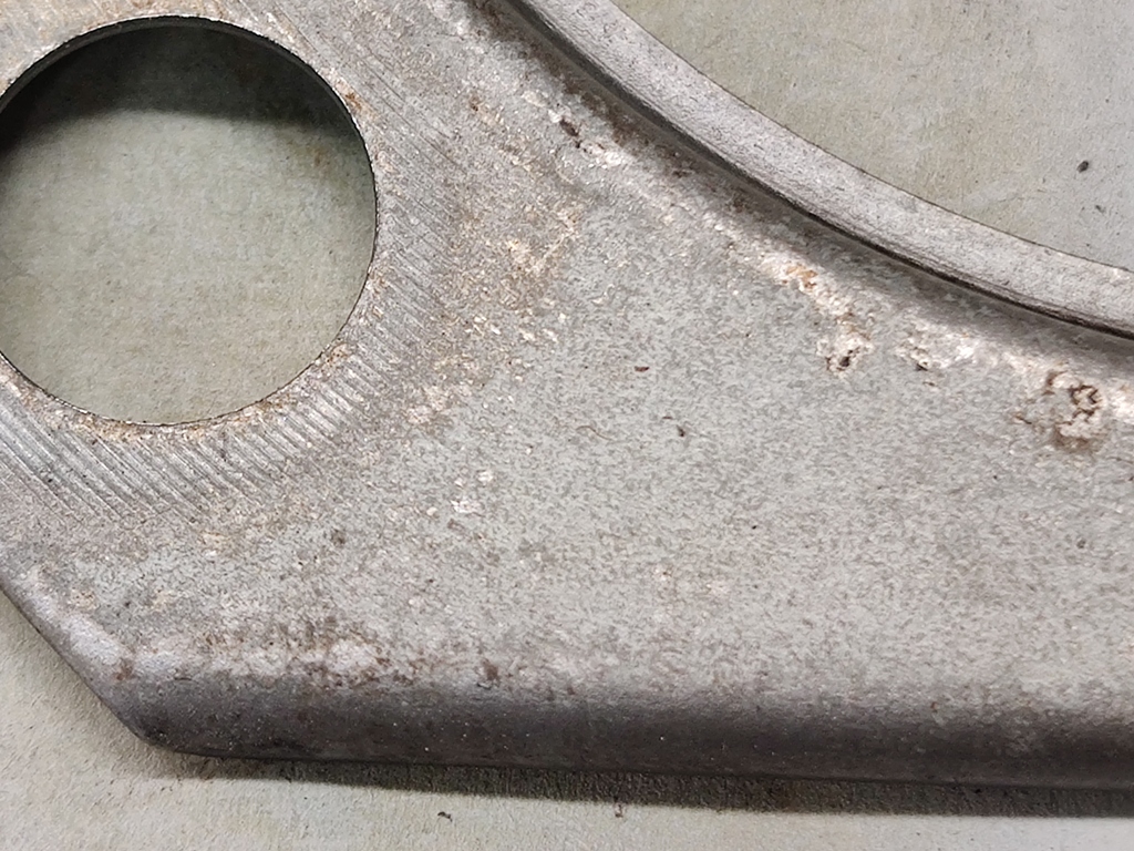

Differential stub axles received no paint from the factory (pics 4 and 5):

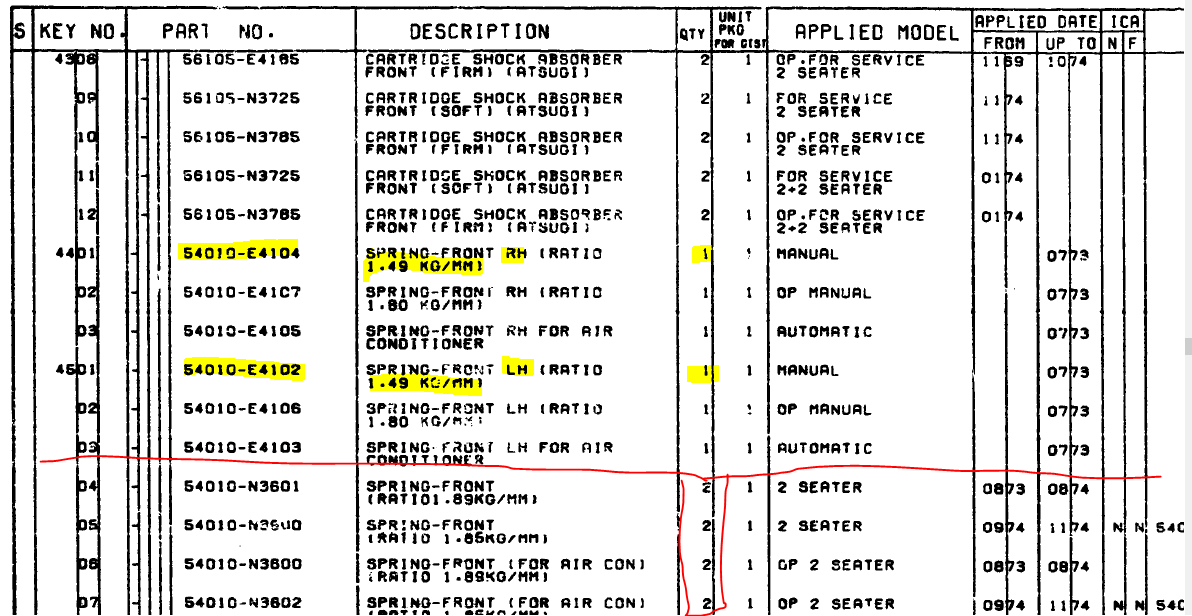

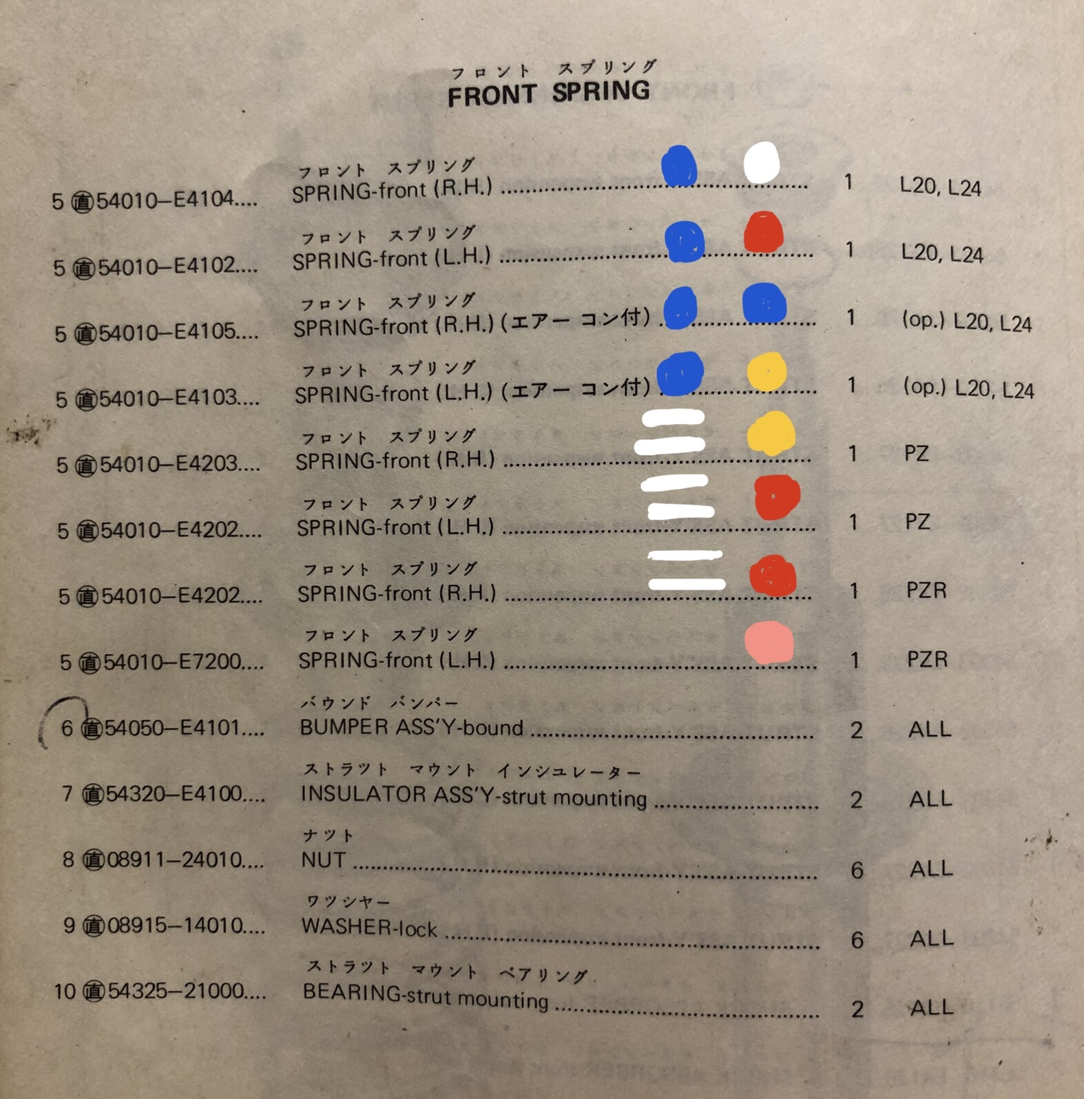

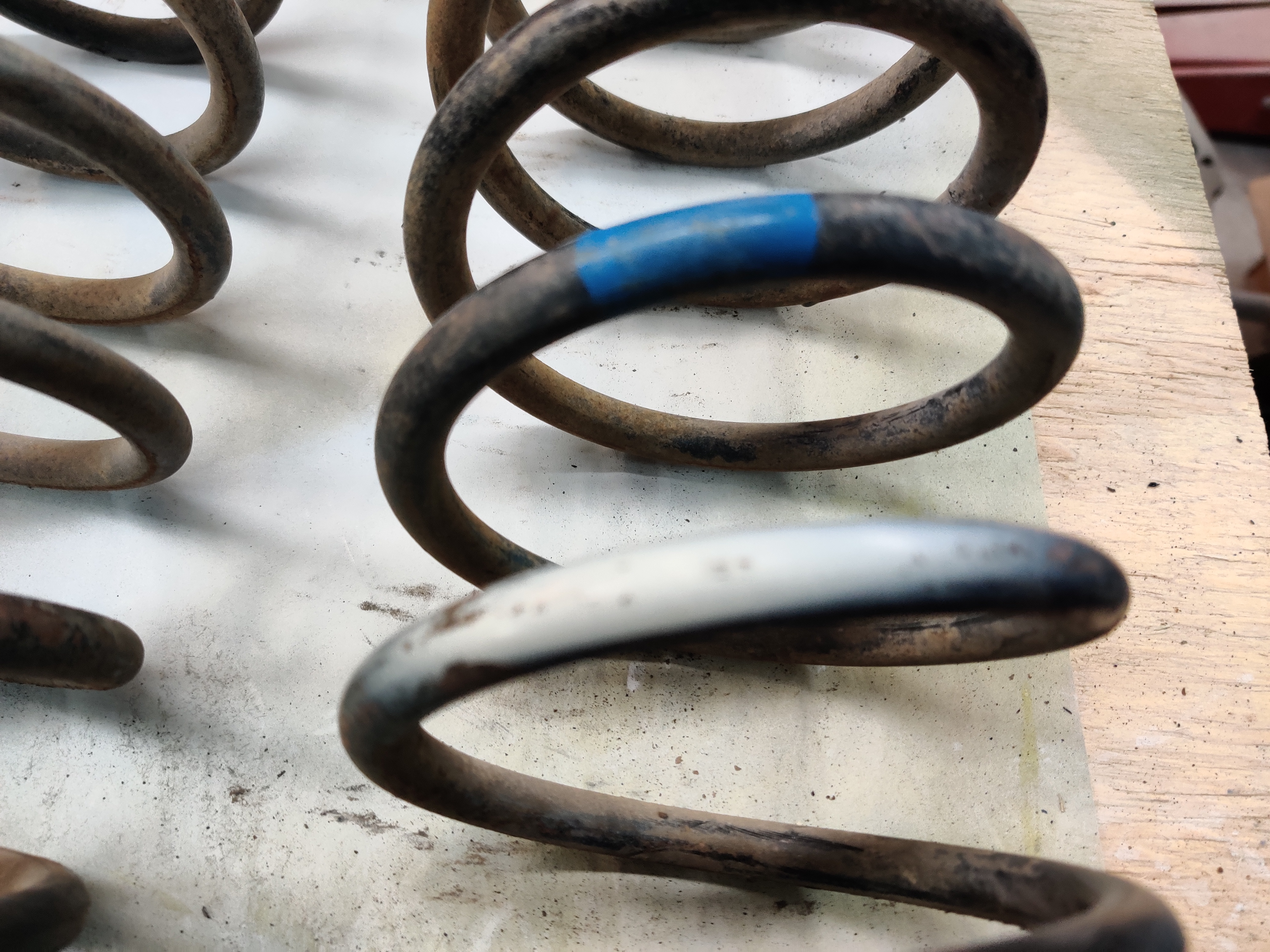

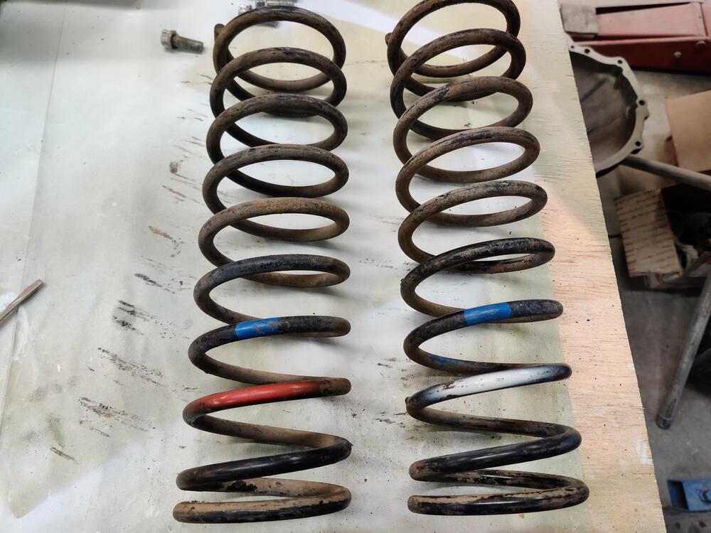

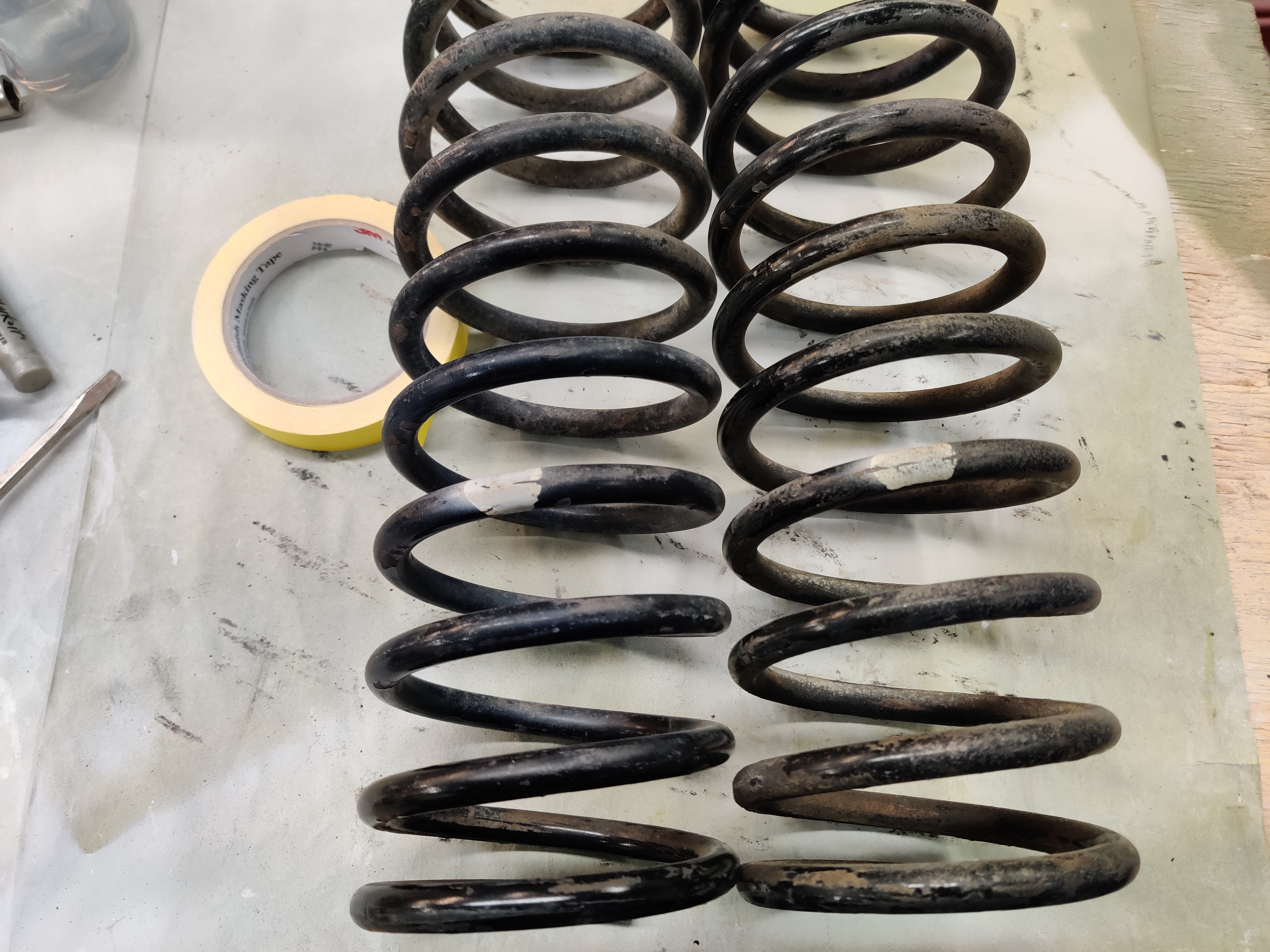

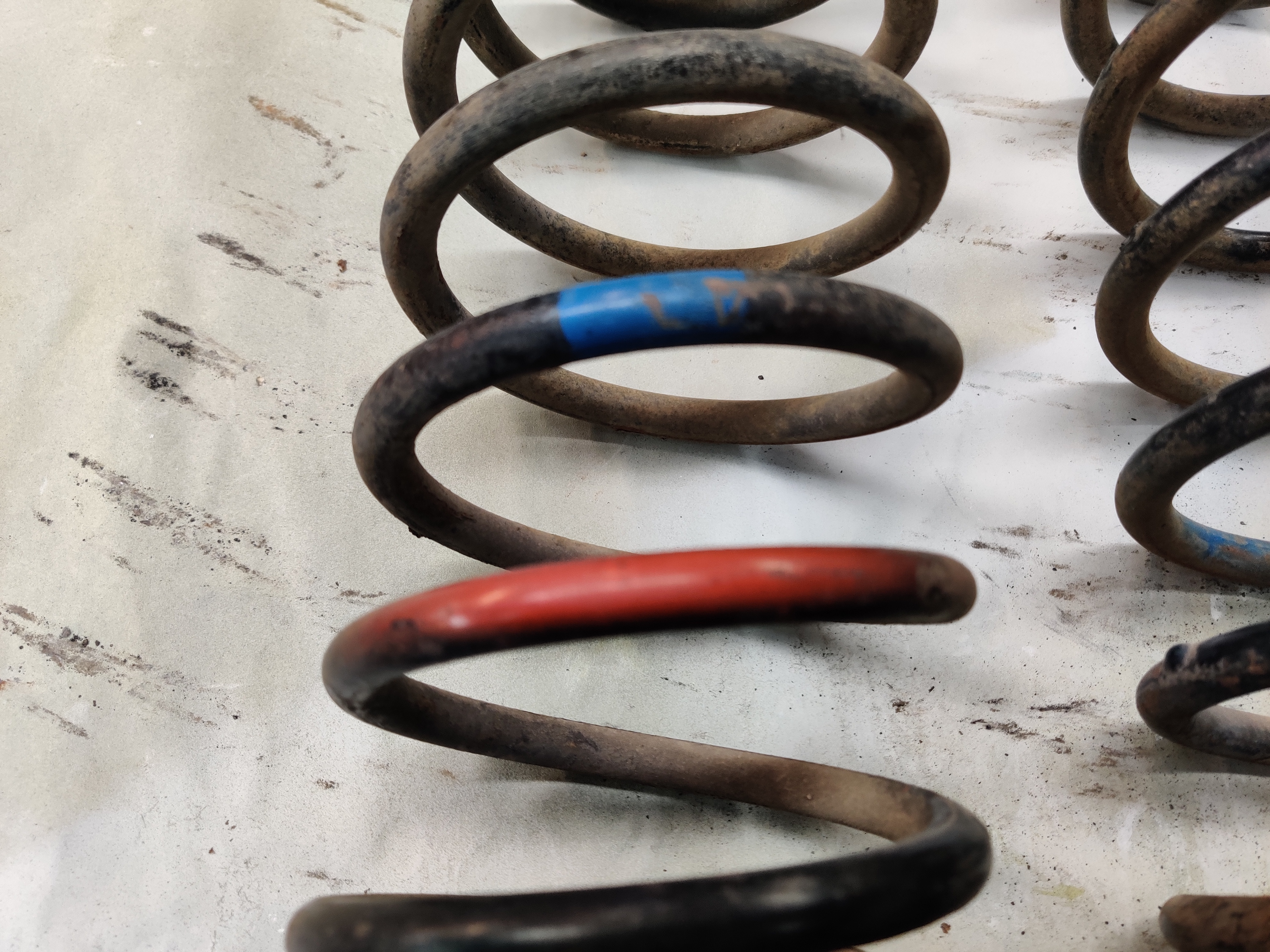

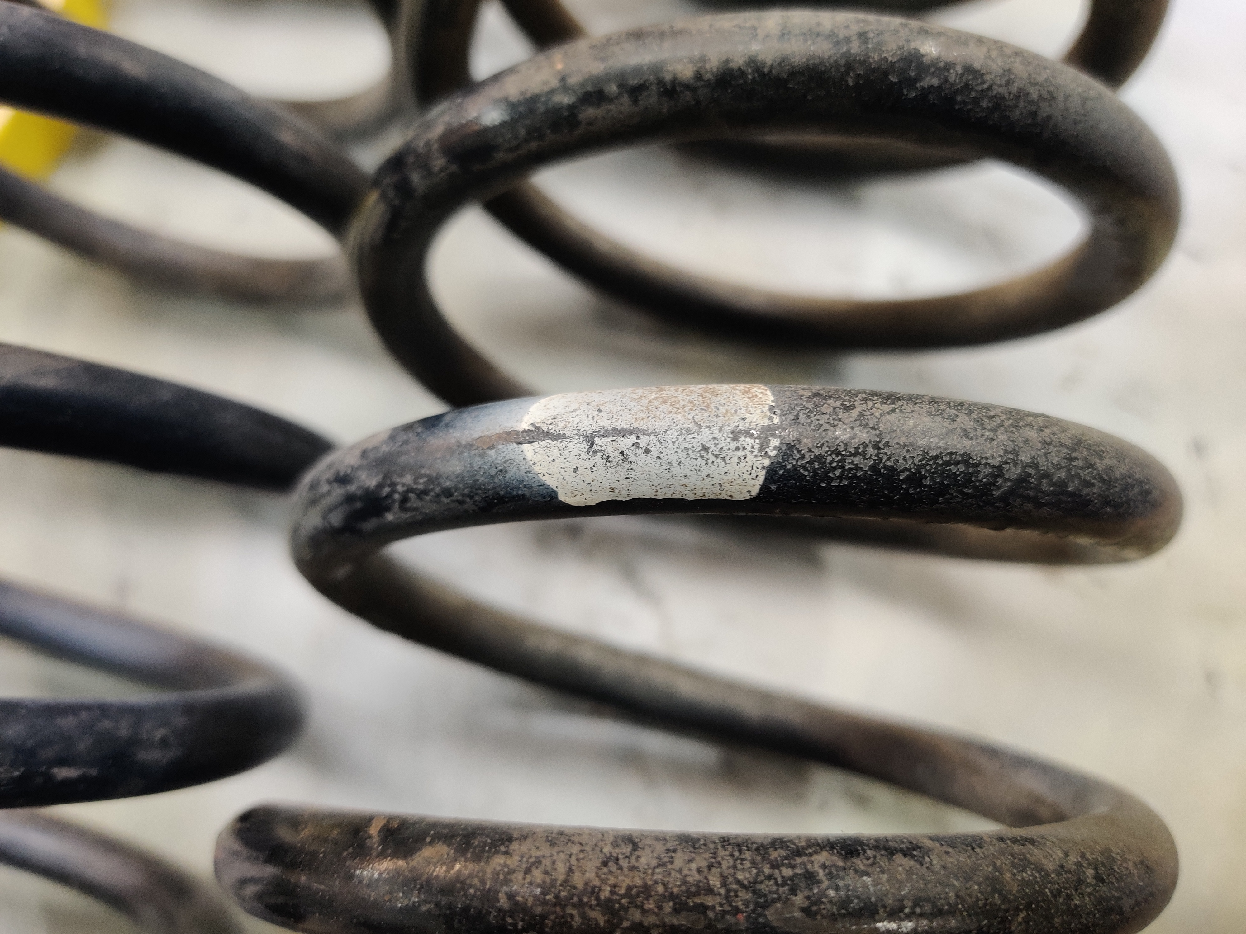

Stock springs... I need to search to determine what these paint marks mean.  I recall something about location on the car...  First pair:

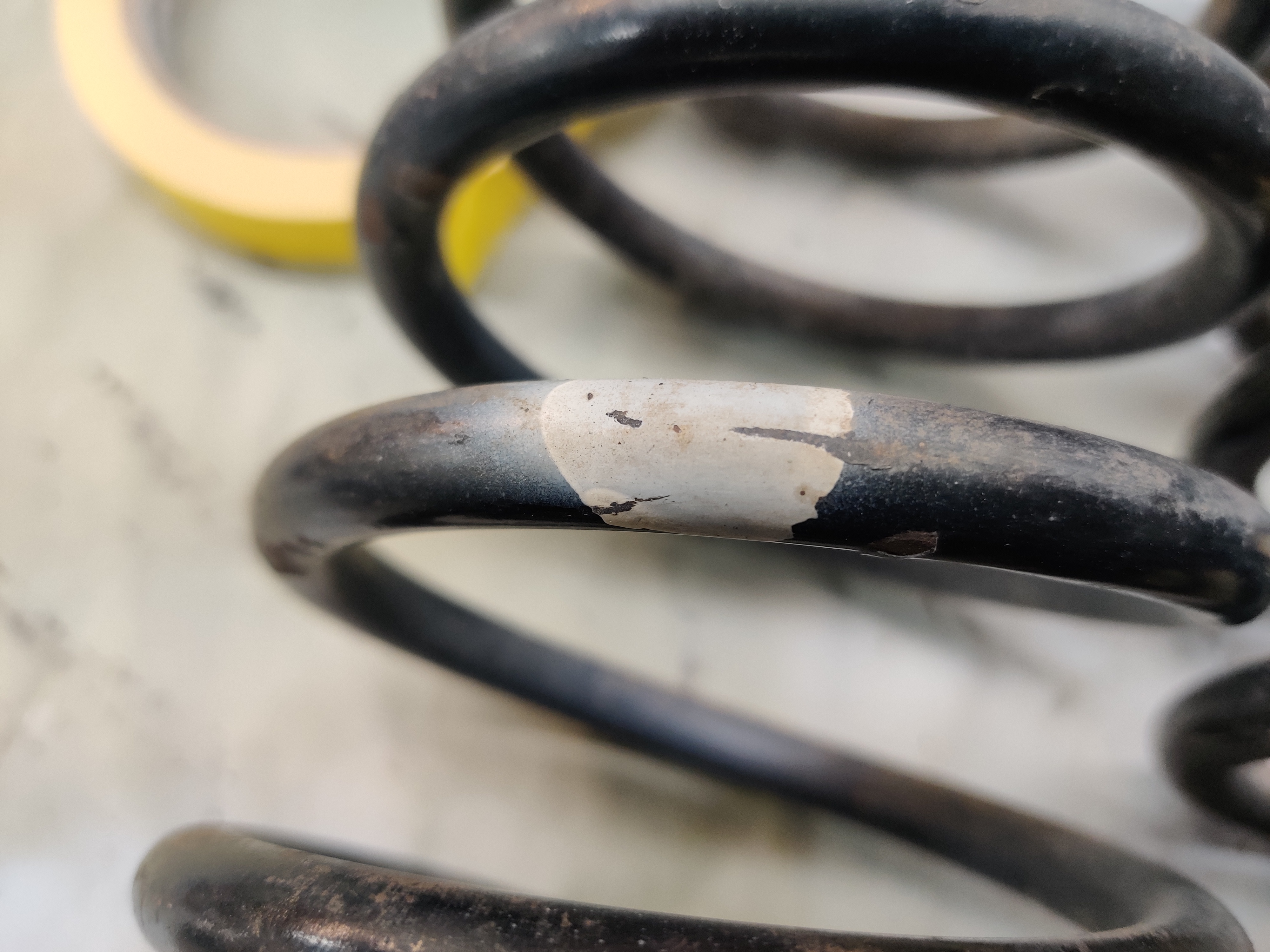

Second pair:

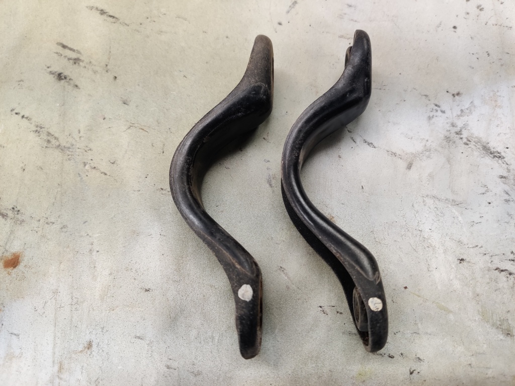

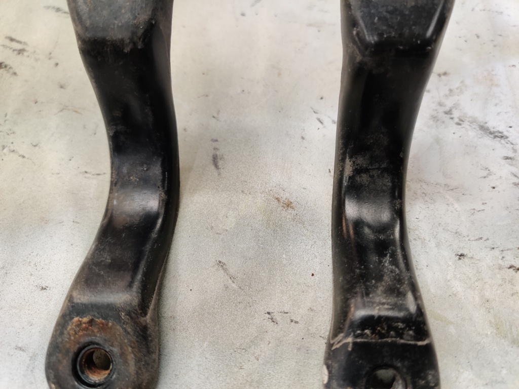

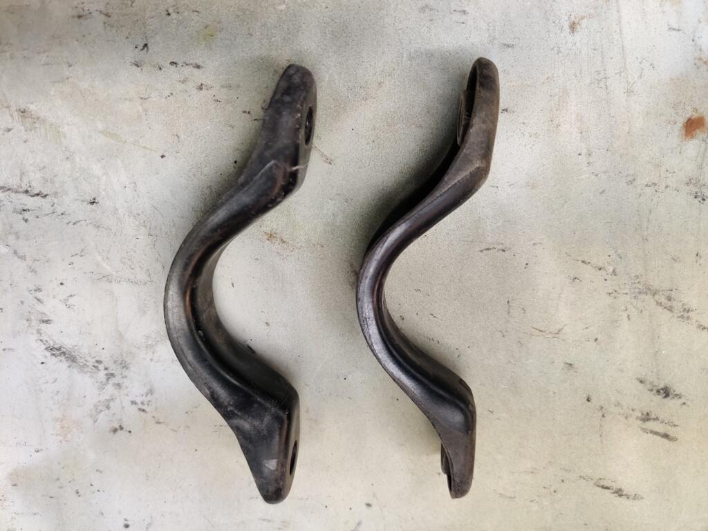

I am taking note of different amounts of gloss on the various pieces. The dash vent control knob brackets are pretty glossy compared to the lower dash mounting brackets (pic 1).  Most parts have a gloss level like this gas pedal, shiny, but not super shiny. (pic 2). Gas tank straps were originally gloss black (pic 3):

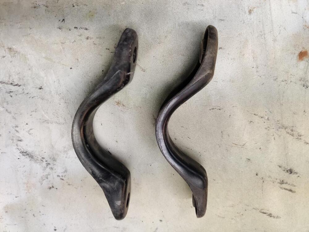

More parts that were glossy but not very: transmission mount bracket (pic 1), seat back - note florescent light reflection is "dull" (pic 2), heater core (pic 3):

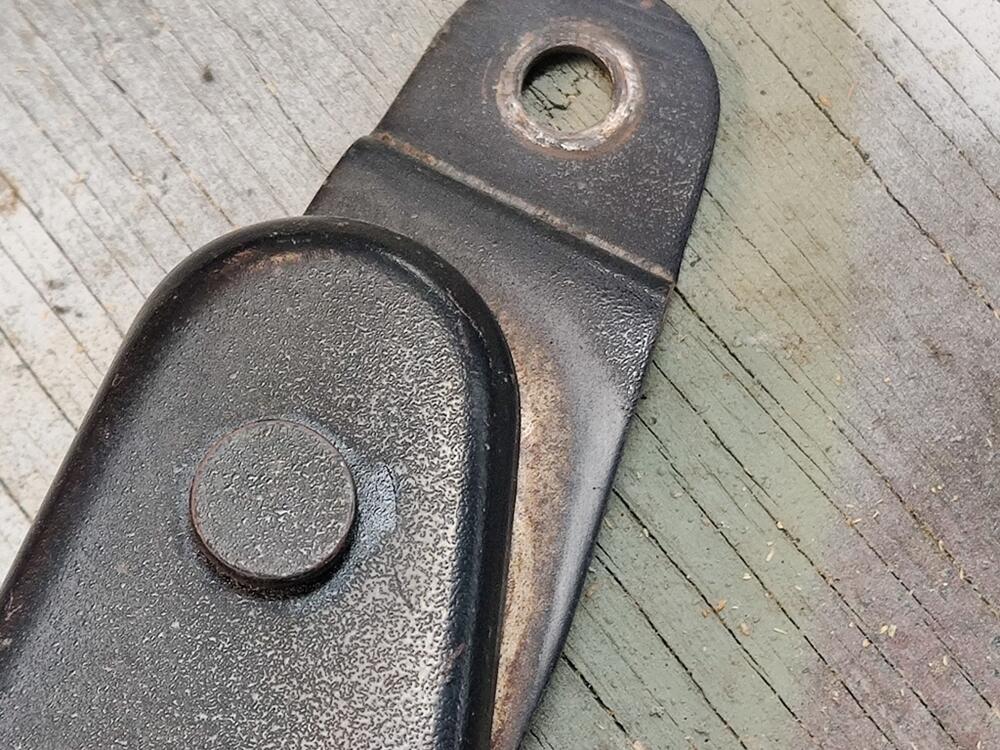

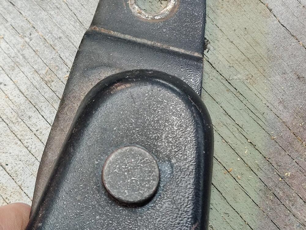

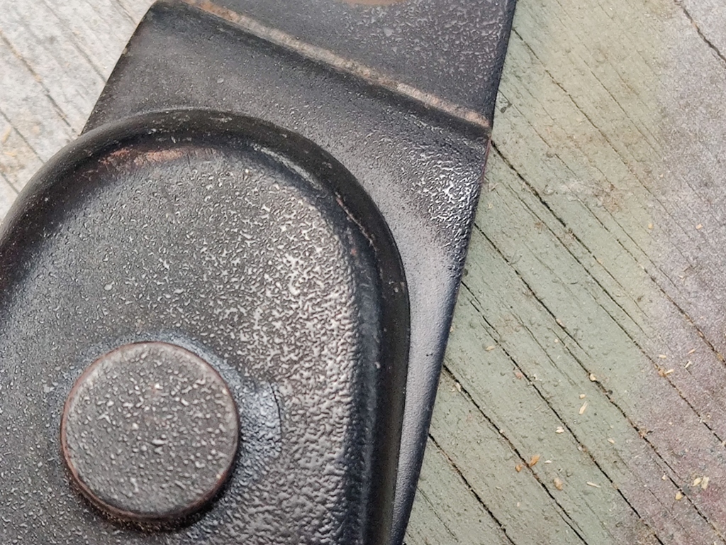

Some interesting pics - the seat adjuster brackets seem to have been sprayed with a coat and this "spritzed" with another to give them a bit of texture:

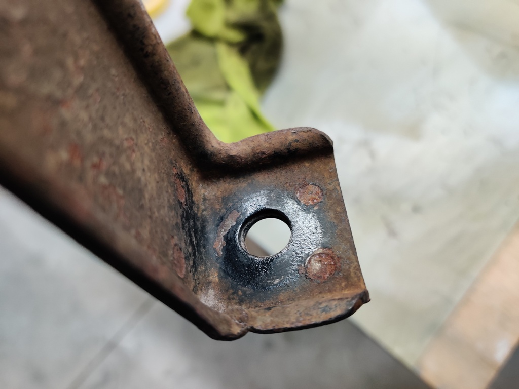

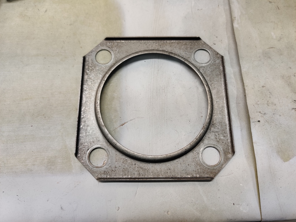

Steering rack securing brackets have interesting paint marks on them:

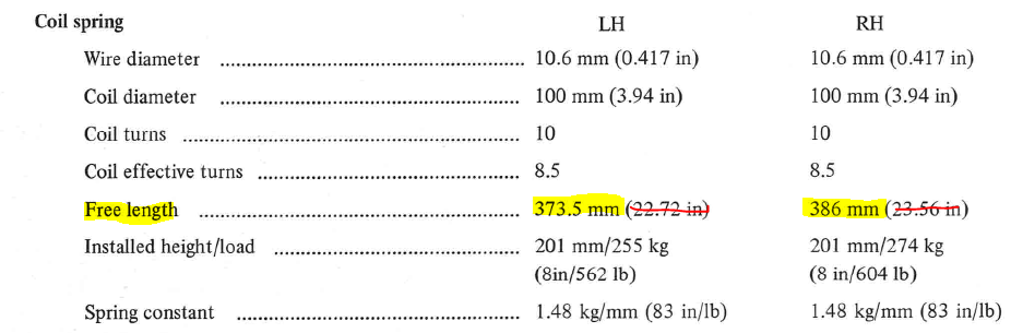

Found a post about the colors on the springs.  Thanks @KatZ.  I don't know if I am reading this correctly. So the two springs with one white mark only are rear springs for my car - HLS30.  Looks like the part number is 55020-E4102.  The front springs are the two with blue... I don't know what is different between the two.  Perhaps the free length?
I just had a look in the Nissan parts book and FSM. On the front axle the left and right springs do have different specs for free length and different part numbers. This is from page FA-20 in my 1970 FSM.
Ignore the inch numbers for free length, as the conversion is incorrect. It was corrected in the 1972 FSM.
Here is the part number info for the front axle. The parts book also lists optional stiffer springs. Interesting that starting with the 260Z, a change was made to use the same spring on the left and right sides.
Edited by CanTechZ
Added part number info
Yes you are reading it correctly. And yes they are different in free length.
 For the front, blue and white is RH 54010-E4104, blue and red is LH 54010-E4102. (Although the picture which I post in that thread had an error for the LH, it says -E4202 this is for PZ)
Today I post this, from a parts catalog of Fairlady Z series 1972. This is correct.

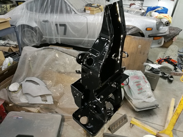

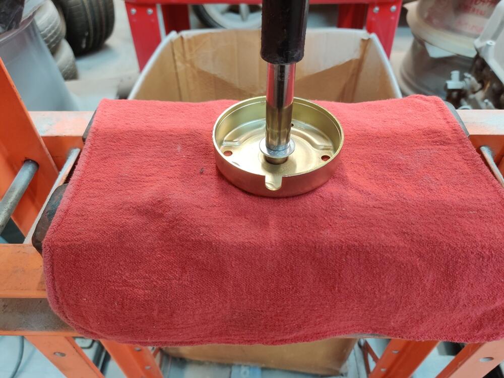

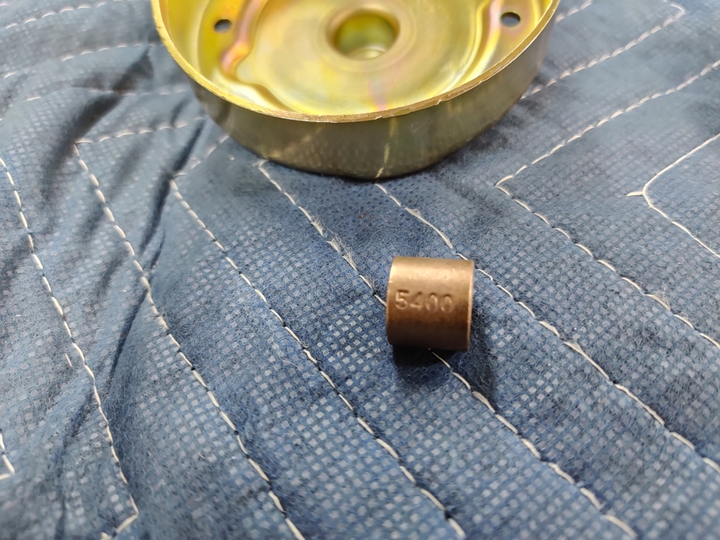

Over the last few evenings, I painted a few items black, and waited for them to dry, and then worked on assembly of the starter.  For the starter, I used new bushings for the front and the rear.  Here is the front:

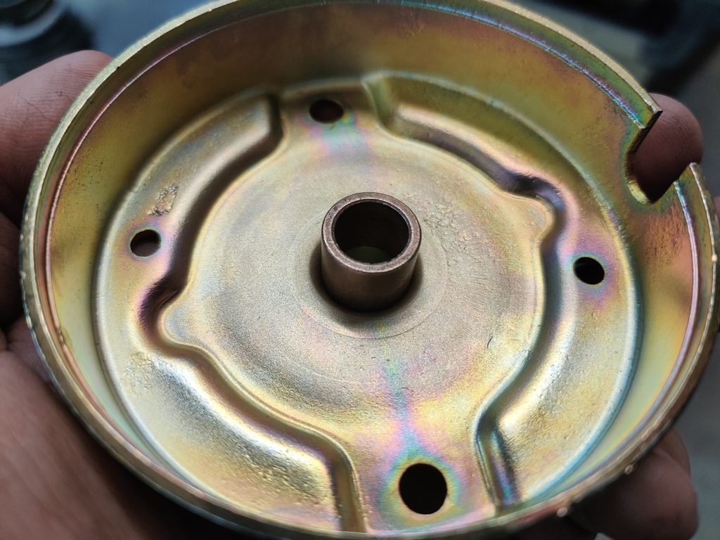

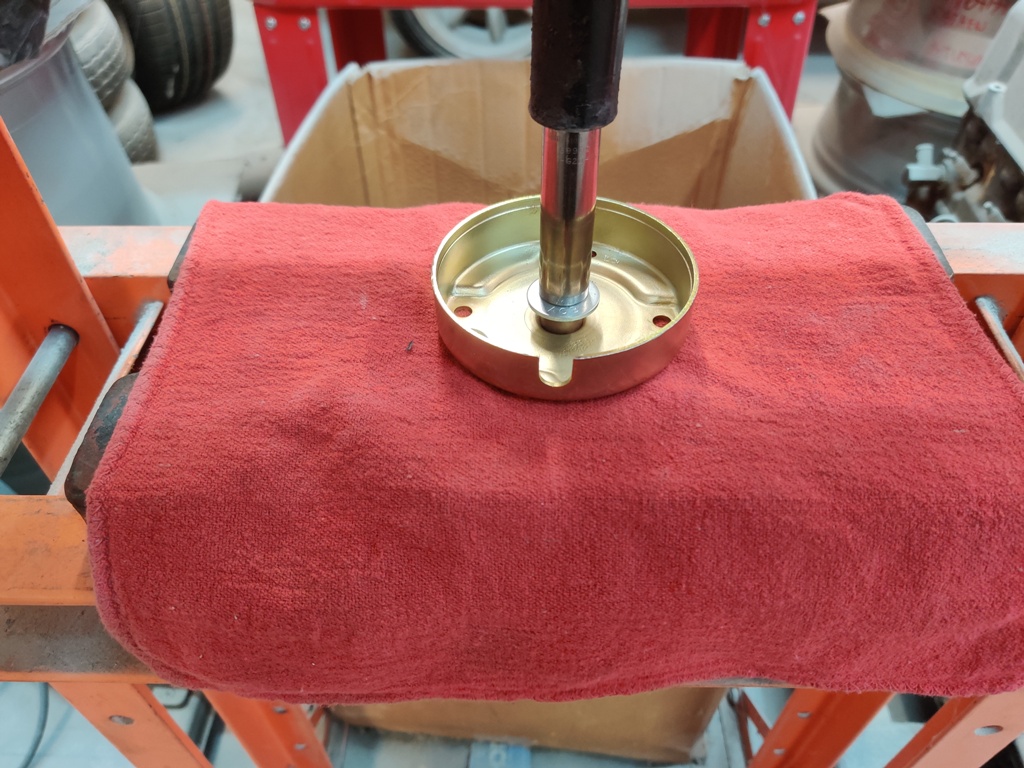

The bushing is a light press fit.  My measurements showed it was about .002" larger on the OD than the starter front cover "well" that the pushing presses into.  After it was pressed in, I used a reamer to get the ID to a size within factory specification.  I went through two bushings here because, I thought the reamer would "self center and ream straight.  That ending up being laughable.  Using a drill press would be sufficient, however, I don't have one yet.  It's one of those tools I just haven't committed to investing in.  So, I rigged up a contraption that helped with my drill angle on the second bushing and got somewhat lucky with reaming straight.  For the back bushing, I did not have a suitably sized reamer and used a "paste" to get the bushing to size.  The bushing ID was very close, but using the 320 grit paste and the armature to get the clearance to spec was arduous.  I've never installed and sized bushings for an armature before.

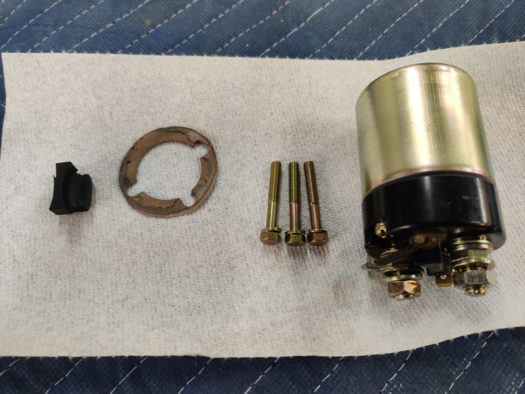

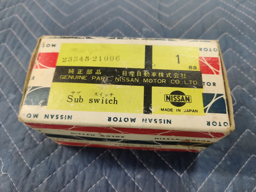

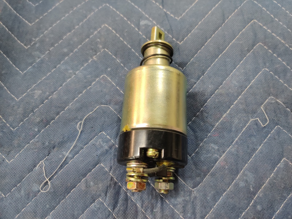

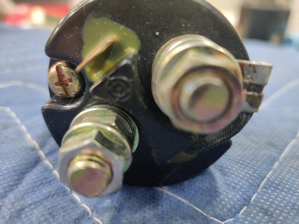

After decades of sitting in my parts bin, I was finally able to install the NOS solenoid.

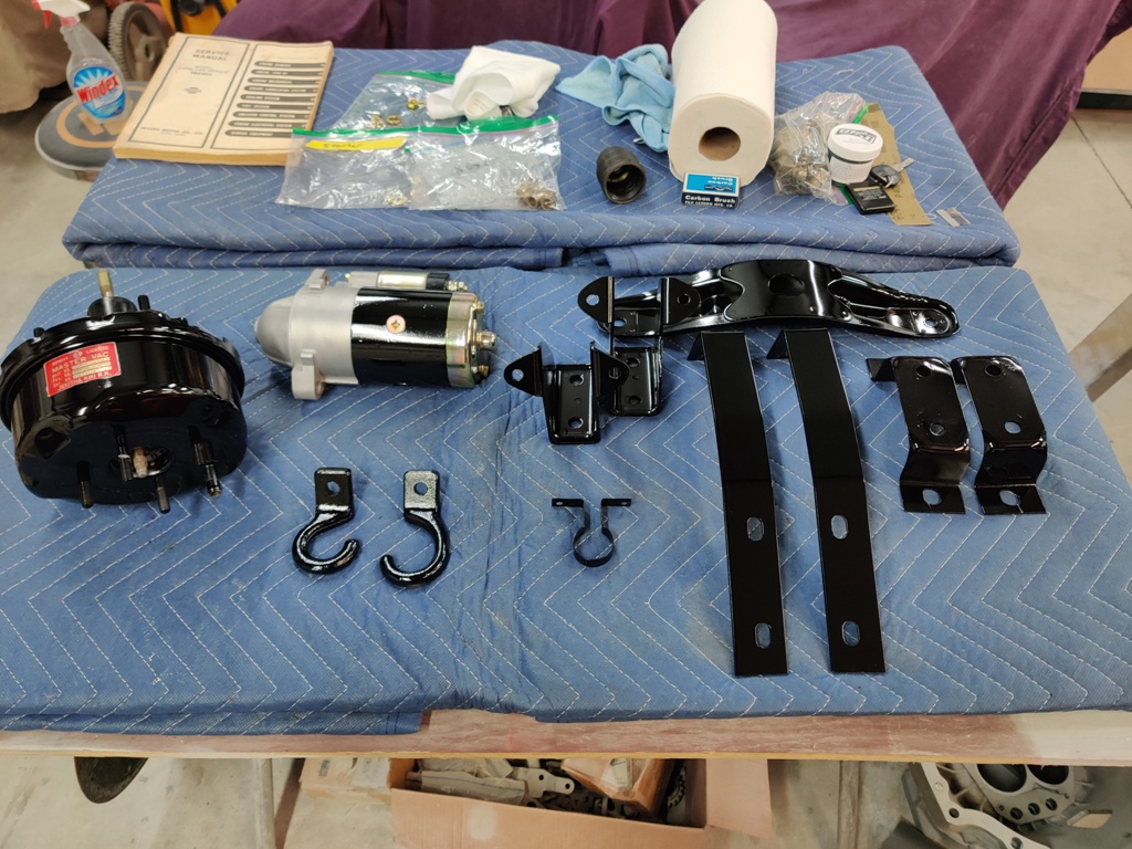

Compared to body work, the pace of progress on this kind of stuff makes me laugh - the sense of accomplishment per hour spent is off the charts.

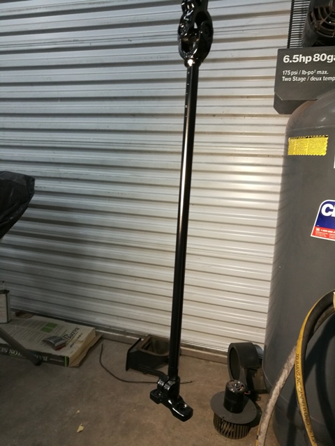

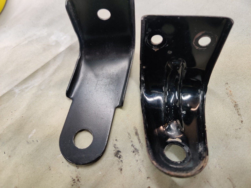

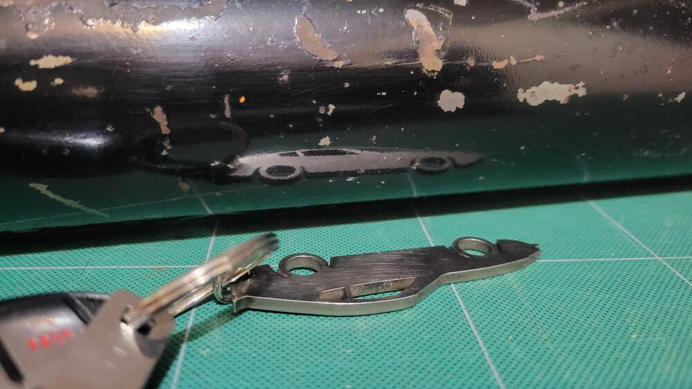

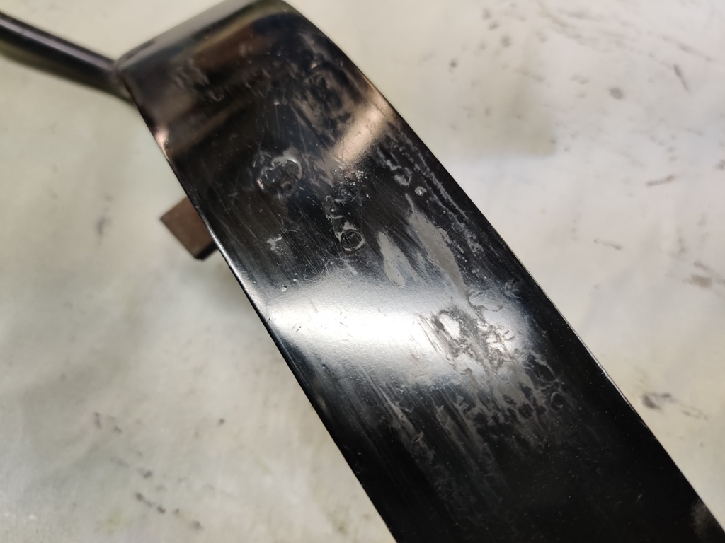

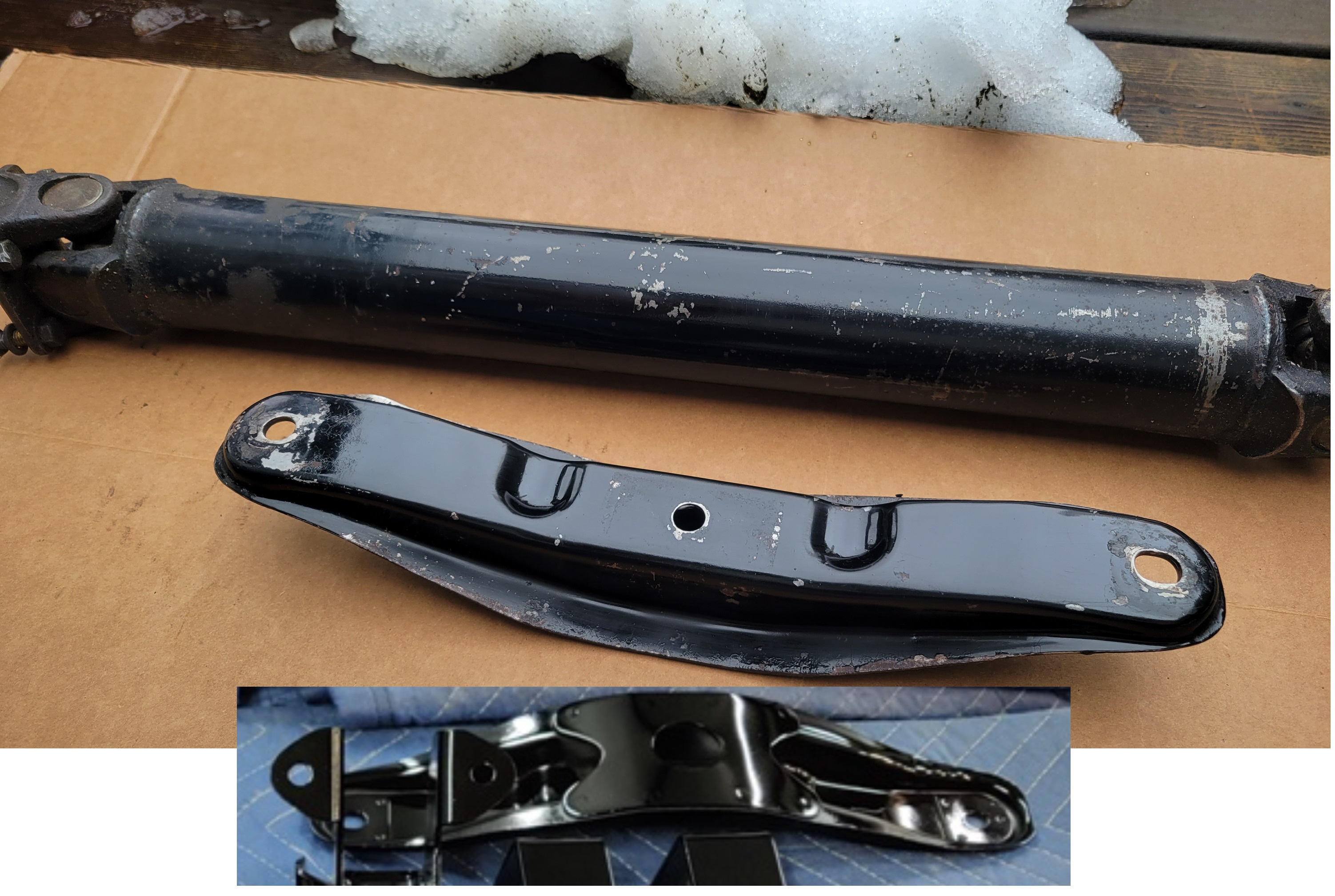

Another note about the gloss level of the black parts - steering shaft on the left mustache bar in the center, and main driveshaft on the right:
As I said before, the mustache bar has too much "flattening agent".  But looking again at these three parts, I think the steering shaft and main driveshaft had a little too much also.  I will respray the mustache bar, but I am ok with the other two.  It's not going to kill me that a few parts are a tad bit dull.
Other parts that I have painted black thus far include the motor mount brackets and transmission mount bracket, the bumper brackets, the brake booster, and the bracket for the one way valve for the booster.
The next round of painting parts black will be a slog, starting with blasting, then priming, then painting.  All kinds of assembly will be possible after that.

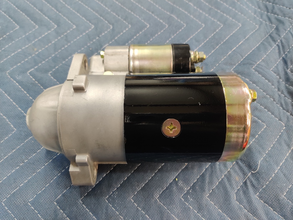

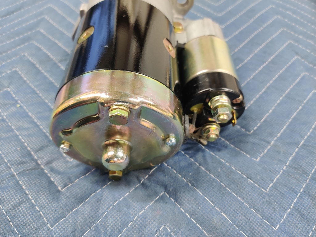

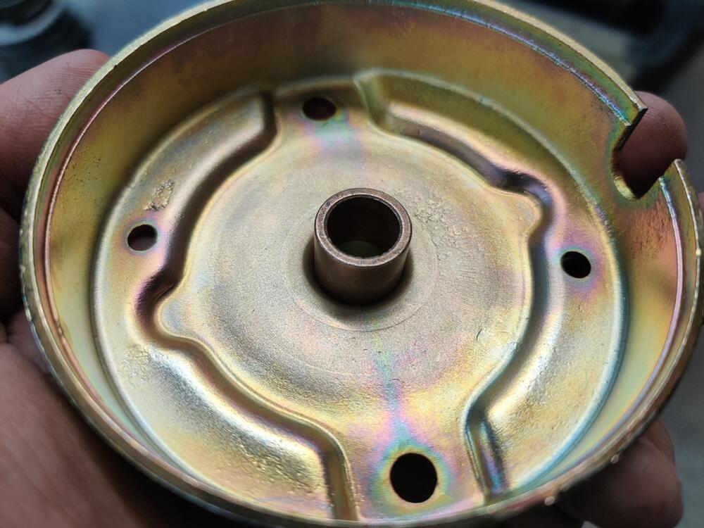

I bench tested the rebuilt starter tonight, and unfortunately, it didn't go as planned.  The motor started spinning at a nice speed but then slowed.  I thought, "that is odd... and not right".  So I tested it again - brief amounts of juice and it would repeat the same behavior.  So, about on the fourth test, I kept current applied for a bit longer, and I saw a bit of grease or oil bubble up off of the back bushing.  I stopped immediately.  I wiped the drop of oil that formed off with my finger and detected that the backend of the armature and the bushing were quite hot.  Yeah...
So, I took the starter back apart and long story short, made another round of using the 320 grit lapping paste on the front and rear bushings.  When I reassembled, I checked that the pinion gear rotated nicely by hand.  Then I torqued the fasteners, checked pinion gear rotation by hand one last time, and bench checked again.  This time the motor spun very nicely and didn't slow down at all.  I checked for heat at the front and the back and only detected a small amount of warmth, not hot at all.
Would have been a problem had I mounted it on the car without checking!
