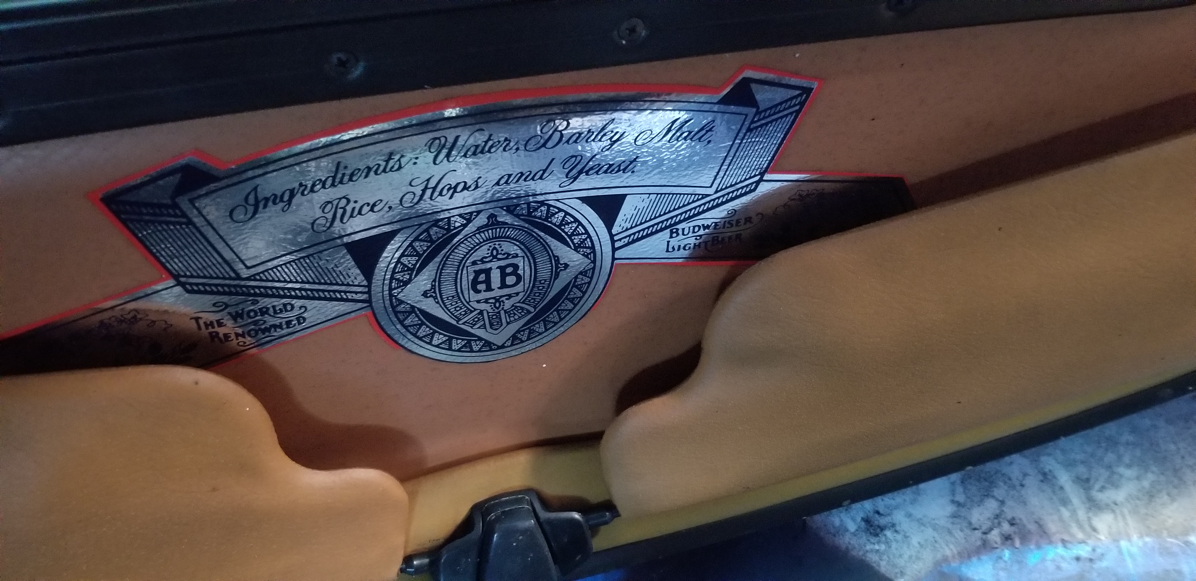

Between the decal and the sunroof, there was no way I could salvage this headliner!
You may want to check a store like hobby lobby for foam. I bought a near perfect match for a bmw headliner there. I have had good luck with 3M headliner spray on adhesive.

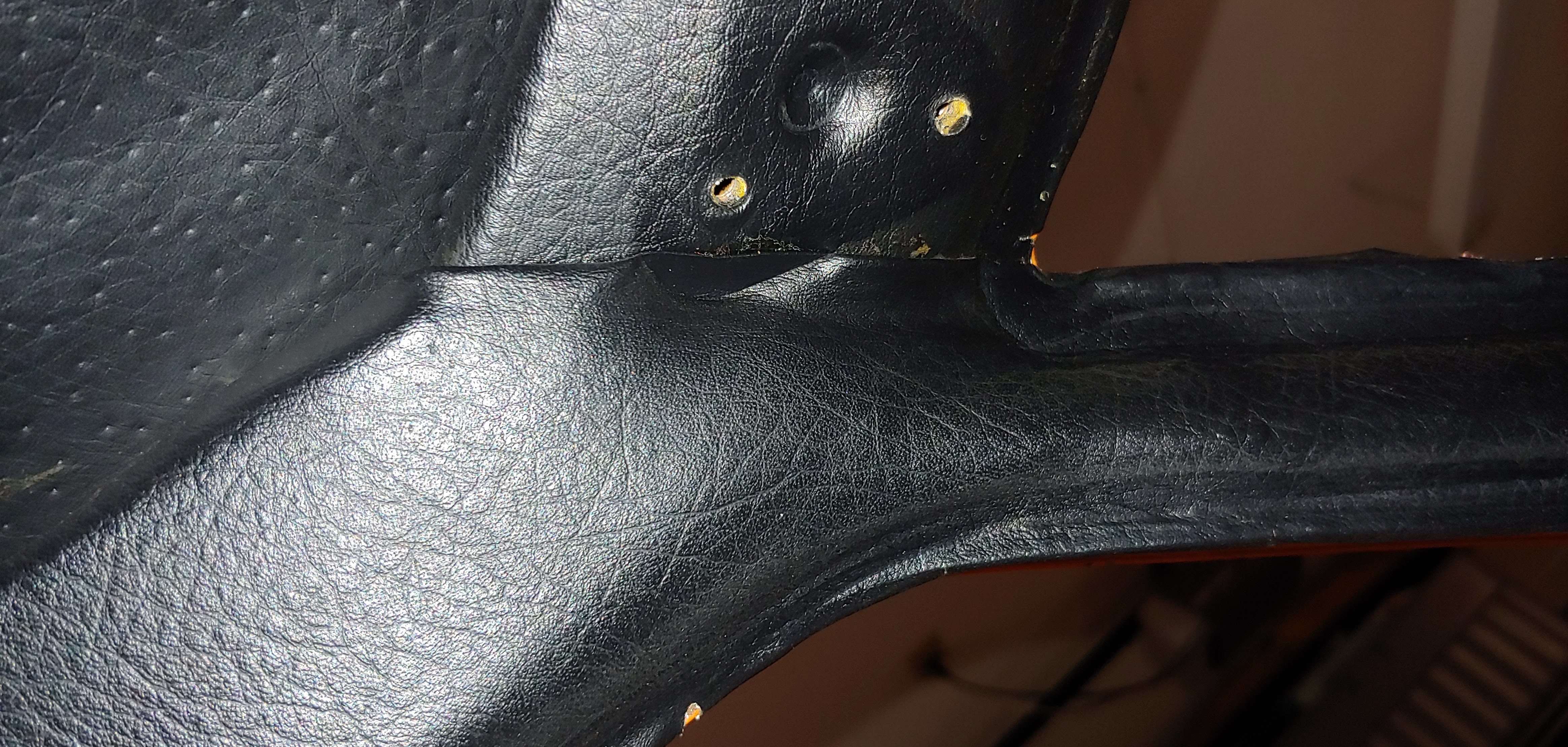

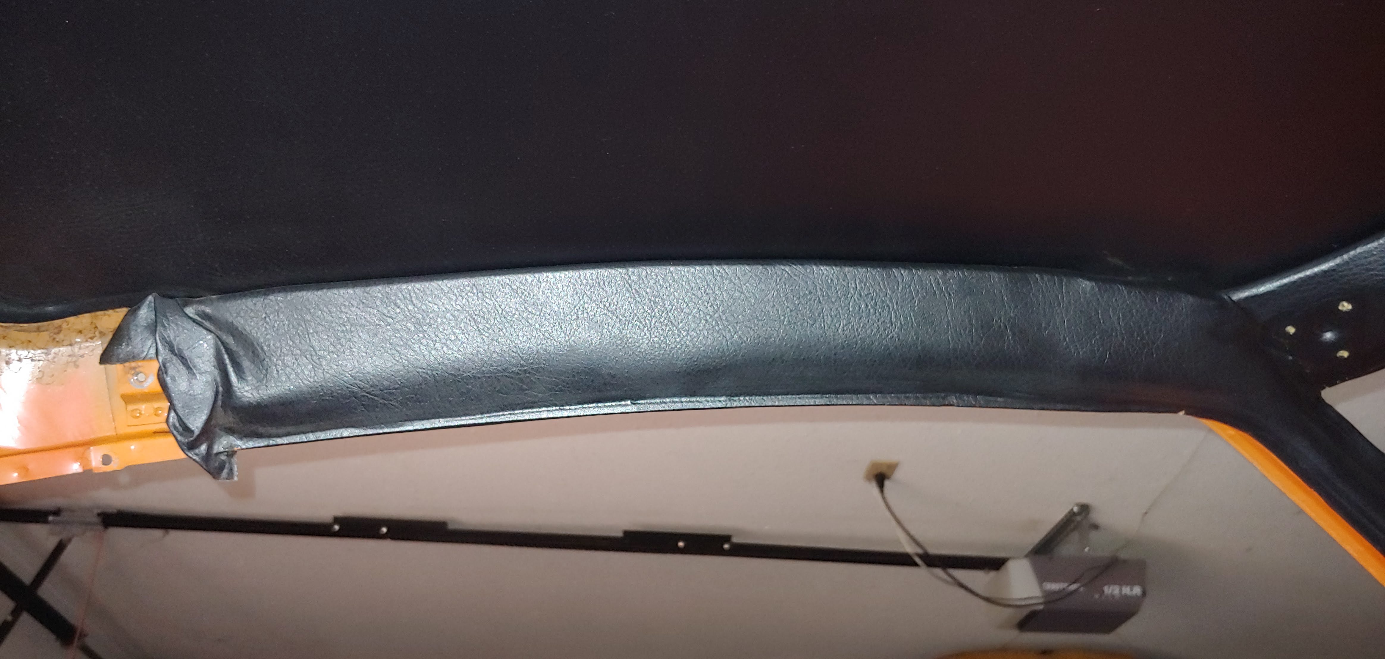

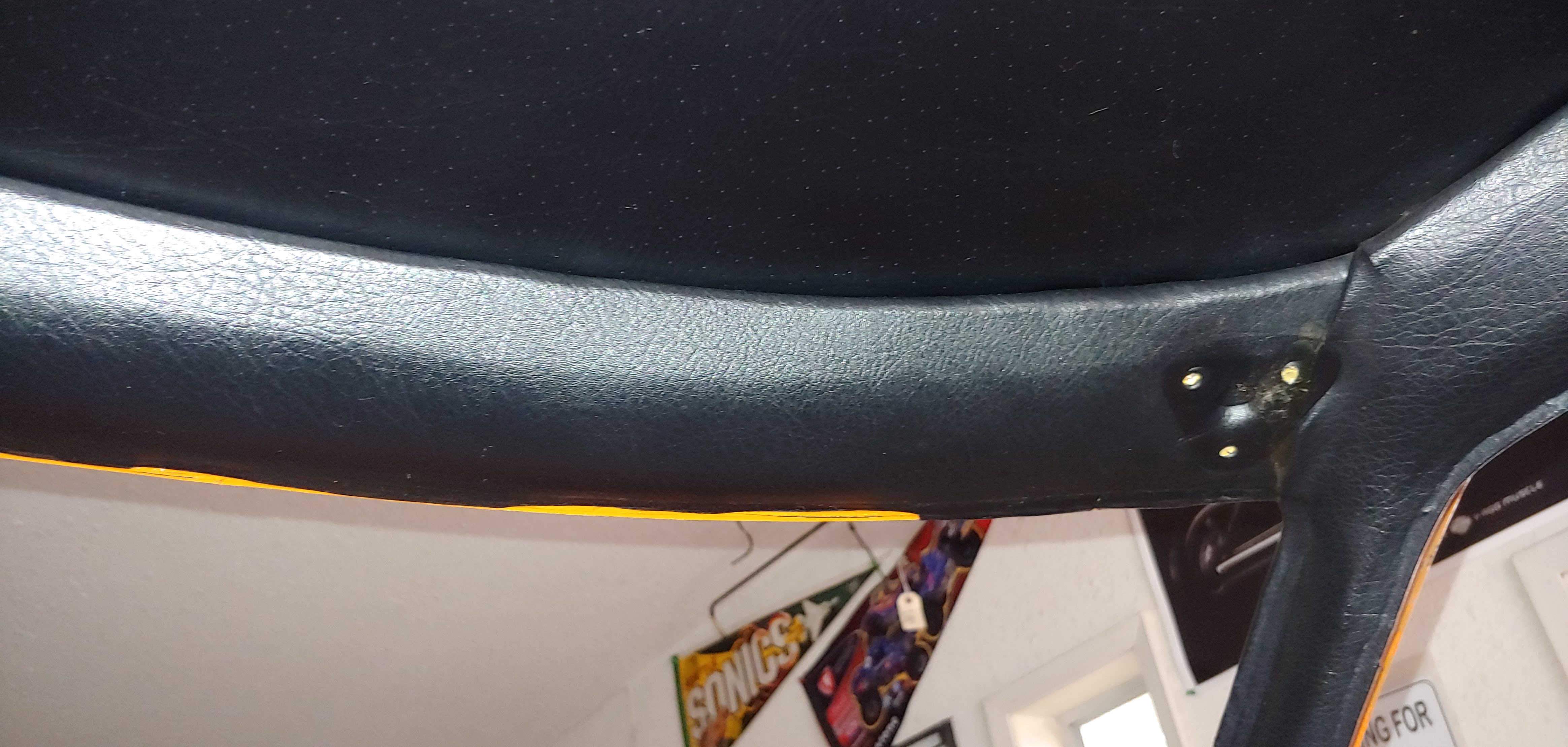

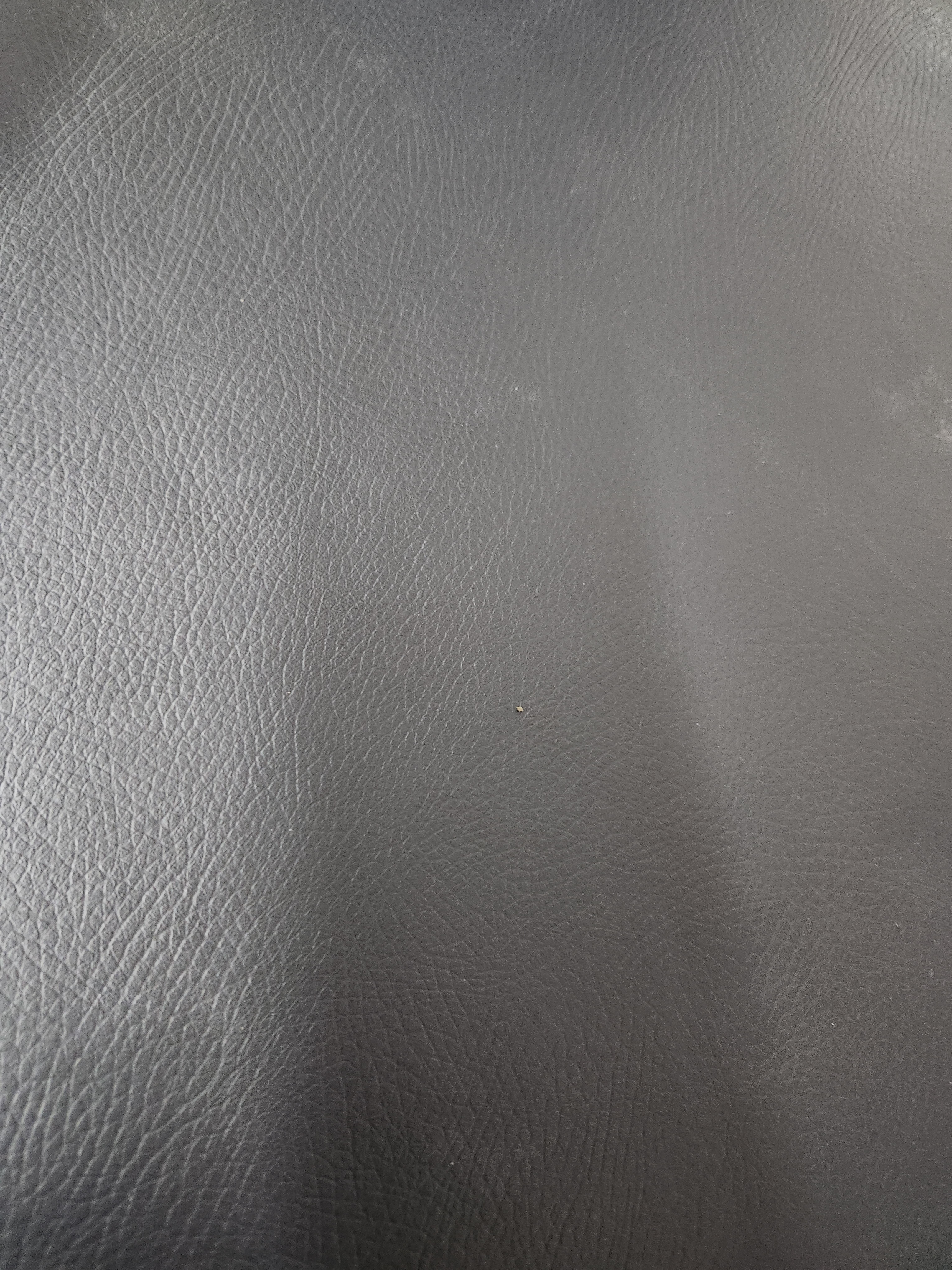

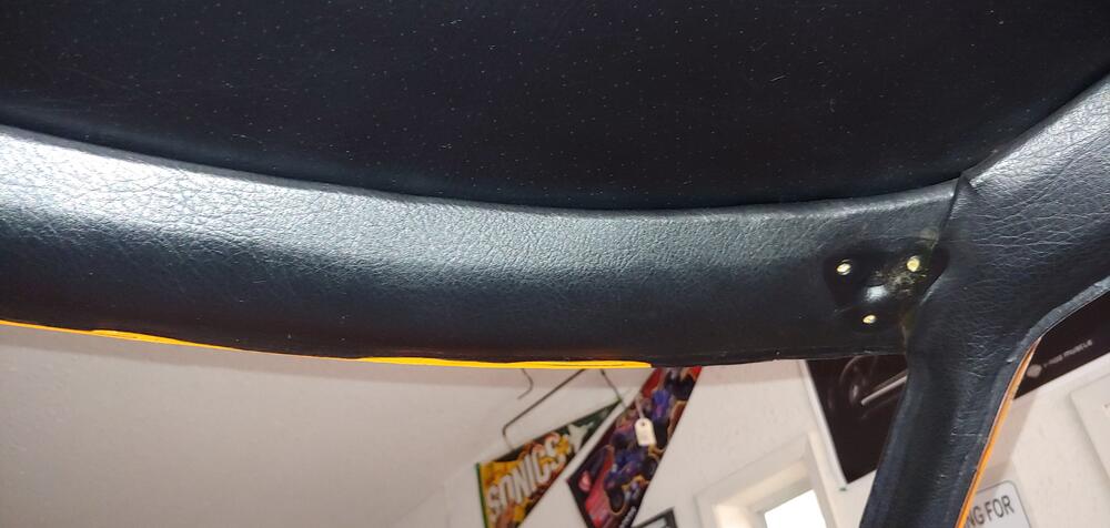

In my case the headliner, both the vinyl and foam backing are in excellent shape. No damage to the vinyl and the foam (polyurethane?) is still fully intact and still has excellent flexibility, memory. The original headliner has a very unique fine grain and light "stippling" effect that I have yet to see on reproductions. Repos I've seen have almost no graining or to much with what looks like perforations. If someone makes one that is very close to OEM I may possibly go that route but for my restoration I am trying to use/re-use as many original parts and materials as I can. Here a few pics of my OE headliner showing the texture at different angles, it's hard to capture in pics.
The very unique arrangement of pin holes forming a circular pattern on the original headliner is not something I have seen in any replacements.  There are pros and cons for going either direction, but I would like my headliner to be the original vinyl with those holes.
That is great that yours is in such good condition CantechZ, and the pillar trim too.

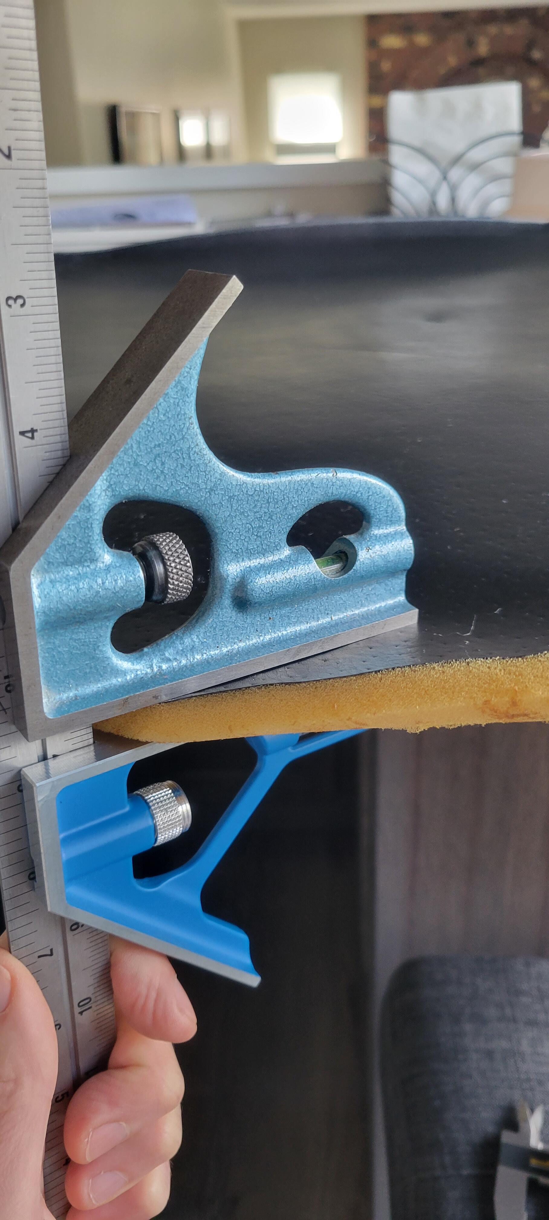

Measured the foam on my replacement headliner from Banzai. Its a bit over 1/2 inch. I measured another old one from a 280 and it was a little less than 1/2 inch. I would say 1/2 inch foam would be about right. FWIW, the one from the 280 did not have any holes.
Picture of replacement headliner:20230413_144344.jpg

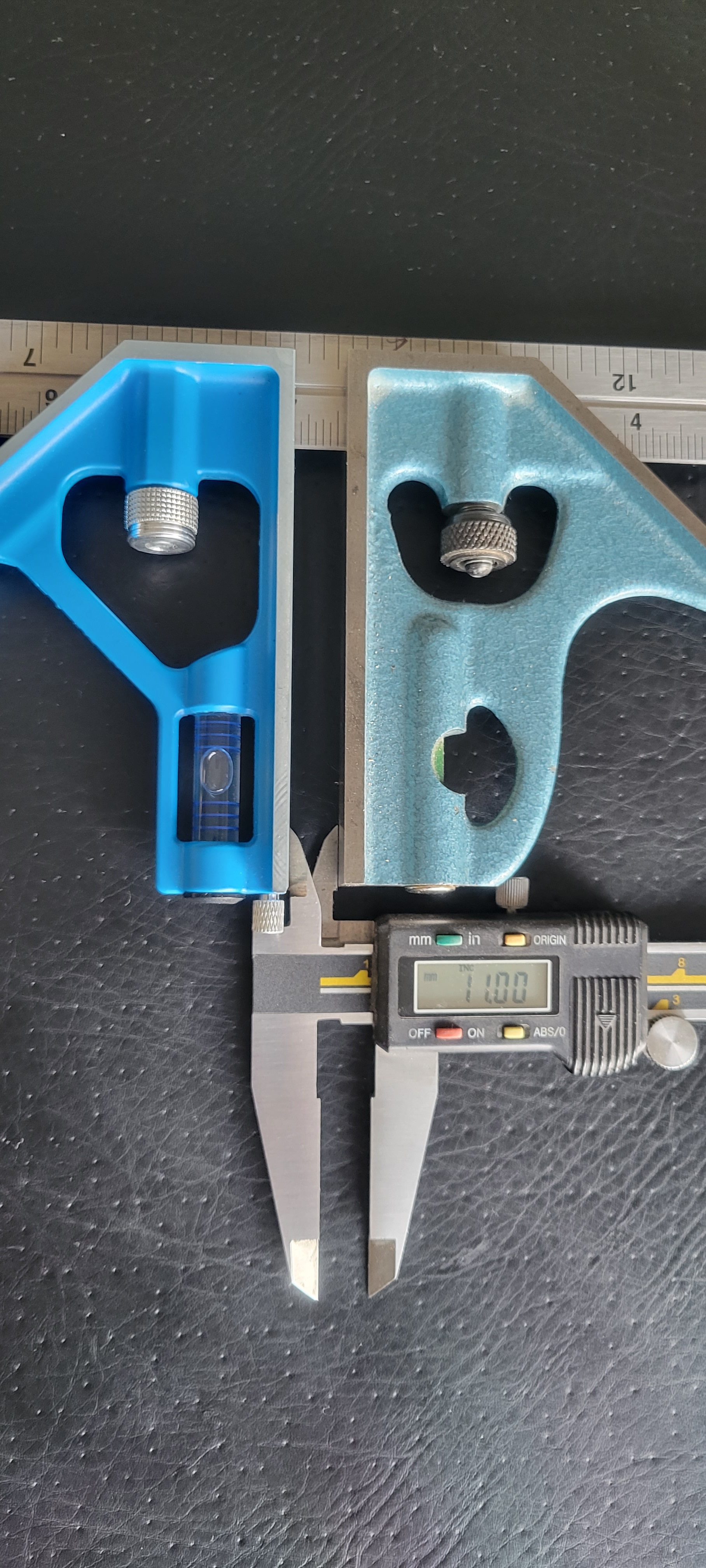

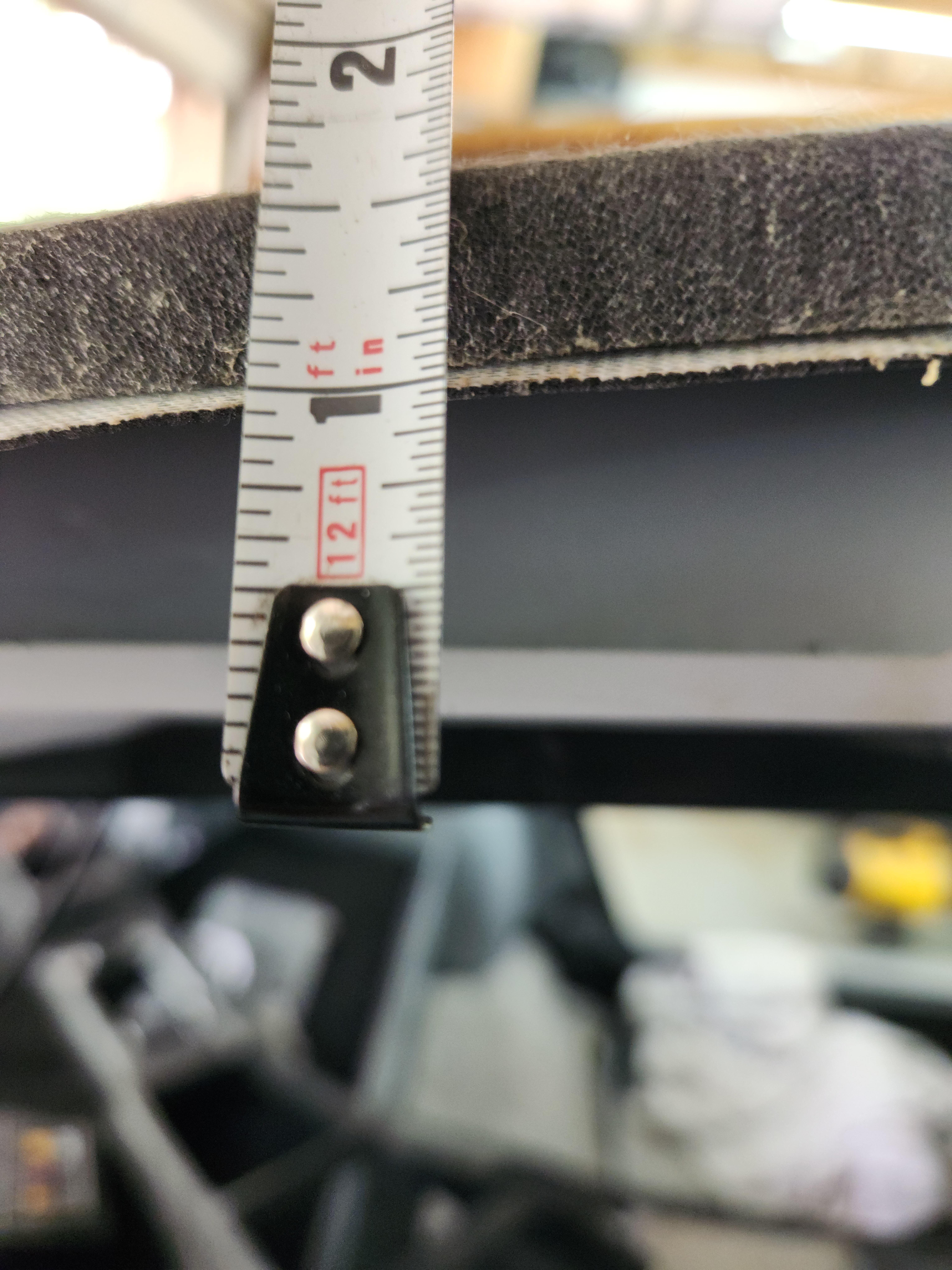

Here is the measurement of the OE headliner from my 7/70, overall thickness 11mm (.433") and best I could measure the vinyl thickness is 0.3 mm (.012")

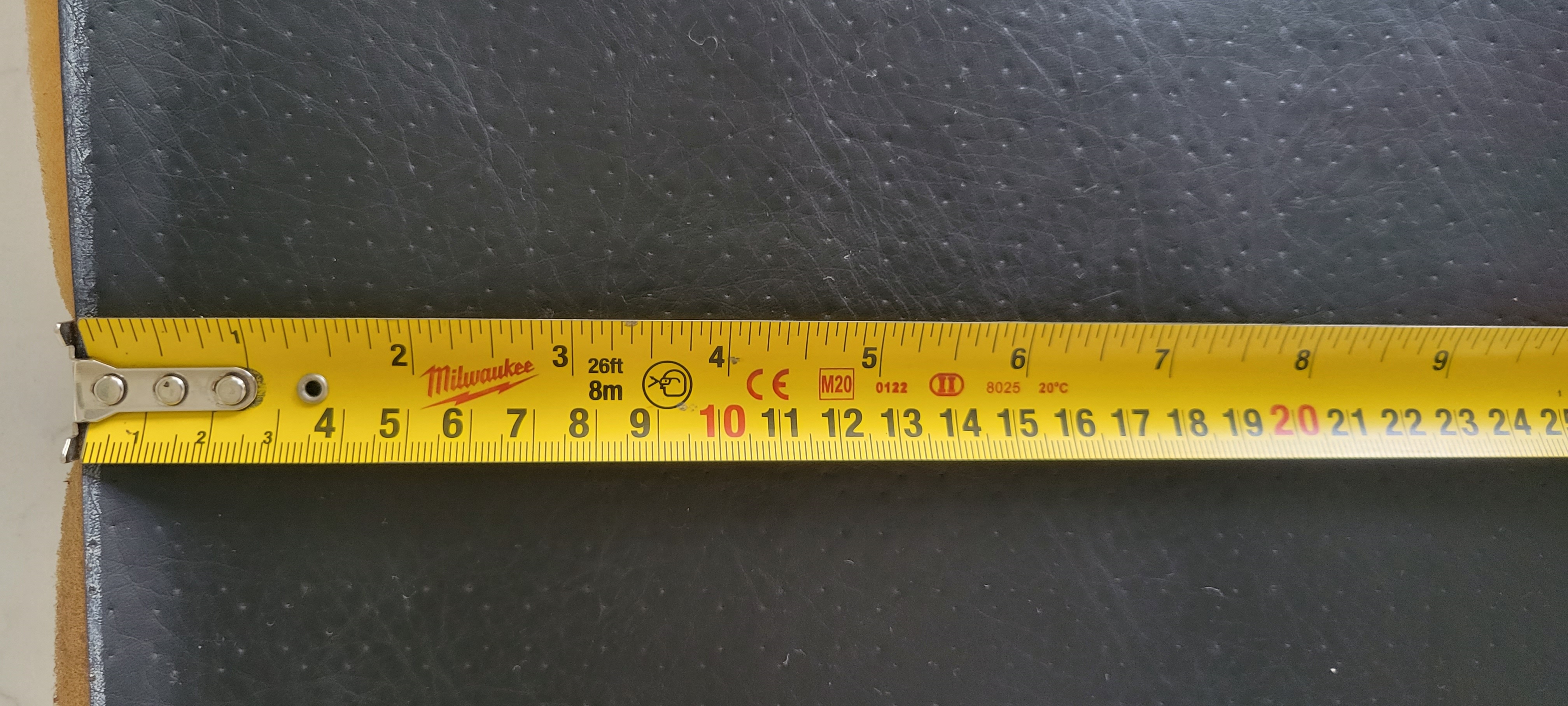

Here's a pic showing the grain and "stipple" pattern with a tape measure. I call it stippling as it's more of a depression, definitely not a hole that goes through the vinyl.
