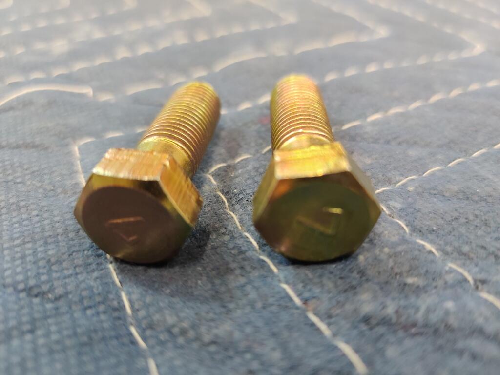

November 9, 20231 yr comment_659237 Here is my attempt at decoding the Nissan part number for this bolt, from the parts book the part number and description is: 08124-03010 BOLT - HEX M10 (UPTO 07/73) Here is the decode: 08124-03010 BOLT - HEX M10 08 = standardize hardware prefix 12 = Hexagon Bolt, Medium carbon steel 40 = 10mm diameter (M10) 30 = 30mm length 1 = Zinc cadmium coated 0 = Filler to complete ten digits Decode source: http://datsun1200.com/modules/mediawiki/index.php?title=NES_Part_Numbers Here is a snippet from an old Nissan technical publication about standard bolts, from this and info in the link above, my interpretation is that "Medium carbon steel" for this bolt would likely indicate a "7" marking on the head. Link to comment https://www.classiczcars.com/forums/topic/63087-restoration-of-bringatrailer-240z-hls30-35883/?&page=48#findComment-659237 Share on other sites More sharing options...

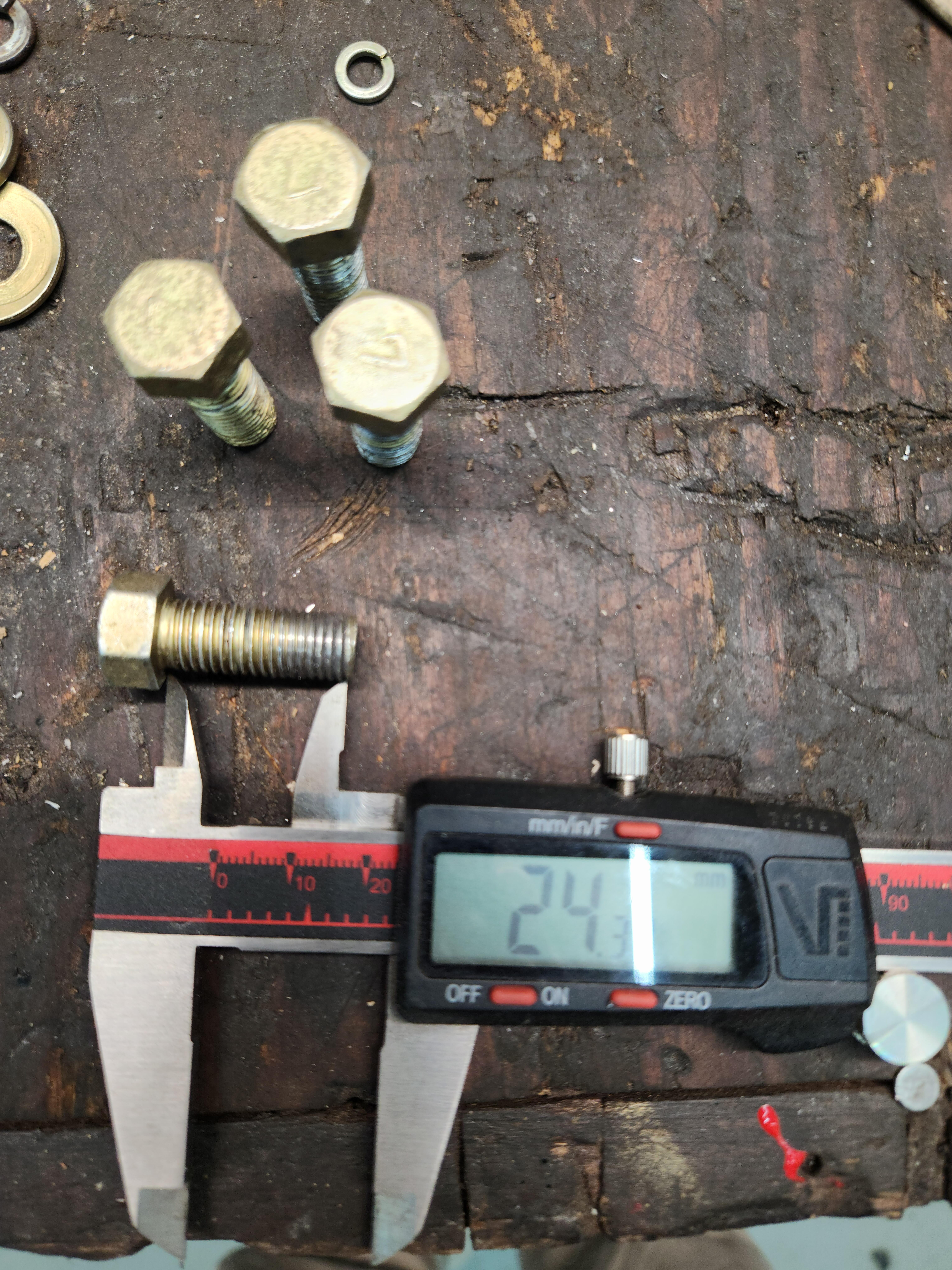

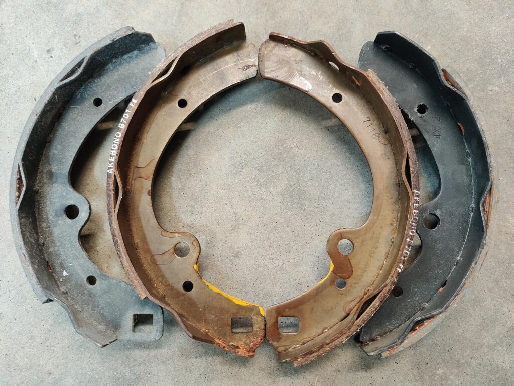

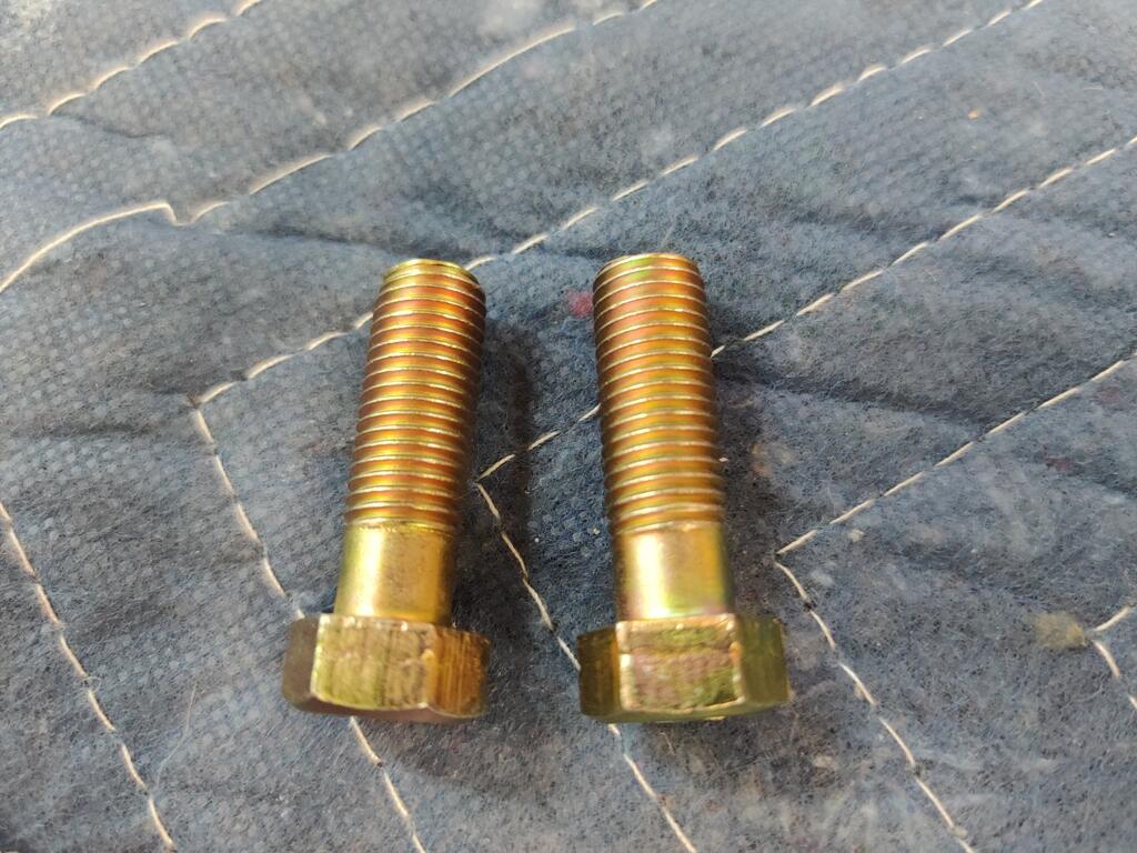

November 10, 20231 yr Author comment_659246 I found two of them - I think. They are 30 mm long, but the threaded portion is more like 23 mm instead of 21, by my measurement. The prior owner of the car had done some rear suspension work and apparently, while going through that work, was replacing most of the factory hardware with 8.8 grade stuff. Luckily nearly all the stock hardware was kept with the car. But, two of the bolts I do not have. And interestingly, my transmission crossmember bolts are similar, but have 9's on them. So they aren't right either, I guess. For now, I'll use two of the grade 8.8 bolts (pictured). While I'd like to get 4 of these (two for the crossmember and two for the transmission), it isn't the end of the world if I can't track some down. I also ran into this unexpected problem tonight - the "240z" OEM brake shoes I bought are for some other Nissan model. Note the location of the "eyelet" holes in the metal stamping for the two inner (OEM) vs the two outer (black) shoes (aftermarket) that were installed in the car when I got it. Whatever B701 FE is, it isn't unique to the correct OEM versions of the shoes for a 240z. Brake shoes are pretty cheap parts for this car, comparatively. I'd like to have some OEM ones. So, I found some online in Austria. I'll see if those are legit. Otherwise, I guess I will install the ones that were installed by the previous owner. A few pics of the brake cylinder I also installed tonight: Edited November 10, 20231 yr by inline6 Link to comment https://www.classiczcars.com/forums/topic/63087-restoration-of-bringatrailer-240z-hls30-35883/?&page=48#findComment-659246 Share on other sites More sharing options...

November 10, 20231 yr comment_659251 10 hours ago, inline6 said: I found two of them - I think. They are 30 mm long, but the threaded portion is more like 23 mm instead of 21, by my measurement. The prior owner of the car had done some rear suspension work and apparently, while going through that work, was replacing most of the factory hardware with 8.8 grade stuff. Luckily nearly all the stock hardware was kept with the car. But, two of the bolts I do not have. And interestingly, my transmission crossmember bolts are similar, but have 9's on them. So they aren't right either, I guess. For now, I'll use two of the grade 8.8 bolts (pictured). I had a look at the bolts for my transmission crossmember, and they do have the 7 on the head but they are only 25mm long. Definitely original as they have the yellow paint mark on them. Looks like there was some switching happening on the factory floor. Did you find any that are 25mm long? Also while searching the web for a JIS fastener dimension chart with the older small heads I came across a company called Fastener Mart. I have never ordered from them but they do list M10x1.25 x 30mm long JIS B 1180 small head. Here is a link, on that page there is a link to a pdf dimensional chart with JIS B 1180, DIN, ISO and ANSI specs. The chart does show 14mm A/F x 7mm head ht. for JIS B 1180, M10. Likely the head marking would be 8.8 https://www.fastenermart.com/BFK693-620.html Edited November 10, 20231 yr by CanTechZ Link to comment https://www.classiczcars.com/forums/topic/63087-restoration-of-bringatrailer-240z-hls30-35883/?&page=48#findComment-659251 Share on other sites More sharing options...

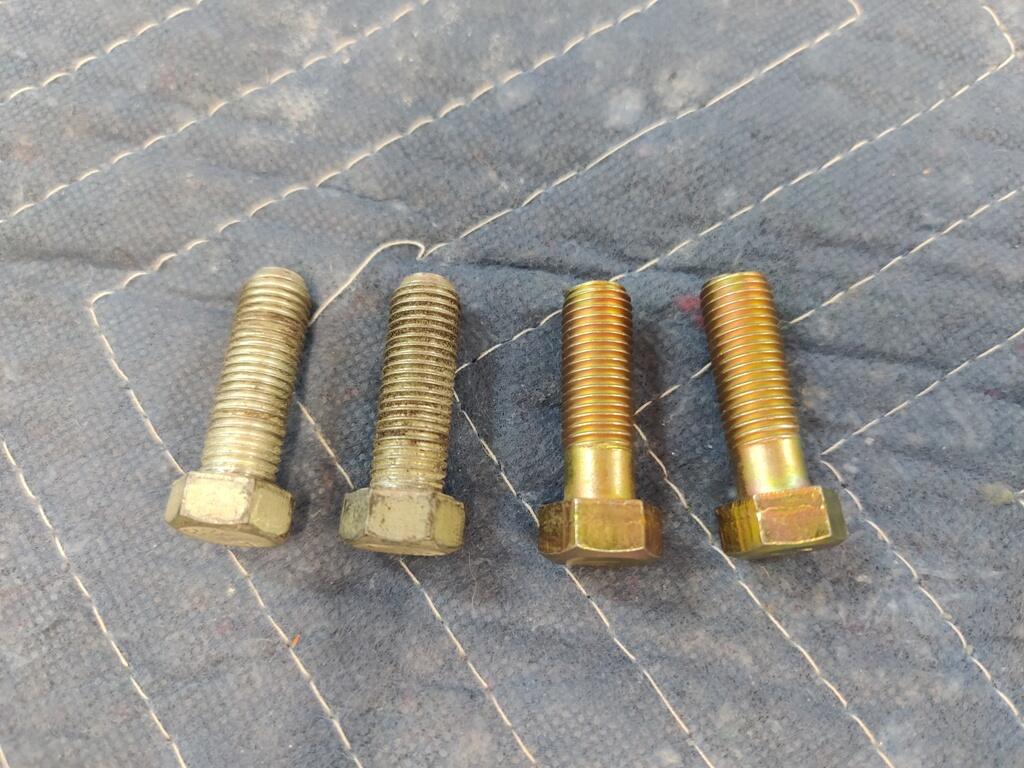

November 11, 20231 yr comment_659296 I got 4 of these. Threads don't look great but may be able to chase them. There yours if you want them Link to comment https://www.classiczcars.com/forums/topic/63087-restoration-of-bringatrailer-240z-hls30-35883/?&page=48#findComment-659296 Share on other sites More sharing options...
