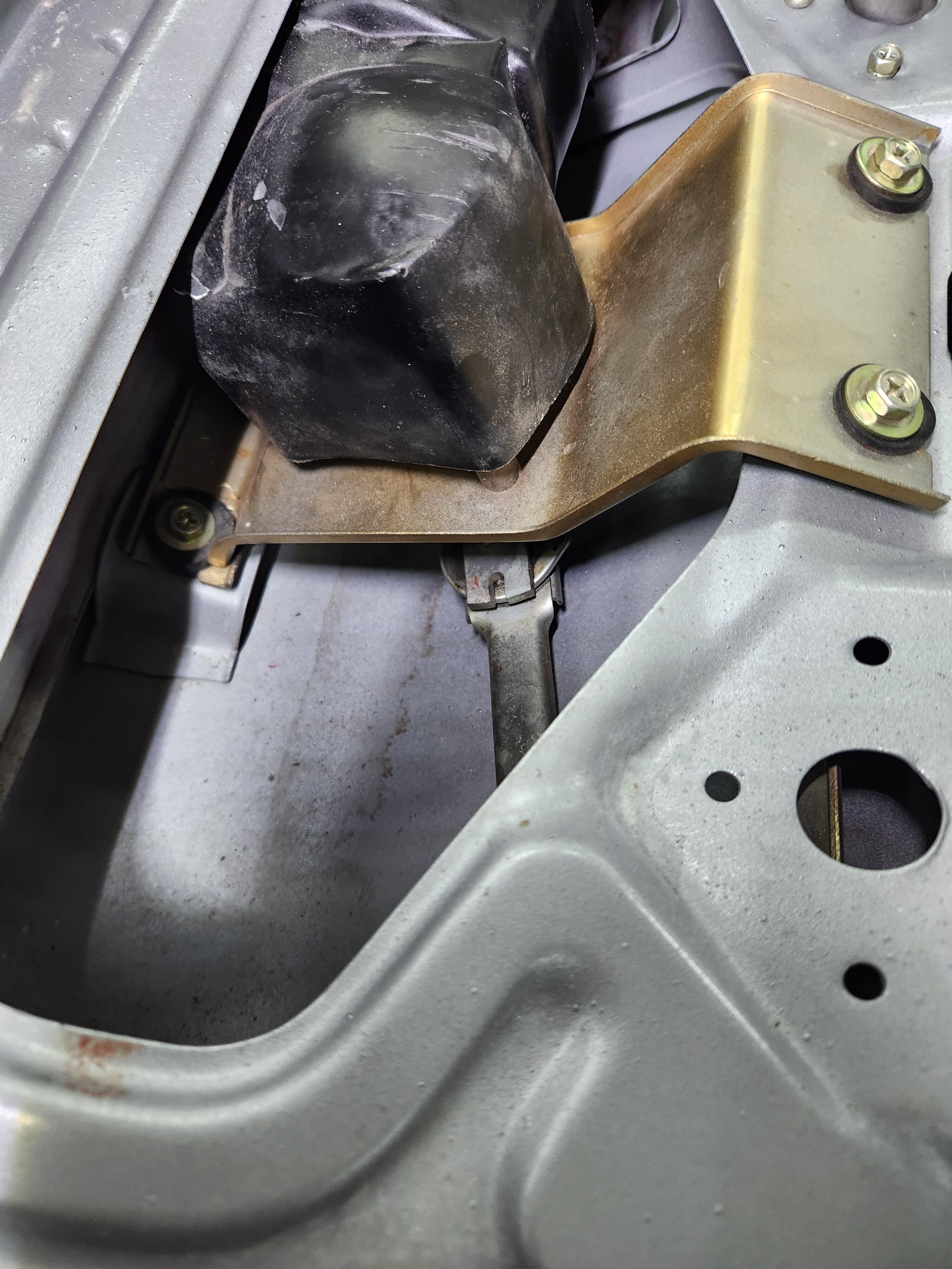

February 4, 20241 yr comment_661698 Tip, so you dont make the same mistake I made. Double and triple check your wipers to make sure they are working correctly before putting on the blades. I hooked up the wiper arm to the motor in the wrong position and it caused them to work almost backwards. Make sure motor is in "park" then hook the arm to the motor. It can go on two different ways. Mine looks like this and works properly now! Link to comment https://www.classiczcars.com/forums/topic/63087-restoration-of-bringatrailer-240z-hls30-35883/?&page=59#findComment-661698 Share on other sites More sharing options...
February 4, 20241 yr comment_661701 40 minutes ago, emccallum said: Tip, so you dont make the same mistake I made. Double and triple check your wipers to make sure they are working correctly before putting on the blades. I hooked up the wiper arm to the motor in the wrong position and it caused them to work almost backwards. Make sure motor is in "park" then hook the arm to the motor. It can go on two different ways. Mine looks like this and works properly now! Yep, I made that mistake before, and then I learned of the warning being posted in various places. Link to comment https://www.classiczcars.com/forums/topic/63087-restoration-of-bringatrailer-240z-hls30-35883/?&page=59#findComment-661701 Share on other sites More sharing options...
