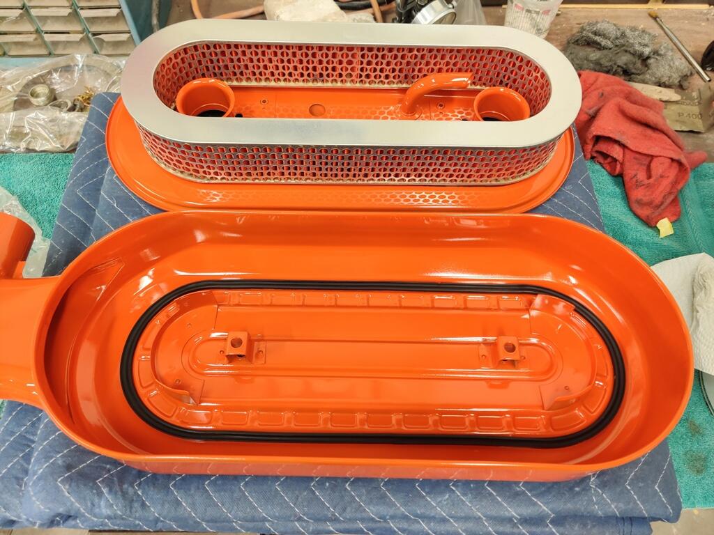

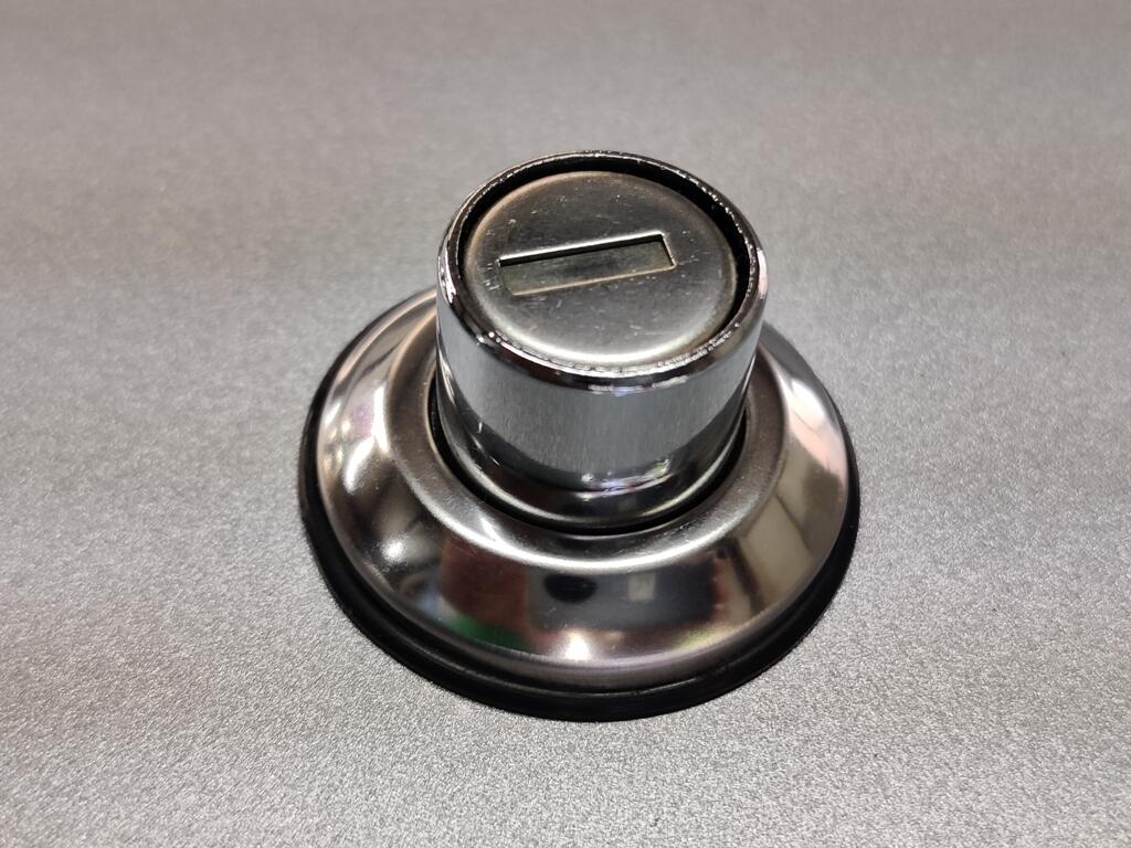

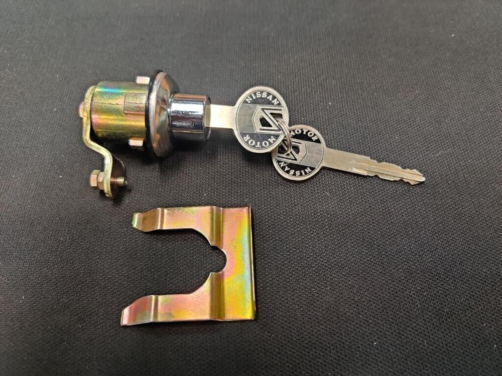

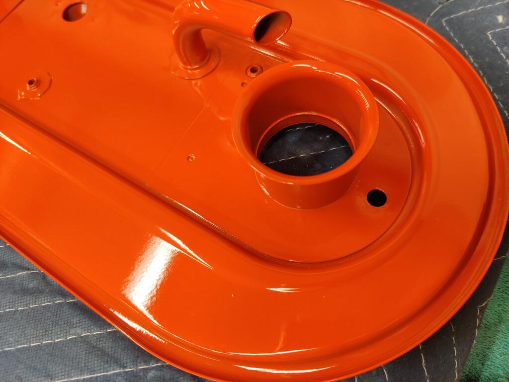

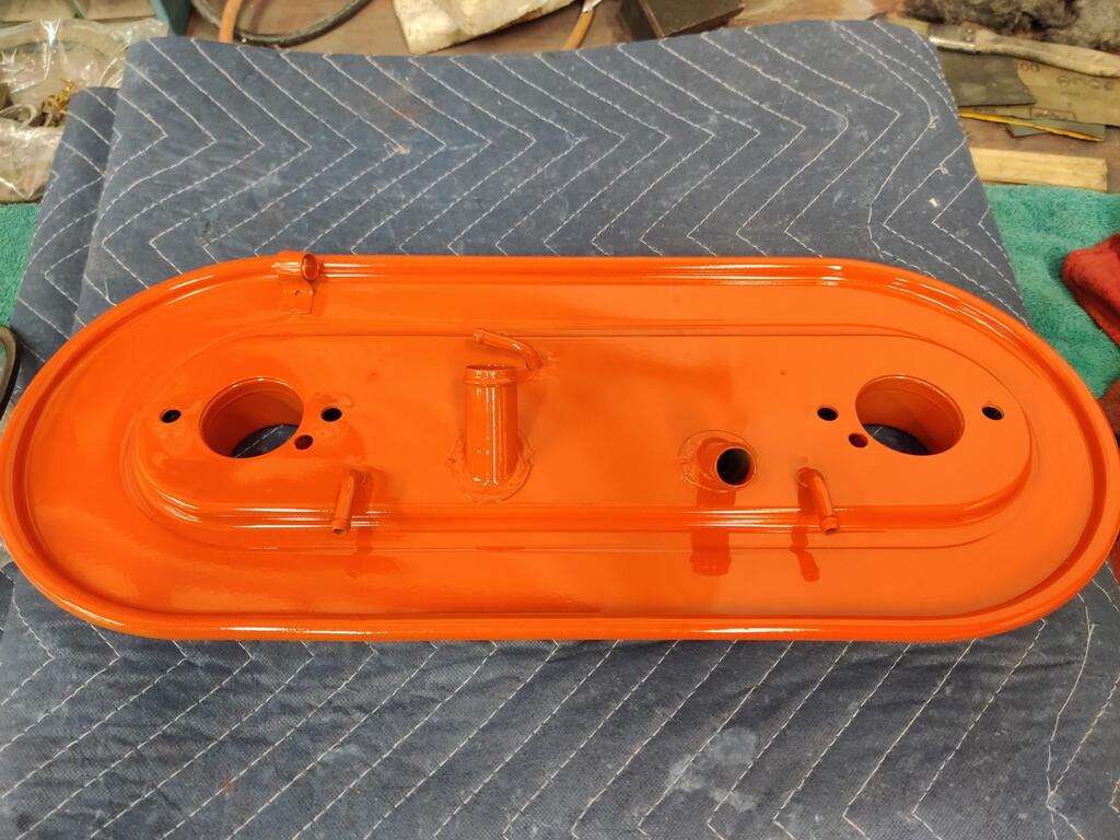

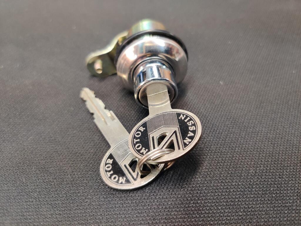

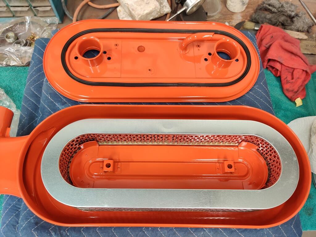

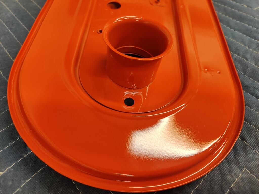

May 15, 2024May 15 Author comment_665499 I switched out the wafers in the NOS hatch lock to match the new keys and installed the lock in the hatch panel. These hatch locks start showing wear when the chrome on the sleeve gets thin from rubbing during operation. I am happy to have this as a new part! I decided to work on the air cleaner this evening. This was one of the first parts that I stripped, primed and painted a few years ago. Tonight, I re-glued the inner rubber strips. I used the same contact adhesive I have been using for everything. I have not made much progress in the last couple of weeks; however, I did get the bumpers and the seat belts shipped off finally. Turn around time for both is many weeks, so I am glad to cross that off the list. With any luck, I would think I could be able to finish the car by the end of July - right at six years from when I brought it home. Link to comment https://www.classiczcars.com/forums/topic/63087-restoration-of-bringatrailer-240z-hls30-35883/?&page=67#findComment-665499 Share on other sites More sharing options...

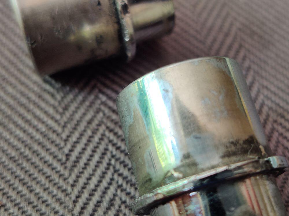

May 15, 2024May 15 comment_665508 6 hours ago, inline6 said: These hatch locks start showing wear when the chrome on the sleeve gets thin from rubbing during operation. Well.. show me a worn lock then.. why? Because i think they are made from (high chrome) stainless.. so any lock can be polished to new after it's worn. Only when it's really scratched and dented then you need a new one.. I think, all the locks from a datsun are stainless outside. Link to comment https://www.classiczcars.com/forums/topic/63087-restoration-of-bringatrailer-240z-hls30-35883/?&page=67#findComment-665508 Share on other sites More sharing options...

May 15, 2024May 15 Author comment_665516 9 hours ago, dutchzcarguy said: Well.. show me a worn lock then.. why? Because i think they are made from (high chrome) stainless.. so any lock can be polished to new after it's worn. Only when it's really scratched and dented then you need a new one.. I think, all the locks from a datsun are stainless outside. The sleeve around the lock tumbler is made of "pot metal" and is chrome plated. The movement in and out to open the hatch slowly wears through the chrome plating. As you can see in this picture, the chrome has worn away, exposing the copper layer beneath in a couple of areas. Polishing will not revive the uniform silver appearance. Additionally, because it is a soft metal, it wears relatively quickly. And that is significant, because the inside of this sleeve is what the tumblers work with for correct operation of the lock. The result is that many keys will work on this lock when only one used to. 🙂 Edited May 15, 2024May 15 by inline6 Link to comment https://www.classiczcars.com/forums/topic/63087-restoration-of-bringatrailer-240z-hls30-35883/?&page=67#findComment-665516 Share on other sites More sharing options...

May 16, 2024May 16 comment_665537 14 hours ago, inline6 said: The sleeve around the lock tumbler is made of "pot metal" and is chrome plated. I must say i NEVER have seen this.. I am always amazed at how many cars in the States suffer more, due to the heat and humidity? Thanks For the pictures! Btw, your car is going to be awesome! Link to comment https://www.classiczcars.com/forums/topic/63087-restoration-of-bringatrailer-240z-hls30-35883/?&page=67#findComment-665537 Share on other sites More sharing options...
