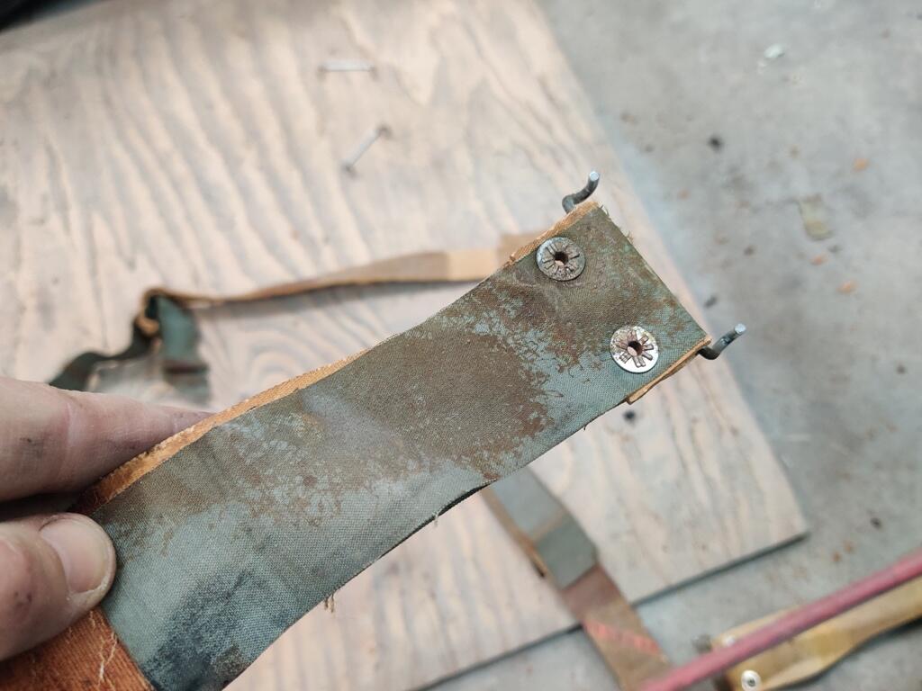

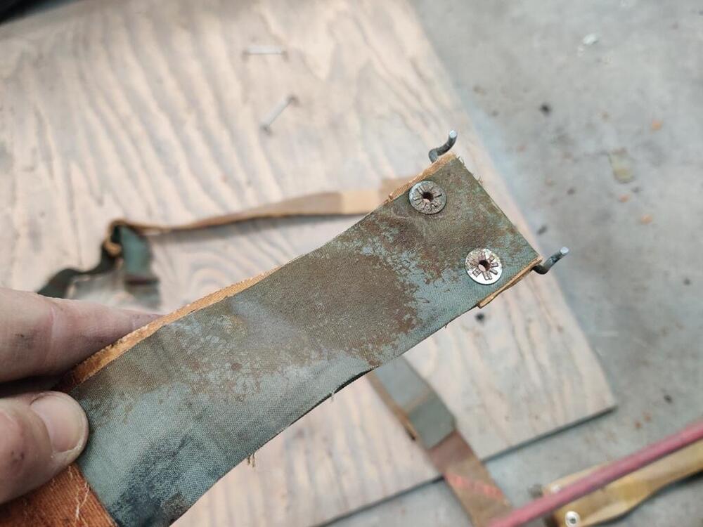

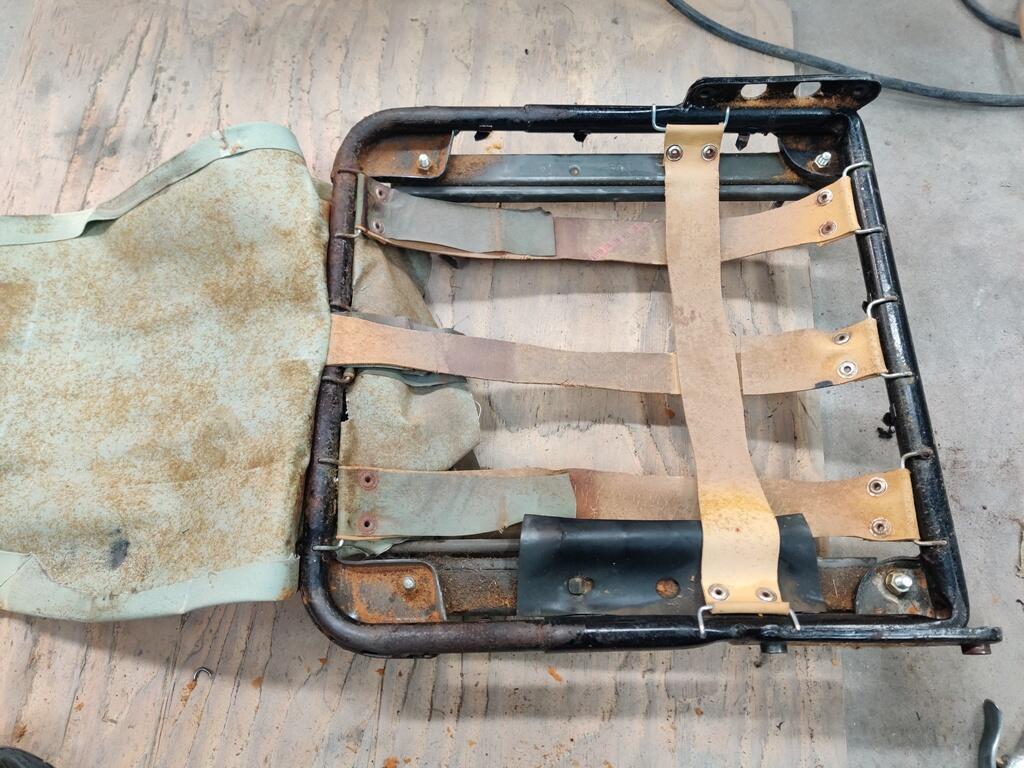

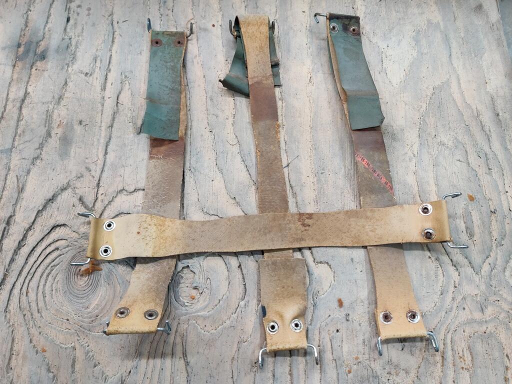

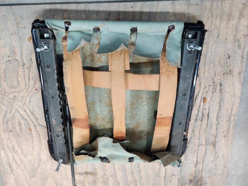

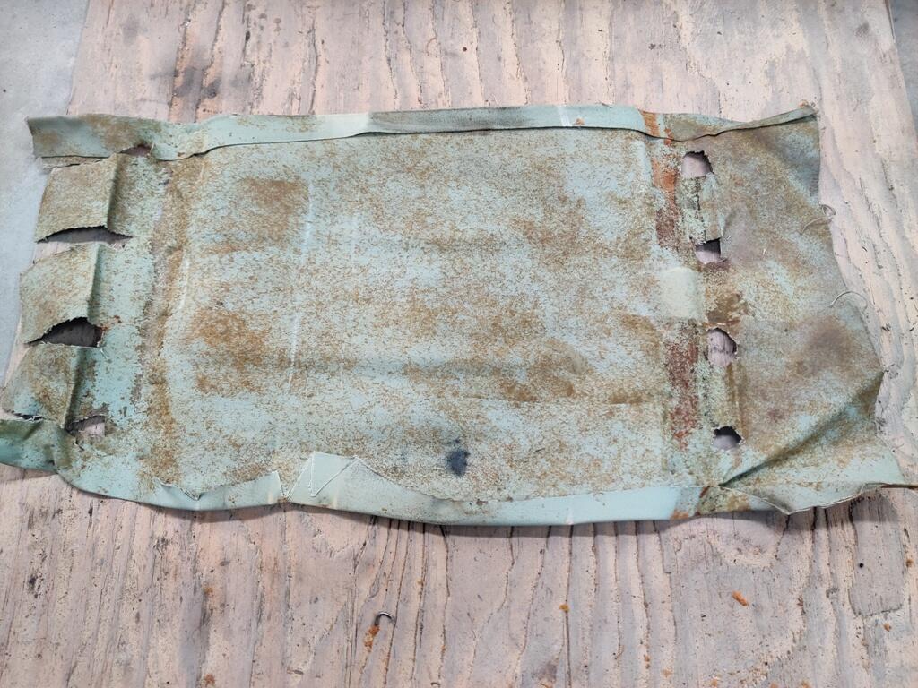

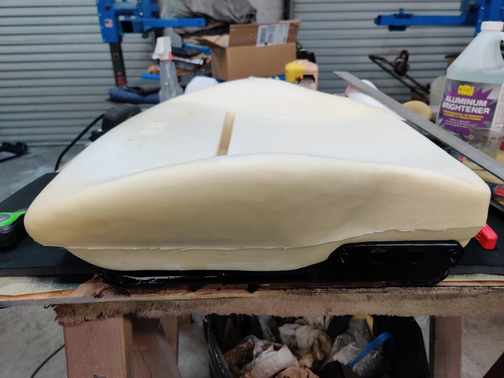

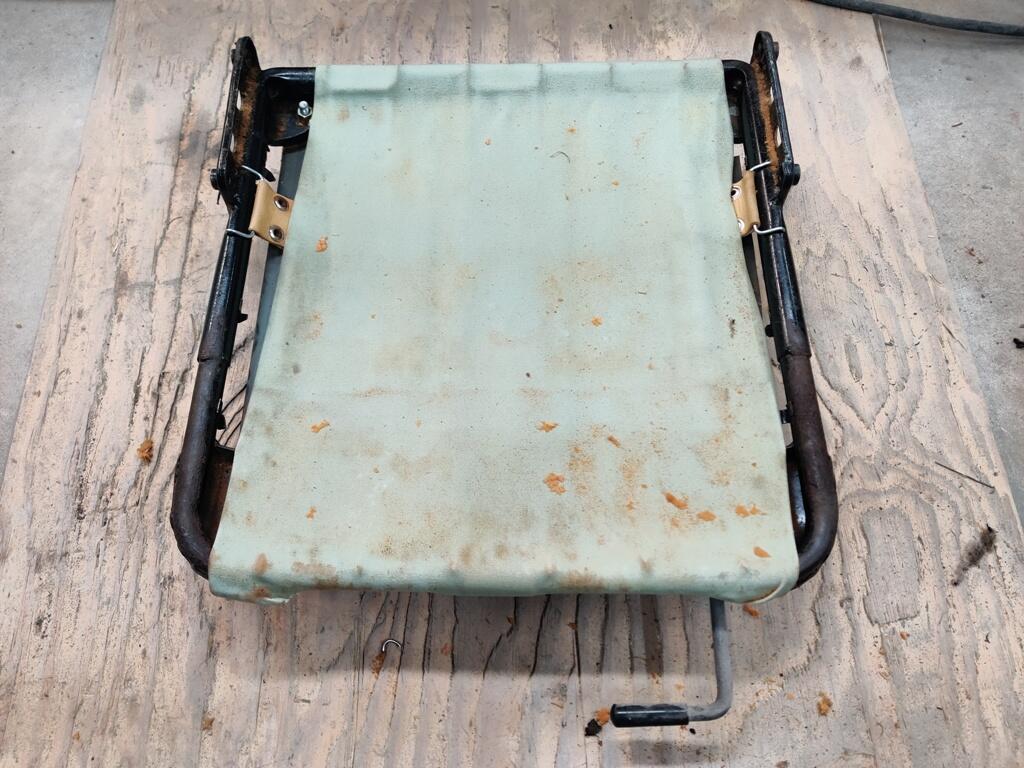

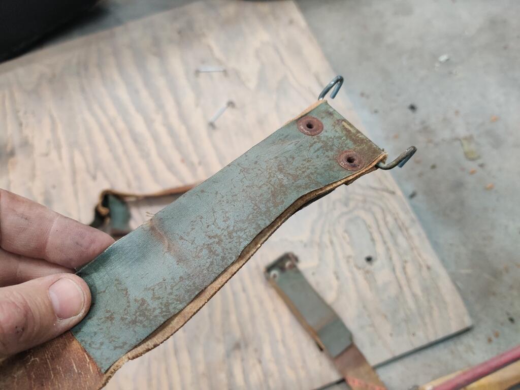

I have started rebuilding the seats.  These were reupholstered once before.  I have come to realize that this sheet of canvas material on top of the dry rotted straps is not original.

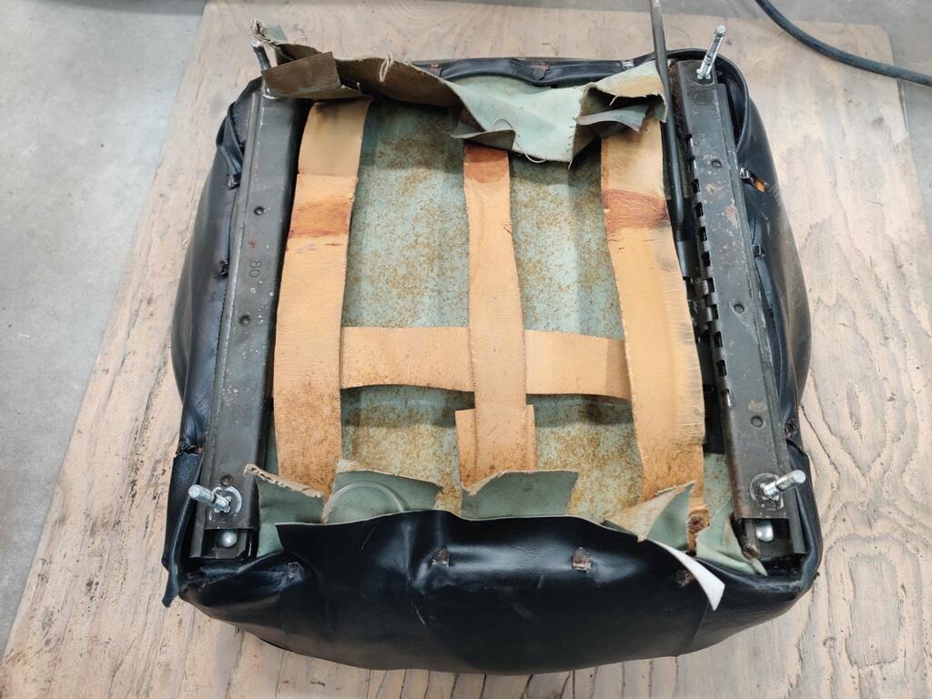

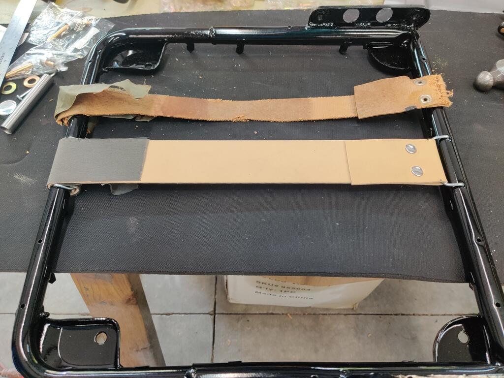

I took many pictures as I was taking the seat apart so I would have documentation to refer to when it came time to reupholster them.  I suspect that the center strap was folded around the front of the seat frame when the seat was reupholstered.  Perhaps they tried to put some tension back in the "stretched out" strap.  None of the other straps in the seat were installed that way.  I believe I have made a mistake in reproducing this and will revisit to make the center strap not roll around the frame like this.

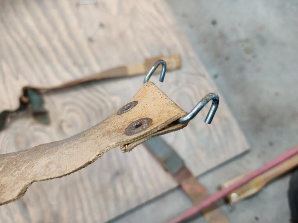

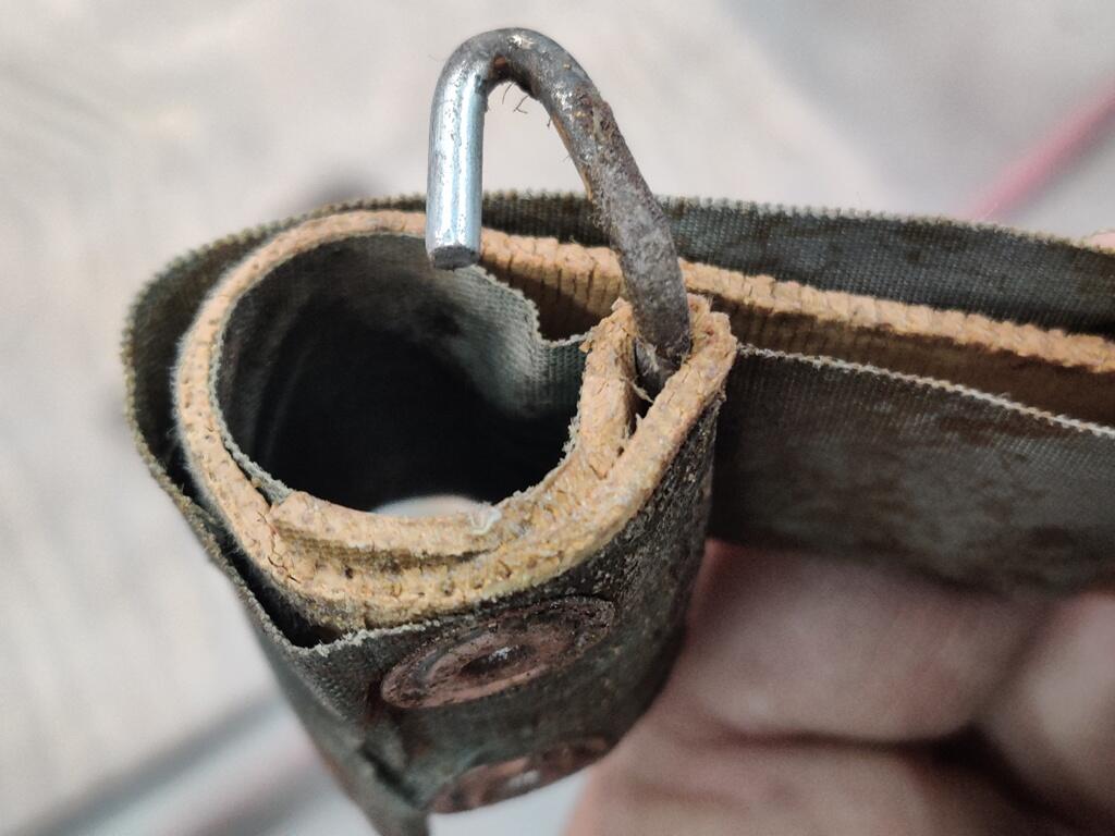

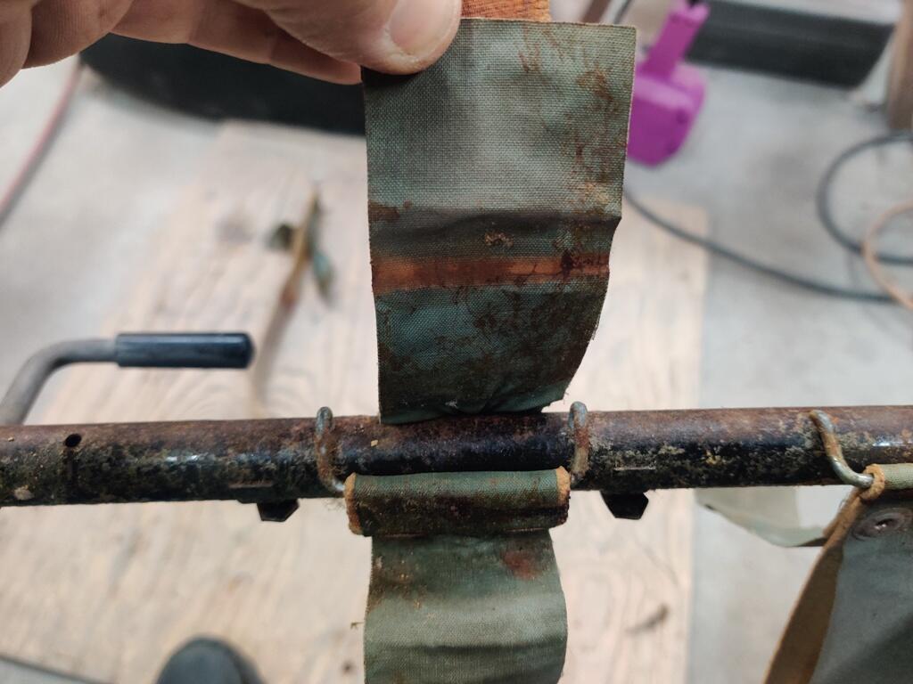

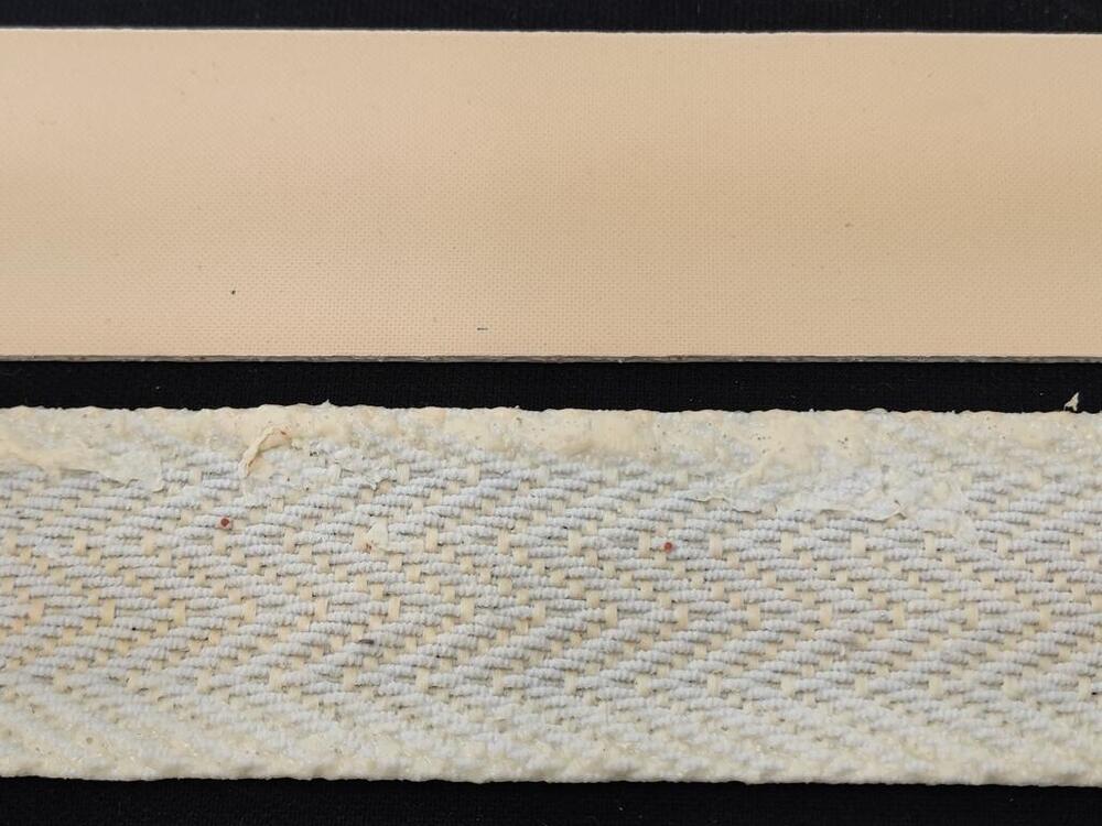

The straps have some cloth tape at their front ends.  It doesn't seem to serve any purpose to me.

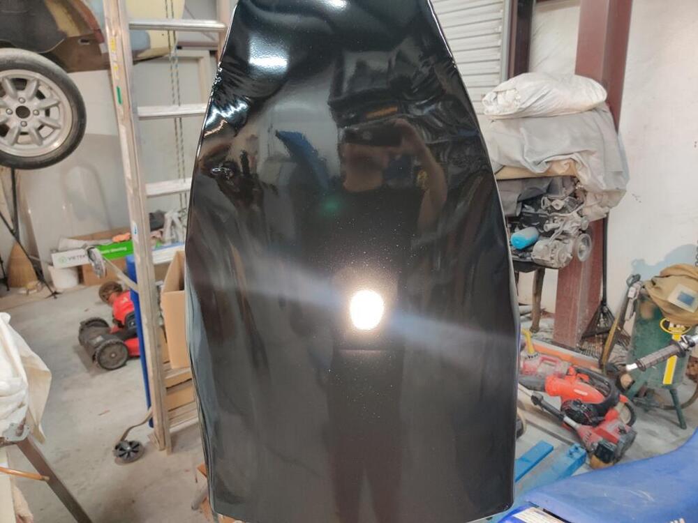

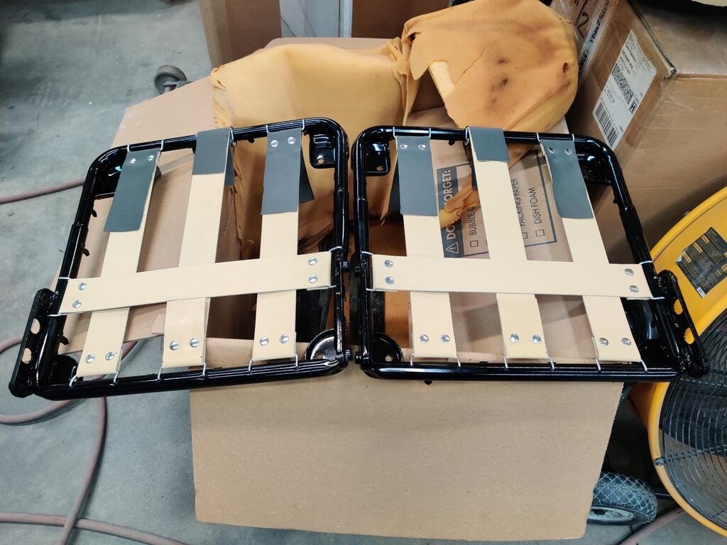

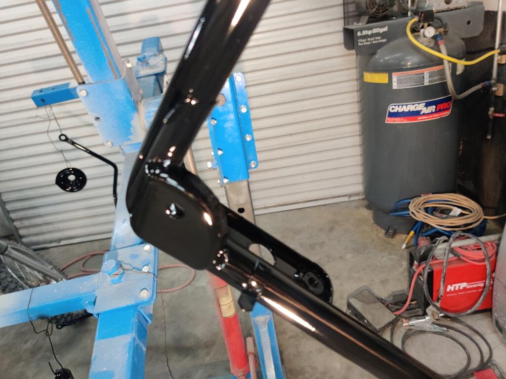

Seat frames and backs were "sand" blasted, epoxy primed, and finished in gloss black.  Hardware was re-plated.  I bought a re-strapping kit, but decided to go with "Pirelli" strapping instead.  I don't know if it is better quality, but it looks more original and feels like higher quality to me.  The amount of effort it takes to stretch it feels noticeably more to me.

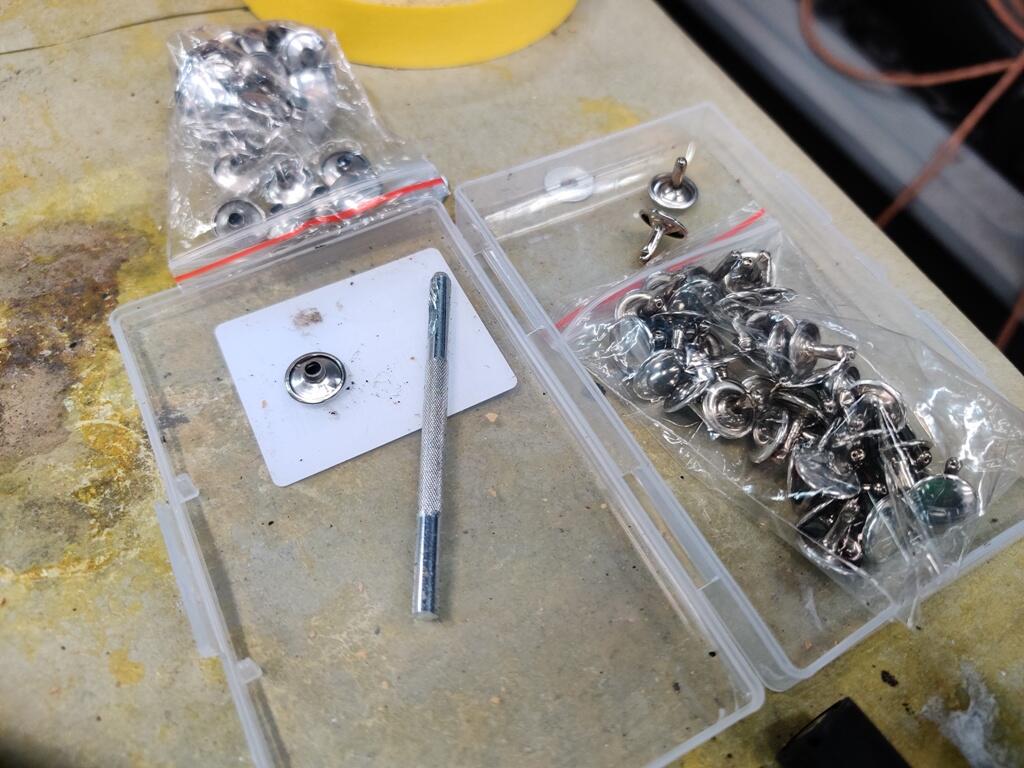

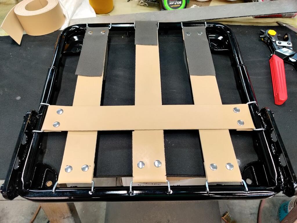

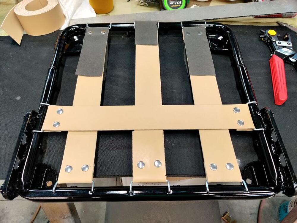

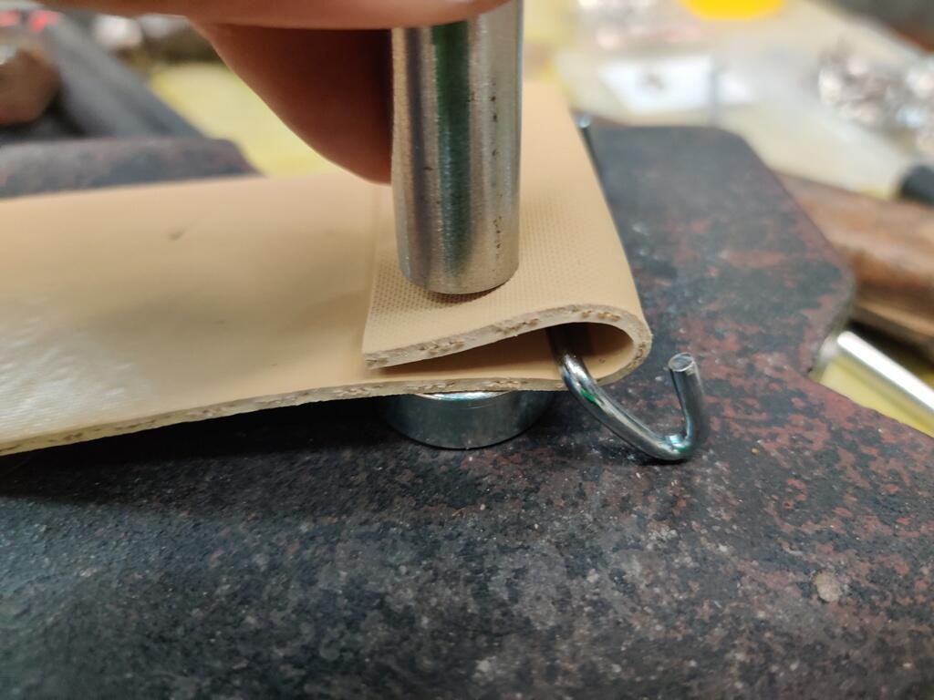

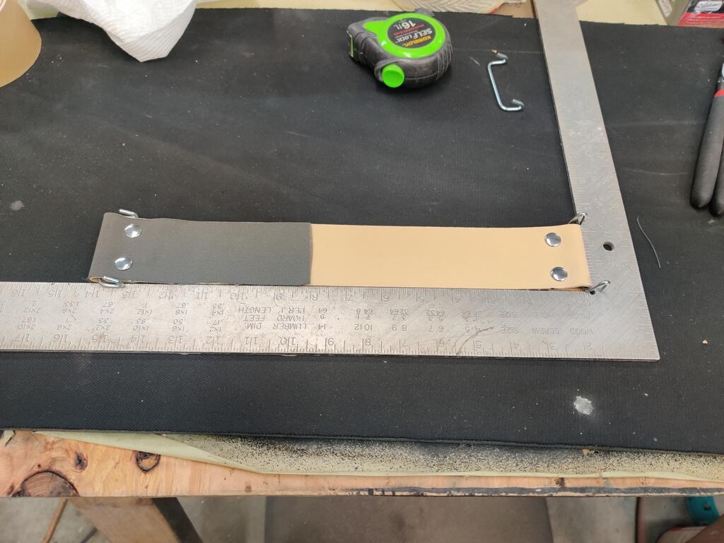

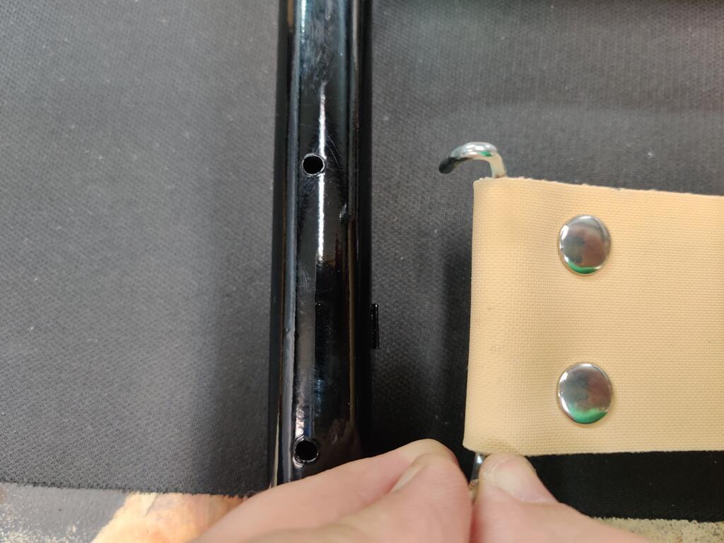

I bought a kit of stainless steel tubular rivets to secure the straps to the clips.  Harbor freight sells a nice hole punch tool that I used to make holes in the strap material and the replacement canvas I bought.  I installed the replacement canvas just for kicks to make mimic the factory cloth tape.  Probably shouldn't have bothered.  Assembly of the rivets consisted of pushing the one with the post through the materials and putting the other half of the rivet onto that post.  Then I set the rivet with post into the round die and used a hammer and included setting tool to smash the two halves together.

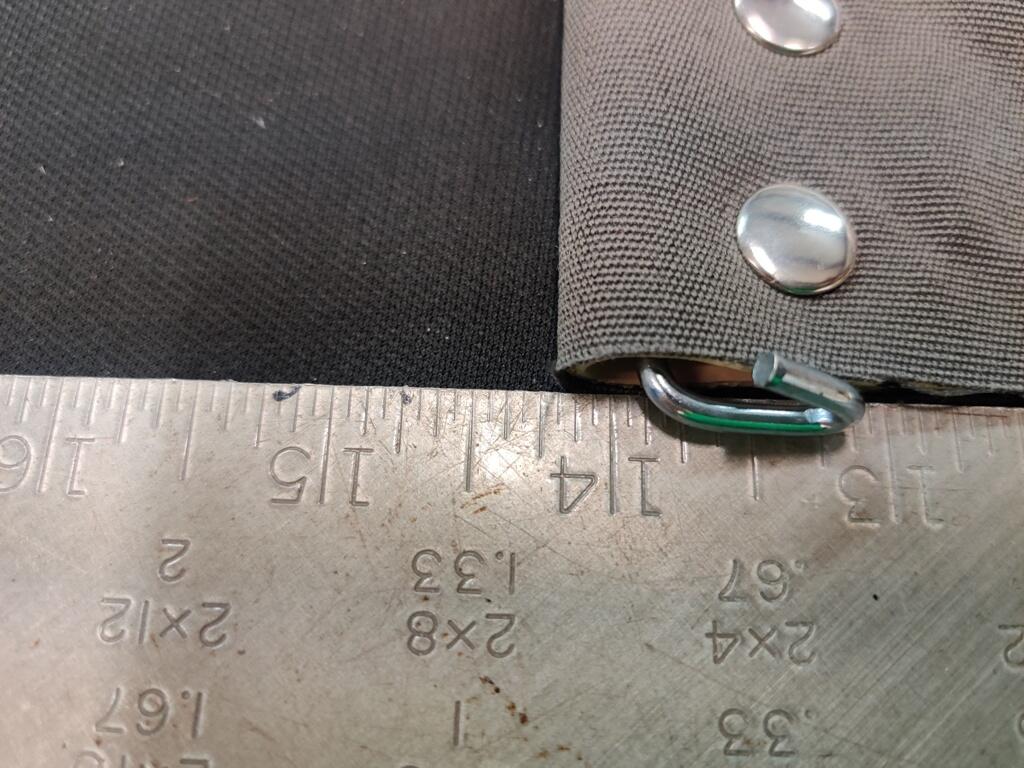

I experimented with lengths of strap to get tension where I felt it should be.  For each piece, I landed at overall length of 17", and then folded over the ends so that the fully assembled strap was at ~ 14 and 1/4".  To install them to the seat frame, I had to stretch the strap and drop the hooks in the holes.  I estimate that I had to stretch the straps about 1 inch to install them onto the frame.

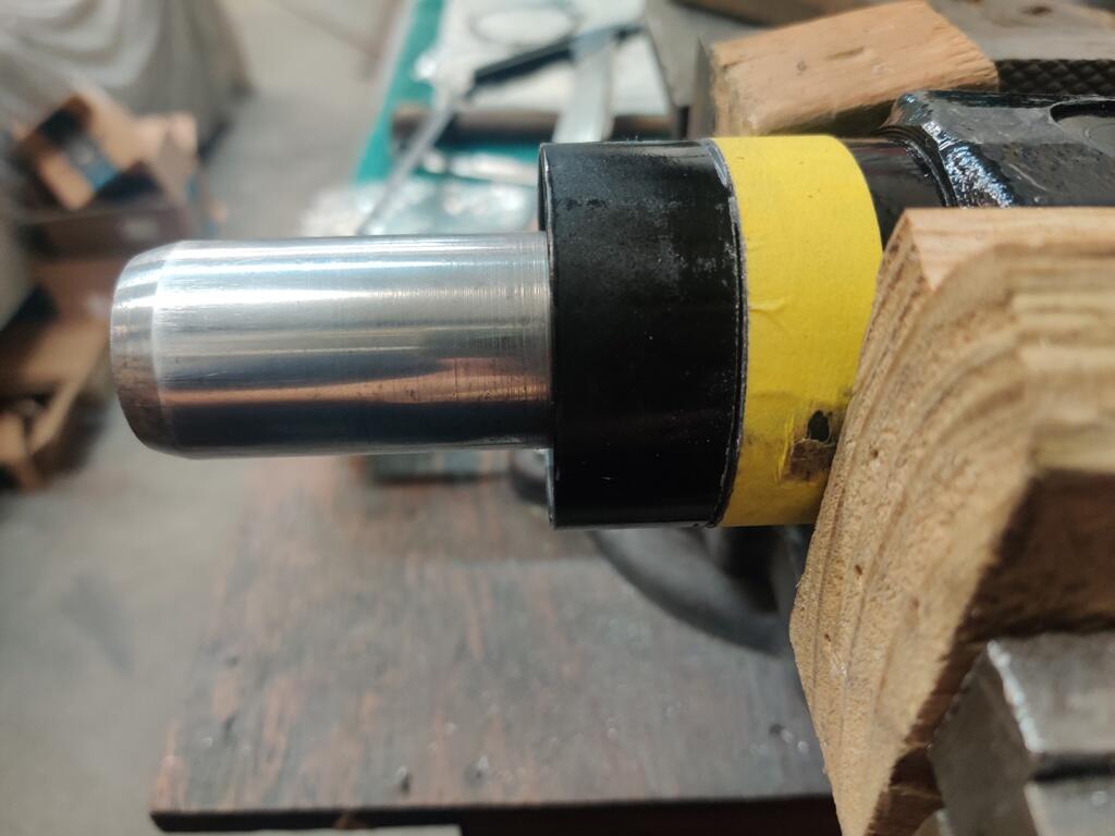

Carolina Driveline received my driveshaft on Wednesday.  They have shortened and balanced it for $120 plus shipping and are shipping it back to me today.  That is impressive turnaround time.
The driveshaft was delivered to me by FedEx today.  During attempted installation, I found that I had to remove some of the original shield.  I did this manually with a hacksaw, removing a linear inch of the shield.  I measured and ran a piece of tape around the shield to mark where to cut.  The remainder of the shield is of a slightly smaller diameter than the shield that is pressed into the tail section of the 240SX transmission.  So, it slides within that shield, but with a small air gap.
Assuming they removed 2 inches as I specified, I am kind of surprised at how tight the fit is.  With the driveshaft installed, the front portion of the shaft (with the spines) is deeply seated inside the transmission.  I will add a pic, but essentially, another 1/2 removed from the shaft would have been better.  I don't understand why all the references I have found online for shortening the stock driveshaft for 240SX transmission conversion don't seem to match my situation.  I confirmed I had the short (early) driveshaft. But instead of shortening by 2 inches (what I found others have done and as I asked for), I think 2.5 inches would be better.

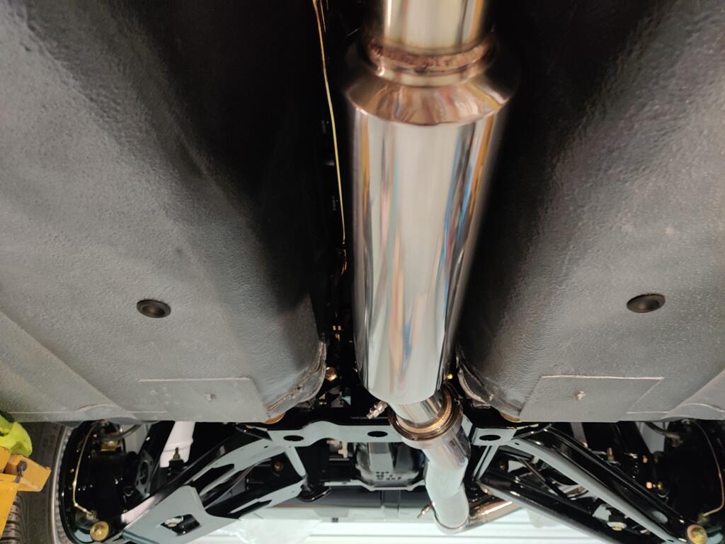

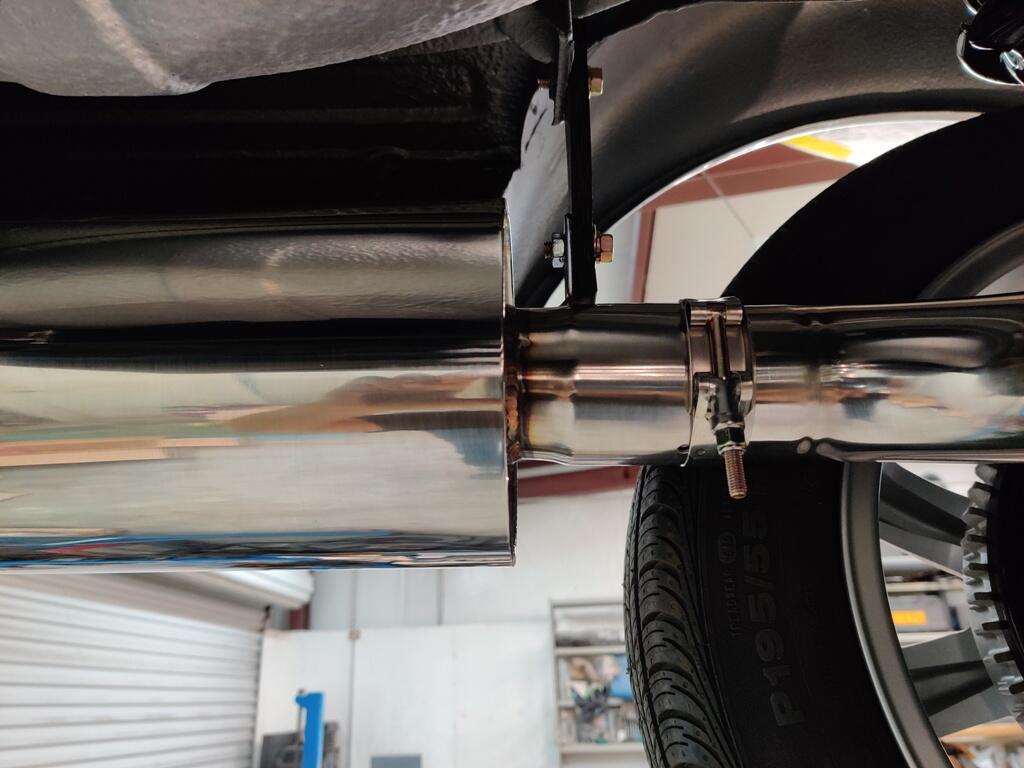

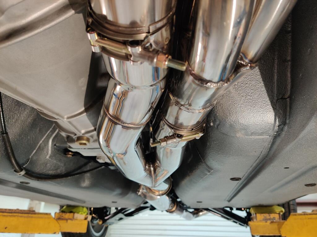

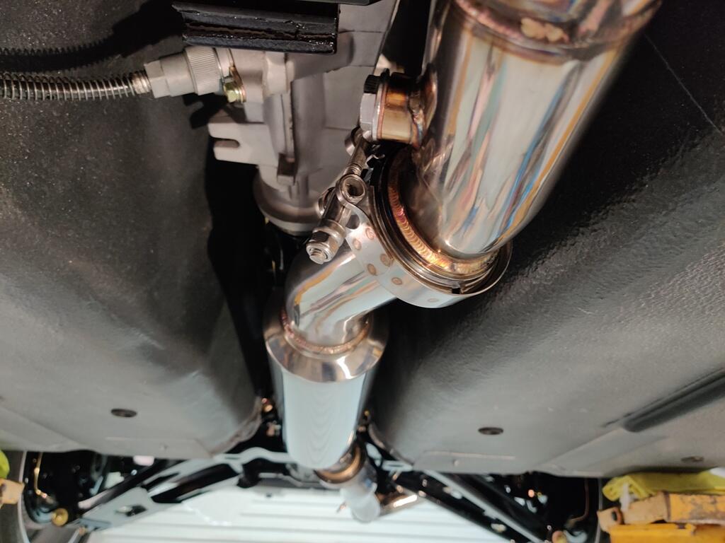

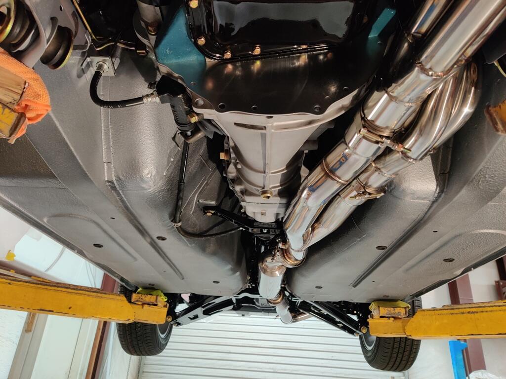

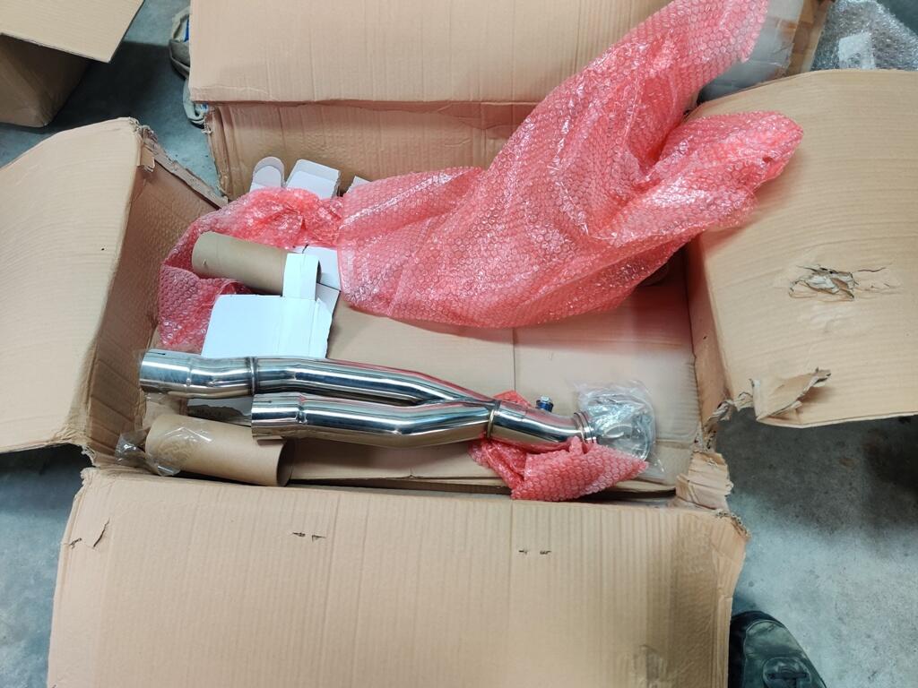

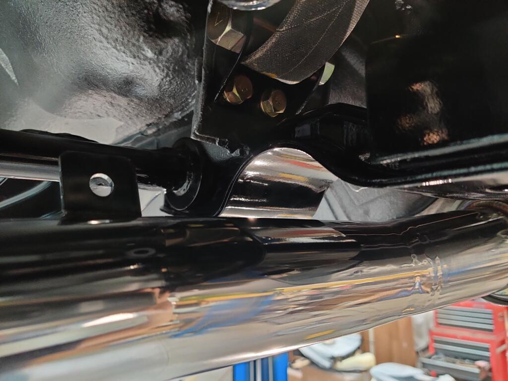

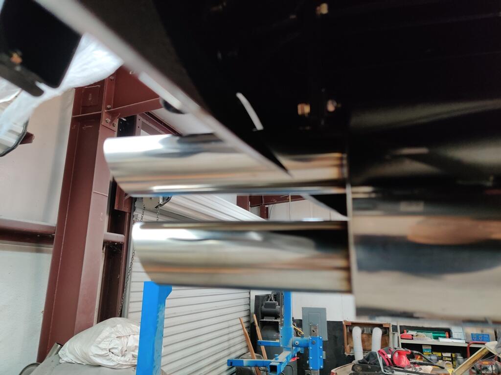

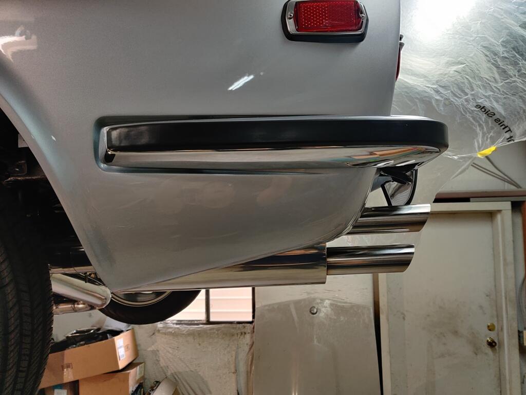

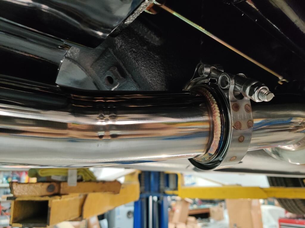

With the driveshaft in the car, I moved on to installing the Z-Story exhaust.  The header was already installed, of course.  So, I unboxed the rest of the parts and put them on the car.

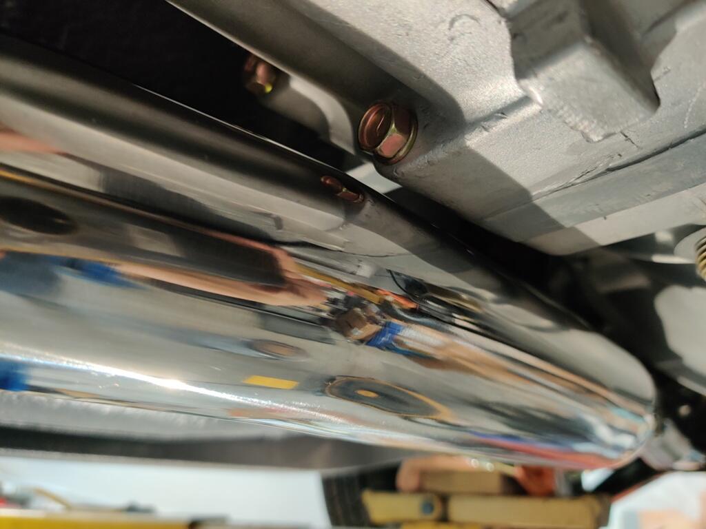

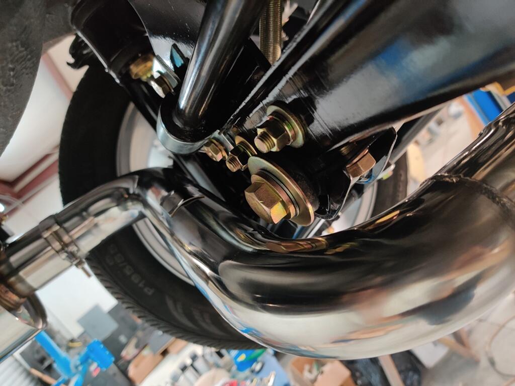

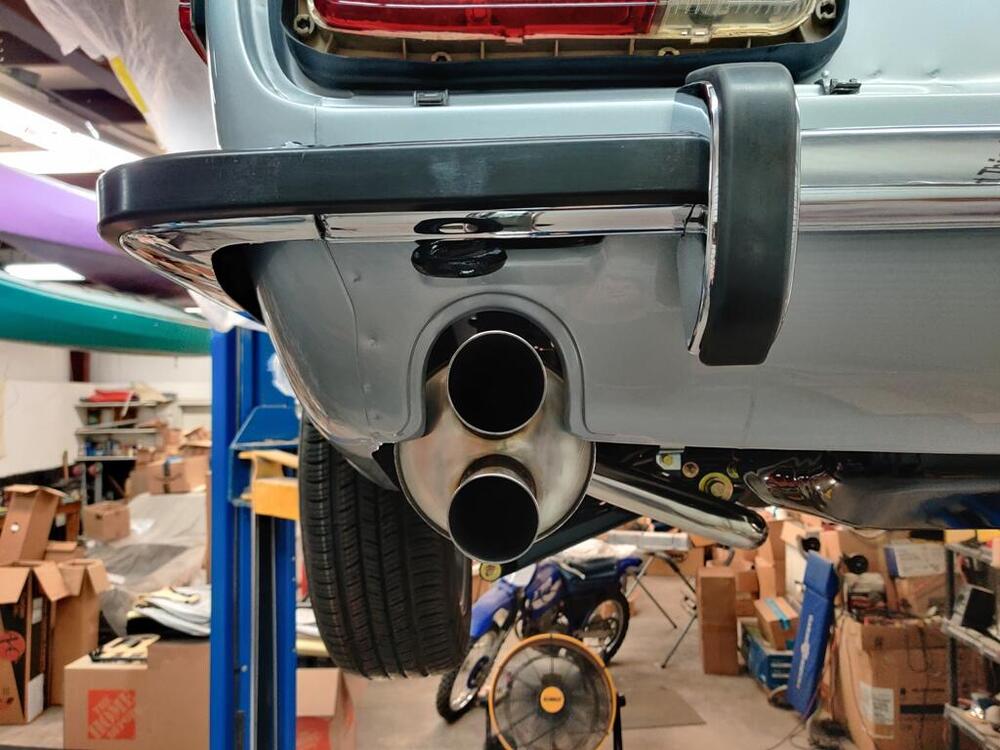

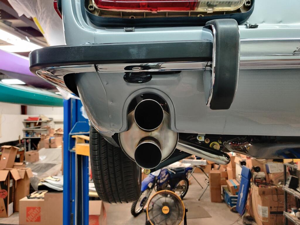

I found the fitment to be very good.   There is one spot where the exhaust comes within 1/4 inch of the transmission case.  However, clearance seems to be enough everywhere - I do not think there will be any rubbing.
