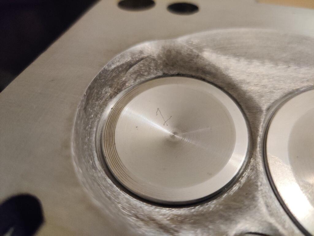

This is interesting.  How deep did he go?  This would also change chamber volume.
Considering the variation and the odd logic it might actually be worthwhile to remove the head and take a close look at what's been done.  Trying to grasp sinking the valve seats to deal with "archaic design".  Esthetics, function, machining problems?  Curious about what he was trying to fix.

I will see if he will provide some info.  I believe the main issue was the transition from the combustion chamber roof into the exhaust valve and that putting the exhaust valve deeper was done to improve flow out of the chamber.  Here is a picture of the number 1 exhaust:

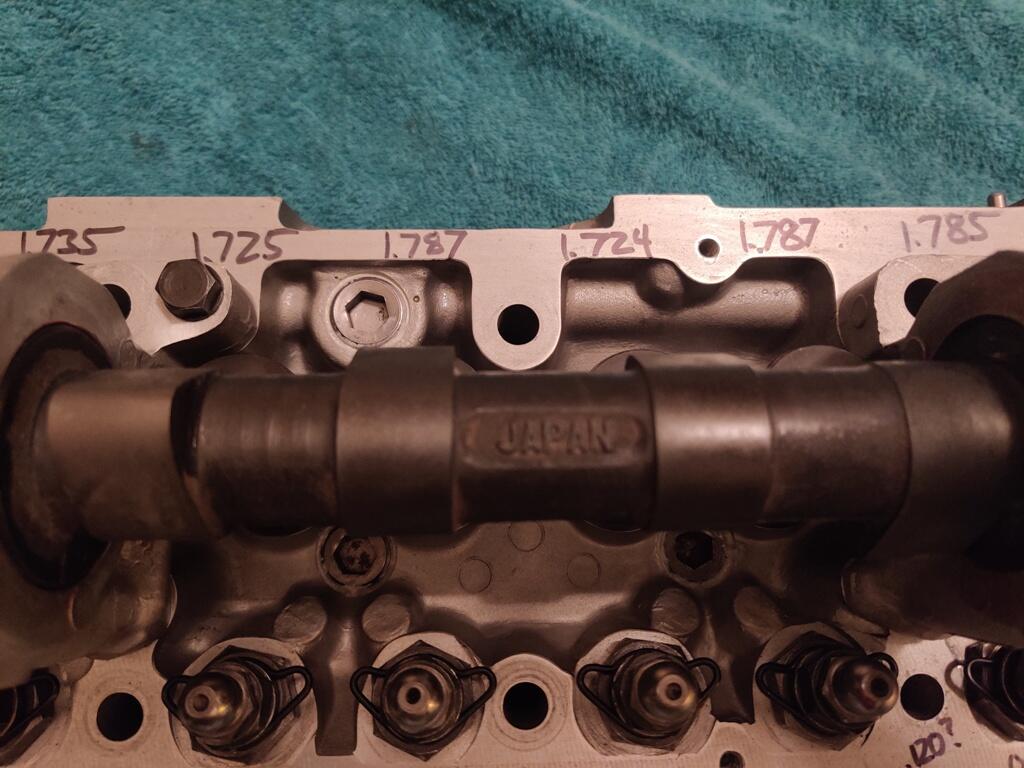

And some of the installed heights.  The 1.78 ish numbers are exhausts.
The plan to fix is changing to removing the tall shoulder on 6 of the Isky retainers.  My engine builder passed this along to me:
"Your exhaust valve tip height is .050-.060 taller than the intake tip heights. This is reflected in the taller preliminary installed heights on the exhausts. It took lash pads that were .055-.060 thinner on the exhausts to get the cam sweep pattern centered, to match the intakes with the .175 pads. If you try to use the .175 pads on the exhausts, it may remedy the interference with the retainers but I believe it will screw up the sweep pattern. With use of a .118" lash pad, that shoulder protruding up on the exhaust retainers is only getting in the way, and not offering the support you would need with a tall pad."

How did he evaluate wipe pattern if the retainers were interfering with the rocker arms?  Maybe he centered the lobes on the pads at a certain rotation point and didn't actually see the whole wipe.  Or he checked it with the interfering parts and didn't realize.  Not clear.
Just seems odd that he missed the interference between the parts.
I was thinking the exact same thing. If what inline6 posted is a quote back from the guy who did the head, then it really doesn't make sense.
If the engine machinist picked the lash pads and declared the wipe pattern "correct", then he must have overlooked a real problem!
"If the engine machinist picked the lash pads and declared the wipe pattern "correct", then he must have overlooked a real problem!" - I think that is accurate.
