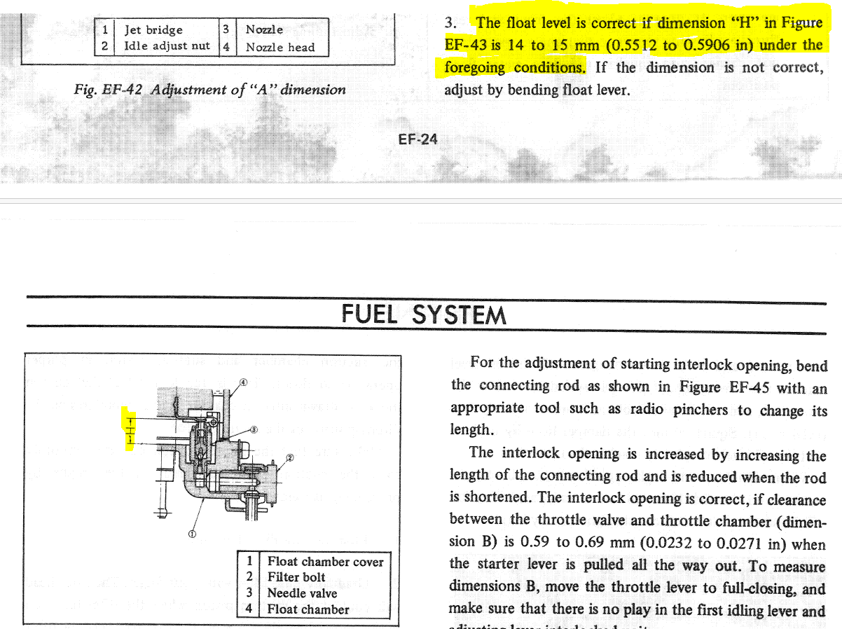

While my intermittent overflow issue could be something else, (maybe the needle and seat is not working properly after all)  I think the problem is the extreme angularity of the float.  I am going to set the float height one more time using the 14-15 mm distance as shown in the factory workshop manual instead of wet setting at 20 mm below the float chamber cover bottom edge.  Using this method, I will check the fuel level using the clear tube as when setting the floats using the wet set method.  I want to see where the fuel height is compared to when wet setting at the 20 mm spec.
Depending on what I find out, I may proceed with modifying the floats by installing one M8 X 16 stainless screw per float.
I suspect you'll find the fuel level lower than spec. I also suspect that it'll run ok even with the lower level. You might starve for fuel at WOT going up a big hill, but for around the neighborhood testing, I would wager that you'll be OK.
As for final positioning of your nozzles, I've found that 2 1/2 turns down is pretty good for stock. With the changes you made to the engine, maybe you need a little more than that? I wouldn't start to be concerned until you're finding it won't run well below say three turns down. At that point, I'd be looking for a vacuum leak.
I find it interesting that setting the float using 14 to 15 mm (I use a 3d nail cut and then ground to size and then fit between the metal part of the float and the roof of the float casting cover), achieves nearly level angularity of the float top surface with the underside of the float chamber cover.  The two methods are wildly different.
I wonder if going down the road and chopping through bumps... I wonder if the float level rises up a bit more because the float is bouncing around in the chamber.  I don't know what the performance difference is with the fuel level too low vs "higher".  I guess more experimentation is in order.  I do have a LM-2 Innovate wideband sensor, and my exhaust has a fitting for it.  Maybe some testing with different fuel level settings is in order.
Edited by inline6
I think the float bouncing around is part of it. I also think that you can get on the downhill slope of the float tang, and once that happens, you're doomed.
Wideband testing would be cool. I know there are people here that think the mixture ratio is highly affected by the float level. I'm not one of them. I believe float level has an effect, but I don't think it's that stark. Of course, however, without testing data, neither camp is anything but speculation. Wideband data would be very interesting.

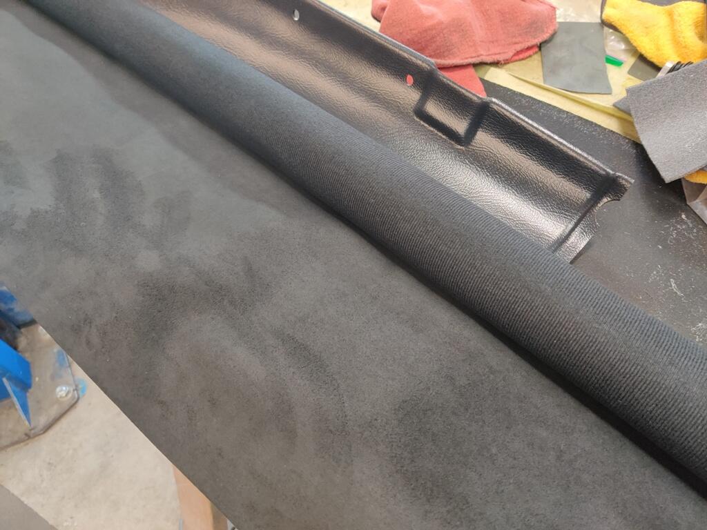

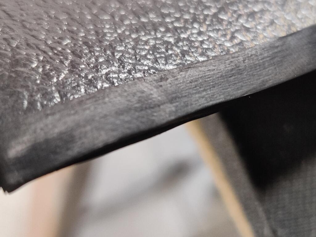

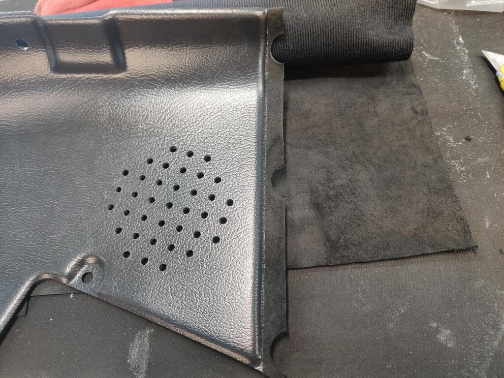

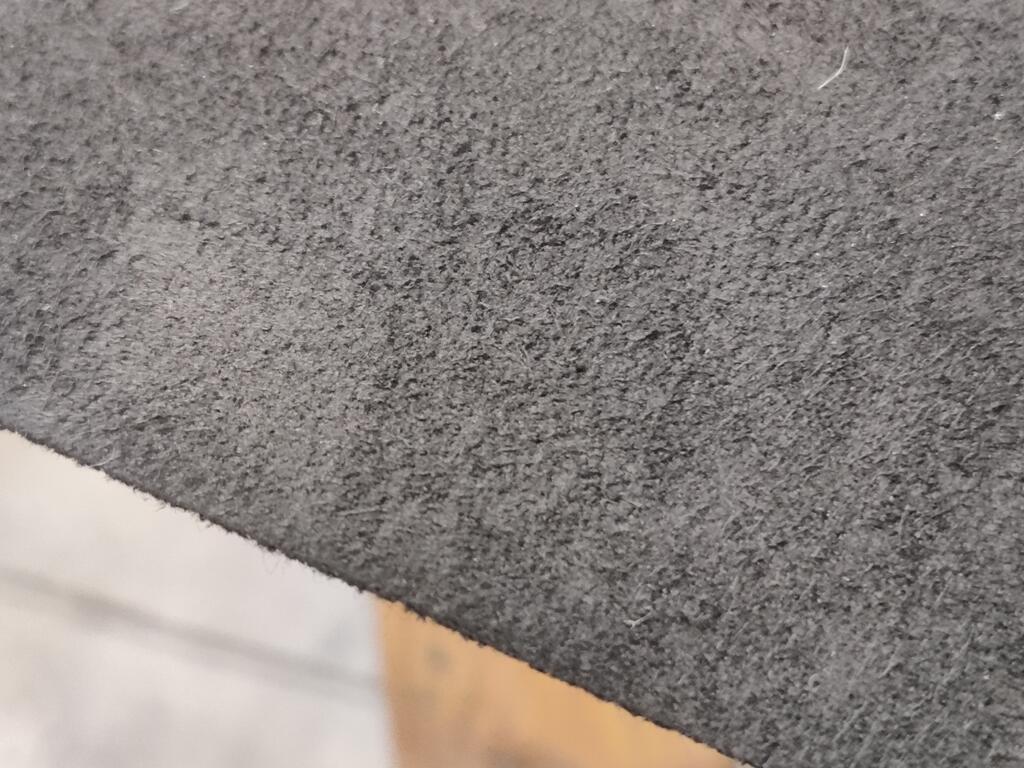

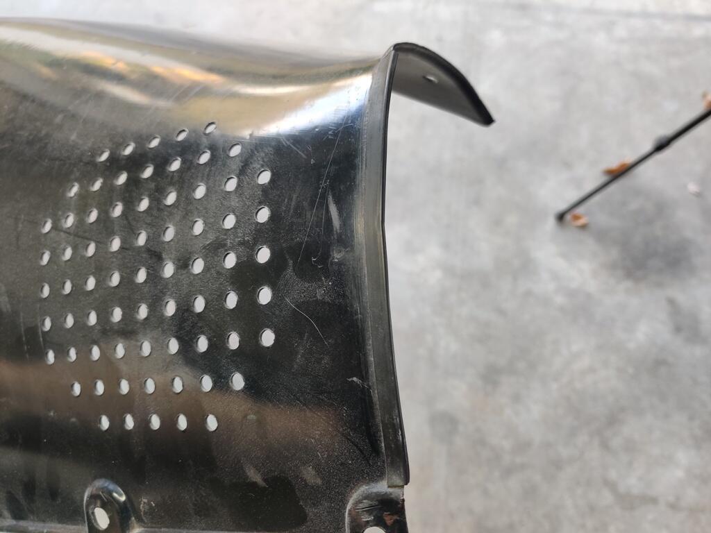

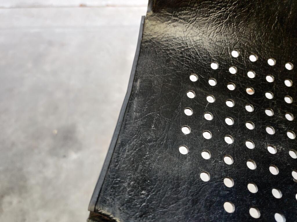

Some of my progress over the weekend included some modifications to the new interior trim panels.  First, I glued some faux suede material (purchased from www.yourautotrim.com) in the spot where the quarter panel trim piece overlaps with the rear panel.  I did this because the original trim panels in my track car squeak when they rub together.  While my restoration car may have a bit more torsional rigidity (being relatively rust free and much lower miles), the torsional rigidity is not high on these cars by today's standards.  So, this is an attempt to prevent noises.  I think the material these aftermarket replacement panels are made out of is less likely to squeak from rubbing also.

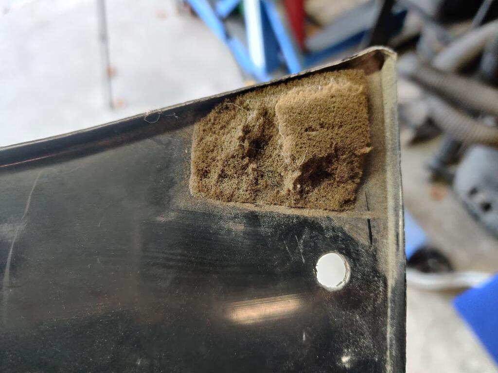

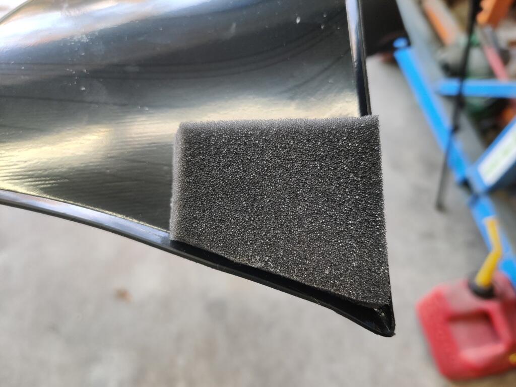

Additionally, I placed foam in the same locations as on the original pieces:

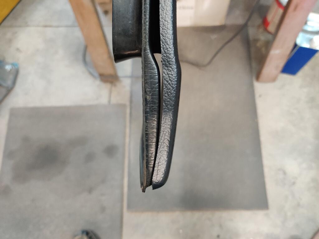

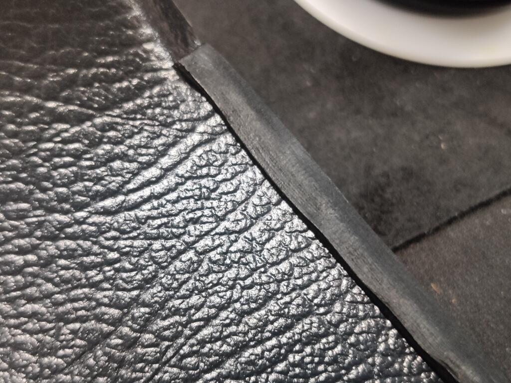

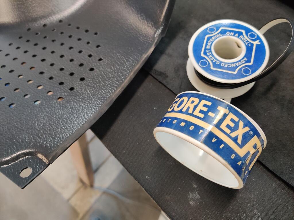

I have some of this Gore-Tex that has been laying around for ages.  I use it for various rubber gaskets like the ones at the back of the rear panels (panel for the first two pics, and the third pic is of the aftermarket panel):

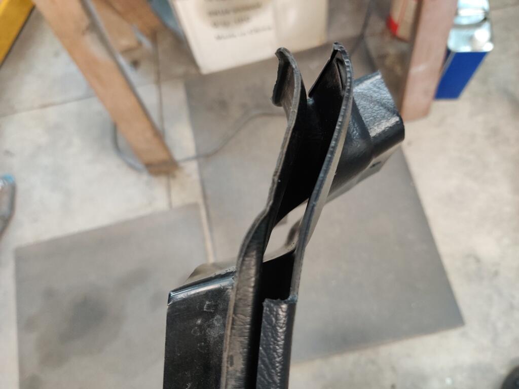

I put one piece of Gore Tex on the frontside , and one on the backside, and pinched them together at the back edge.  The aftermarket quarter panel trim has slight differences as seen in pics two and three here:
I used a 4 1/2" grinder with a mild sanding disc on it to quickly (and carefully) re-contour the front edge in a few places to improve the fit of the quarter panel piece to the car.  The front edge was taller than it needed to be in some places.  Fitment was much improved after removing some material.

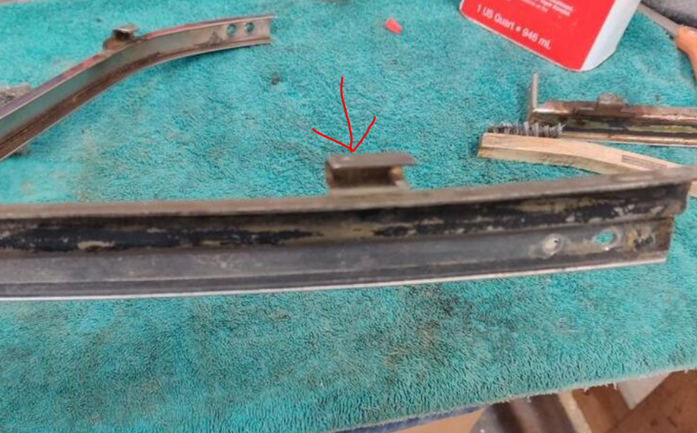

Can anyone tell me what this bracket on the quarter windows is for?  There is a small hole in the original quarter panel trim at this location.  I think it is simply there for securing the front edge of the quarter window interior trim panel, as it would be loose for most of the front edge otherwise.  Anyone have any pics of the hardware used at this location?  It may be specific to the 1971 cars.
