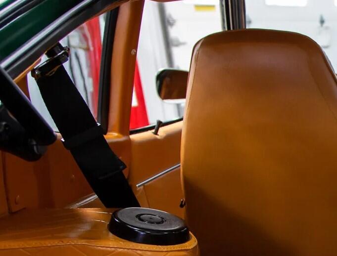

3 hours ago, grannyknot said:
Pretty sure that's where the black plastic J hook goes, it's for the seat belt to hang on.
Not sure anyone ever used it for that, usually they are broken.
The J hook on the early cars goes on the seat.  The J hook on my 1971 car goes at the bottom front corner of the quarter window trim panel.
1 hour ago, emccallum said:
Pretty sure its a phillips screw with a trim washer in that spot. J hook is below the panel and a coat hanger round metal piece is at the top.
This picture is from BAT auction
Thanks for this pic!  You can see that part much more clearly.
Confirmed clear plastic washer and small screw. Round metal "coat hooks" up above were later replaced with a more hook shape in plastic.
Seat belt hooks are here. Once they were moved from the seat back.
Thanks to all who responded!
